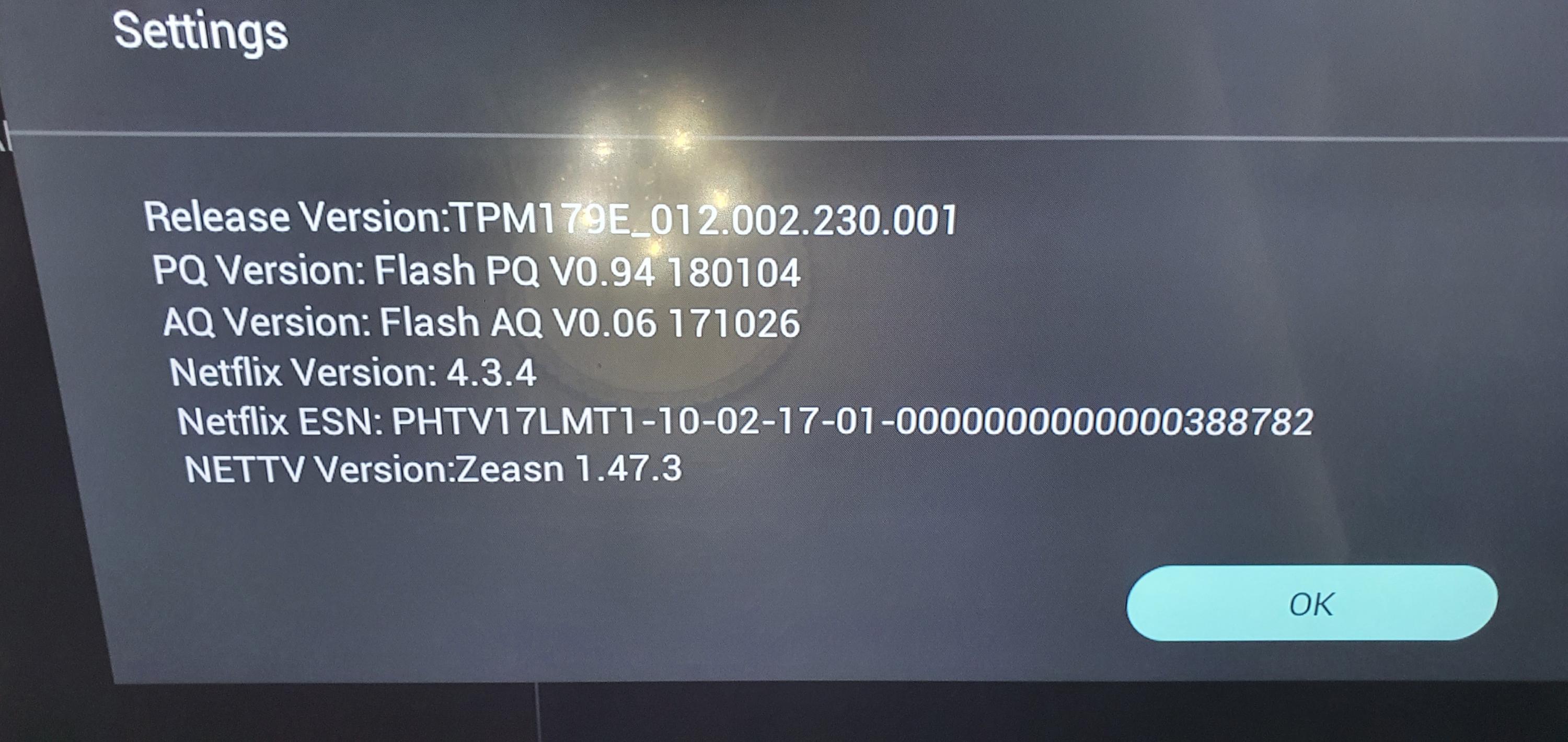

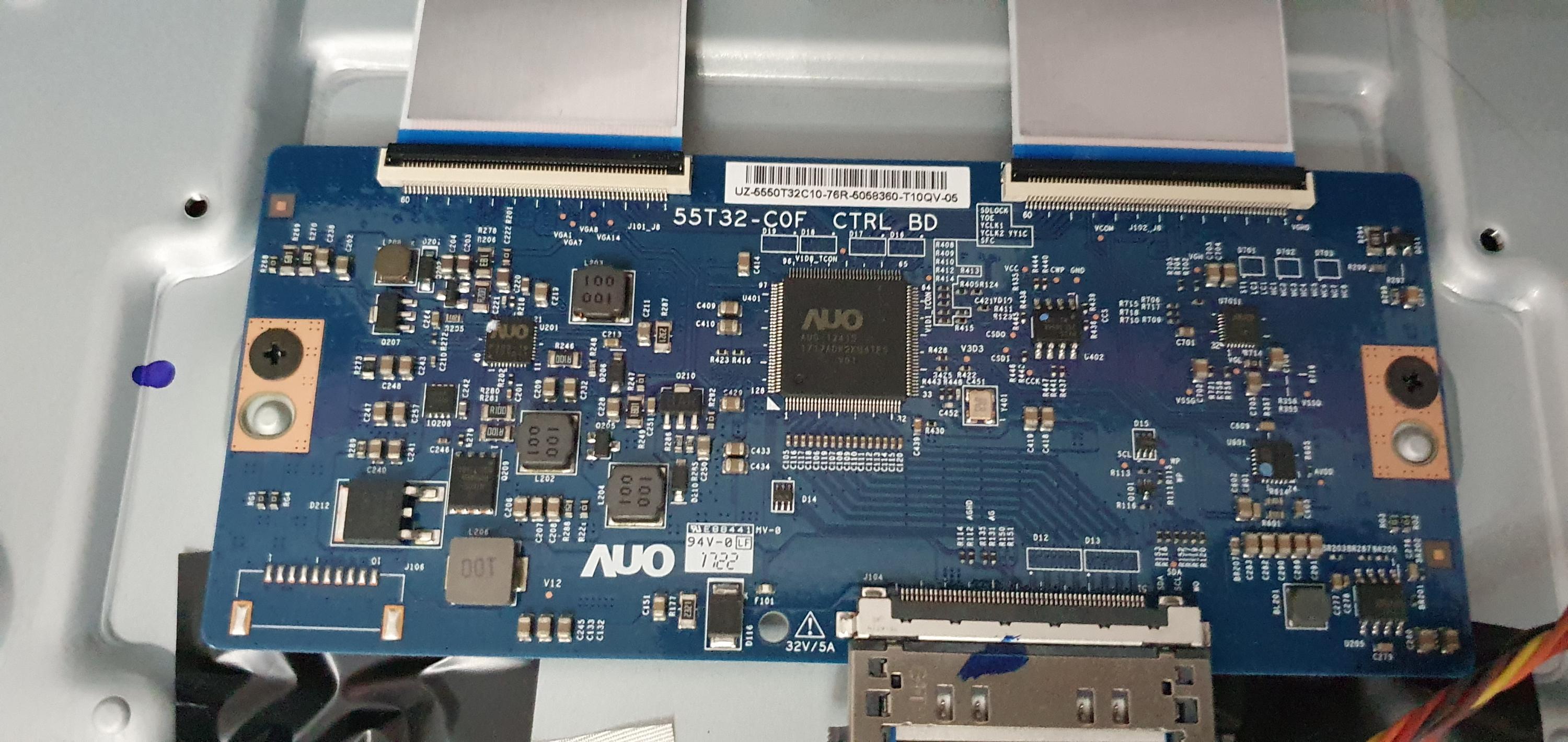

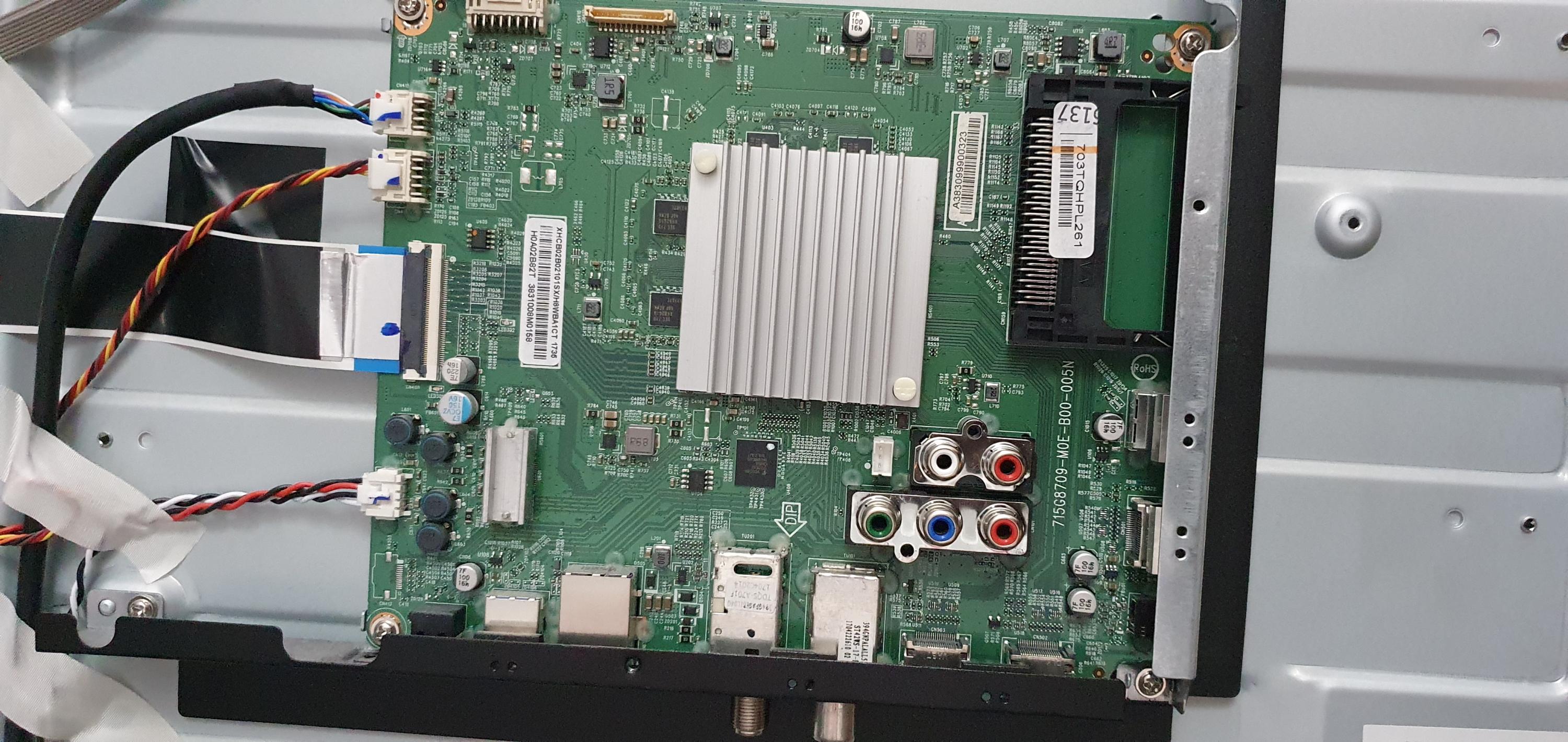

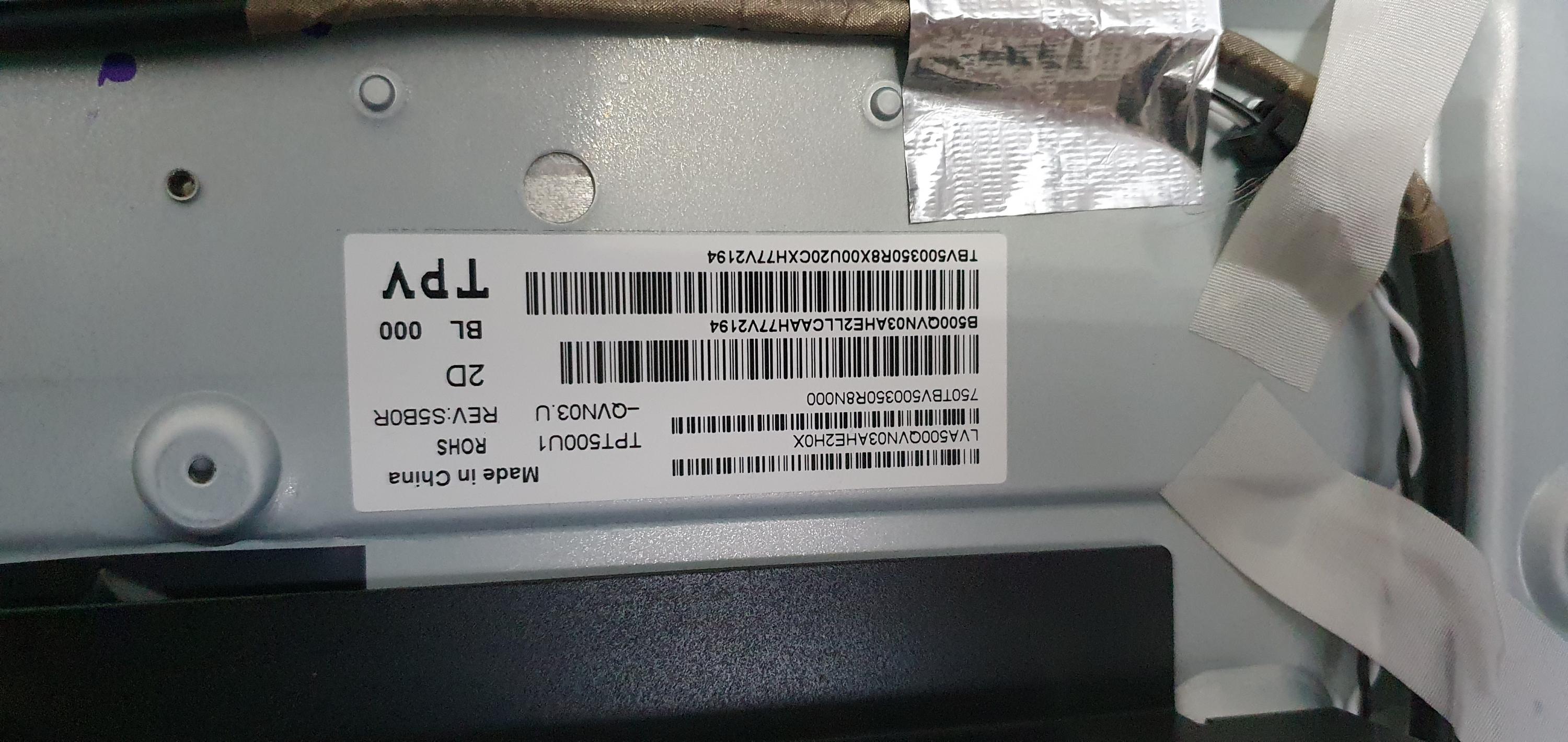

    Philips 50PUS6272/05 image flipped and upside down
    Seems this tv works all fine but the image is mirrored and also upside down, other than that seems to work all fine.
    Is this a bad tcon or mainboard?

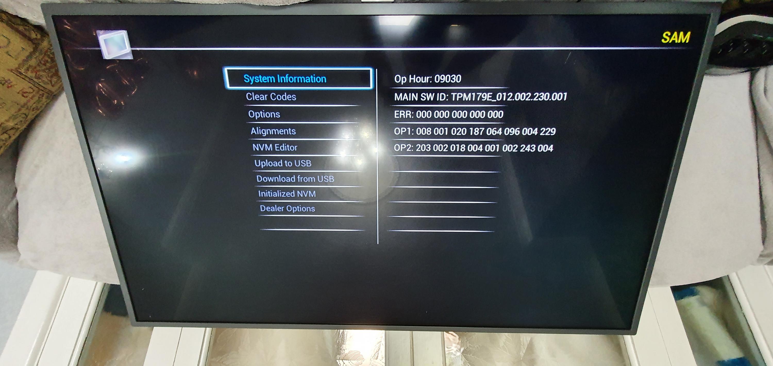

        Re: Philips 50PUS6272/05 image flipped and upside down
        can you upload pictures of your service menu screens
        • rash.m2k
          • Apr 2010
          • 64
          See attached, can't find anything about flipping the image
