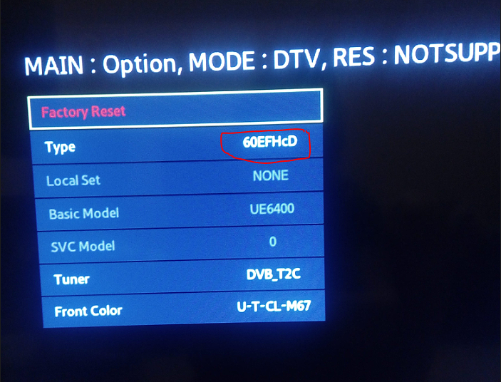

    hello i changed the mainboard with another one but the image is flipped . i try to enter service menu, but there is no hv flip option . Can someone help please i tried everything
  • lotas
    • Jan 2016
    • 4668
    • Russia
    Set the model (TYPE) of your panel, on the label of the trough there is your panel number, if there is no number, then go through it manually, each time you need to reboot the TV.

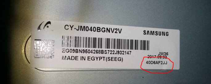

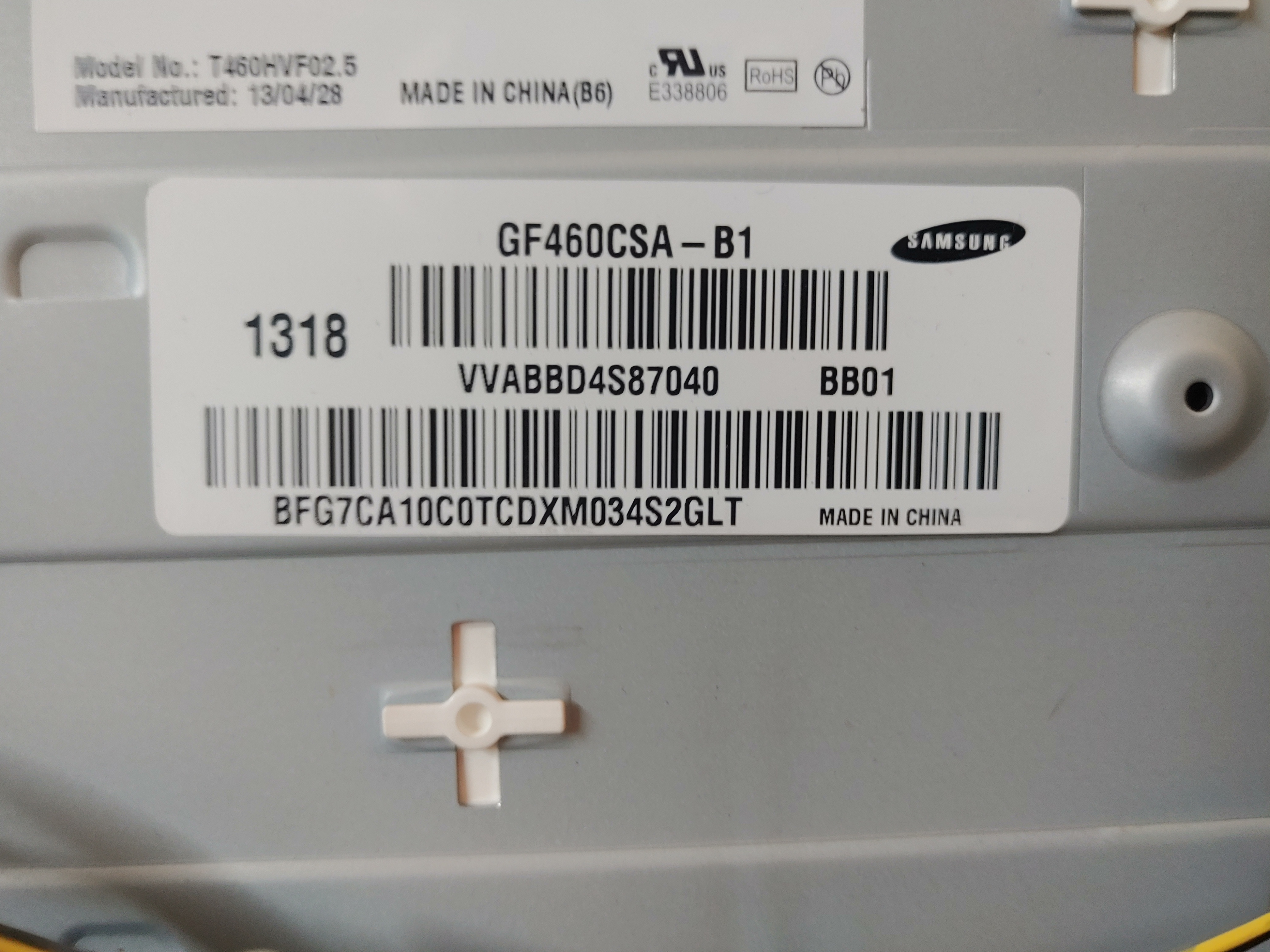

        Is it the right label?
        • lotas
          • Jan 2016
          • 4668
          • Russia
          Yes, it is correct, but there is no service code for the panel, try sorting in service mode, those with a diagonal of "46"....
