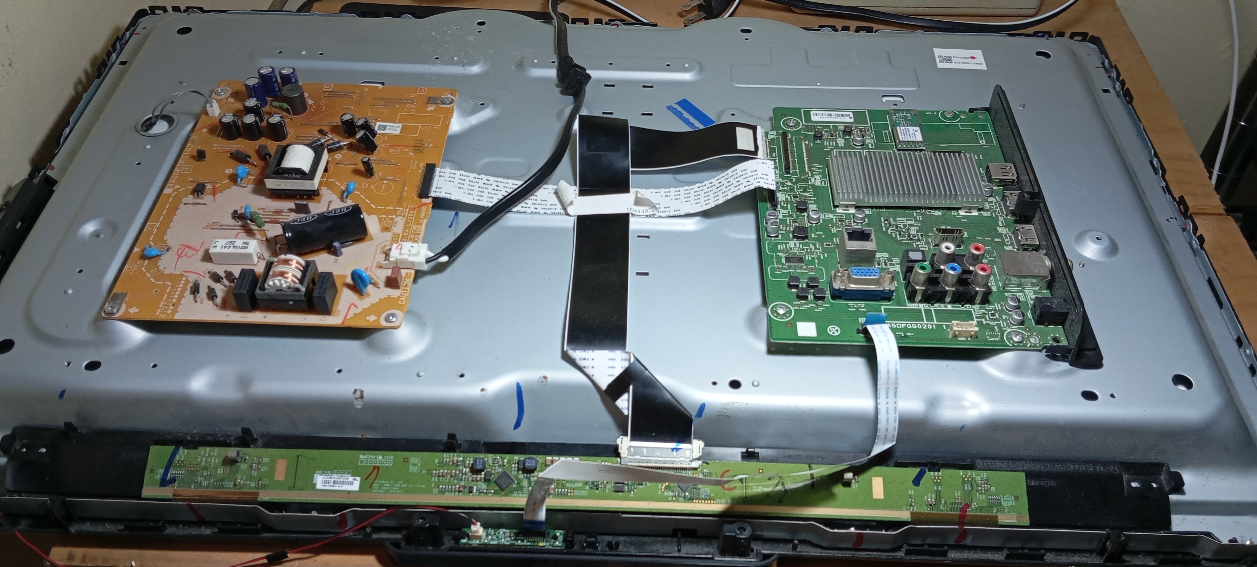

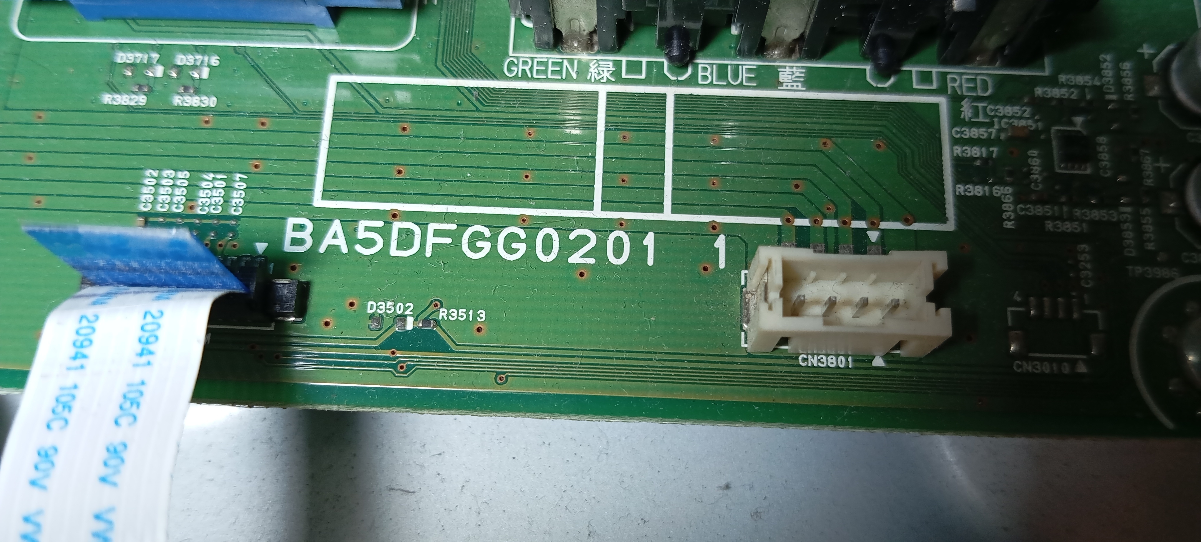

    Hello there!
    Have this Philips with no image at all. When I plug it to the outlet, it turns on without pressing the power button, and after a moment, it turns off, then starts again. I checked the 12v and 3.3v voltages on the main board connector that goes to the T-con, but it only has the former (12v). Any clues, guys?
  • alro7779
    Alex
    • May 2025
    • 65
    • Mexico
    EDIT: When I disconnect the T-con flex cable, the turning on and off loop continues. Can it be a problem with the main board?
    • alro7779
      Alex
      • May 2025
      • 65
      • Mexico
      EDIT: The power supply is sending 21v, 12v and 3.3v to the mainboard, but the latter just sends 12v to the T-con.
      • alro7779
        Alex
        • May 2025
        • 65
        • Mexico
        EDIT: Now when I press the power button, it does not turn on. Checked the voltage on the connector that goes to the control panel, and there is 3.3v, but it doesn't respond when I press the power button. What could it be this time?

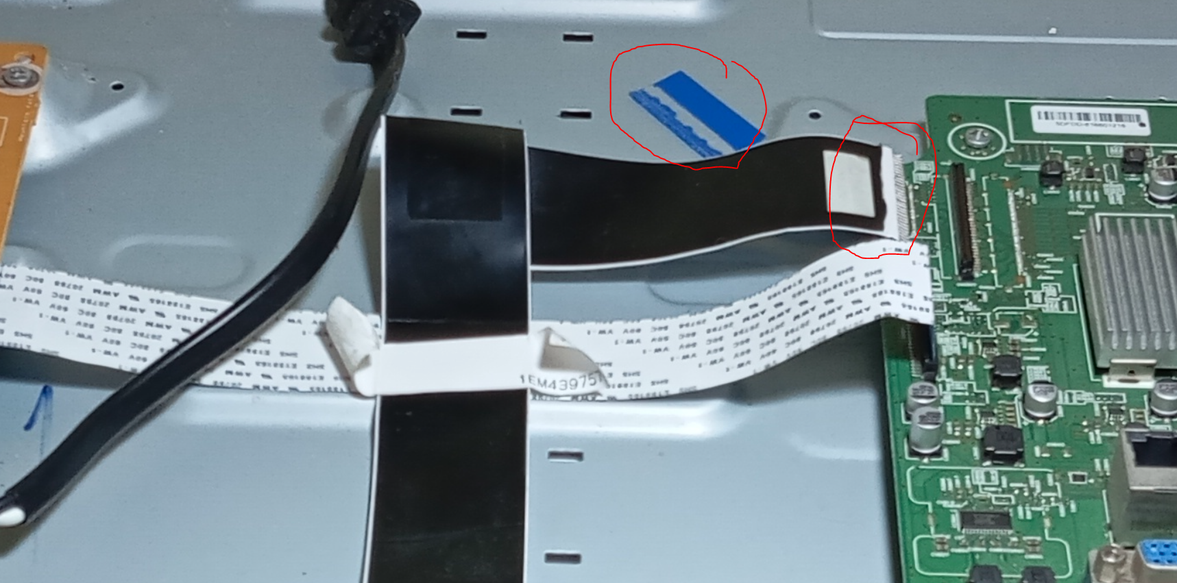

          So where will you get the image, if your LVDS cable is damaged, replace the cable and check if something has not been shorted or damaged by a non-working cable.
          • alro7779
            Alex
            • May 2025
            • 65
            • Mexico
            Thanks for your response!
            The problem started before having the LVDS cable damaged. However, I know I do need to replace that 30-pin ribbon cable. However now I'm dealing with this new issue... it does not turn on (no standby light nor backlight). I've found a shorted diode on the primary side of the power supply, next to a mosfet. Checked the leds with a tester and they do light on; 44 volts shows the tester and I remember getting only 21 volts on its connector after pluggin' it in to the outlet.
            PS.- I'm trying to find the schematic of the power supply. The model number is BA4GF0F0102 2 (only found a similar one... the BA3AF0F0102 1)
            Cheers!
