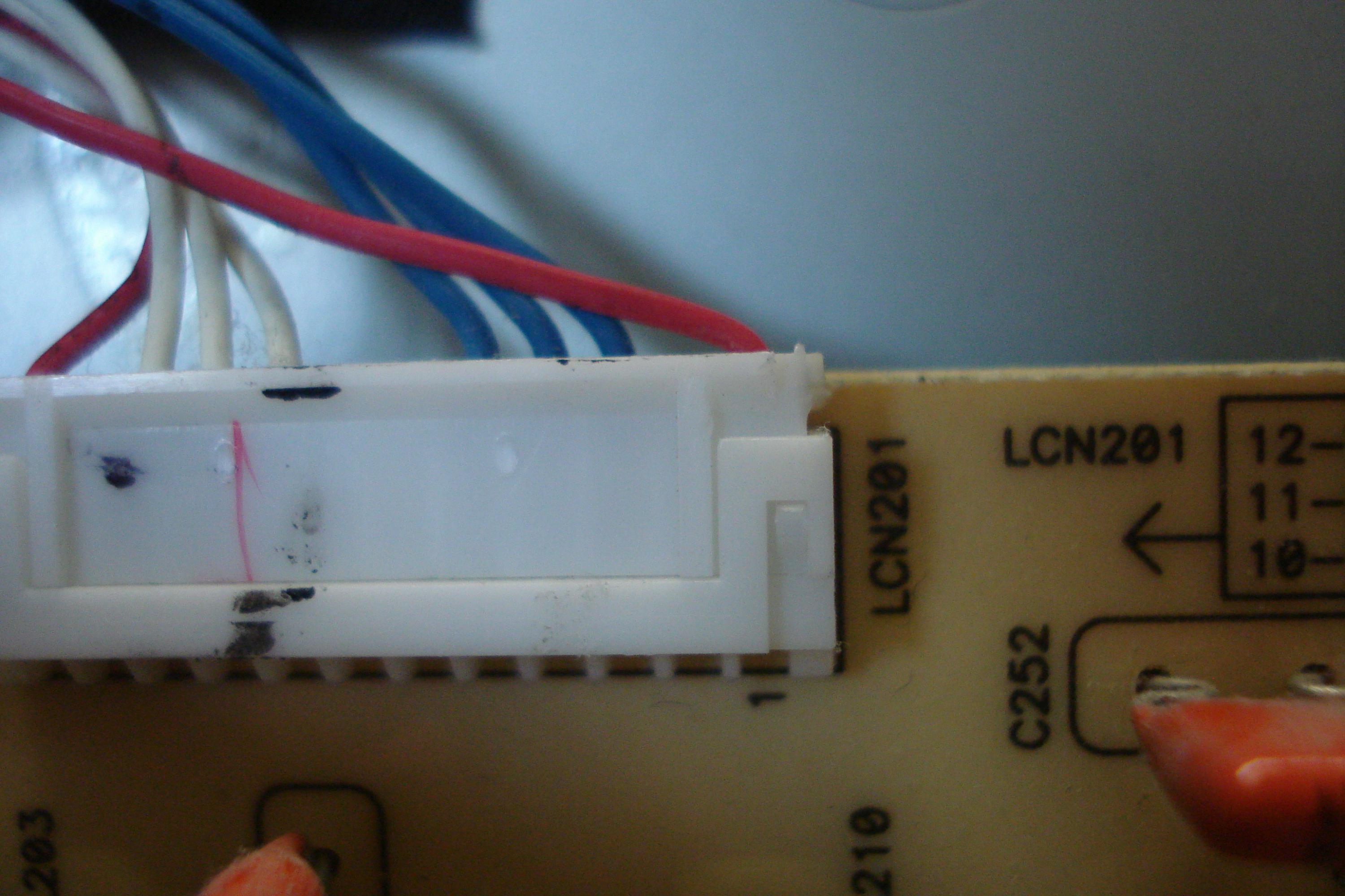

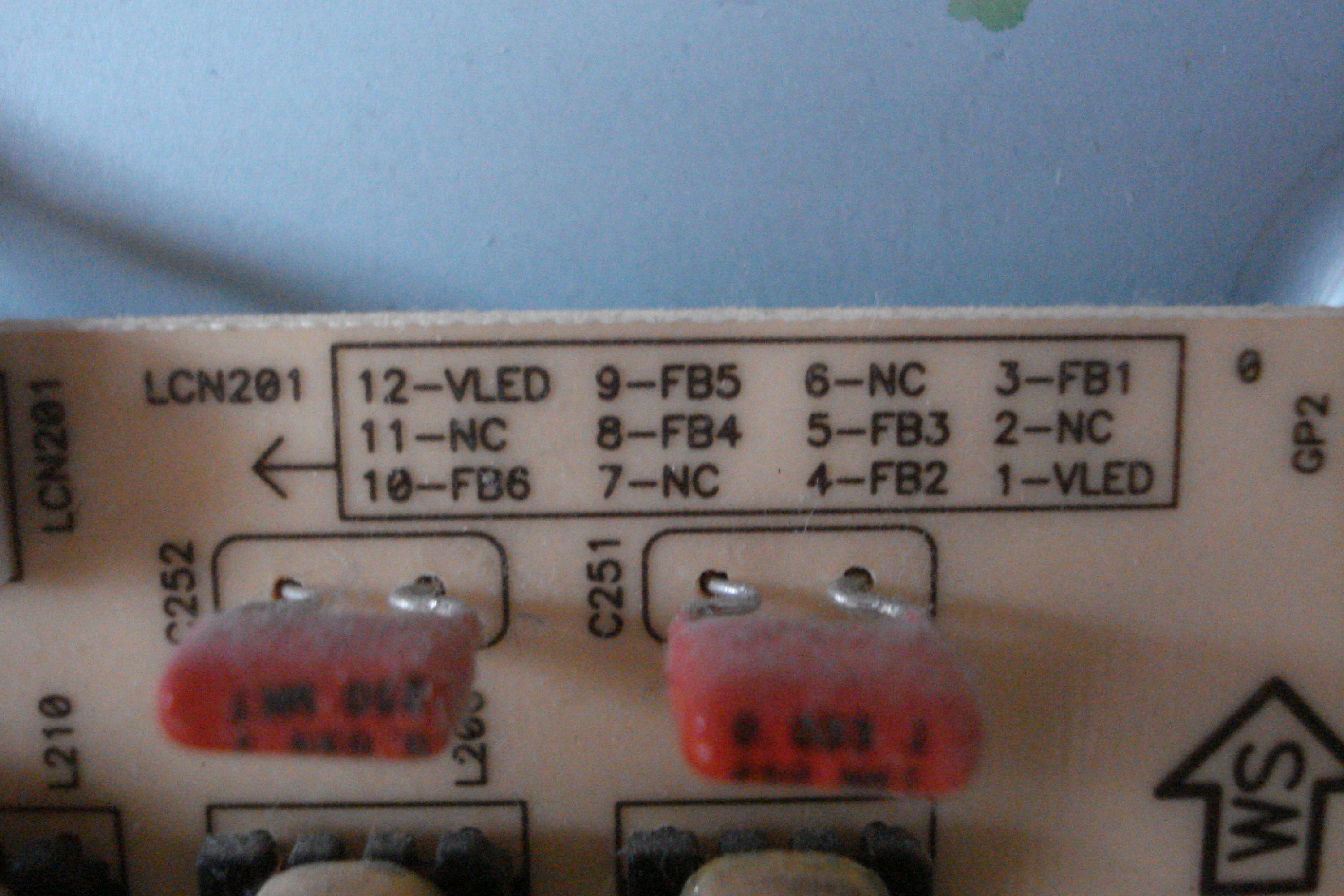

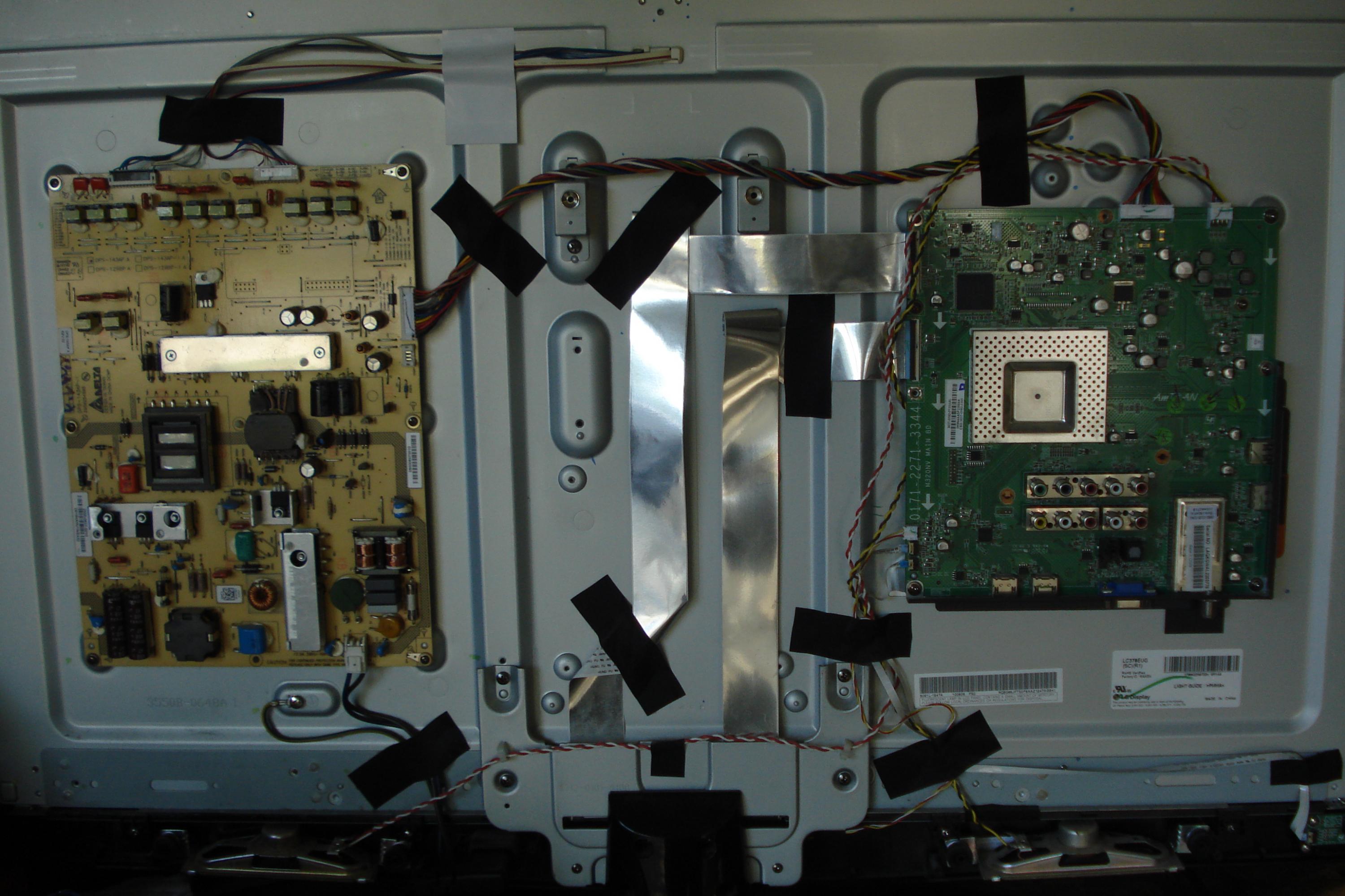

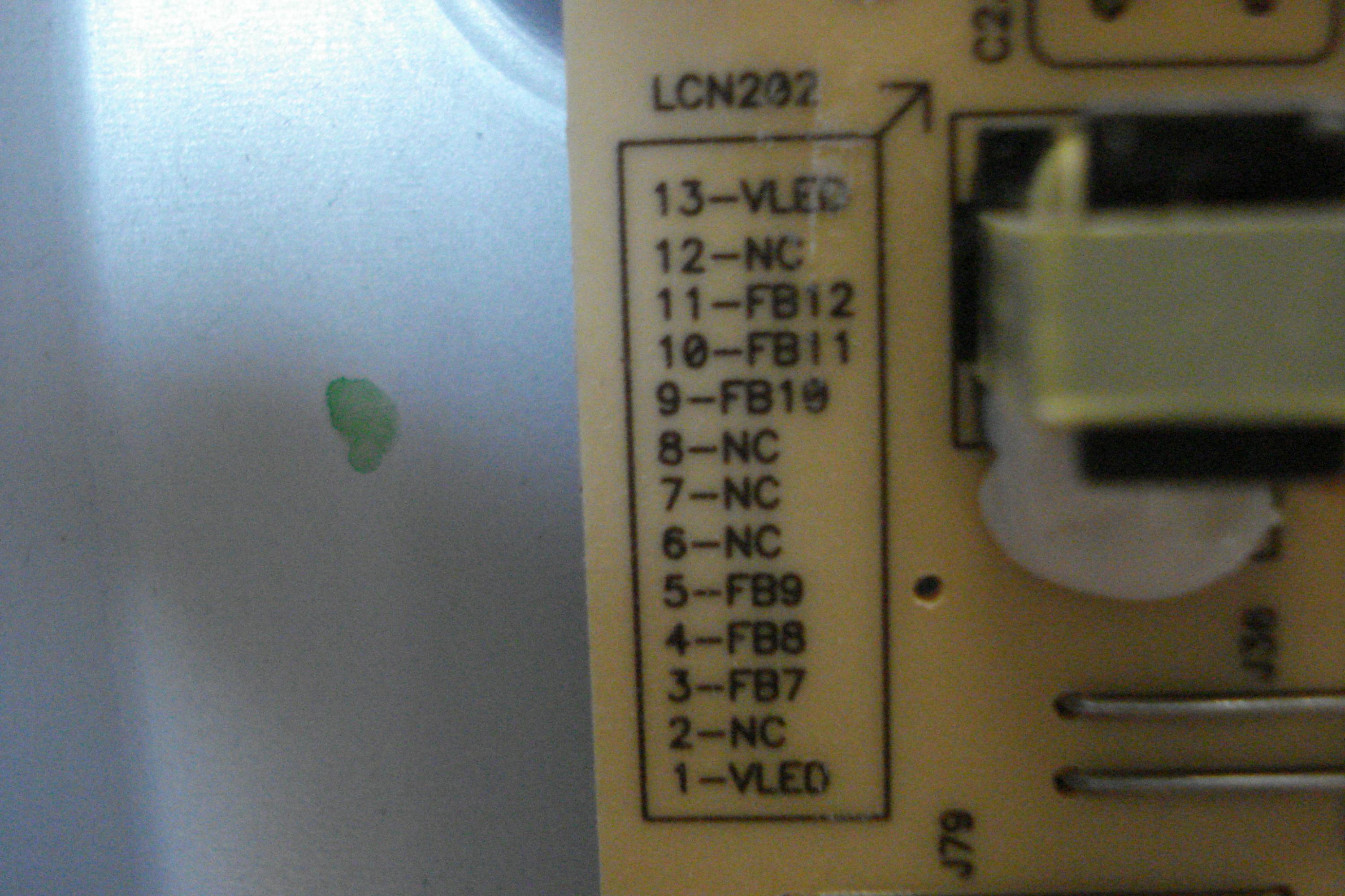

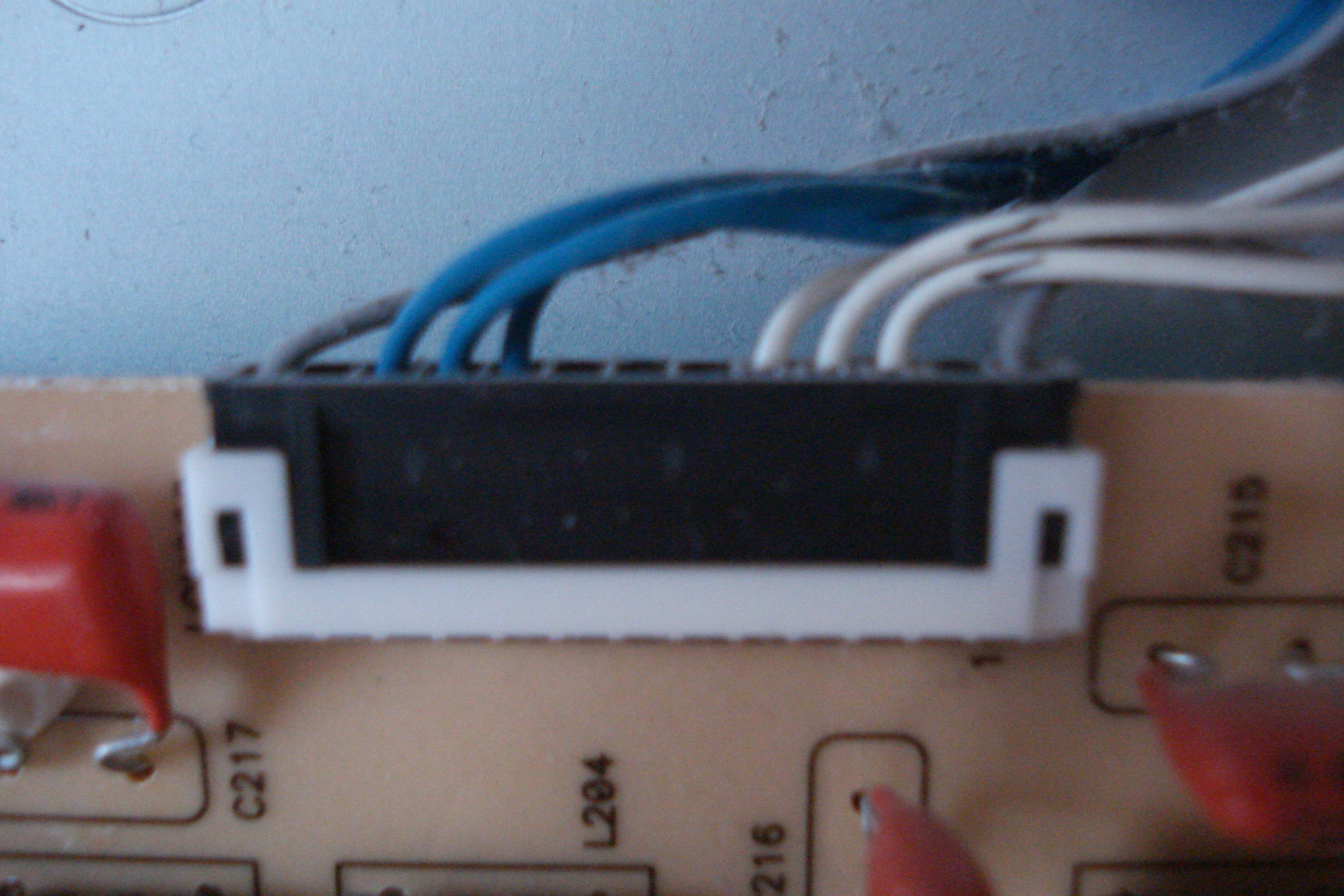

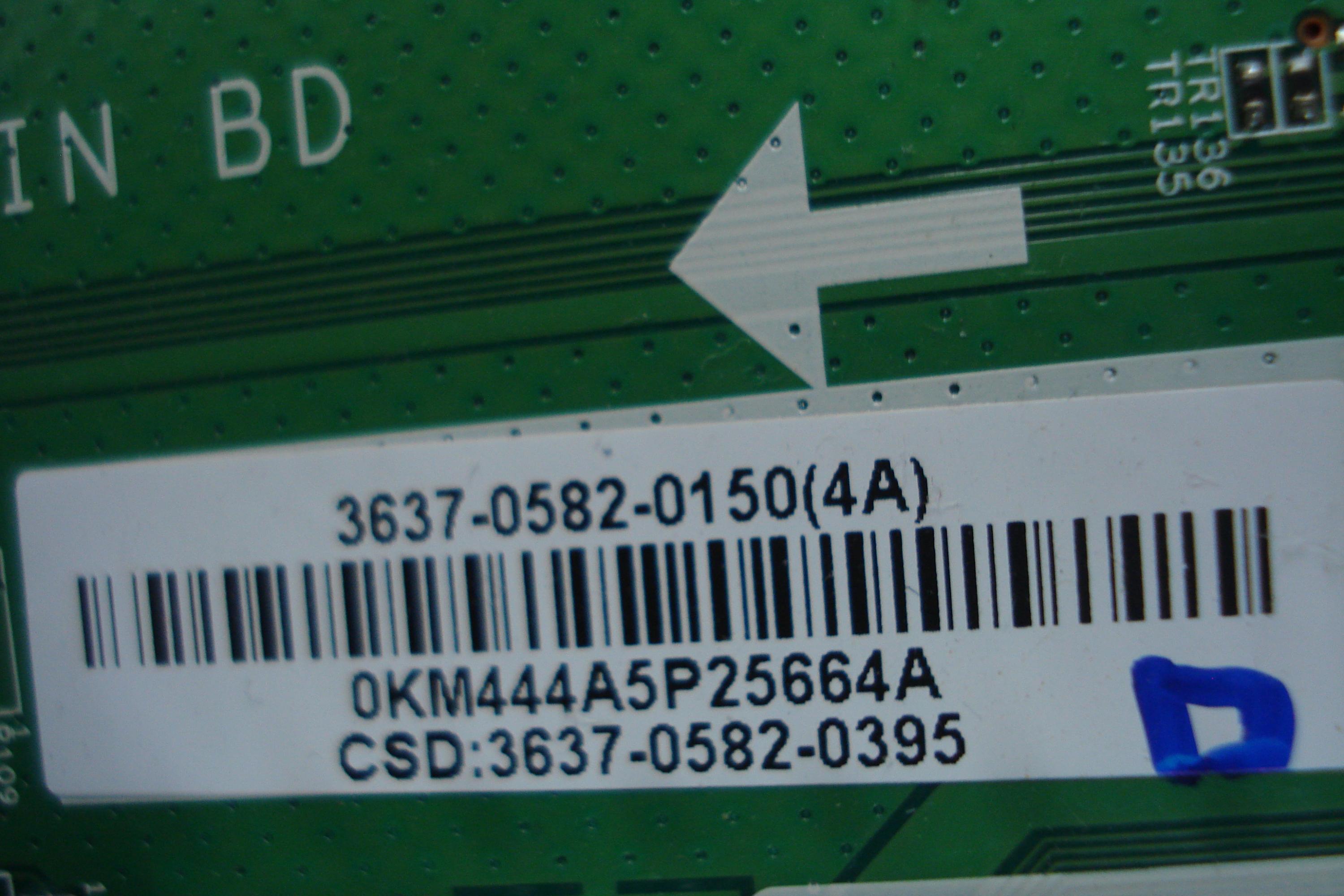

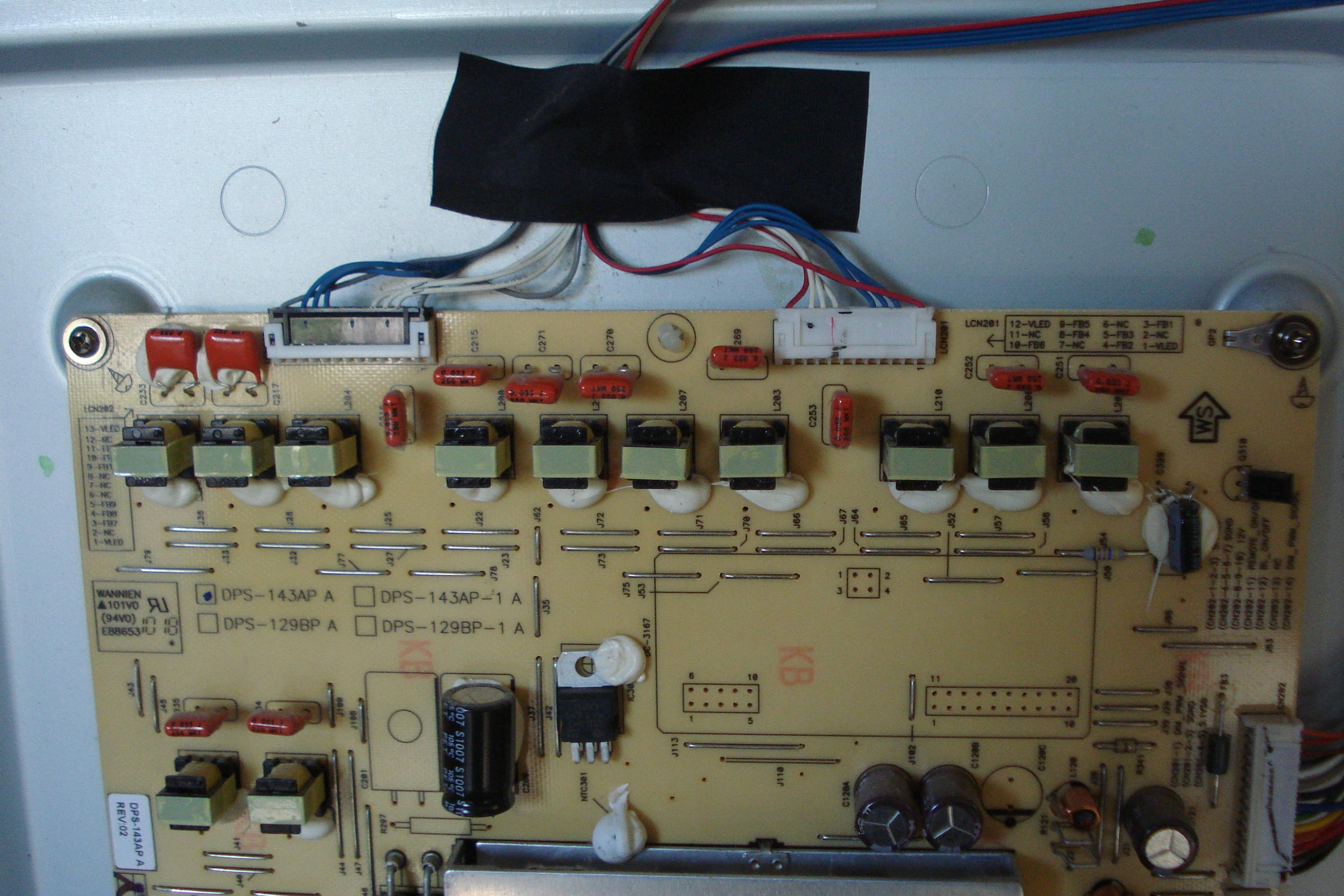

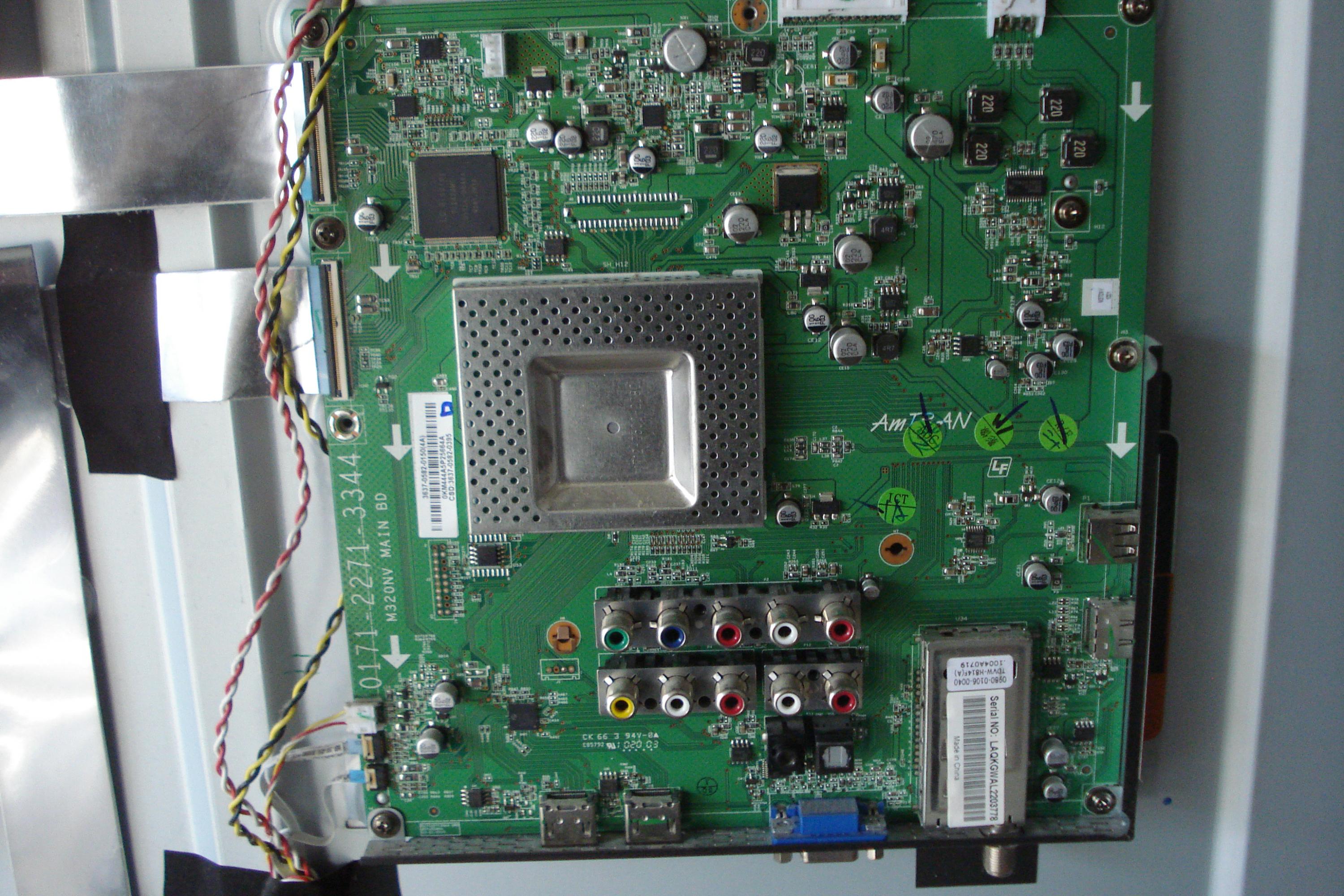

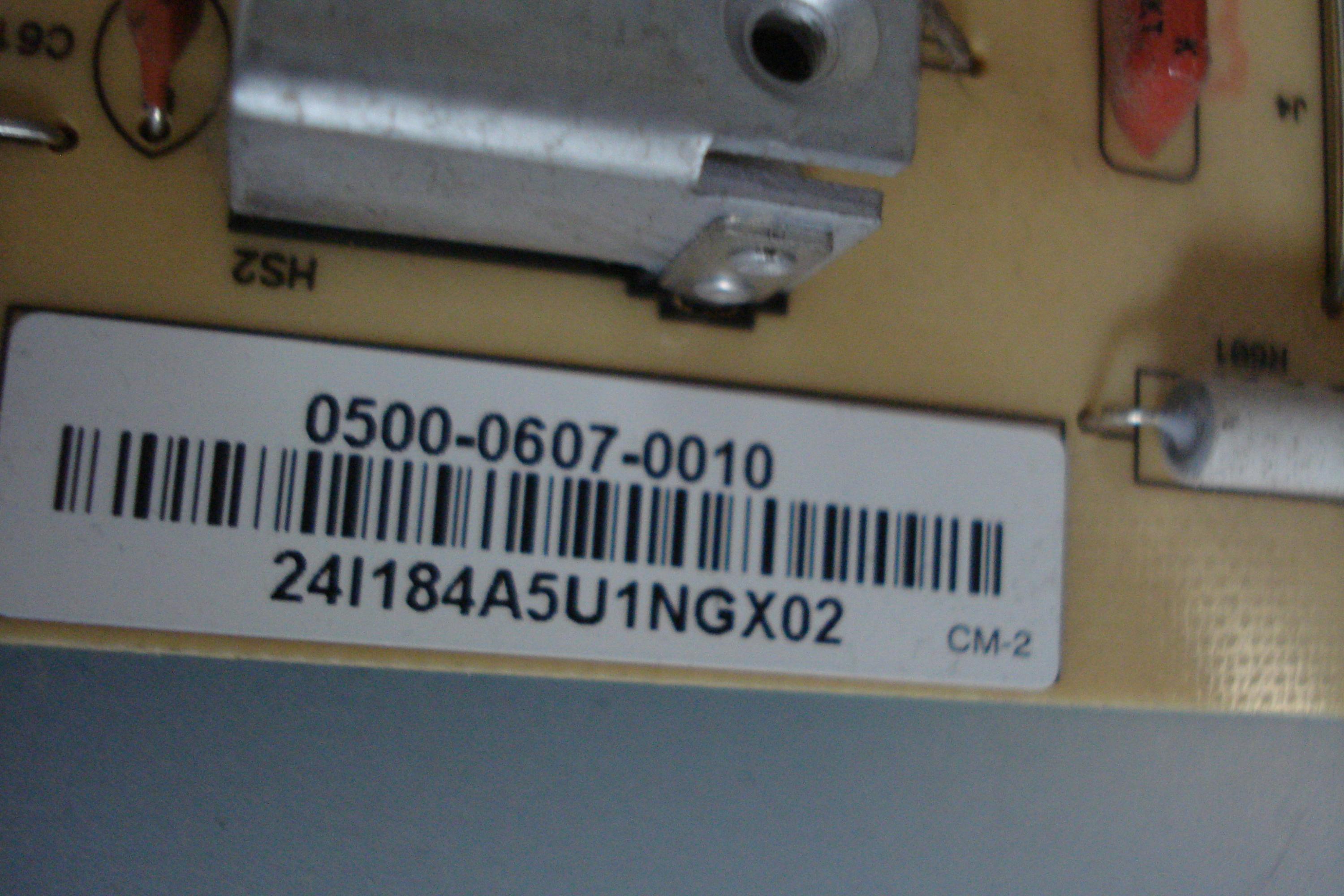

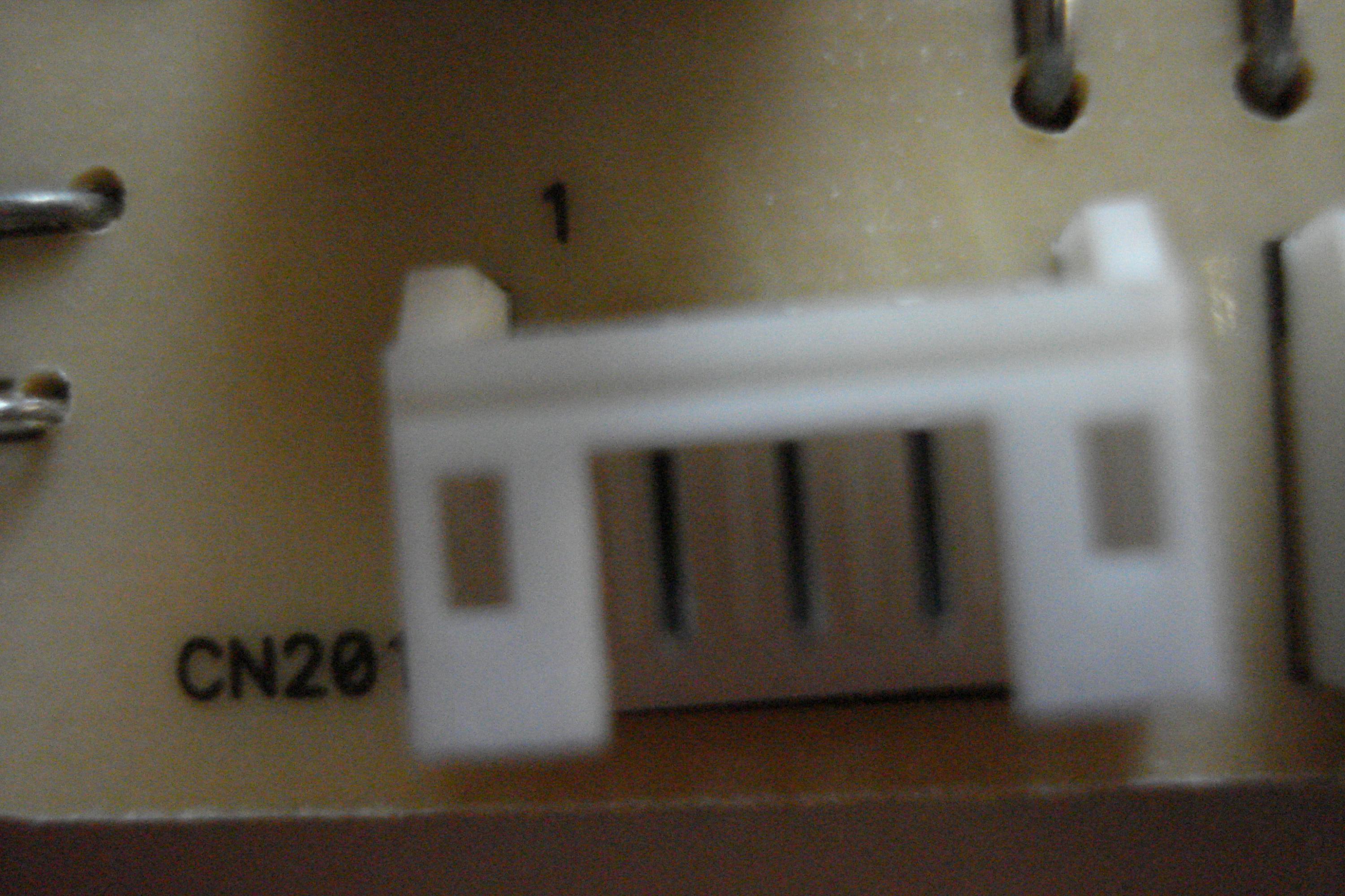

            Re: Vizio M370NV Powers on for 2 seconds then shuts down
            This camera is not very high quality but here are some pictures

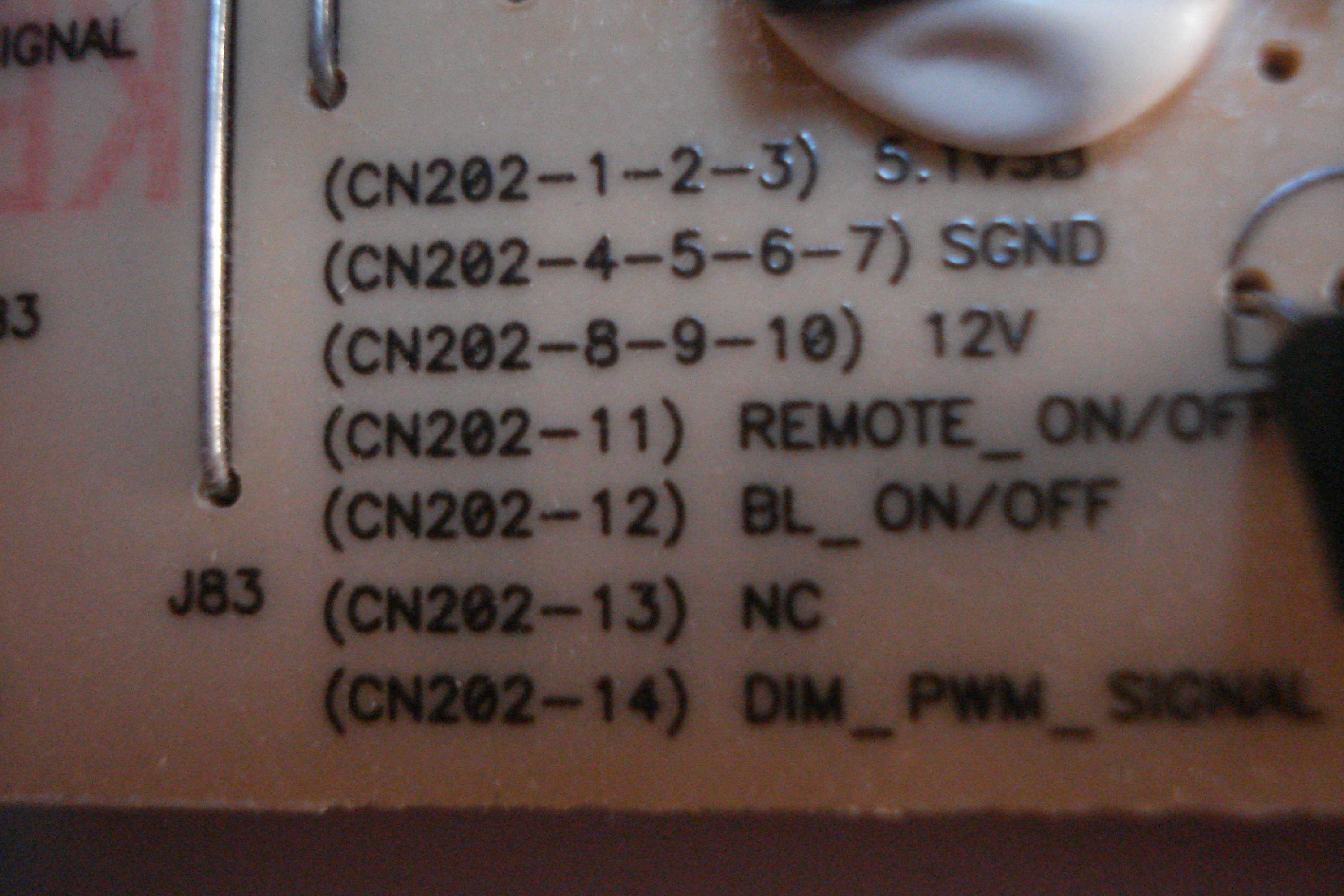

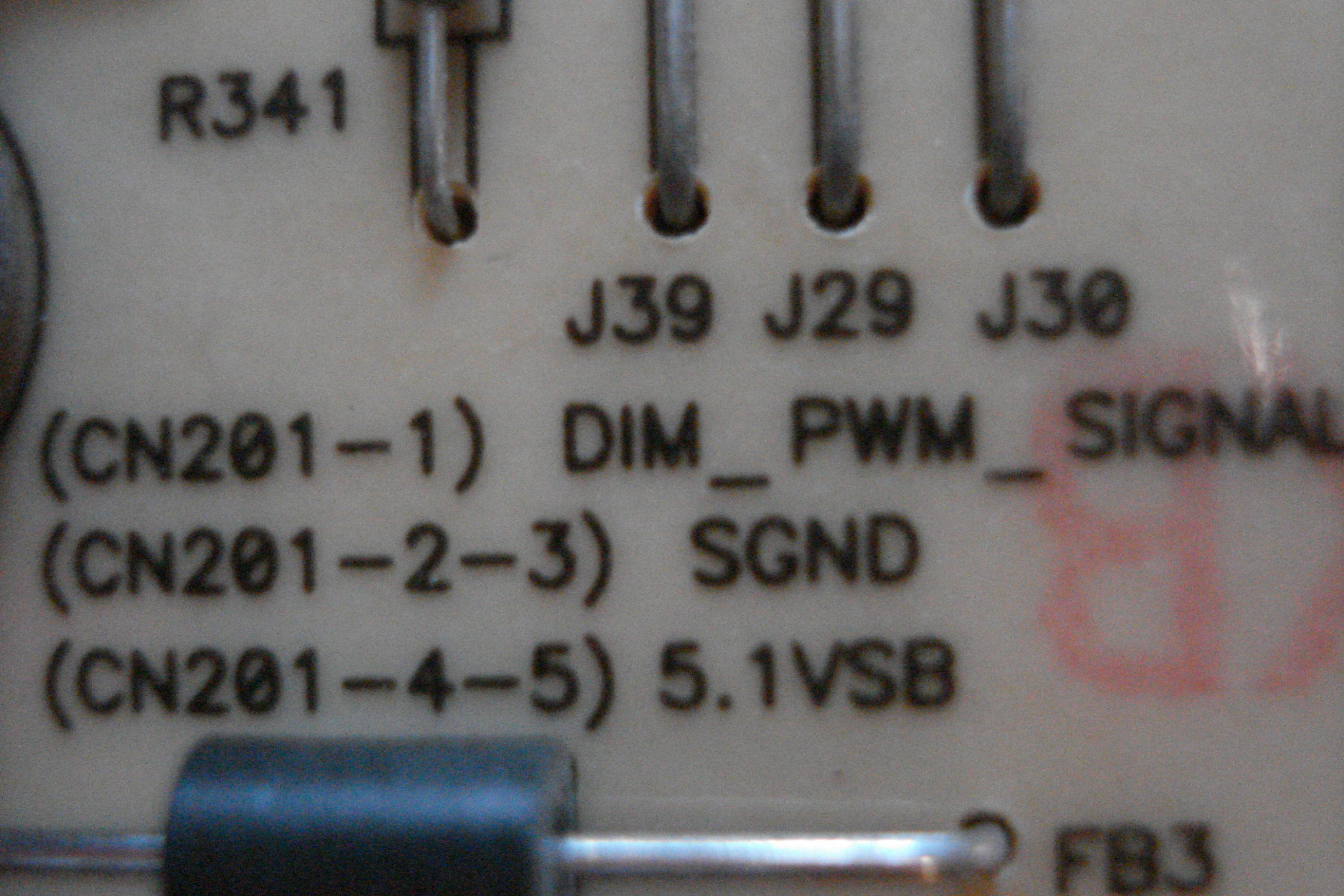

                Your isolation transformer/with switched output, won't help, this power supply is universal input 100~240vac input and it will have no real effect on the power supply voltages.
                You should be able to check the power supply/backlights by:
                disconnect the cable between main and power supply boards
                using a few 470Ω~1kΩ resistor
                Connect one between 5.1VSB and REMOTE_ON/OFF (this should turn on the power supply)
                Connect one between 5.1VSB and BL_ON/OFF (this should turn on the backlight but may need dim signal)
                Connect one between 5.1VSB and DIM_PWM_SIGNAL ( this should turn on the backlight)
                        Check the value of R341 and R327, if their value is over 500Ω you can omit the resistor I suggested and connect the pins direct to the 5.1VS
                        After looking closer at the board, DIM_PWM_SIGNAL may not be used on this model and the backlight should come on with the BL_ON/OFF line.
                        This board uses pulldown resistors so without the main connected the power supply stays in the OFF/standby state

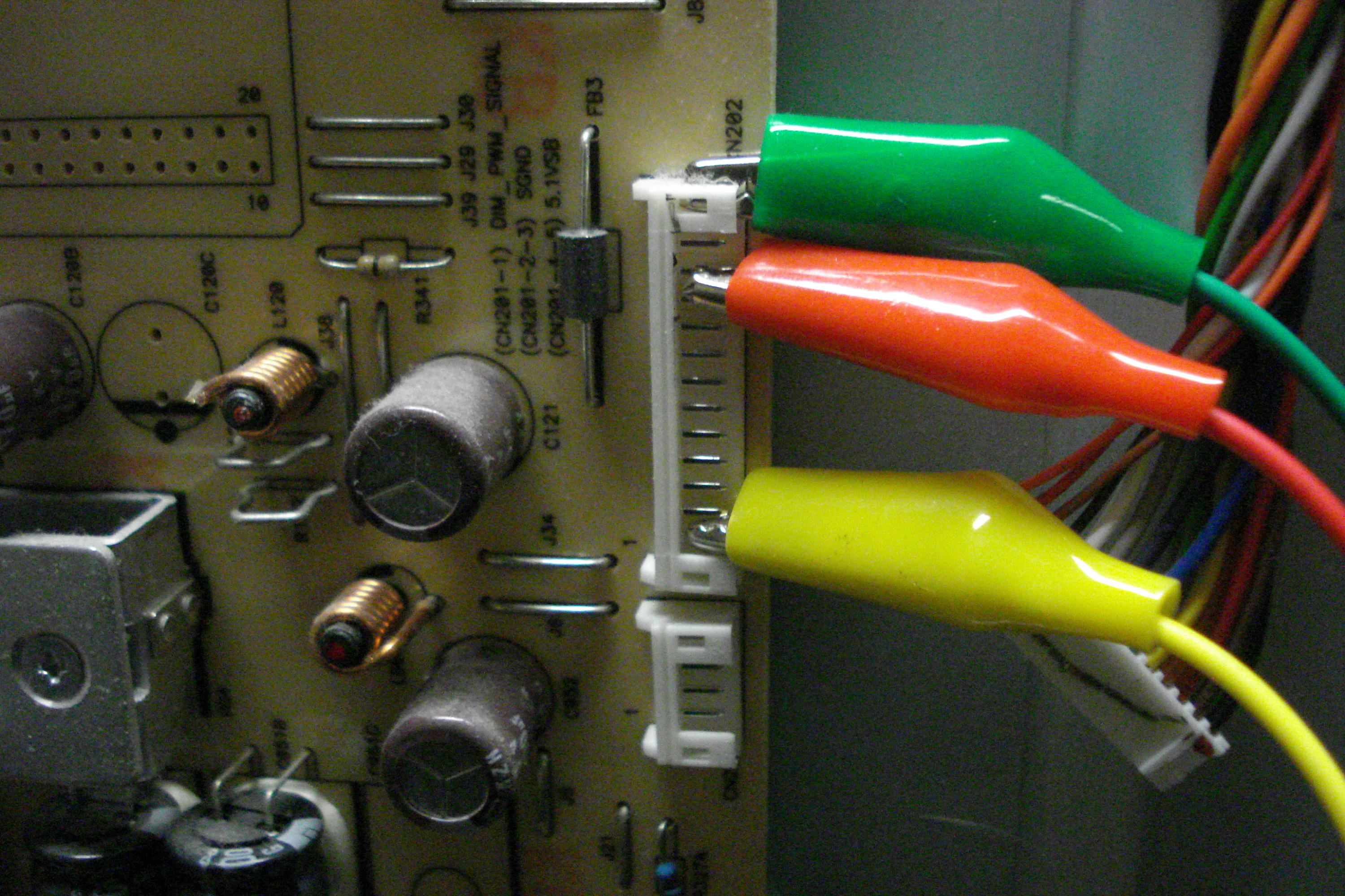

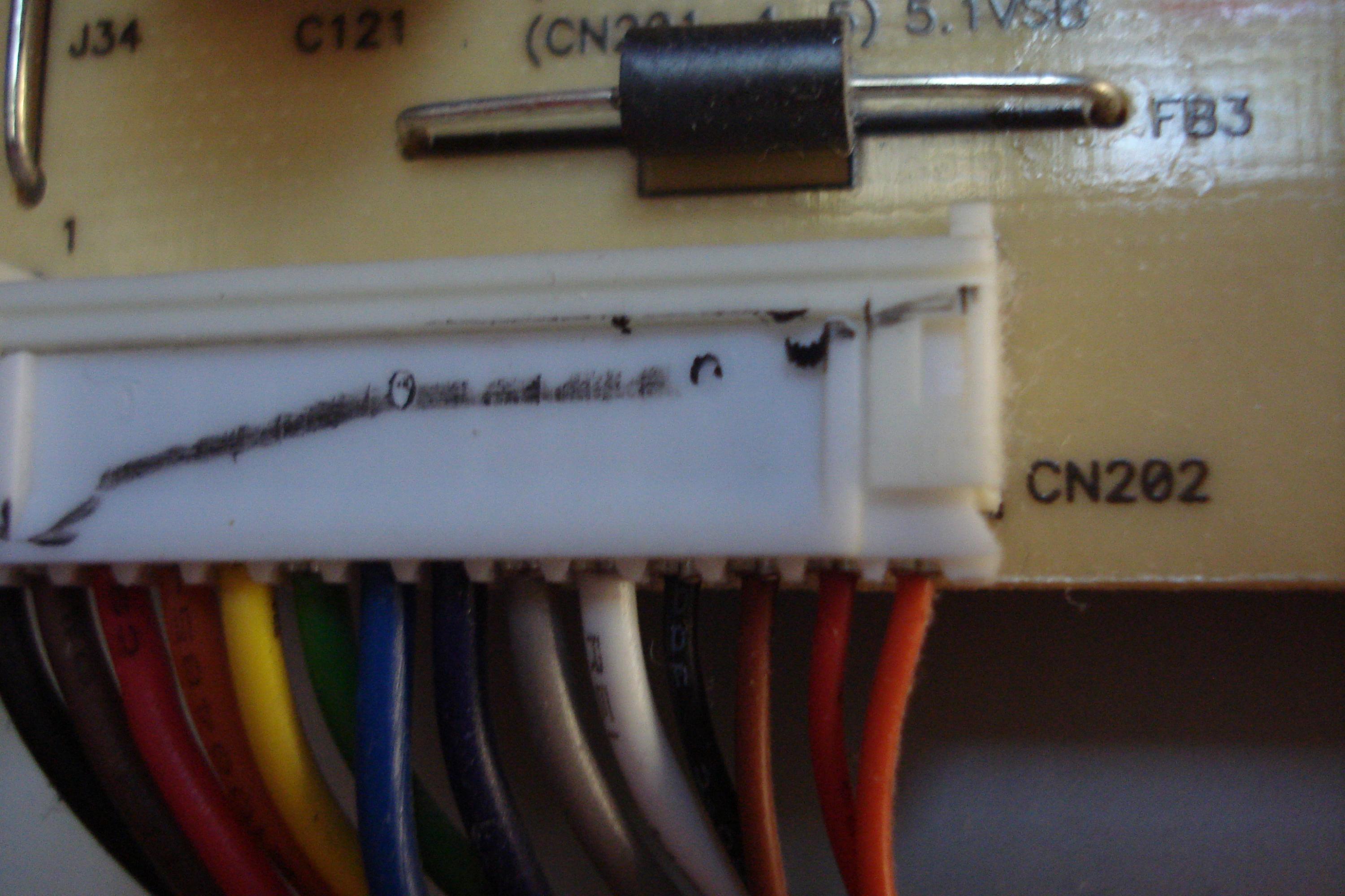

                            Ok, you won't need a resistor between REMOTE_ON/OFF, so connecting CN202 pin 11 to the 5.1VSB directly will be ok, that will turn the power supply on. I'm just not sure about the BL_ON but you may not need a resistor for it either.
                              The reason I always suggest to use the resistors for force on incase you jump the 5.1VSB to the wrong pin.

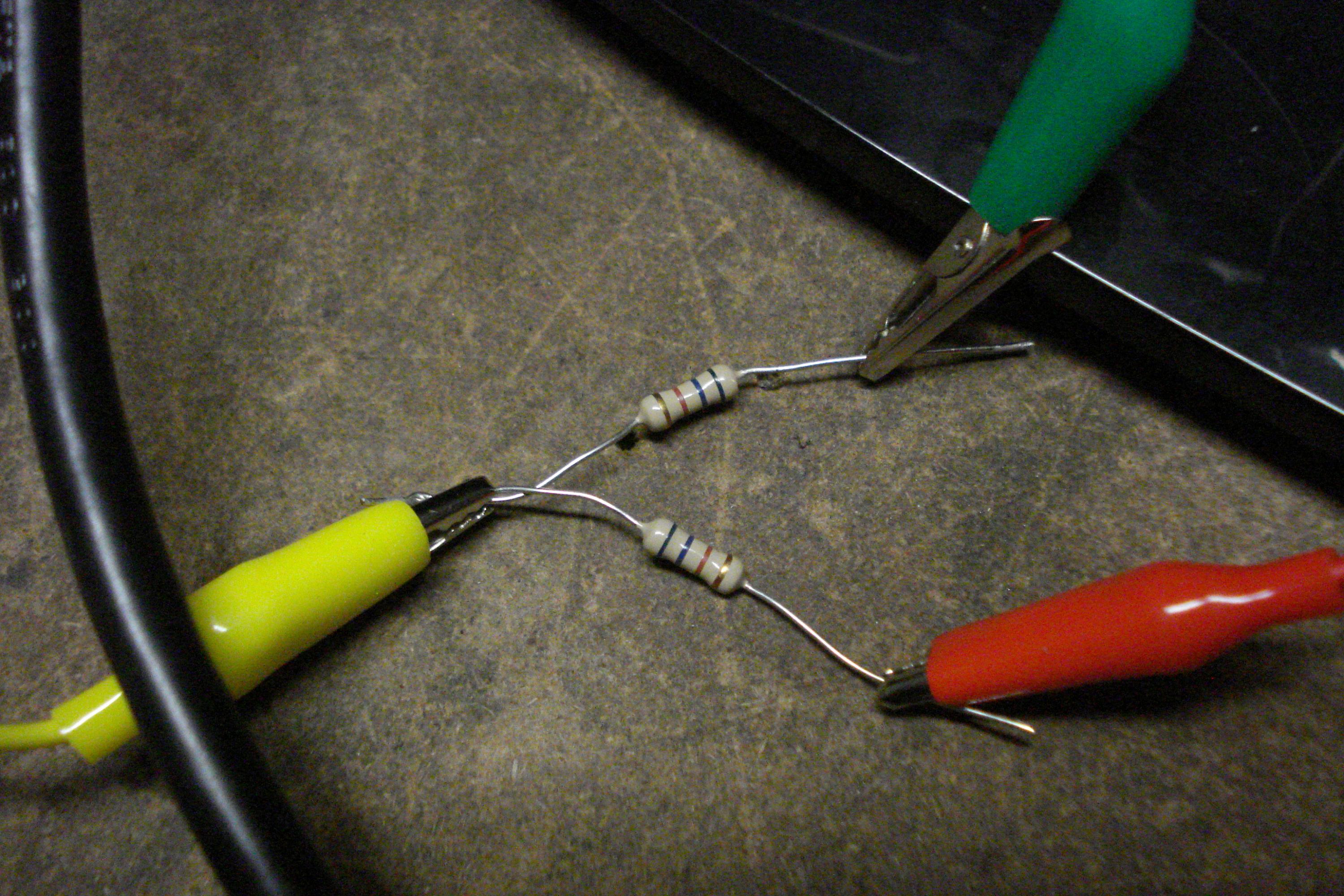

                                I had a 4 pack of 560 ohm resistors, I have connected them with small alligator clip leads and this did force on the power supply and backlights are on now...I did have backlights prior to this test but the tv would power itself back off in about 2 to 3 seconds...now that I have these resistors in place what would be the next step???? I tried to see if all led's are on but it's hard to tell from the back side, but it appears as if they are.
                                • MisterD
                                  • Oct 2012
                                  • 668
                                  Here's how I jumped in the resistors. Yellow 5.1 VSB supply to resistors. red to pins 11 & 12 used one resistor here, and green to touch one side of pin 14 being careful not to touch pin 13.
