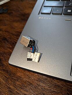

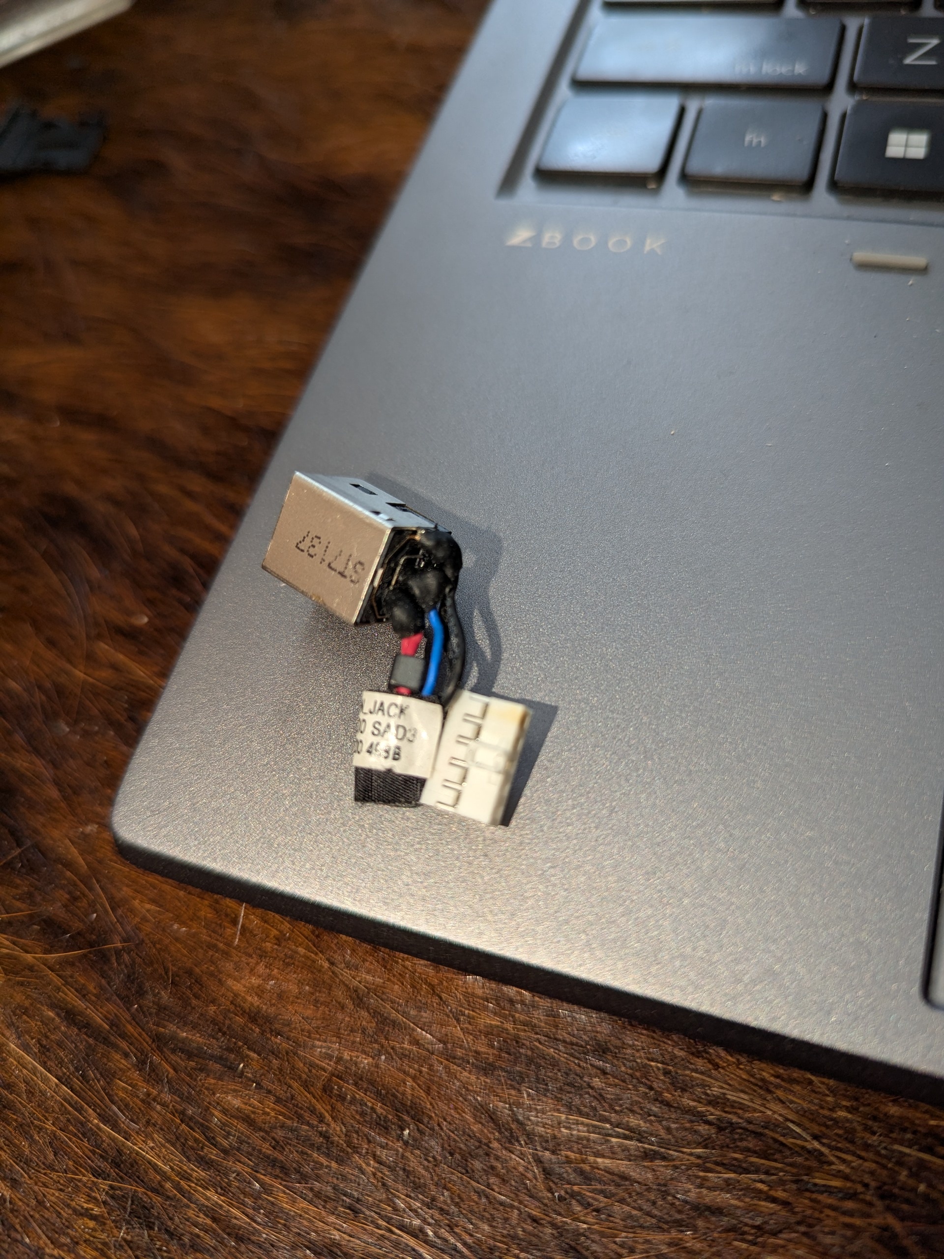

    I have a Dell E5470 that powers up and boots windows no problem. Using a non-standard universal type charger, it shuts down immediately if moved, (power short in that charger or AC power jack) because the battery has no charge and isn't charging orange/white lights blinking on the front. When first powered up, BIOS power alarm stated that it could not detect the voltage setting and I had to dis-able the message to get past this. It got into Windows fine, as long as not moved, so I dis-assembled it looking for a cold solder joint on the power jack that I thought might be lifting off the MB, but discovered it sits in a frame with and has a 5-wire connector BLK-BLK-R-R-B, and although it was securely plugged into the MB, I see what looks like possible burn marks from the two BLK wires near the top of the connector in the photo. D
    Does this look like the type of fry that would cause the symptoms that I'm seeing? What other testing can I do to validate the cable and the battery itself? I don't want to just throw parts at this if I can avoid it. I can use a multimeter...just point me to the test points and the acceptable values. T​he MB inside says it's a ADM70 LA-C631P, REV 1.0(A00) 2015-10-23
    Stop. You MUST use a Dell branded and recommended power rated adapter for this laptop. Check the original specs for the laptop for the power rating. This is mandatory so that you have a working PSID pin which is a 1-wire ID IC inside of the power adapter to identify the proper specs of the adapter. Every Dell requires this security 1-wire ID feature. Only then will the charging work normally. Cannot comment on the Jacob's ladder / skidmarks you are facing till the adapter is a Dell brand. Perhaps available through Amazon. You can always return it if you decide not to keep it.
