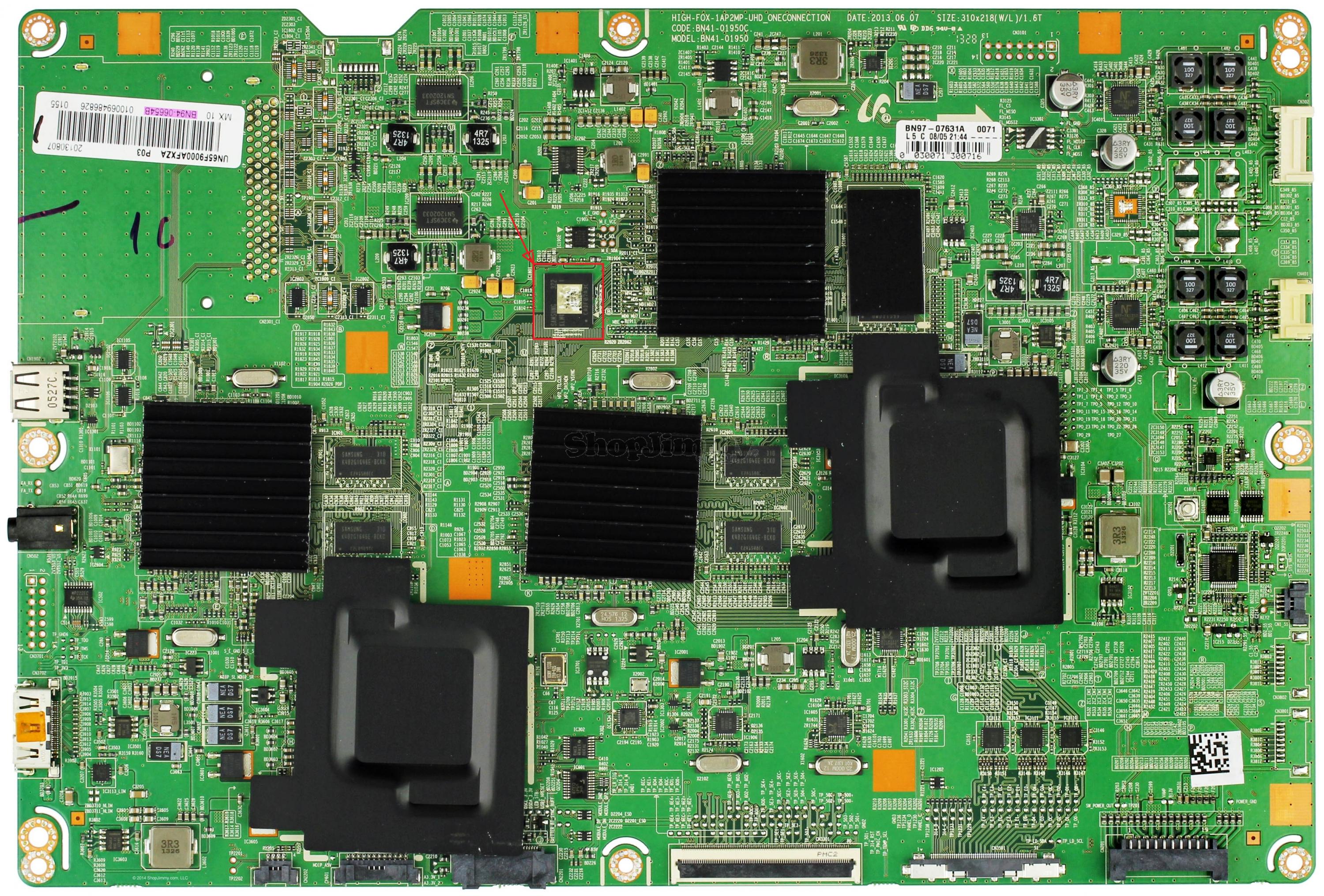

    Hello, I wonder if anyone could shed some light in the repair to the mainboard for this tv please, the mainboard is a bn41-01950c and also has a one connect box, after the apps logo is displayed the tv becomes unresponsive and the red led flashes in the bottom right hand corner of the tv, it then starts again and does the same, if it is this board at fault then does anyone know what the fault is with it
    As I can't find a replacement in the uk.
    Thank you.

    Maybe eeprom. You could try spraying freeze spray on it and see if it comes on. Is a one connect box a tuner? If so try disconnecting it and see if it comes on.

            I had such a problem, rebooting in a circle. the problem was solved by re-rolling nand flash on the programmer. 15 minutes of work.

                  I have a different problem. My TV does not freeze, or lock up, or reboot. The problem with my TV (UN65F9000) is a white screen with yellow/cyan artifacts (with or without the One Connect device attached) and no functionality whatsoever.
                  See the link to the thread below:
                  https://www.badcaps.net/forum/showthread.php?t=63109
                  The solution is Mainboard replacement or repair (specific part number is BN94-06654B. Board markings are BN41-01950C, BN97-07631A. Your numbers may be different).
                  I am still trying to resolve the issue for my problem as of today's date. However, if your TV has a problem with freezing, or lock ups, or reboots, then your solution is also Mainboard replacement or repair, but you may be able to reprogram a new Nand flash or EEPROM chip as indicated by CDRW in his earlier post.
                  CDRW: Can you please let us know which specific IC you replaced or reprogrammed?

                      I successfully repaired my UN65F9000 TV with working mainboard replacement (TV was stuck on was white screen with cyan/yellow artifacts)
                      I plan to repair the old board when I can. I strongly suspect embedded eMMC memory IC1801 as highlighted in the image I attached below. eMMC = "embedded Multi-Media Controller" with flash memory and a flash memory controller integrated on the same silicon die.
                      IC1801 may be corrupted from a bad update? or like other garbage EEPROM designs, maybe deteriorated internally which is causing the inability to read or write program contents.
                      If I can read the contents of the eMMC chip from my working board, and re-program to a new chip for my faulty board, I think I can repair it... But I have no idea how to read/re-program the IC.
