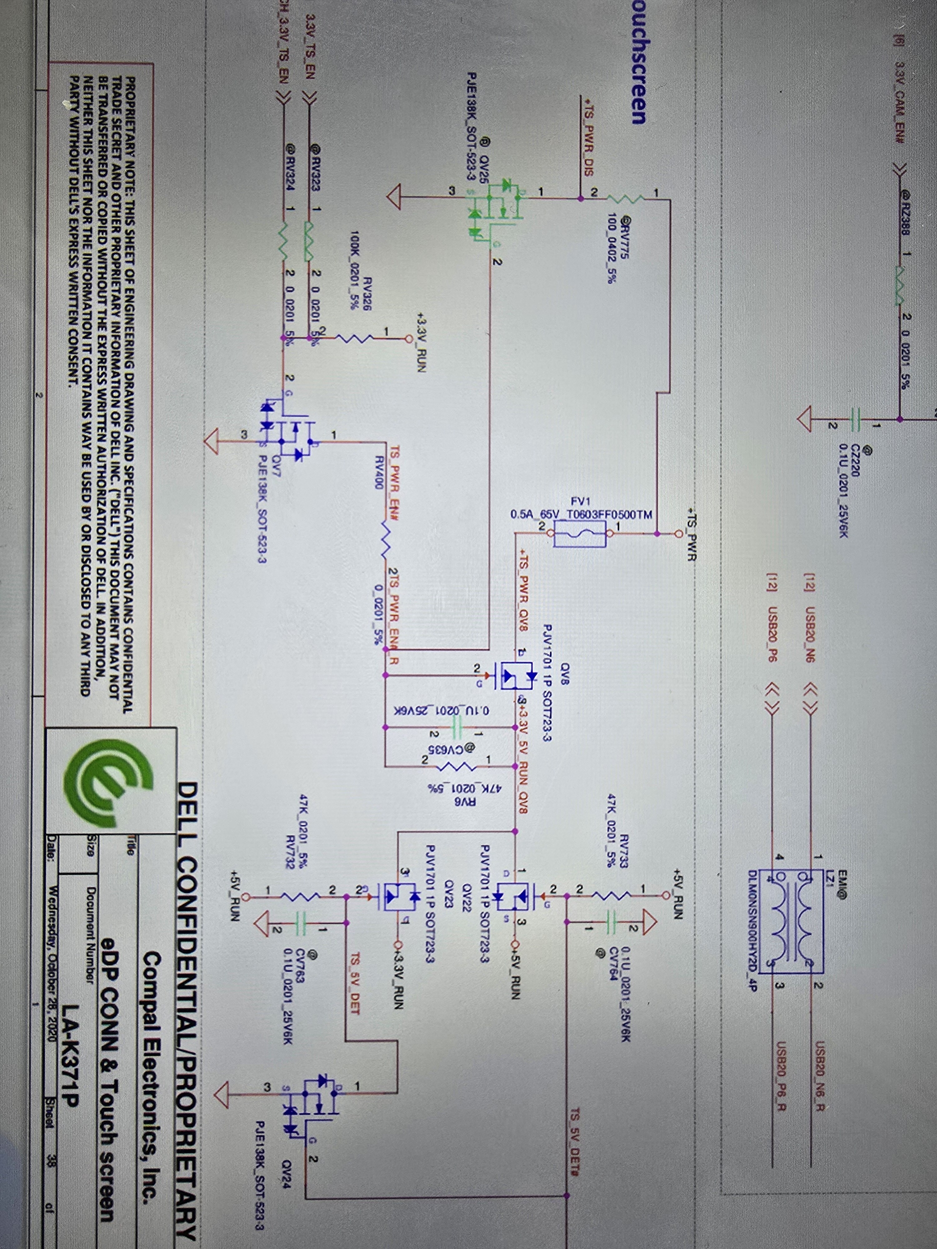

              The mainboard has multiple connectors for everything in the screen lid. A "normal" display connector, a touch connector and two more for IR, camera, microphone and gyro stuff. As far as I could read from schematics: there are a few touchscreen related pins on the display connector itself. But there begins my struggle: how can I trace them?
              The display connector looks super complicated and I don't know where to start with "counting" pins.
              Are only the pins in the middle relevant? Or are there more (in the metal frame around?)
              Is there a spec from this kind of connector available?
              Or do you have other recommendations, where I should start?
              Klicke auf die Grafik f?r eine vergr??erte Ansicht  Name: image.png Ansichten: 0 Gr??e: 130,8 KB ID: 3604652
              EDIT: I already checked the resistors, which are pulling the signals for touch.​

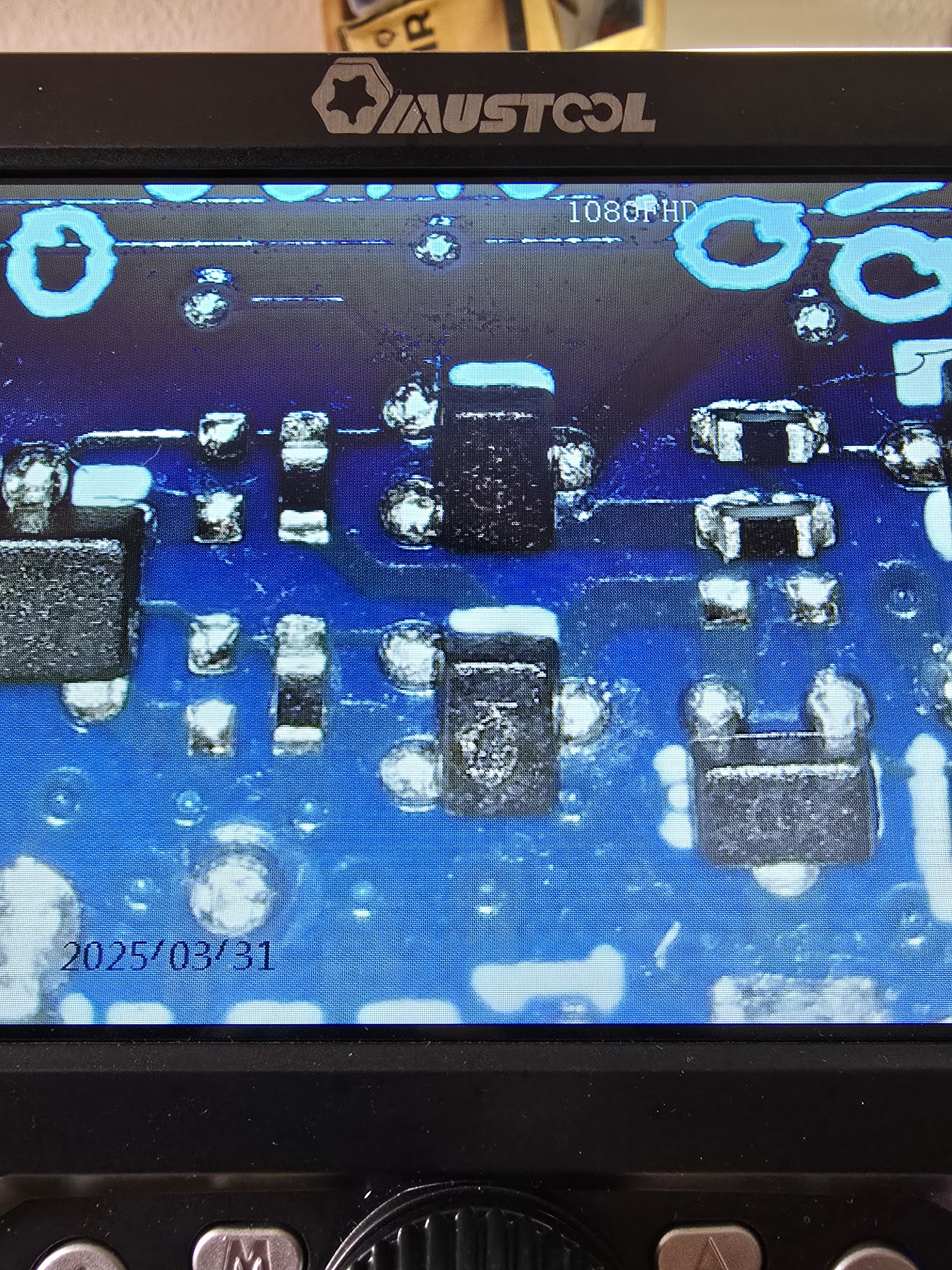

                  Maybe I found the culprit(s)...
                  QV22 seems to have emitted magical smoke. QV23 also looks like it has a burned bump.
                  In schematics they're responsible for Touchscreen power.
                  Does anyone know, what TS_5v_Det could means?
                  Detection if it is a 5V Touchscreen or a 5V rail, which detects if a touchscreen is connected?

                    Good news:
                    i replaced qv22 and qv23 with help of my other defective board and touchscreen is finally working!!!!
