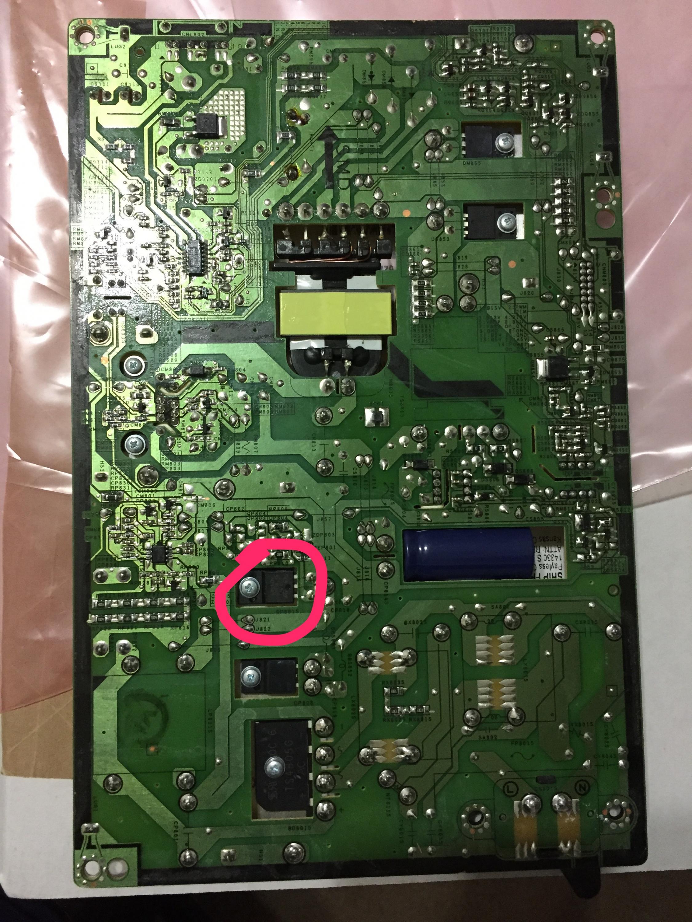

                          Re: Samsung UN40ES6100, Power supply issue
                          Originally posted by crabn
                          Hi Everyone,
                          I got a non-working Samsung TV UN40ES6100. It does not have any power including standby light.
                          There is several with power supply:
                          1) Fuse nearby AC inlet blown
                          2) Diode DQ851 shorted
                          3) One of the MOSFETs (Part No: 13NM60N) cracked
                          Then I got a replacement working power supply. It was working fine for a few hours. I tried to turn it on next day. It won't turn on any more. There is standby light. Here are some measurements:
                          1) Voltage at Fuse: 50 V AC
                          2) Voltage at C9110 and C9111: not stable 191V
                          3) Diode DQ851 got shorted again
                          4) Unplug cable from PSU to mainboard: backlight keeps flashing on and off.
                          My question is what cause the DQ851 being shorted?
                          Any other comments are welcome.
                          Thanks.
                          I checked the board and found no bad soldering.
                          So I went back to the old board and replaced shorted fuse and cracked MOSFET (Part No: 13NM60N). It is working now. Except wifi does not work, hardwire is working.
                          My question is how to test the MOSFET mentioned above? I would want to check if this MOSFET on new board is working or not.
                          Thanks.
                            #33
                            That MOSFET is for the PFC Voltage booster, common failure mode for that one is shorts and it will cause the main fuse to blow.
                            I just do not have the time to trace out the standby power supply section yet, it is not easy, very time consuming.

                              #34
                              "I went back to the old board and replaced shorted fuse and cracked MOSFET (Part No: 13NM60N). It is working now"
                              If you learn to spend a little time searching for faults on boards, you don't have to mess with used boards, remember i read many threads on forums and that there are many situation when the user, not so expert, go to sell boards without be able to test them, and in critical situation, so if you buy from a unknown or a private do many question before buy. I would return the psu back and fuck off further inspections..
