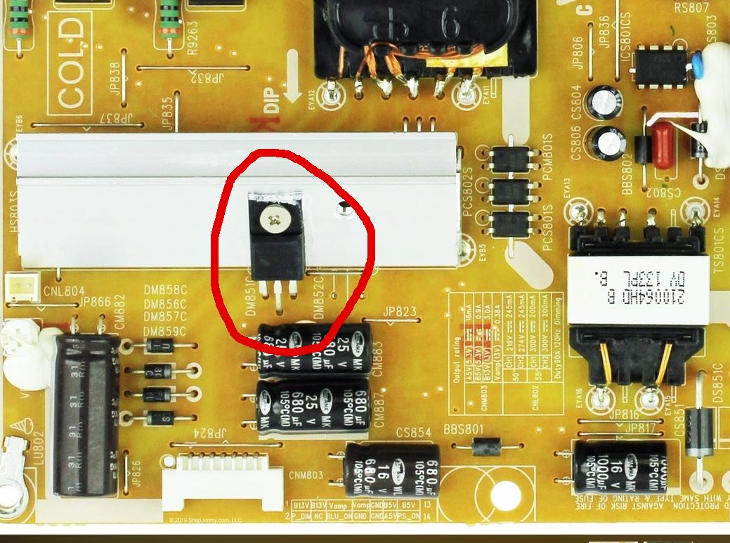

    Samsung Bn4400612b Power Supply issue on Samsung UN50F6300
    Samsung Bn4400612b Power Supply issue takes out a new 5A fuse on my Samsung UN50F6300, without any the BL or main board cables connected. Please advise if this board has known issues and fixes. There are no evident fried components and the caps look ok. Nothing unusal on the bottom side of the board under magnification. Is the ICM801CS under that heat sink a known issue? SJ (https://www.shopjimmy.com/samsung-bn...-1473373576096) out of stock, so component level repair may be my best shot. Thanks.

    Re: Samsung Bn4400612b Power Supply issue on Samsung UN50F6300
    Fuses typically blow due to shorted FETs or power diodes. I would check the ones mounted on heatsink which is probably the switching FET for the PFC circuit. The short can be measured with your multimeter. If a FET is shorted, it introduces unexpected high voltages to the gate side of the FET and can damage components in that section as well.

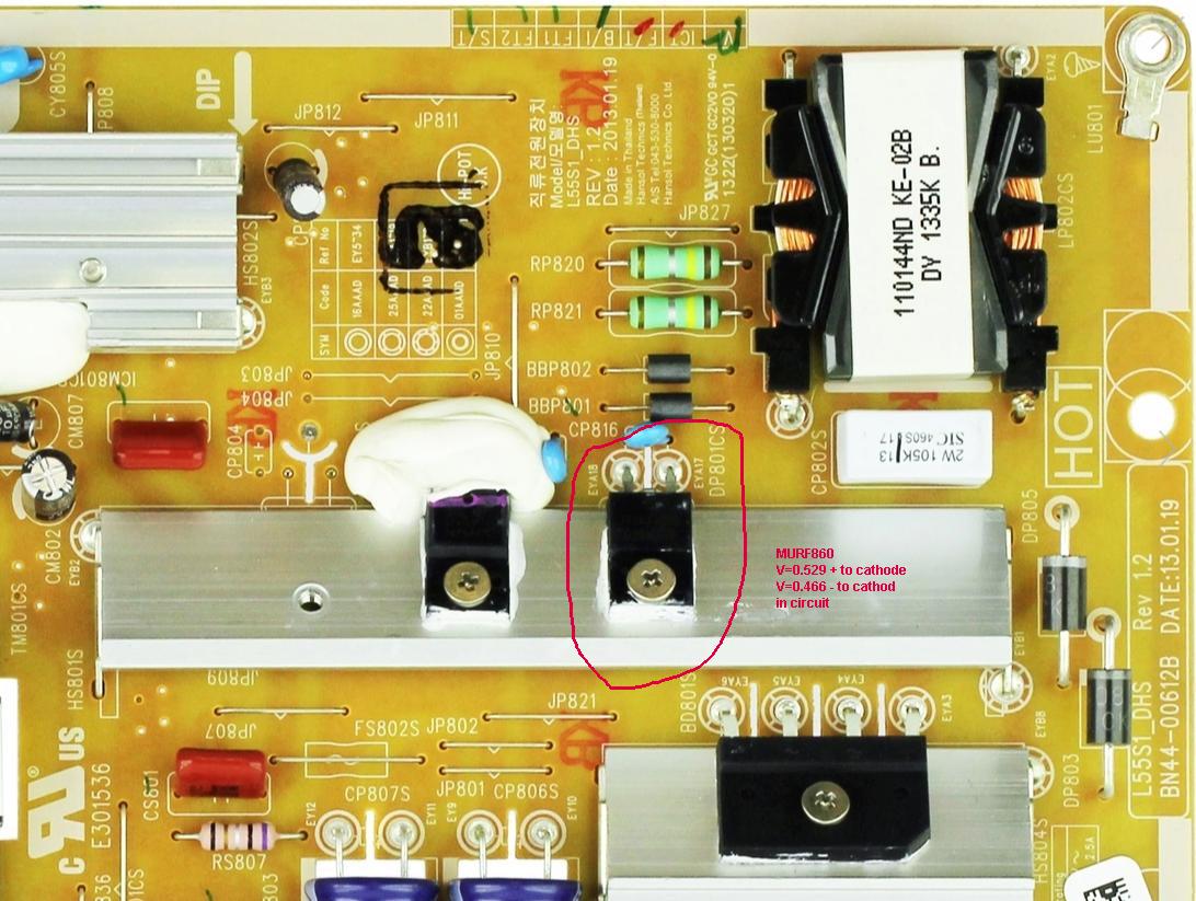

      Check for a shorted VX801s mov, then check for a shorted BD801s bridge rectifier, check the pfc mosfet (and small blue disc cap)then check for a shorted icm801cs Check pins 1 to 10 and 6 to 10.
        IF the only thing bad was this MURF860, would this always cause the fuse to blow as soon as power was applied?

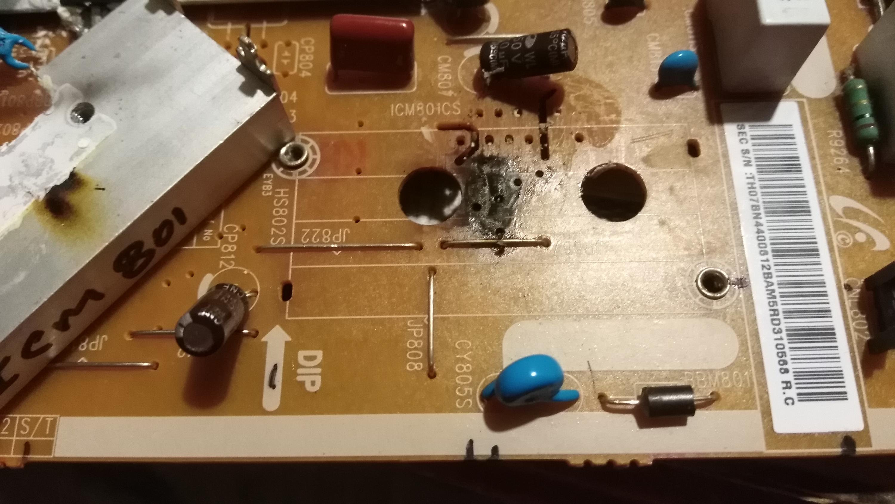

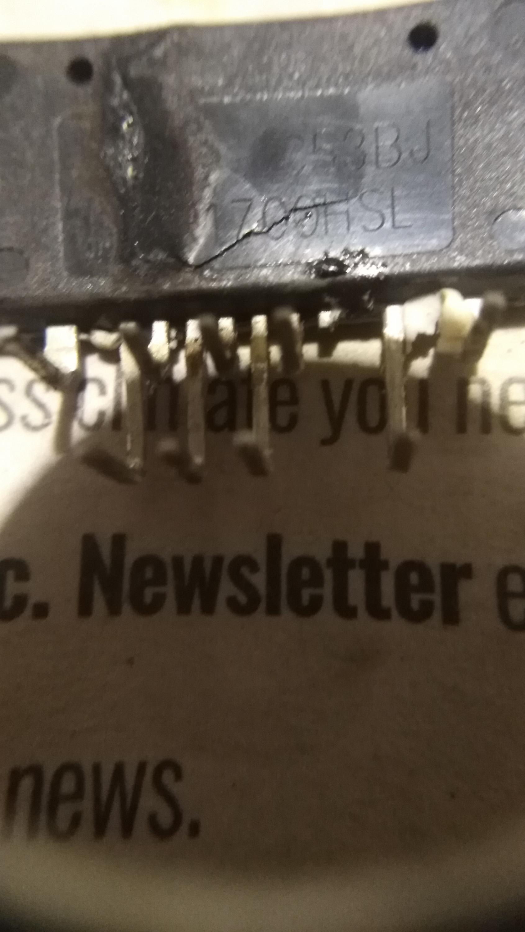

                So, I lied. Well not exactly, there were no burnt or physically damaged components that I could see. Turns out the ICM801CS has LOTS of damage. It was hiding under its heat sink. After digging all the silicone rubber off and testing shorts, 8 of the nine pins were shorted. Since this is a Fairchild FSFR1700HSL which is no longer manufacturered and Mouser and DigiKey has no stock, I turned to ebay and aliexpress. Seems the FSFR1700HSL is 3 times the price of the FSFR1700XSL. And since I am nothing more than a hack, I am struggling to determine whether they are interchangeable? Another issue for thought is if that blew...see pics...what else is likely to go down with it?
                  I see a difference between the HS and XS with pin 2. I would likely go with the FSFR1800HSL About $5.00 from Digikey
                  The 1800 has a lower RDSon but should not be a problem.
                  This ic drives a transformer so check the diodes etc. on the transformer secondary in case something was shorted, but it is likely it was just the ic that went bad.

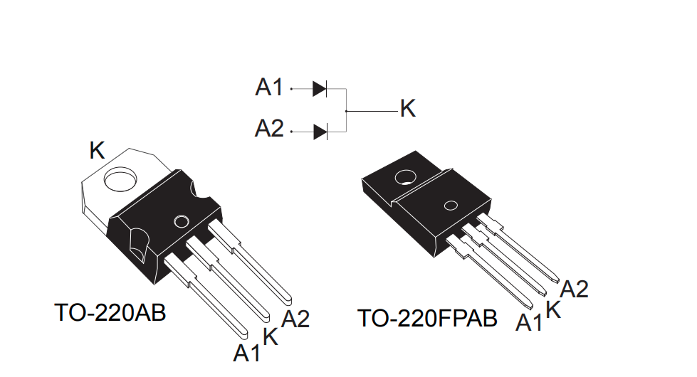

                      Can any one please help me find a substitute for the DM851C = STPS20LCD80C
                        Can any one please help me with instructions to test the DM851C = STPS20LCD80C and then maybe and find a substitute?
                        • lotas
                          • Jan 2016
                          • 4796
                          • Russia
                          It is checked, as usual, the diode, one then the second.
                            So, with it in circuit, multimter on diode mode, positive lead on the center pin, and the negative on each outer pins results in 0.413 on each of the outer leads. Reversing the leads gives 0.216 on each of the outer pins. Leads connected to the outer pins shows continuity.
                            If this means it is bad, this is going to kill my project, because I cannot find a STPS20LCD80C anywhere, not even on Aliexpress. CAn anyone sugest a viable substitute?

                            • lotas
                              • Jan 2016
                              • 4796
                              • Russia
                              t is better to check this diode in a non-circuit, that is, it must be removed from the board and checked.

                                  Update:
                                  I removed the STPS20LCD80C from circuit (thanks lotus) and with the negative black lead in the middle, the outside leads read 0.240 to each. Placing the positive red lead in the middle, there is no continuity to ether of the outside leads, nor between the outside leads.
                                  Therefore, I will reinstall the STPS20LCD80C and the new FSFR1800HSL that I just received today, along with my last 5 amp fuse and hope for the best.....
                                  I was trying to remember the use of the light bulb for the fuse, but for the life of me I cannot find it.
                                  Thanks to all, will report later...

                                  • lotas
                                    • Jan 2016
                                    • 4796
                                    • Russia
                                    You need a Power Schottky rectifier which has a low junction resistance.
                                    Can replace with MBR20100CT
                                      Thanks guys, it's fixed with a $3 part and all YOUR knowledge....not by me😀
