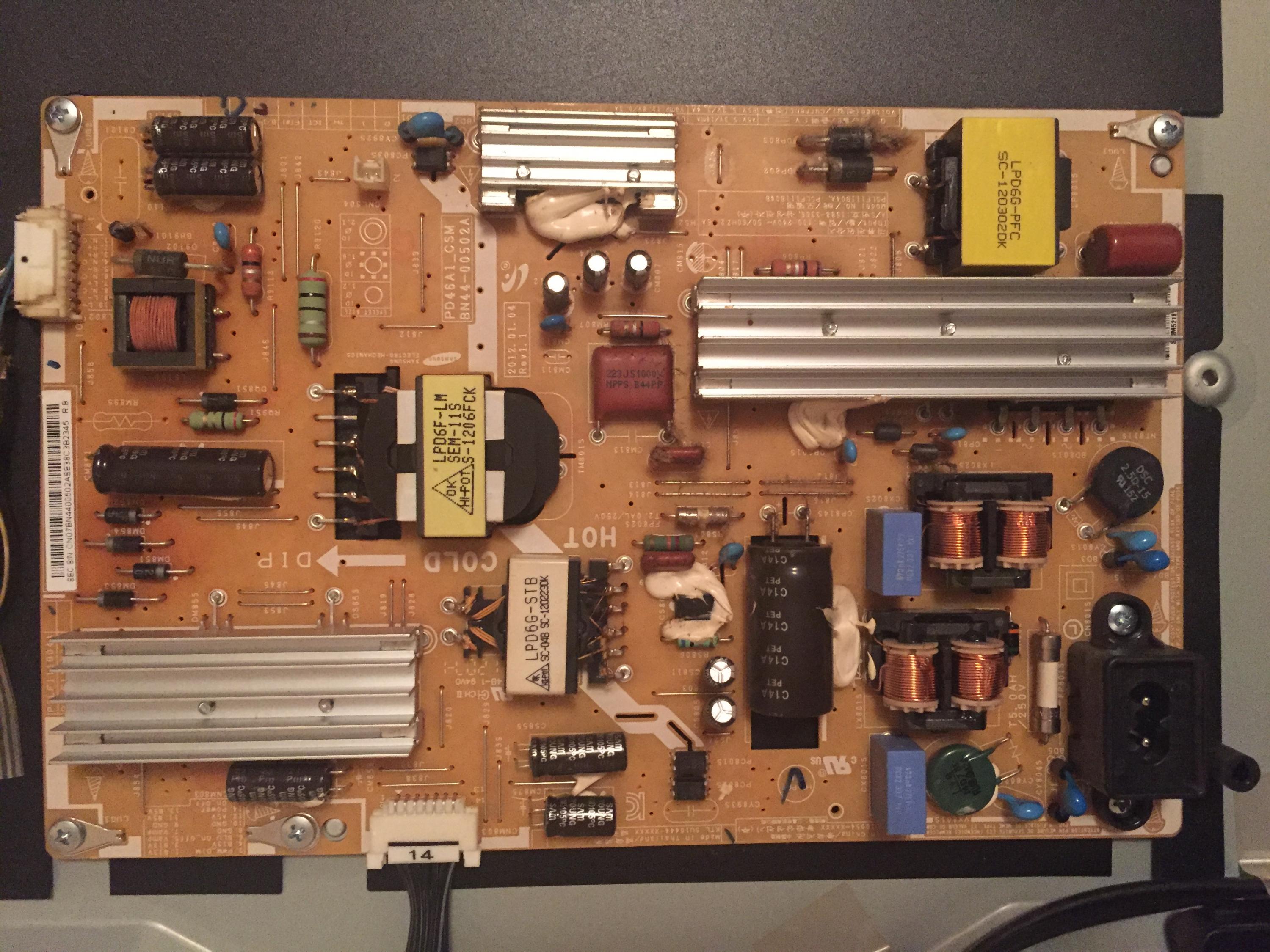

                                  Is there a possibility to see pictures of your PSU not SJ's?

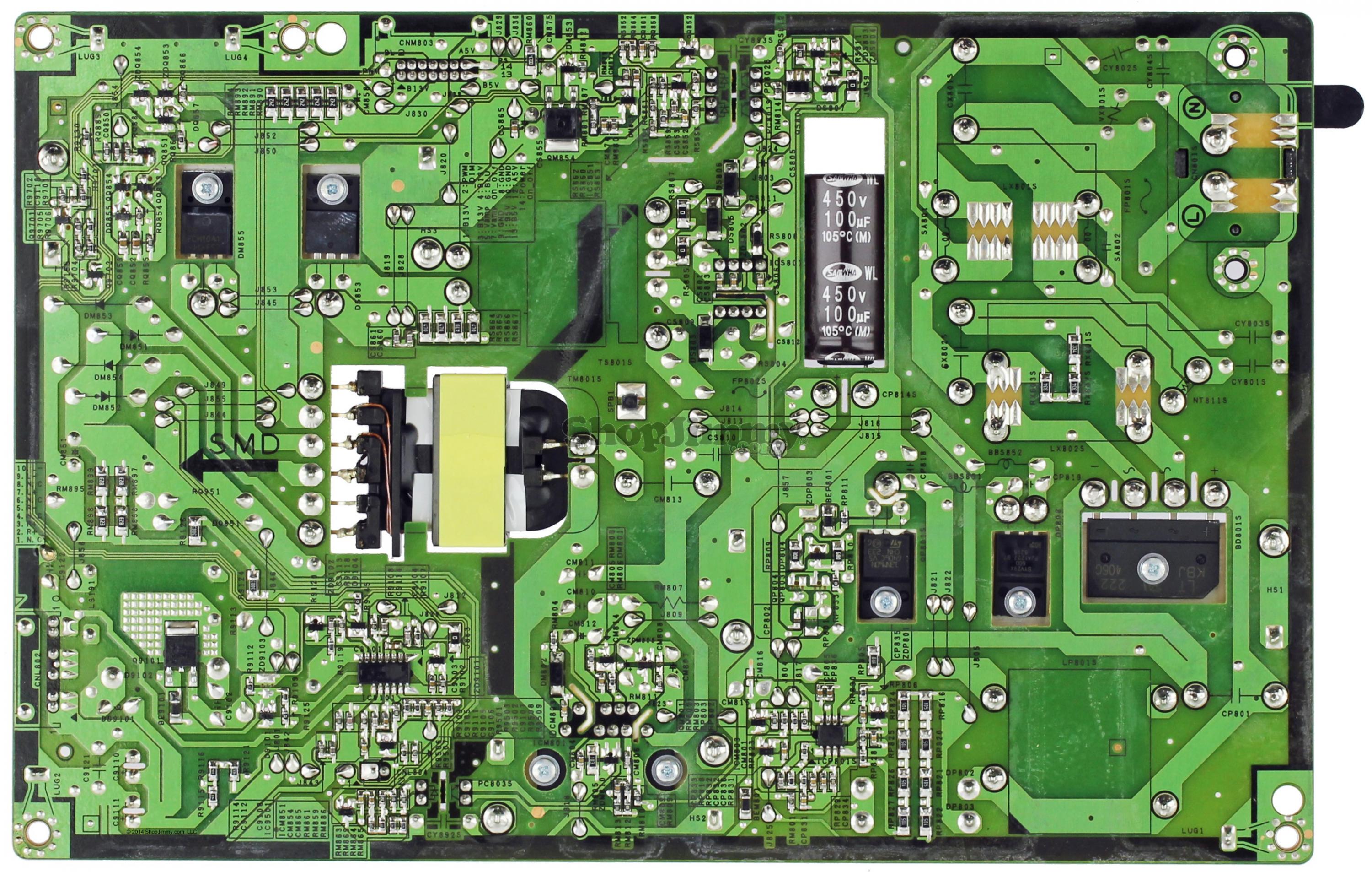

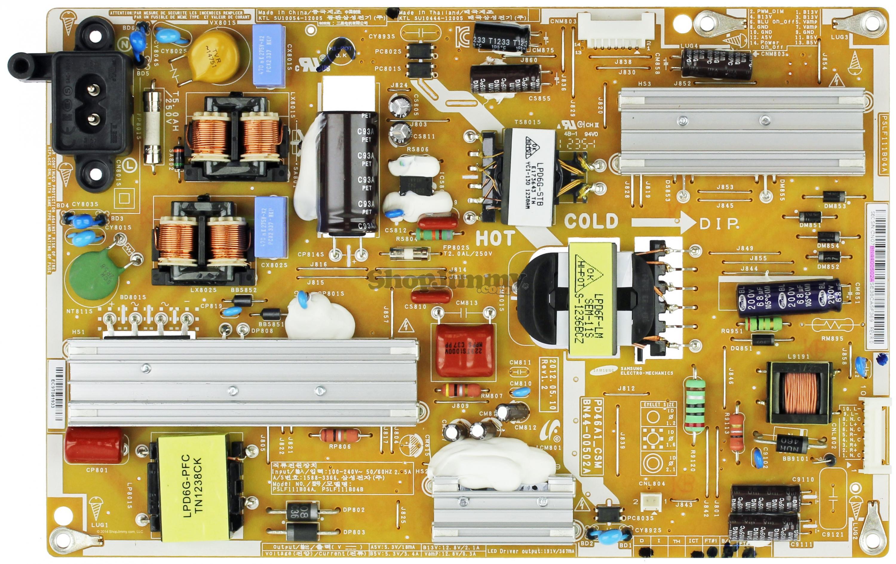

                                    There is no physical damage to any caps
