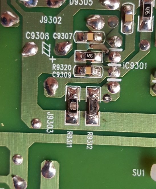

                                Hey Looking for a little bit of help. I am working on fixing my PCB. I have identified my problem as the IC 9301, but there are a couple of resistors near this IC on the back of the board that also fried. They are the two resistors that are tied to pin 1 of IC9301. Unfortunately I haven't been able to find a schematic or even a picture of the back of the board that would show me what value of resistor i need to get to repair it. Does Someone have this info?
                                • Gbars
                                  • Mar 2018

                                  #76
                                  Re: Vizio E500i-B1
                                  Hi guys, I also need values of the resistor at pin 1 of ic9301 (R9311) please help.
                                  • travis7s
                                    • Jun 2018
                                    • 2
                                    #77
                                    Re: Vizio E500i-B1
                                    Also looking for resistors for R9311 and R9312 on my ADTVD3613XA7 board for Vizio m502i-b1. They measure around 48ohms as is right now. A trace to IC9301 also blew up as you can see.
                                    • dick_barton
                                      • Aug 2015
                                      • 6643
                                      • Wales
                                      #78
                                      Re: Vizio E500i-B1
                                      They both look like 1R2 ohms
