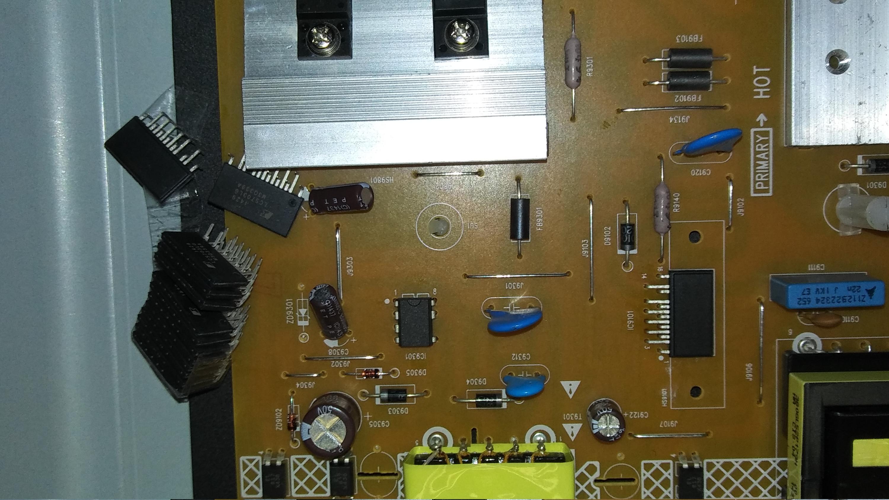

    How in the world did you get the heatsink off!! Solder braid and solder sucker not doing it..!!

      bigger soldering iron / gun. You may also preheat the heat sink with a hair dryer etc.

        Ok..good and bad news... bad news, this didn't fix the power issue..good news , my soldering skills suck. I'm taking the board to a qualified solderer, I'll update if I fubbed the job.

          Hay pal, I took out that IC use this Poorman's T12, it cost me $ 2.22.................

            Alright folks! With magnification at work found solder holes n my work. Fixed those, and BOOM! , TV has been on for 30 mins, I can switch inputs, turn of and on..no problems. Fingers crossed, thanks to CAPWIZARD!! , AKA D MAN! if it stays on all night..it's definitely fixed. I will update

              Edit* BOOOOO!! just turned off. Sorry for the rushed update. Lol

                what turned off? the whole TV or just the back light?

                  Whole tv. No audio. Video, or backlights. Won't turn back on with remote or button .

                    check stby voltage and PSon pin.

                          I do fix it by first change IC9301 then IC9101............
                          PS: I have parts to fix 14 more Vizio E500i-B1 TVs

                            Well.. u shoulda told me wizard! �� Do I need to get another 9101? I replaced it and it worked fine for a while then went out again..

                              Did you change IC9301 (STR-A6069)? you need to do that first !
                              PS: Vizio E500i-B1 80% problems are STR-A6069 only 10 % problems are IC9101....the other 10% is A DOG........

                                Well I didn't do that. But I will now. So, I probably need another 9101, right?

                                  No, You dont need it anymore! order STR-A6069 asap. This will fix your DOG.
