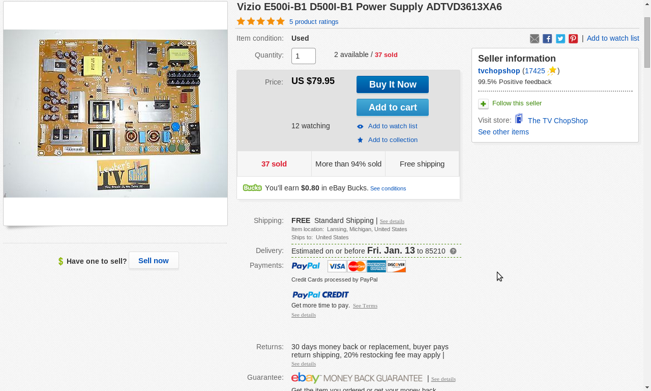

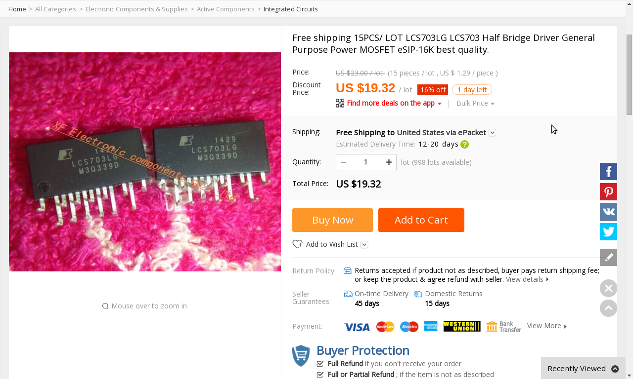

                  Thanks for everyone's help. Will update.
                  I ordered the parts and power supply board at same time, and I offer customer two options, one is the loaner TV, other is their TV plus a can of Dustoff and tiny hole in the back of TV, just for temporary use until parts came. they choice the loaner TV.
                  PS: RTFM means Return To Friendly Motion.....from Old English Dictionary for Gentlemen.

                    Why do you buy ICs from Aliexpress when you can buy them from Mouser?
                    Aliexpress will take 2 weeks, and they maybe fake.
                    -David VanHorn
                    • capwizard
                      • Jun 2016
                      • 1991
                      #30
                      Re: Vizio E500i-B1
                      Power Integrations, they make this parts, Hiper LCS Integrated LLC Controller, High-Voltage Power MOSFETs and Driver, the logo PI..it match with the Aliexpress's picture, it is a monopoly product, not easily, and no profit to counterfeit,
                      https://led-driver.power.com/search/site/LCS700-708/
                      "Aliexpress will take 2 weeks" sometimes took them 1 month to ship here! for cost reduction no choose, same with the quantity, 15 PCS.

                          Re: Vizio E500i-B1
                          Your logic is good, but even when they're the real IC, you still don't know the supply chain. Are they factory seconds? Pre-production samples? The problem with China is that nobody knows, and even if they did, they wouldn't tell you.
                          Do you really want more unknowns when repairing for someone else? Are you willing to risk reputation\returns on saving a few dollars? It's your choice, but I know what mine is.
                          Not to mention the Chinese sellers wrap these things in clingfilm, sellotape, bubblewrap, whatever they get their hands on, and don't give a f**k about ESD protection.
                          I go to real distributors like Farnell\RS-Components\Digikey\Mouser first of all and use the no-name Chinese sellers on Aliexpress\eBay only as a last resort.

                            Re: Vizio E500i-B1
                            Thank you, I will remember that "I go to real distributors like Farnell\RS-Components\Digikey\Mouser"
                            which I used to do that, and I have business TAX free account with them (Digikey,Mouser).
