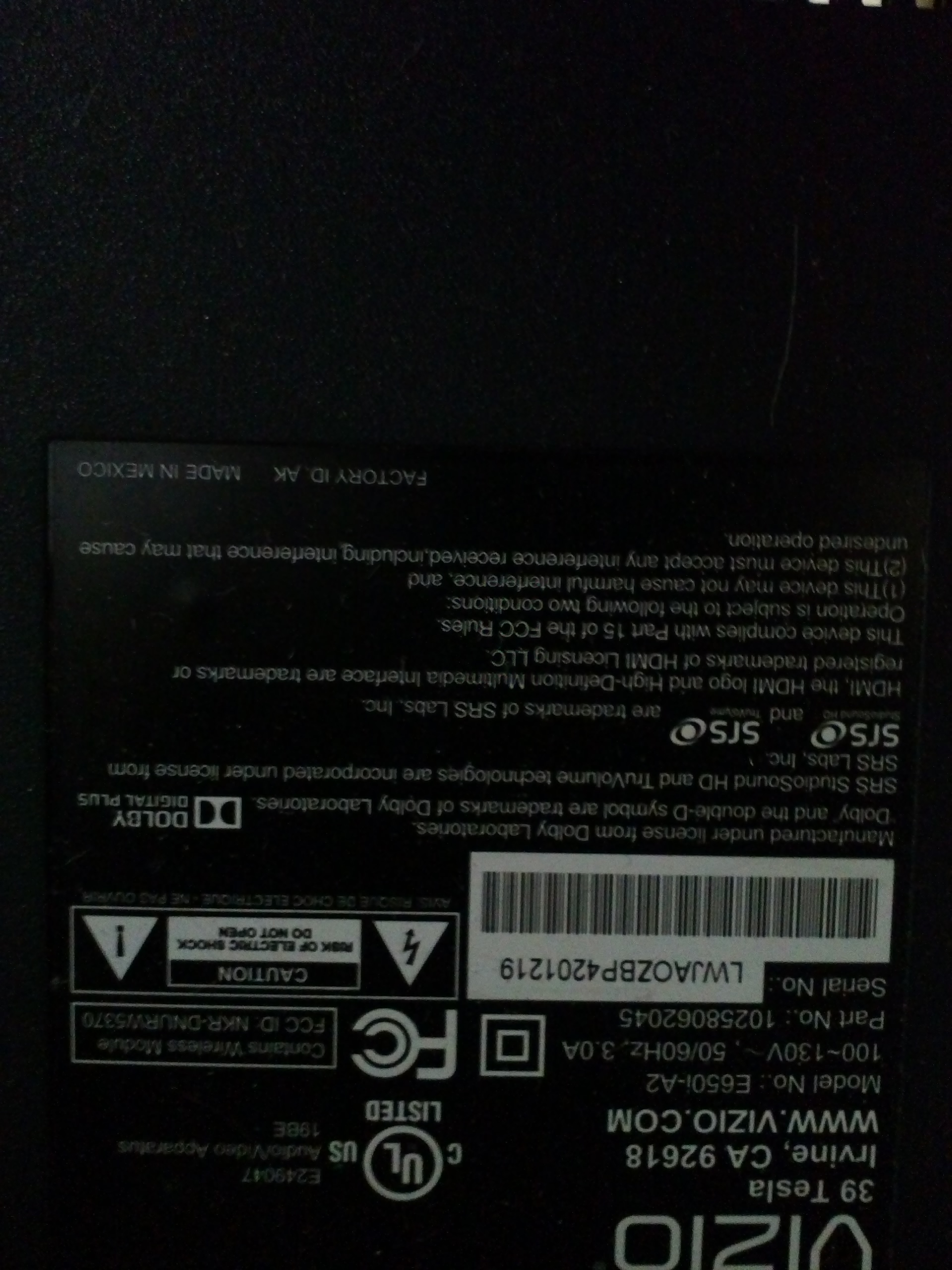

    vizio e650i-a2 (LWJAOZBP Serial) led backlight flashes then turns off, has video (via flashlight) and audio.

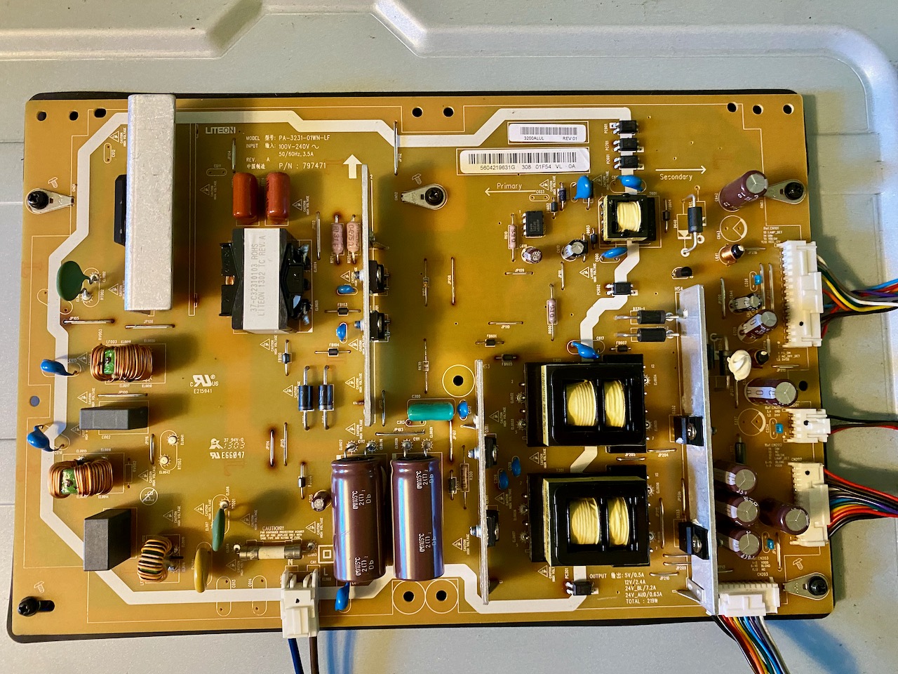

    Vizio 56.04219.641G (liteon PA-3231-01WN-LF) Power Supply Unit
    https://www.shopjimmy.com/vizio-56-0...-power-supply/

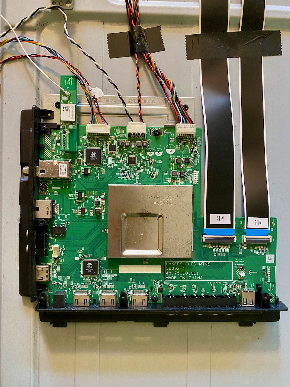

    Vizio 55.75J01.001G (91.75J10.004G) Main Board
    https://www.shopjimmy.com/vizio-55-7...-for-e650i-a2/

    voltages with tv off and plugged in:
    Power Supply
    cn203 (12 pins)
    pins 1-5 (vddb)= 0v
    pins 6-10 (blgnd)
    pins 11-12= N/C
    cn202 (14 pins)
    pins 1-5 (vddb)= 0v
    pins 6-10 (blgnd)
    pin 11 (lamp_det)= 0v
    pin 12 (vblon)= 0v
    pin 13= N/C
    pin 14 (dim)= 0v
    cn201 (4 pins)
    pins 1-2 (24v)= 0v
    pins 3-4 (gnd is marked on board, but pin 3 is N/C)
    cn101 (15 pins)
    pins 1-2 (5vsb marked on board, but pin 2 is N/C)= 5.04v
    pin 3 (ac_off_det)= .655v
    pin 4 (ps_on)= 66mv
    pins 5-6 (gnd)
    pins 7-8 (5vres marked on board, but no pins connected)
    pins 9-10 (gnd marked on board, but pin 10 is N/C)
    pins 11-12 (reg_12v)= 0v
    pin 13 (vblon)= 0v
    pin 14 (dim)= 0v
    pin 15 (lamp_det marked on board, but pin is N/C)

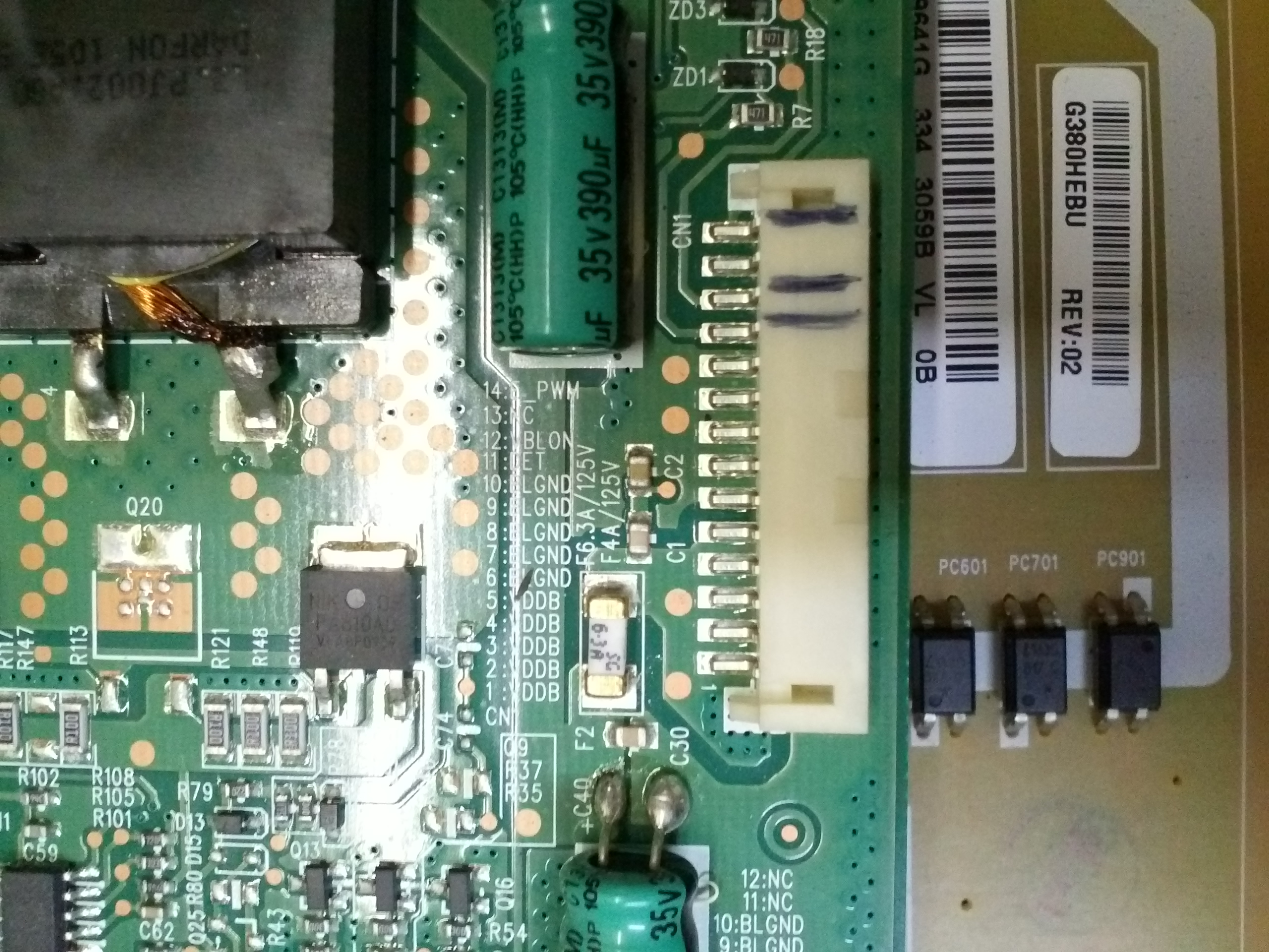

    led driver board:
    cn1 (14 pins)
    pins 1-5 (vddb)= 0v
    pins 6-10 (blgnd)
    pin 11 (det)= 0v
    pin 12 (vblon)= 0v
    pin 13 (N/C)
    pin 14 (e_pwm)= 0v

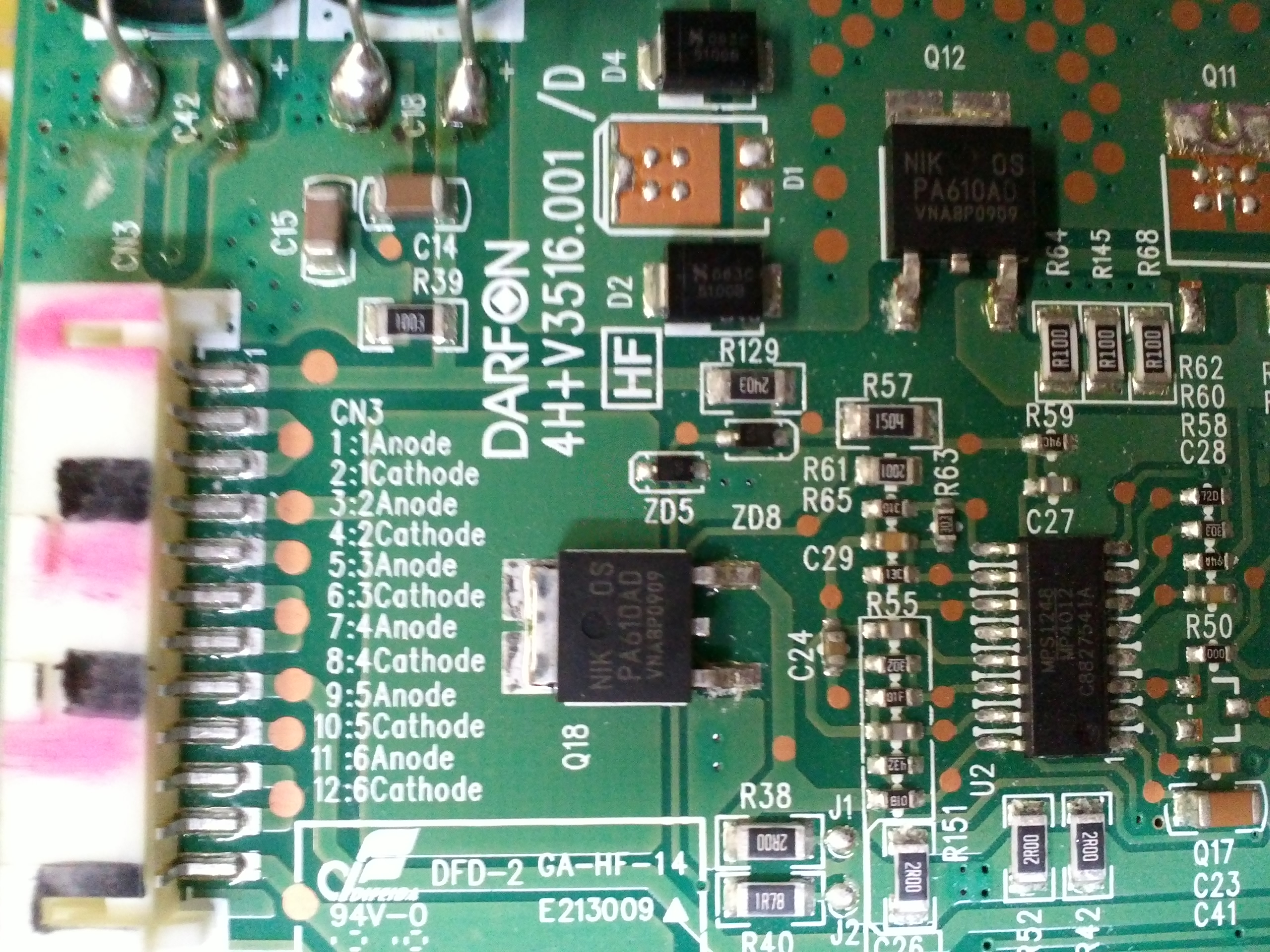

    cn3 (12 pins to led strips, only uses six wires)
    pin 1 (1anode)= 0v
    pins 2-3 (N/C)
    pin 4 (2cathode)= didn't measure this pin
    pin 5 (3anode)= 0v
    pins 6-7 (N/C)
    pin 8 (4cathode)= didn't measure this pin
    pin 9 (5anode)= 0v
    pin 10-11 (N/C)
    pin 12 (6cathode)= didn't measure this pin

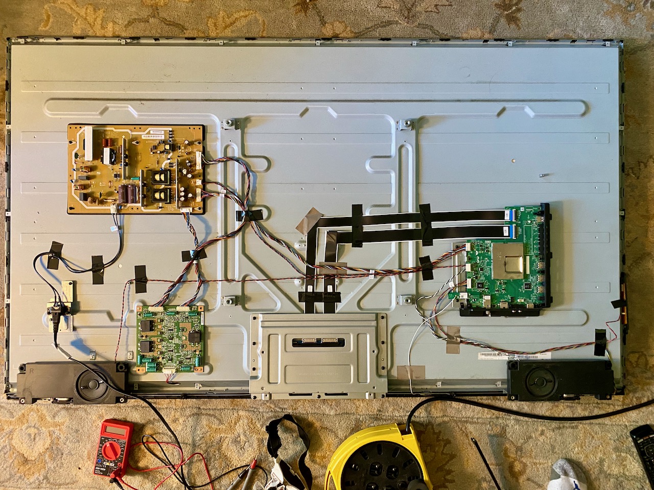

    voltages with tv on:

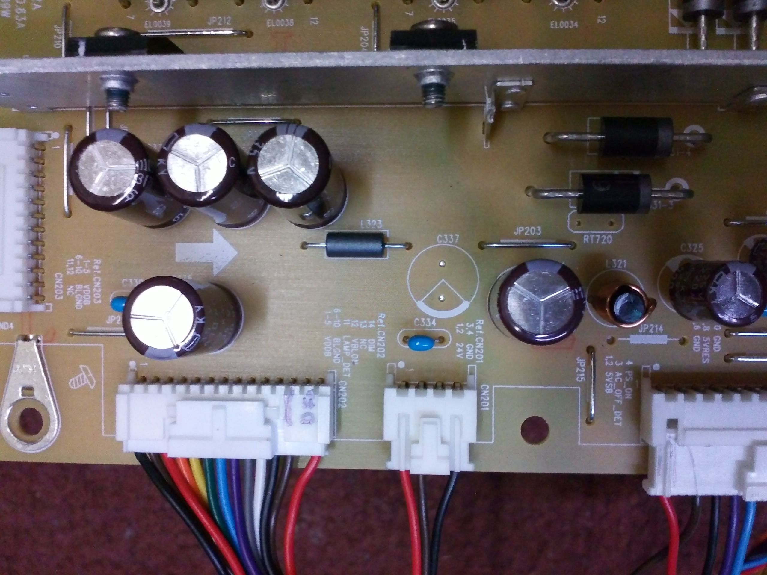

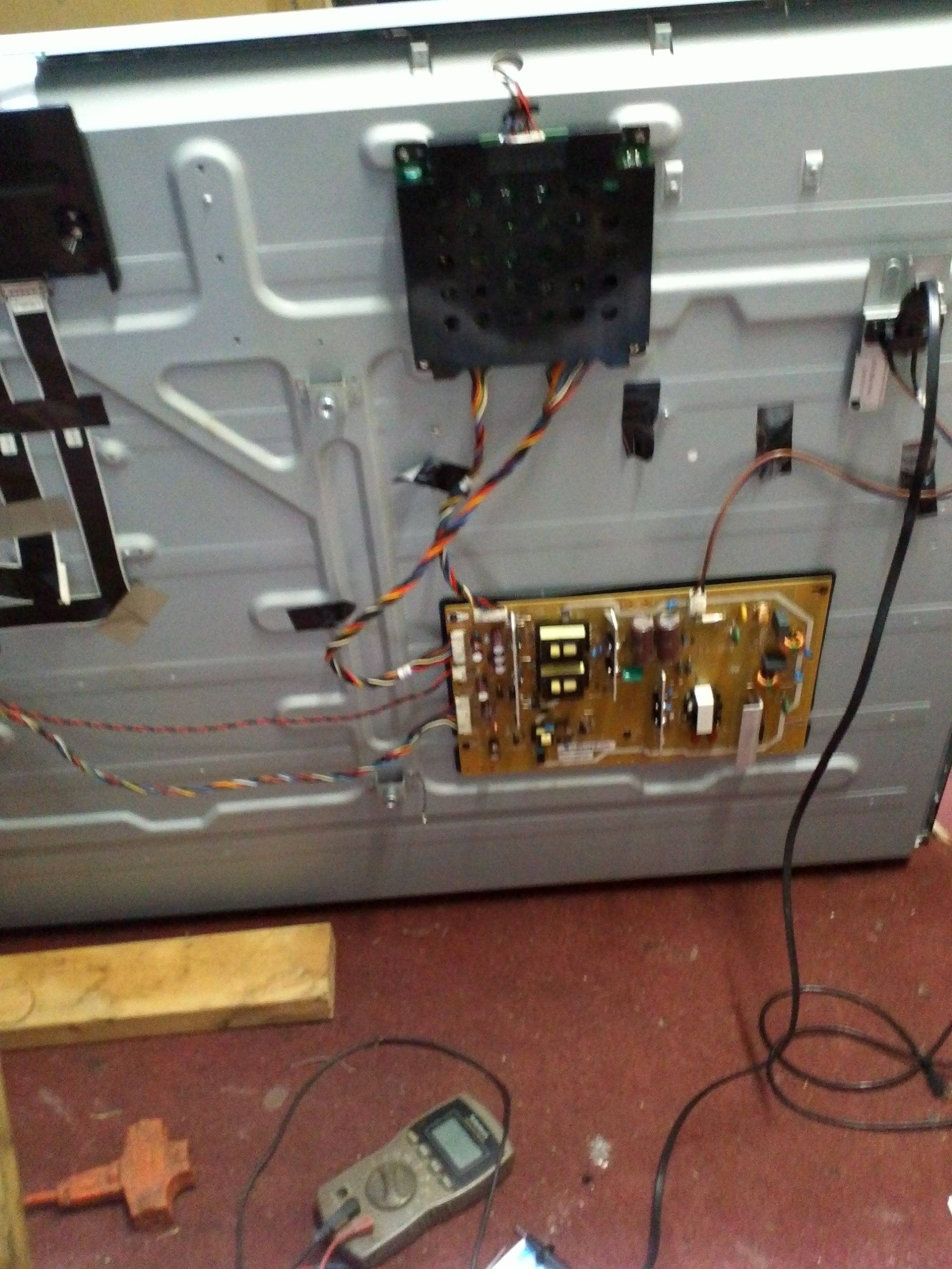

    what i have done so far:
    only problem i could find on original led driver board was that pin 5 (3anode) did not have any voltage on it.
    fuse f2 was blown.
    disassemble panel and check each individual led strip (12 of them) using a hp laptop psu with output of 19.28 volts.
    all led on each string lit completely.
    bought this kit from shopjimmy:
    https://www.shopjimmy.com/vizio-e650...air-parts-kit/
    fed a full 3.3v to ps_on (with wire to main disconnected, of course) because i thought 2.368v might be too low
    (made no difference).
    so, long story long ;-) tv acts same as original boards. power comes on and backlight flashes once, then turns off.
    flashlight shows image (says "no signal" after displaying vizio logo) and have audio, but nada from backlights.
    initial voltage on led driver board cn3 (pins 1,5,and 9) is 84v then dropping and holding at 24v.
    the only signal i see that might be a problem is the DET signal, but i don't know. i'm a noob on these led backlit
    tv's, so i would appreciate some help from the Wise Ones here on the forum. Thanks! James

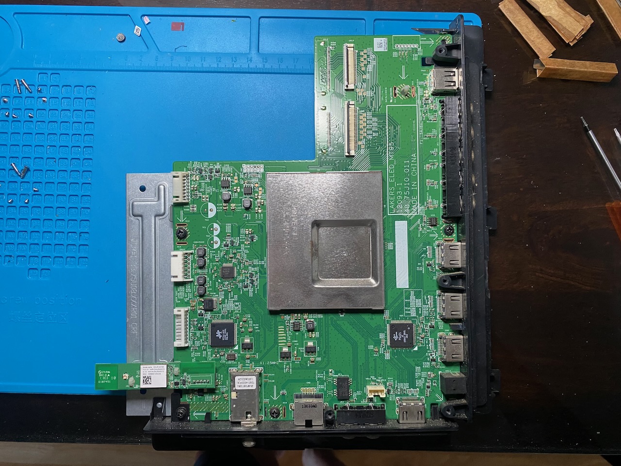

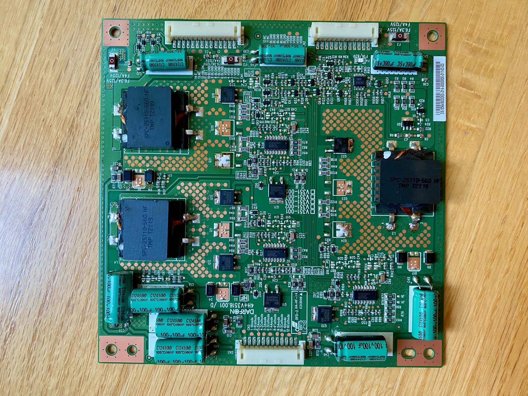

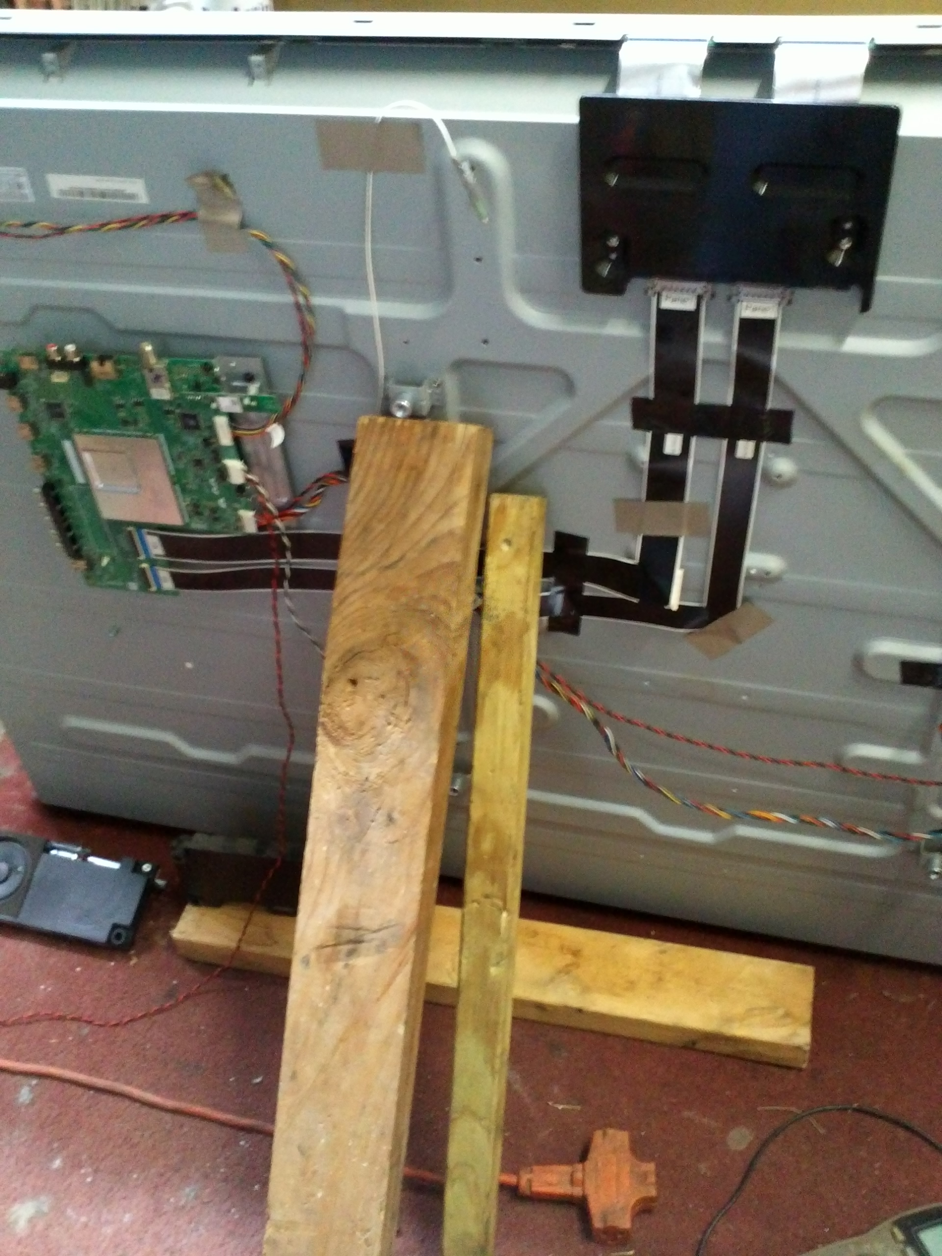

    Got one that has no backlight but panel shows vizio logo + no source msg with flash light on power on.
    Voltage readings are same as OP except for LED driver board CN3. My pin5 and 9 shows 0v when TV pwr on. (also my dim line is 2.6v)
    LED tester shows 63.5v on all 3 strings on CN3 (pin 1+4, pin 5+8, pin 9+12) and light up through rear chassis holes. LED tester shows 300v on pin 1+8, and 1+12. Backlight is 12 LED bars each with 6 3v LEDs. So each of the 3 strings should read 6 LED x 3v x 4 bars = 72v and pin 1+8 should read 2x72v? 1+12 should read 3x72v? See CN3 on first pic for reference.
    But probably have open LEDs that yields this reading.

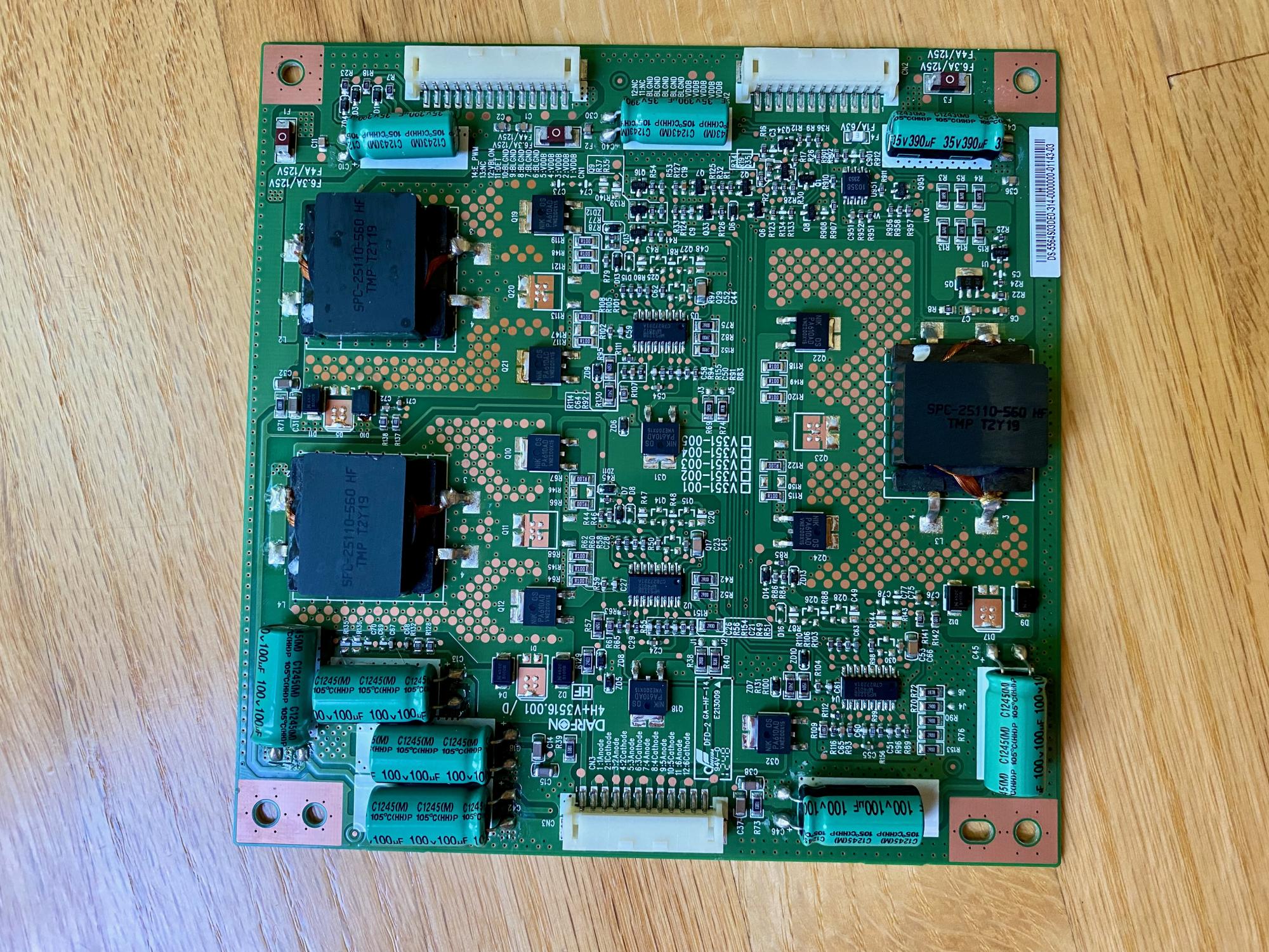

        UPDATE
        all 3 LED string lights up with 65-66V so I figure there aren't any bad LEDs.
        Closer look at the LED driver board finds a short on anode of 2 of 3 LED strings at on CN3 (pin 5 and 9) LED strings themselves have no shorts. Found a shorted MOSFET on each of the 2 failed boost converter circuit (Q21 Q24). These are 100V 15A MOSFETs in TO-252 package that basically use the ground plane as heat sink so they've lived a hard life. High res pics attached of before and after MOSFET removal (How did I ever fix things before hot air station haha)
        Will order a LED driver board (same price as 2x MOSFETs haha) and report back the results.

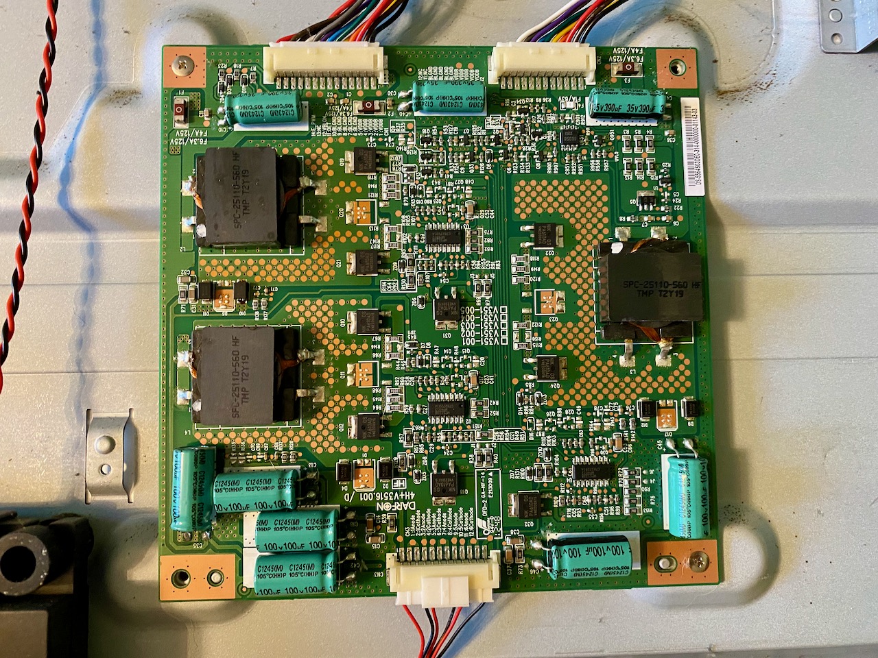

          Re: vizio e650i-a2 backlight flashes then turns off
          UPDATE
          LED driver board came in. No short on the 3 boost converter circuit. Installed into TV, works.

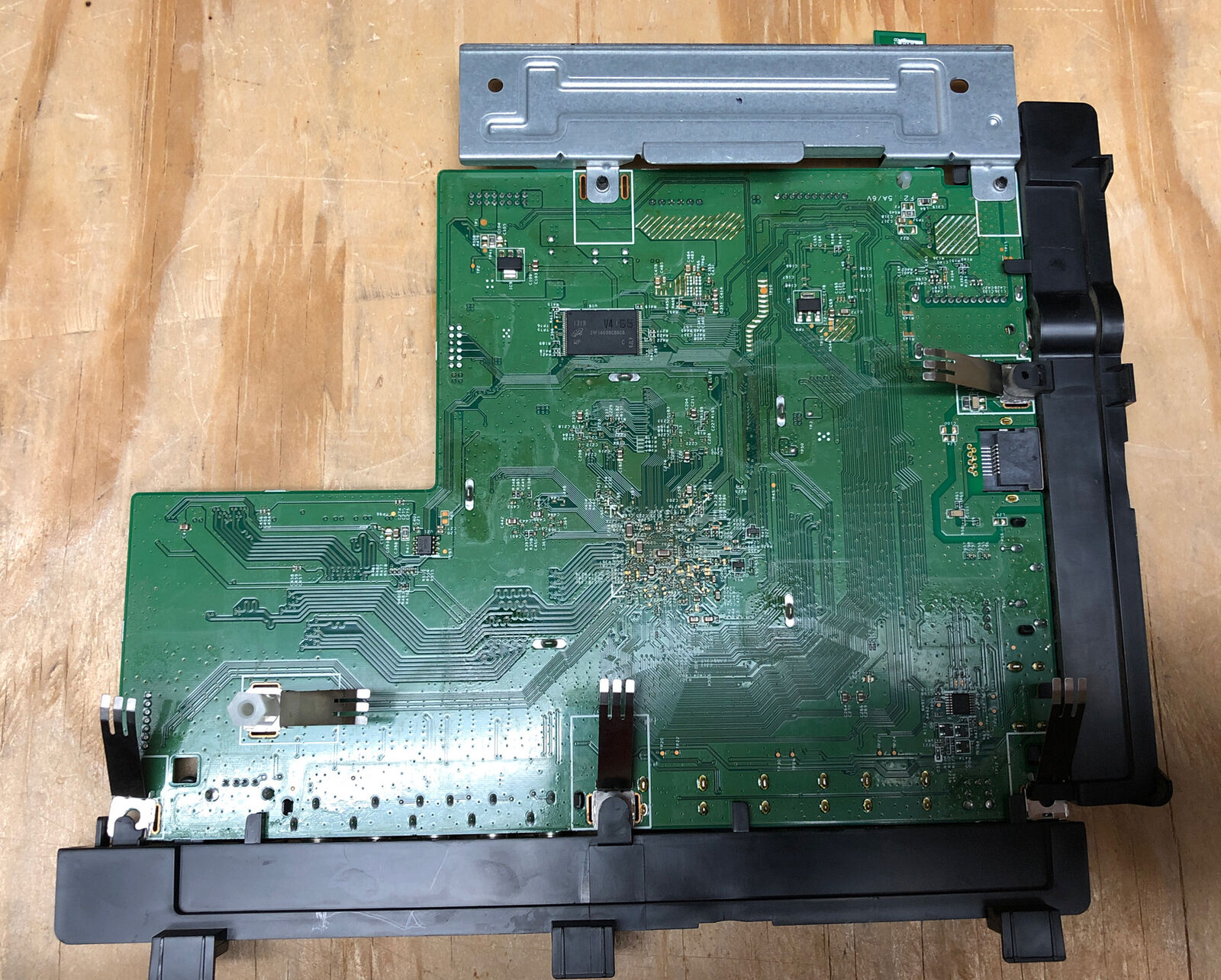

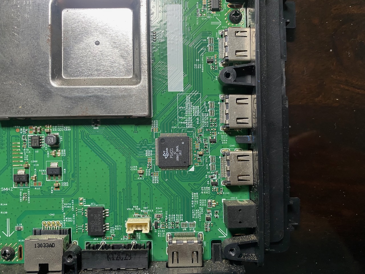

          Now onto the next problem in sequence. 4x wonky HDMI ports. All ports come and goes. Some times says no signal, some times say Not Support. Seems to change with each removal/reflow/install. Reflowed HDMI connector and switch (Parade PA421) pins. No shorts around the area.
          This main board has 5 grounding fingers on bottom that requires the back case (very difficult to remove) on to secure ground path. Board doesn't have enough screws to keep the grounding fingers tightly against the chassis. When I had the back off and testing, just unplugging HDMI and move to another port would cause the first port to not work. Made more complex with the HDMI device getting confused and need to reset that...
          Maybe HDMI switch is bad... maybe my reflow skills aren't good enough on fine pitch HDMI pins. don't know.
          All other TV functions works fine. Tuning ATSC channels, running Vudu smart app, wifi so most of the board appears fine other than HDMI region.
          • diif
            • Feb 2014
            • 6978
            • England
            The BGA under the processor is more likely to be affected by heat than the HDMI switch.
              Seems doubtful its the main BGA. Here are some deterministic results.
              SONY 4K bluray player works on HDMI 2/3/4
              Xfinity flex (their streaming device) works on HDMI 2/4
              Firestick 4K works on HDMI 2
              Nothing works on HDMI 1
              All devices display in 1080P which is max rez of the TV
              I'd expect HDMI compatibility with SONY > Xfinity > Amazon. SONY is also the oldest device of this bunch and may play best with this circa 2012 HDMI implementation.
              Anyway, enough HDMI is working for this old TV. I'll call it done
              • diif
                • Feb 2014
                • 6978
                • England
                Is HDMI 1 the bottom port? It looks like a couple of pins are bridged.

                        UPDATE:
                        Turns out was main board. Replaced and all 4 HDMI ports work perfectly with any HDMI cable.
