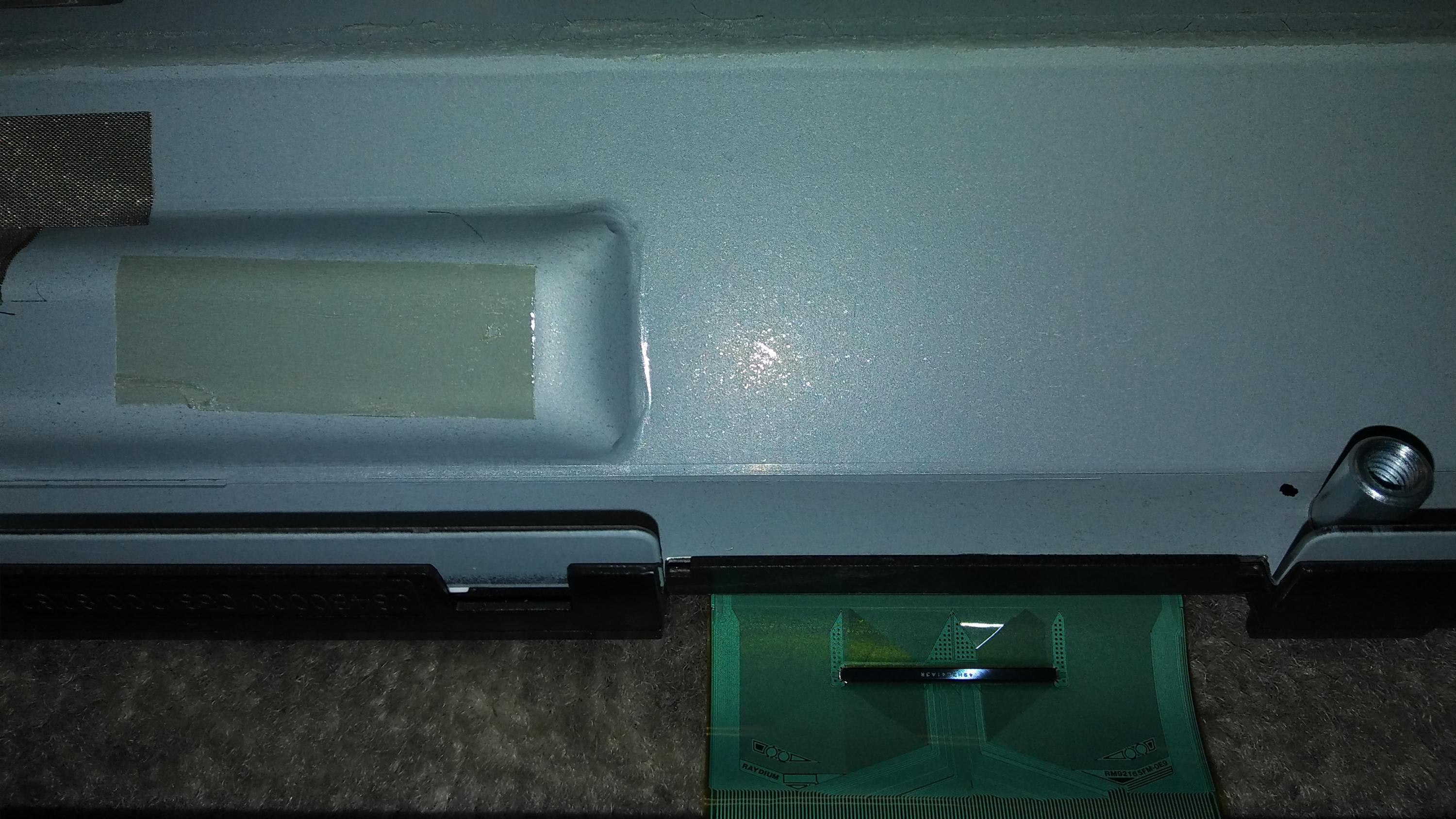

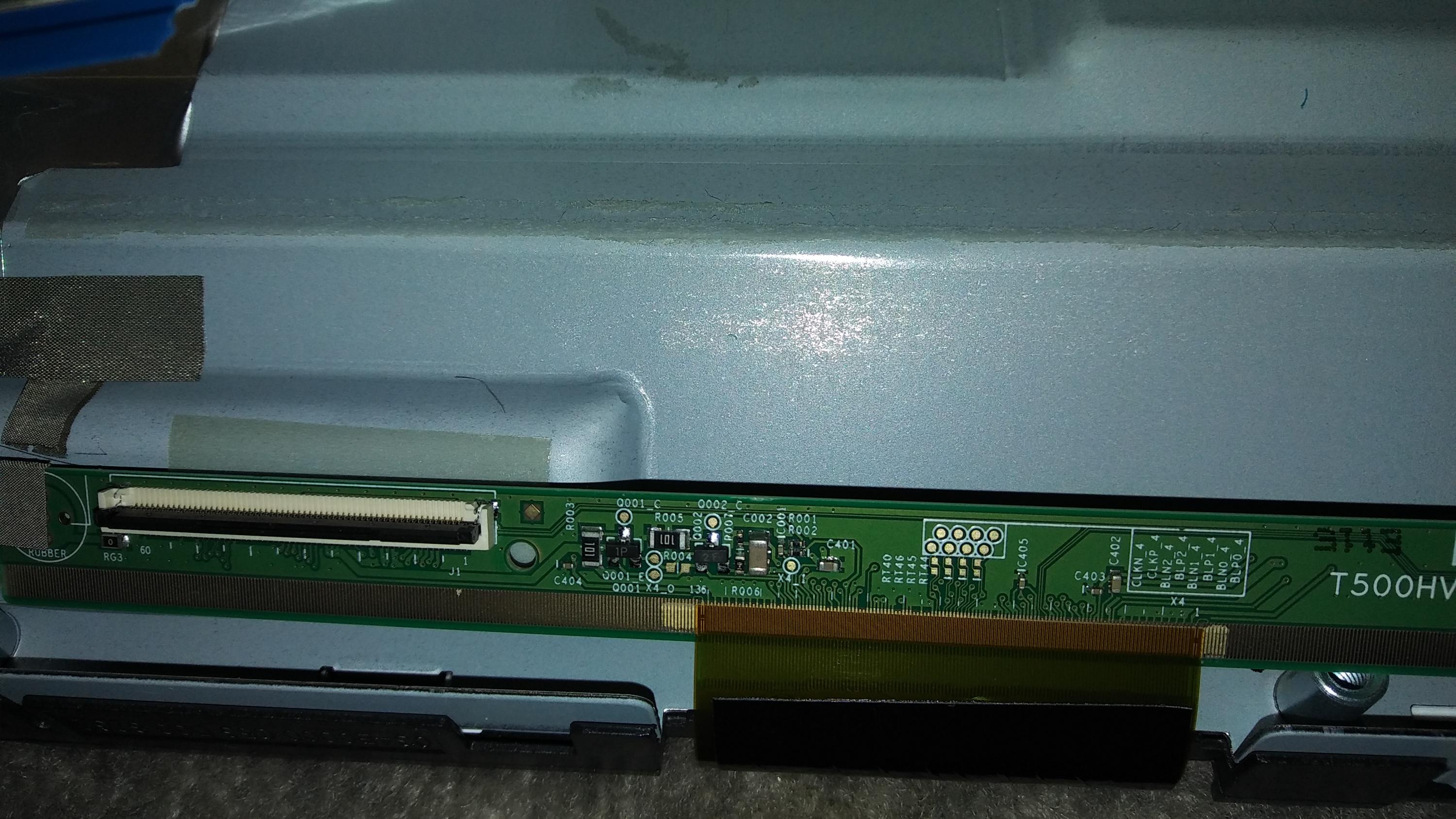

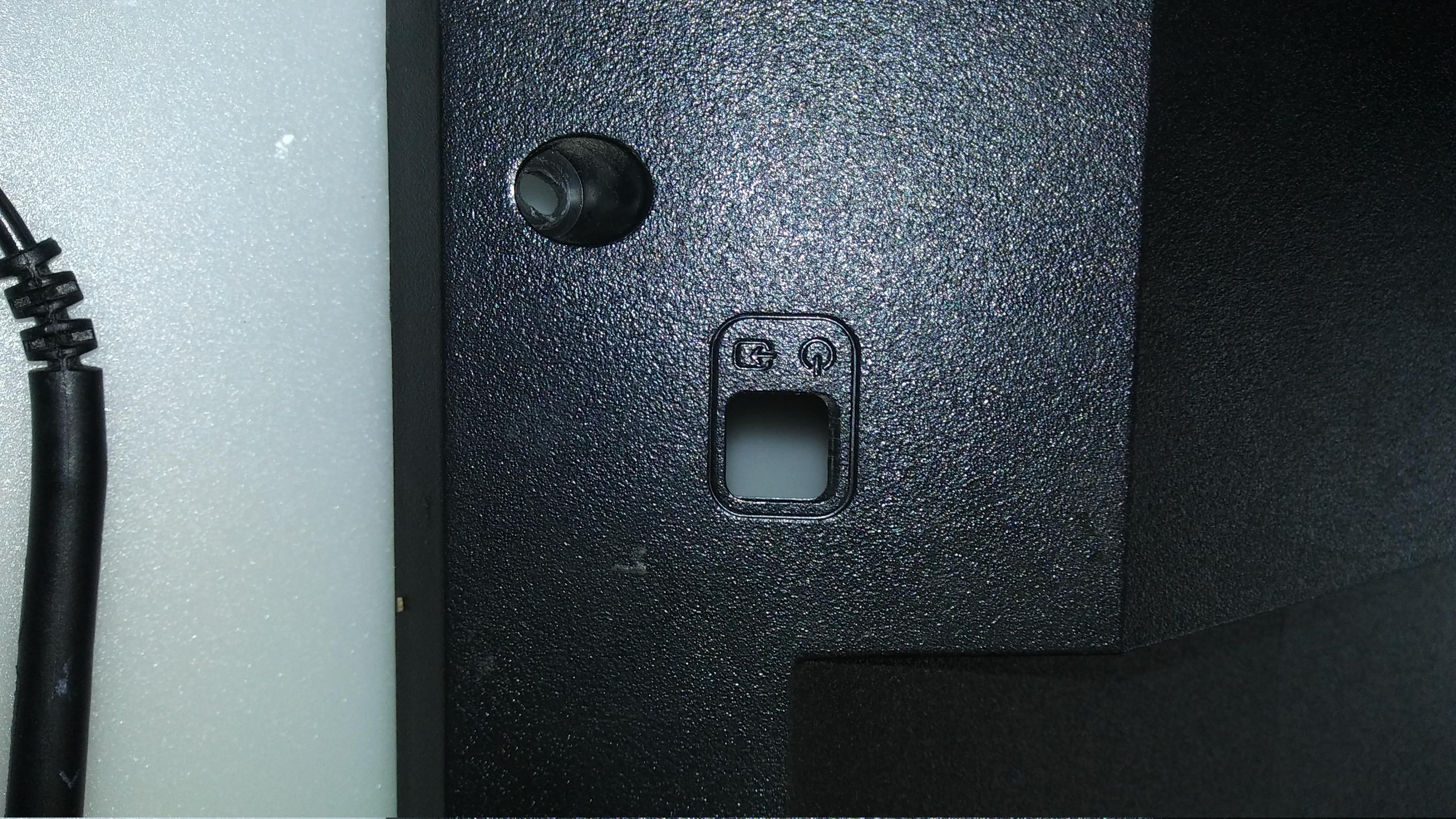

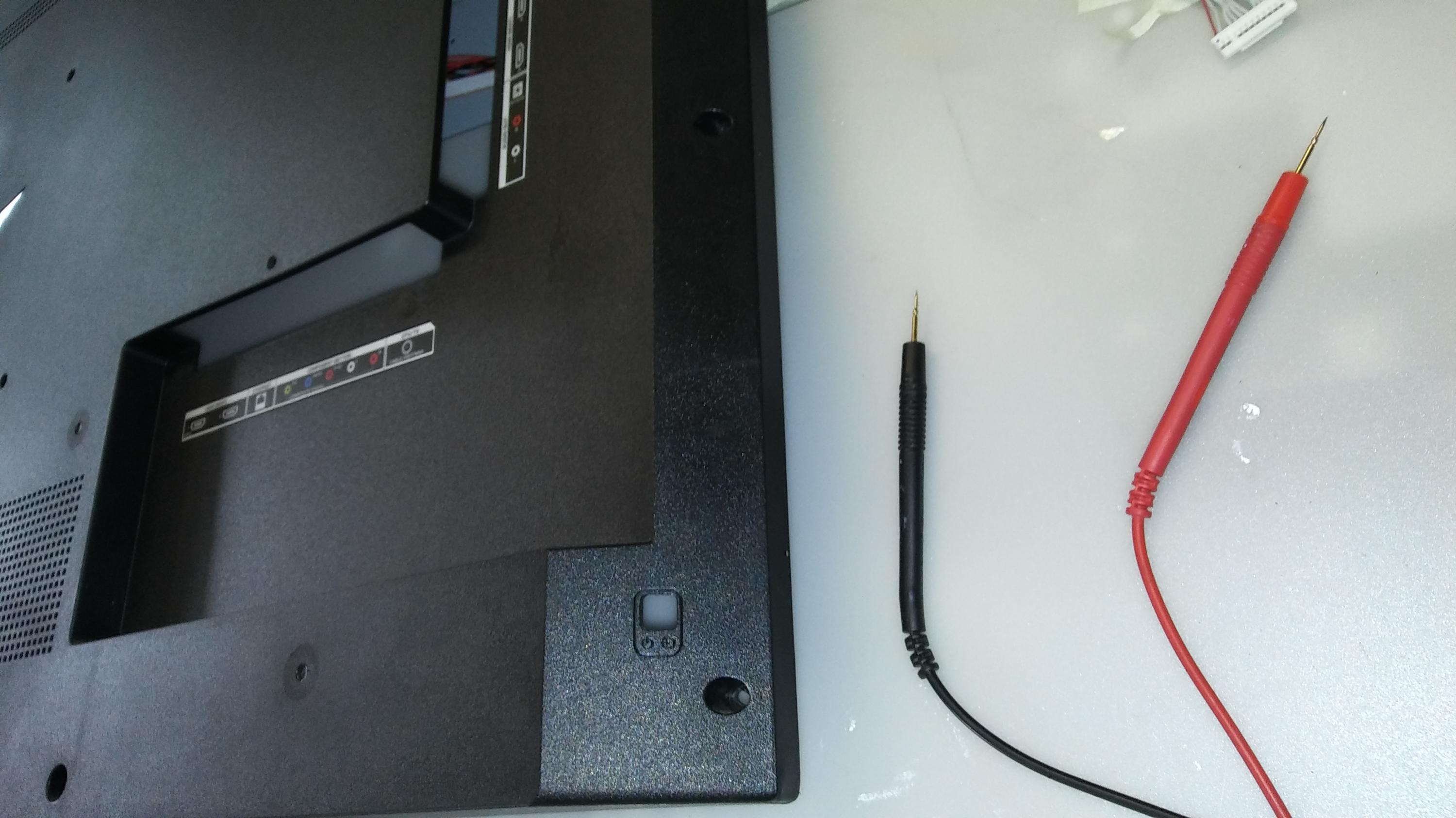

    Vizio E500i-B1 , is the one of, I did nothing but charged full amount at 2016/12/16, complains is will cuts off, came back I tested work OK, , drive me crazy.
    I told customer Ive been fix tons of this TV , in front of customer, about 1 mins, I could not find the power switch, only have 1 button in whole TV set, at left hand side over the back of TV ... ....
    Re: Vizio E500i-B1
    You should post anything about TVs in the TV section instead.
    BTW, any pictures of the backside showing all the boards?

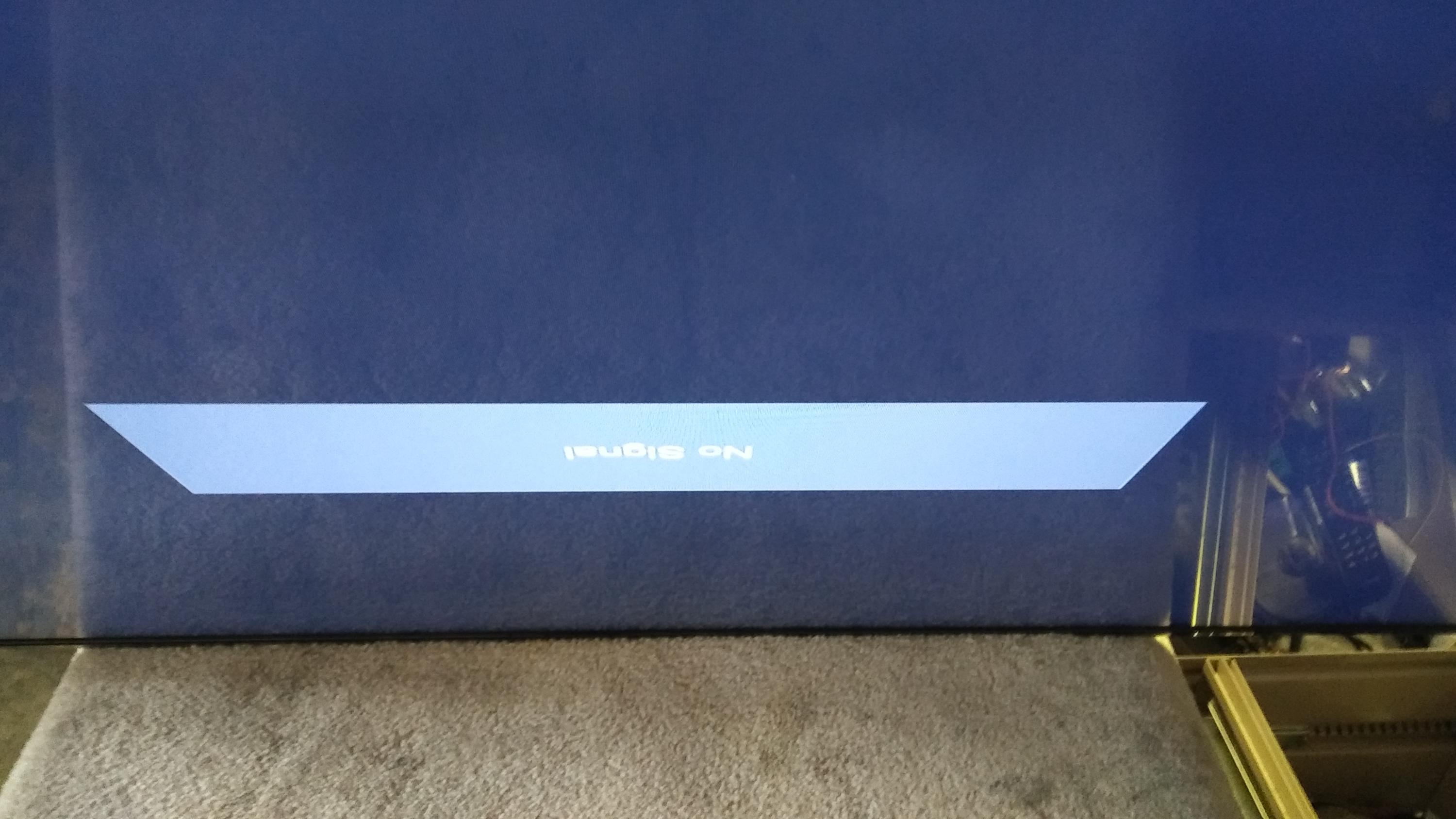

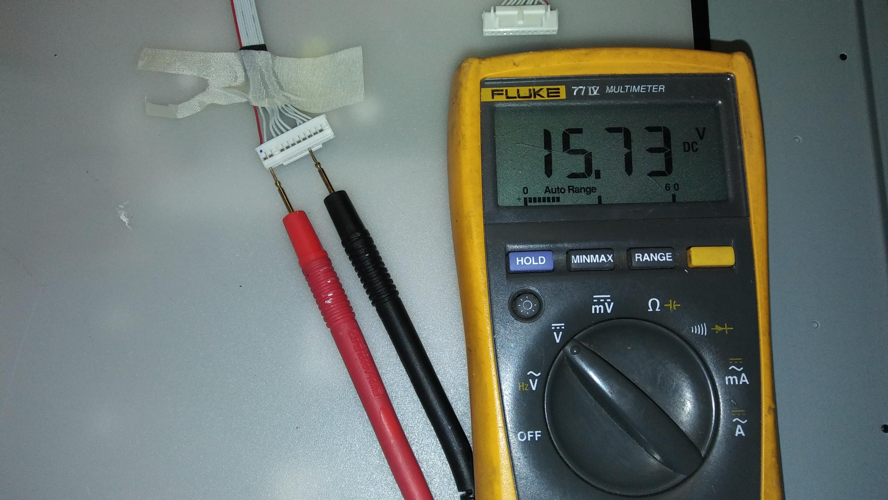

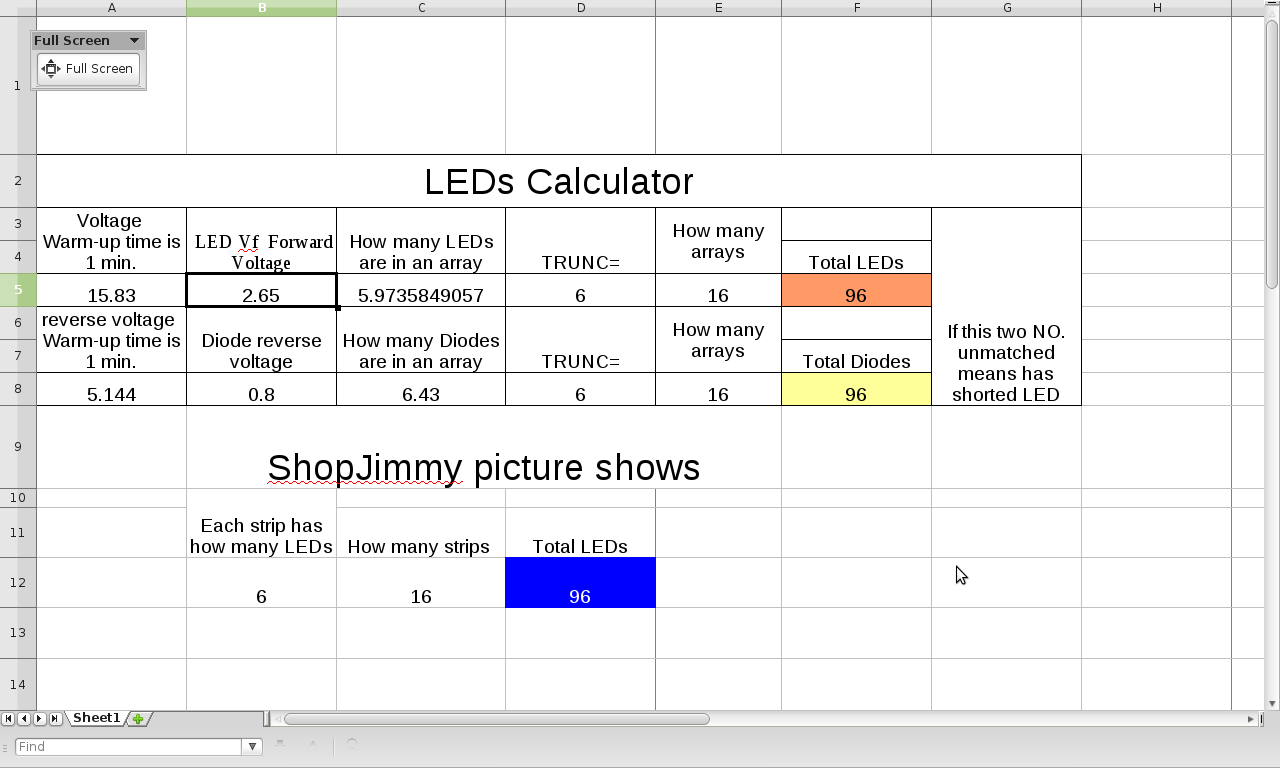

      Test black-light of TV .
      Show 96 LEDs, maybe one of them gave the trouble.
      Panel Sticker Number: TPT500J1-HVN04 REV:S17TB

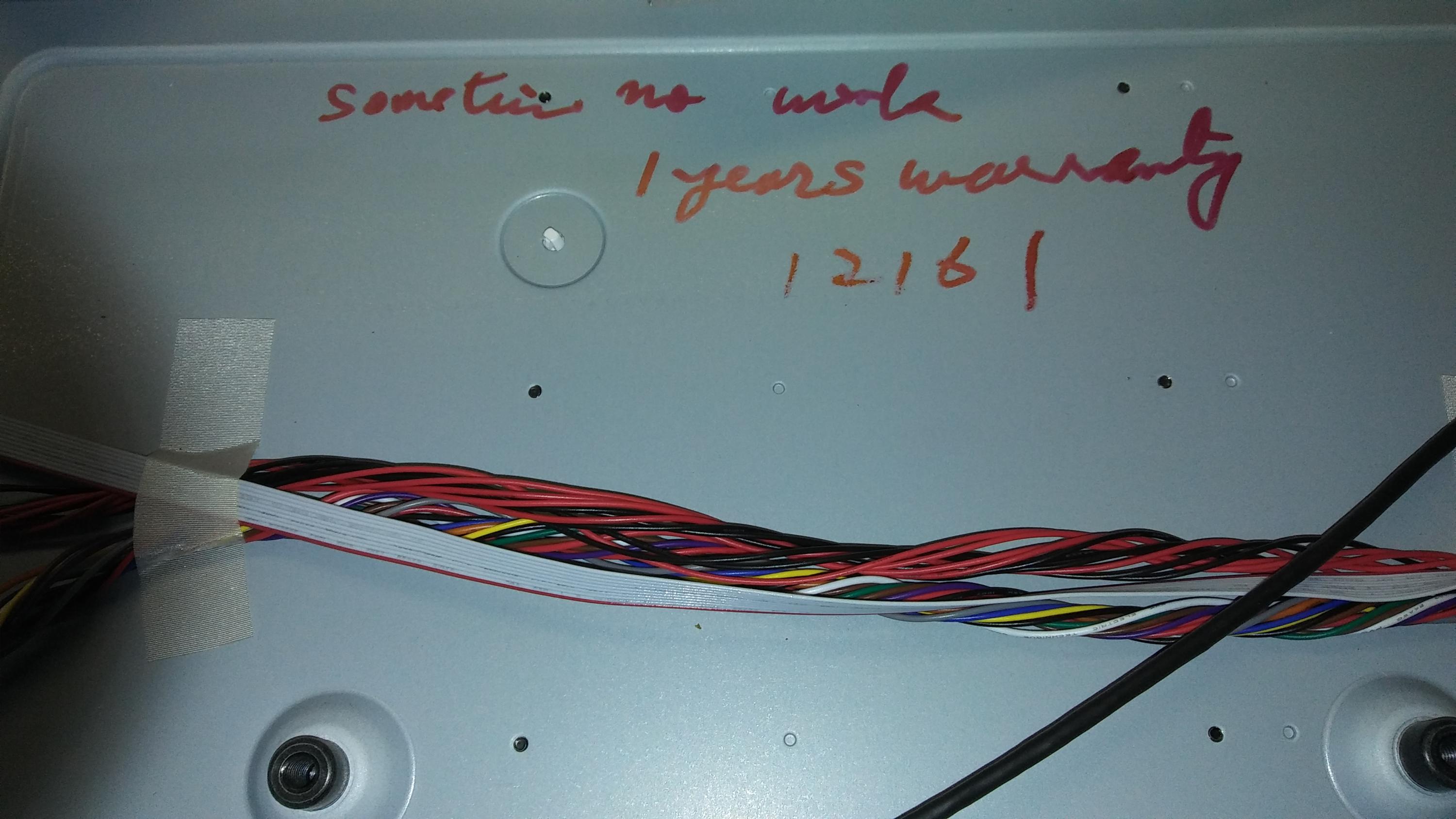

            "I did nothing but charged full amount at 2016/12/16," at meantime I give one year warranty. This TV has been tested for 3 days work good, thats why I try to invent A LED lifetime tester.
            PS: pic1 show one year warranty. and copy of customer's receipt.
            https://www.badcaps.net/forum/showthread.php?t=59247

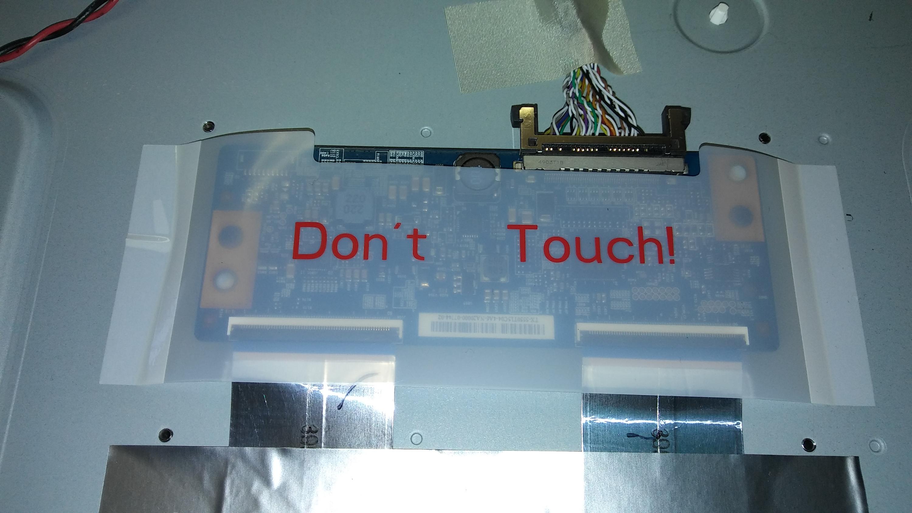

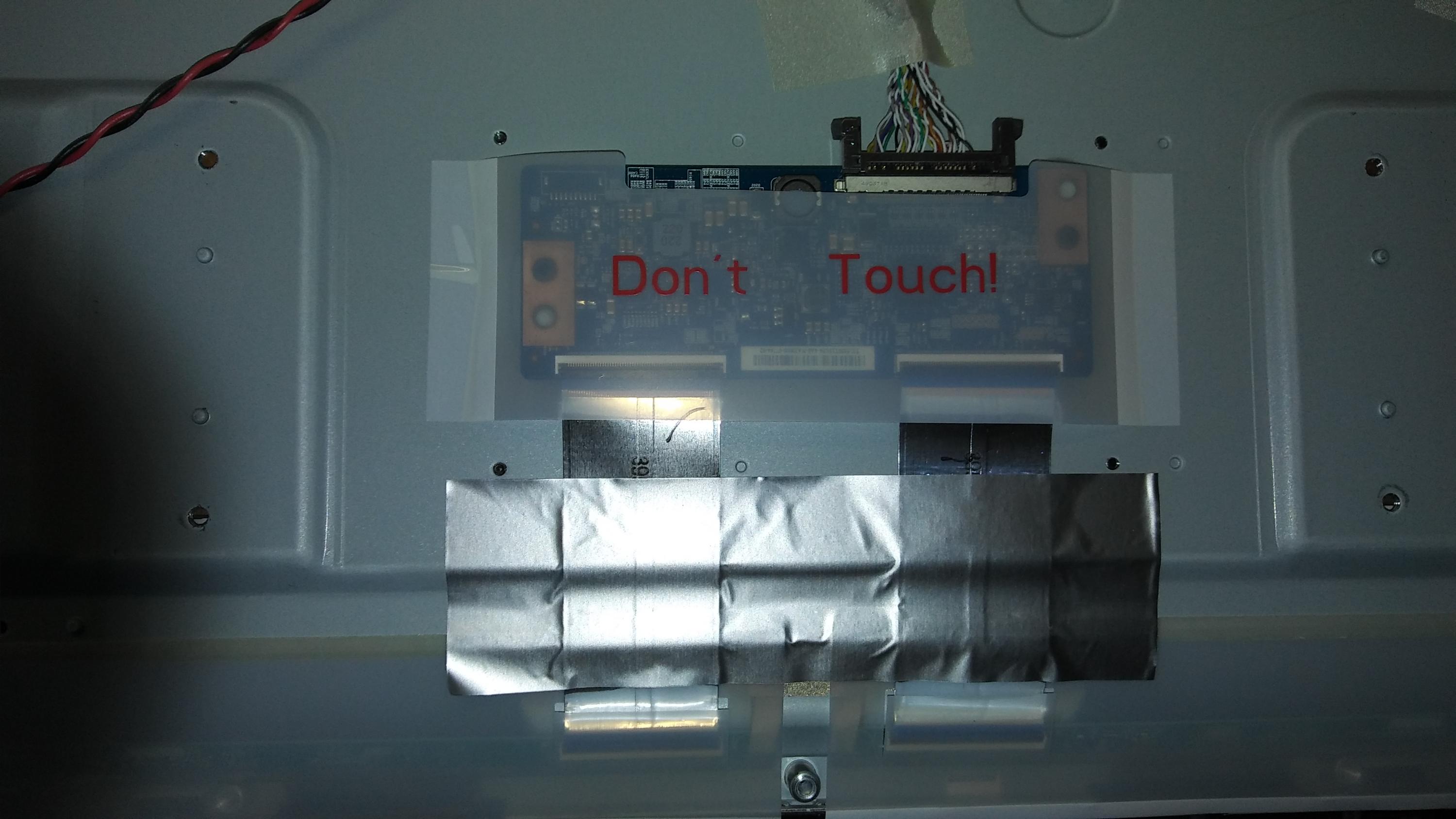

              Don't Touch! How can I fix the TV without touching ? Remember the TV was working what happen if I broke the tabs, and TV no more has pictures, Who gonna pay for?
              PS: Why Don't Touch! is because they glue screen on the panel, need extreme carefully to unglued those double sided tape.

                user manual attached regarding buttons to turn set on and off and swop inputs etc
                • capwizard
                  • Jun 2016
                  • 1991
                  Re: Vizio E500i-B1
                  Thank you, I already lost face in front of customer when I can't find the power button. will remember next time.....

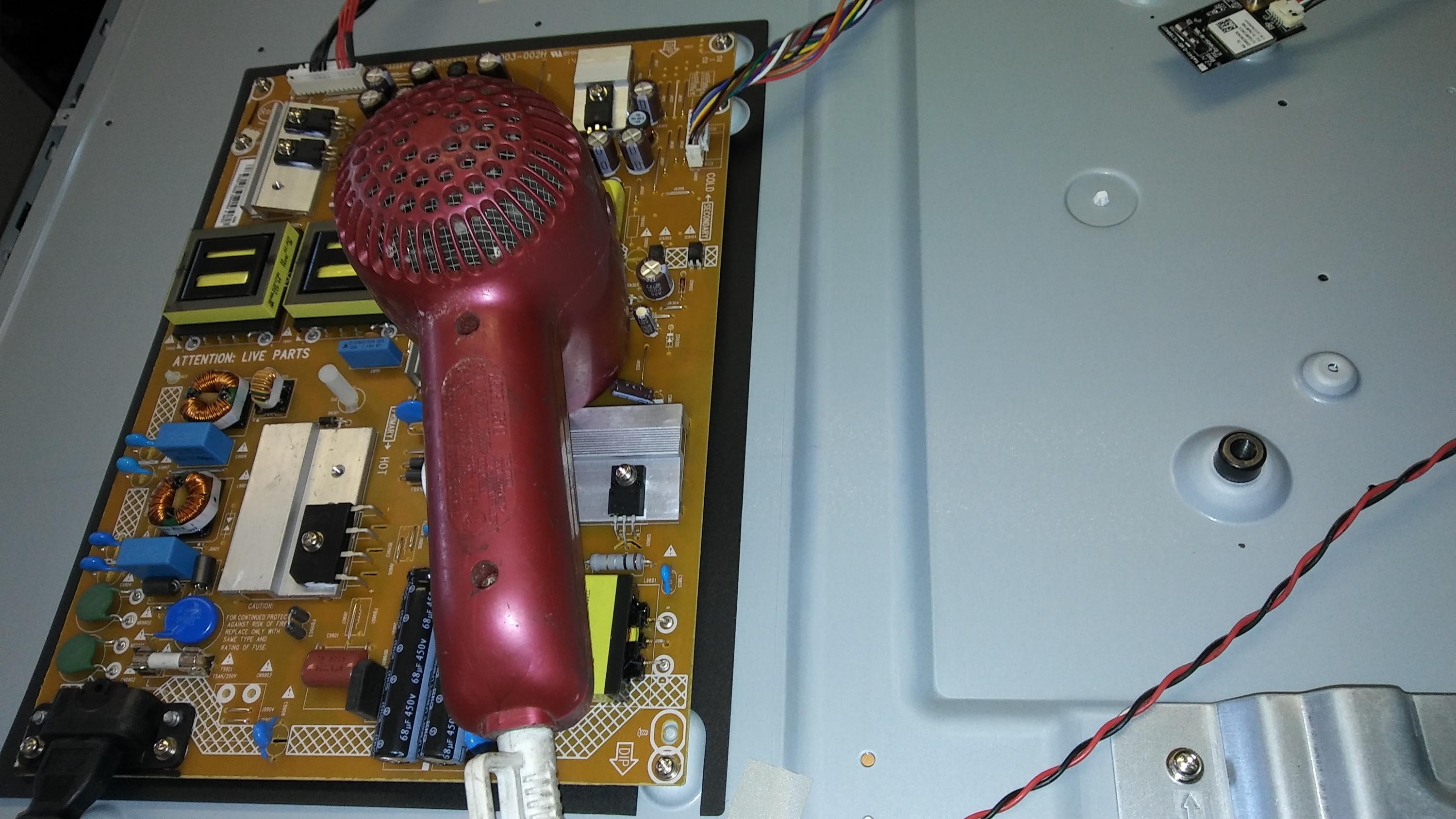

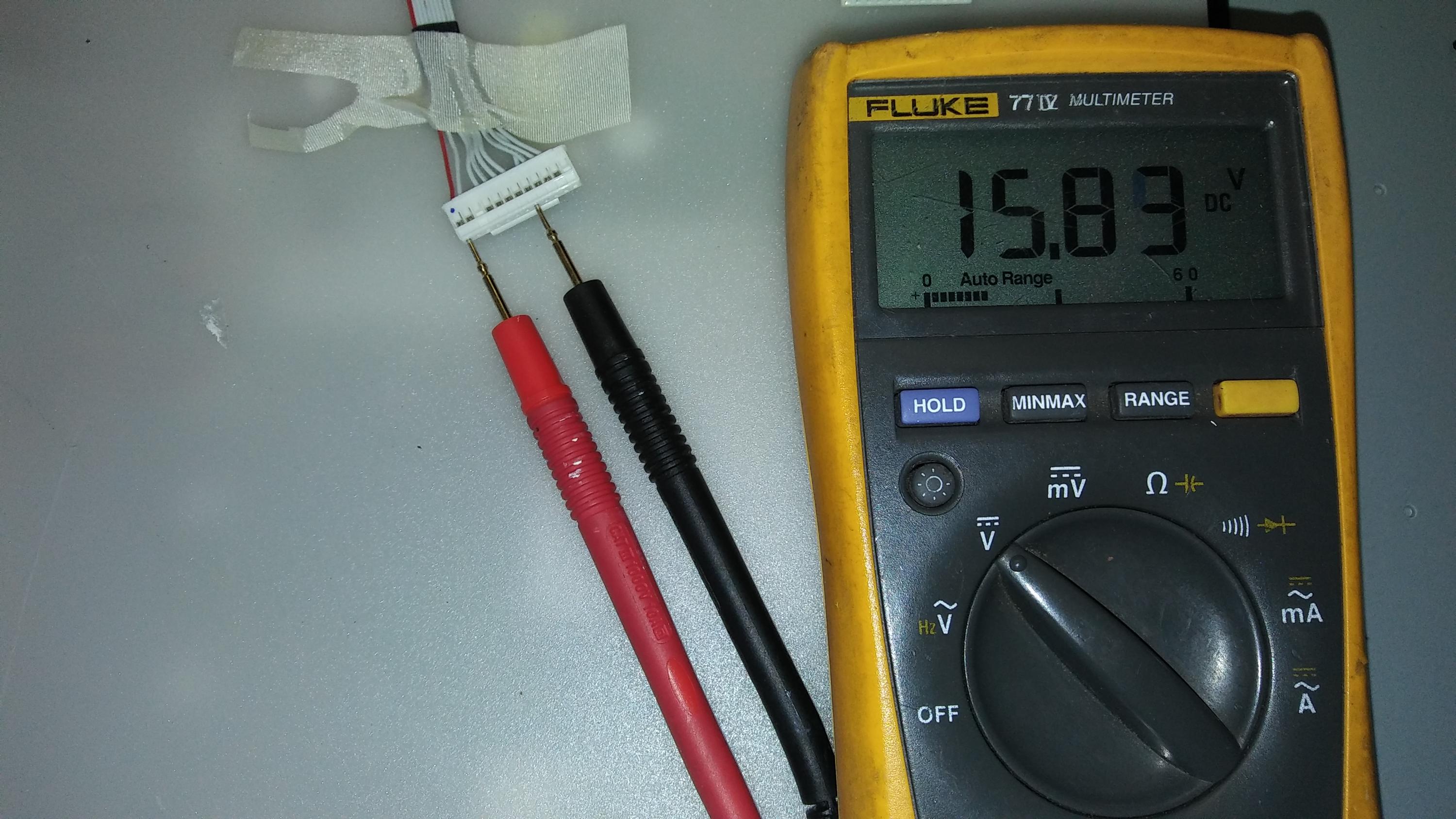

                              This morning I test TV still working from cold start. I'm giving up because it works, I never saw the problem....How can I.....then I try to use hair dryer to castrate myself, no ..I mean use hair dryer to test for the last attempt testing....If still not work I will.......
                              YES......When I heated IC9301...... I found the problem is the STR A6069H caused all the problem.........A common bug IC....

                                The symptom : After you heated up the IC9301, power pilot light is on when you push the hard- to- find- power- button the LED diminished slowly..........

                                  After changed IC9301 STR A6069H, it still will not turn on when heated up, Oh My ...do I still need to be castrated.....wait A minute..... give me one more chance....I found it..... it is this one next to it.... ic9101.........been over heat cant read the NO. Who know the IC NO.?

                                    wait A minute..... give me one more chance.....I did ordered 10pcs FSFR1700XSL, I don't know they are the same or not?
                                    YES, I found it, it is LCS703LG.......................

                                      Re: Vizio E500i-B1
                                      There you go
                                      It must have been an environmental problem, maybe the customer has the set in a hot room or by a window in the sunshine.
                                      I don't know if FSFR1700XSL will work though? Looks like a very similar IC to the LCS703LG but I think they have a rather different pinout.
                                      LCS703LG you can get from Mouser.
                                      -David VanHorn
                                        Re: Vizio E500i-B1

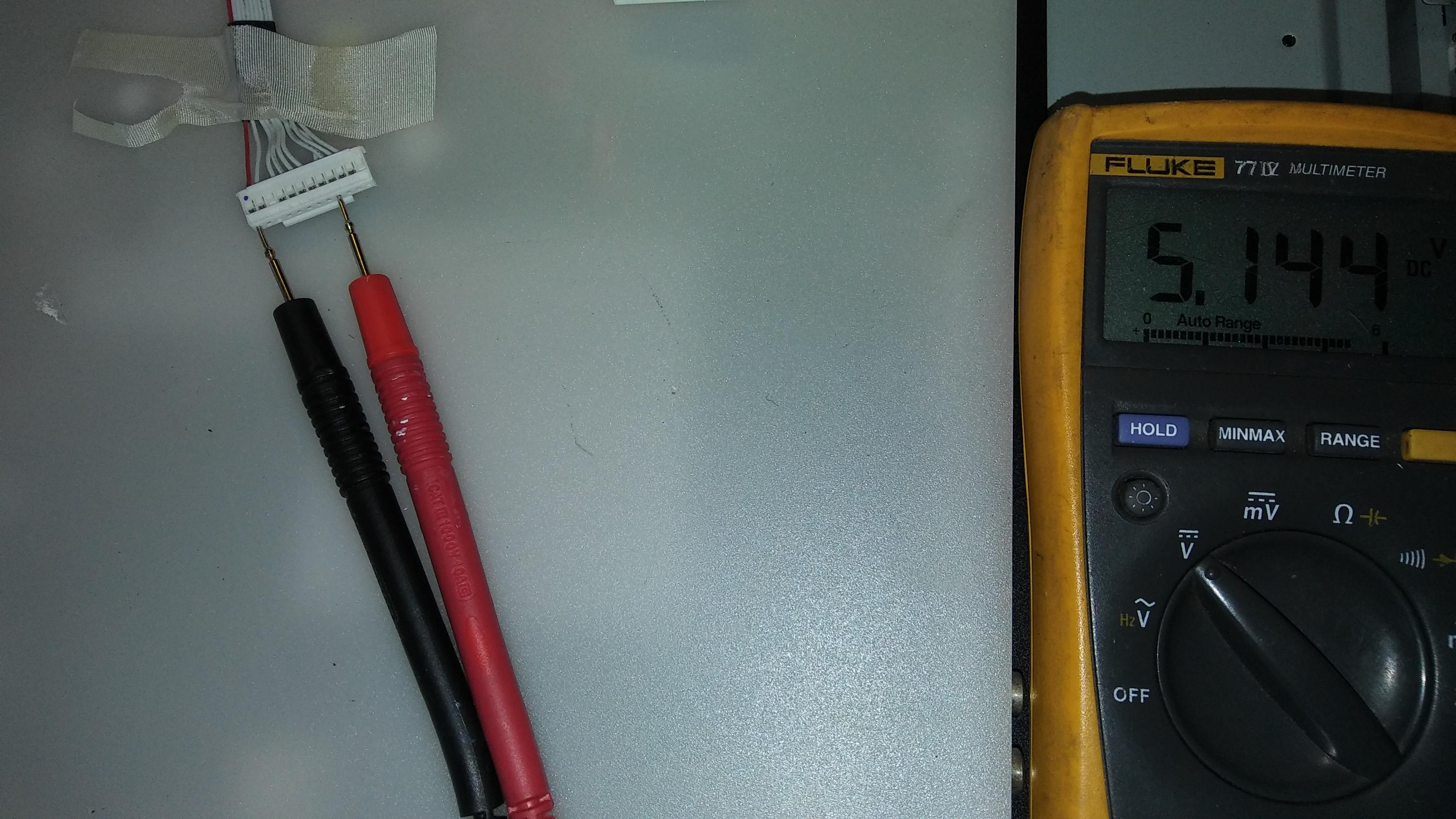

                                        I still wonder what DCVs are missing when the TV does not work. The STBY PS (using IC9301)? or the switched supplies using the LCS703LG IC?
