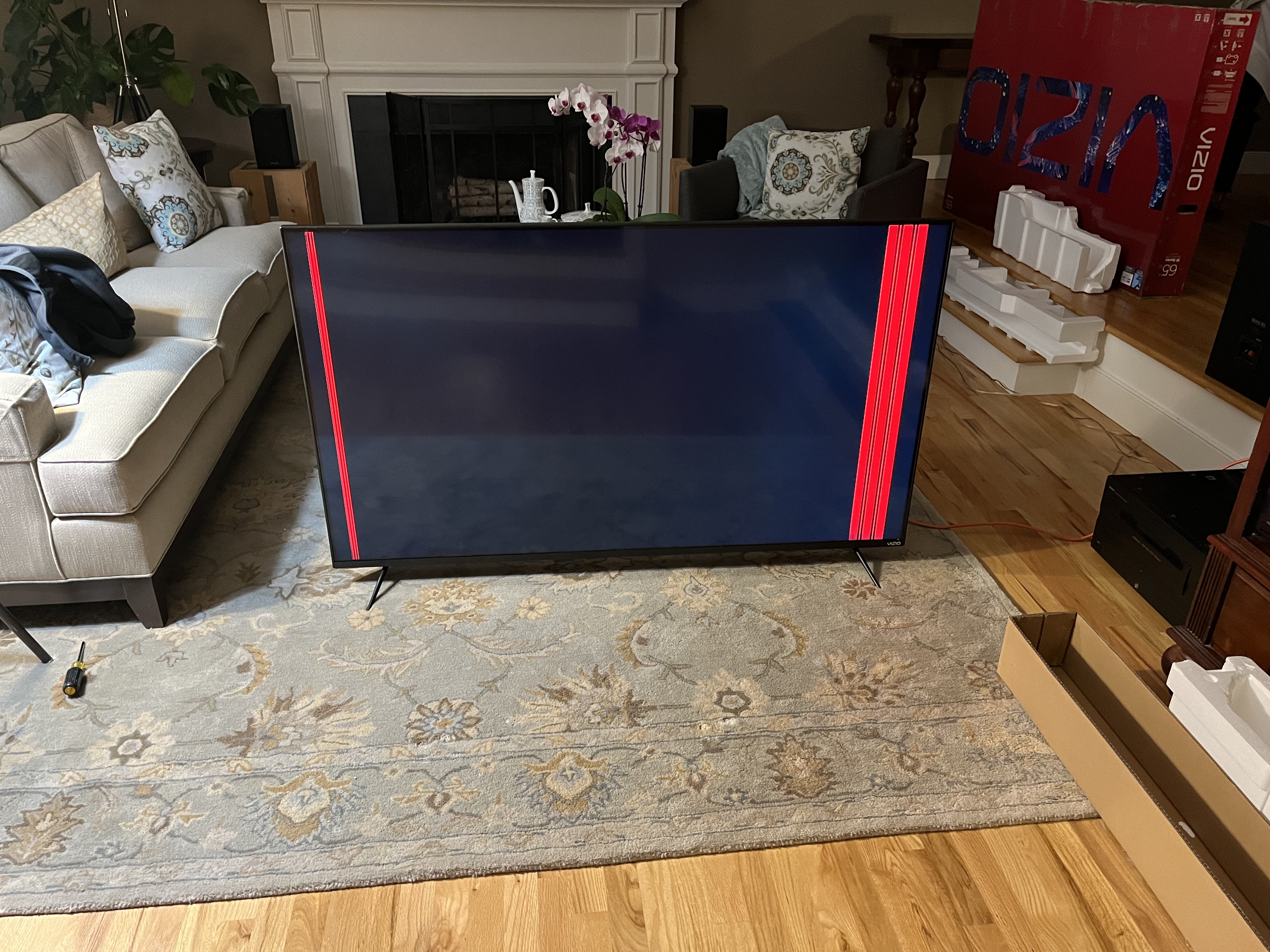

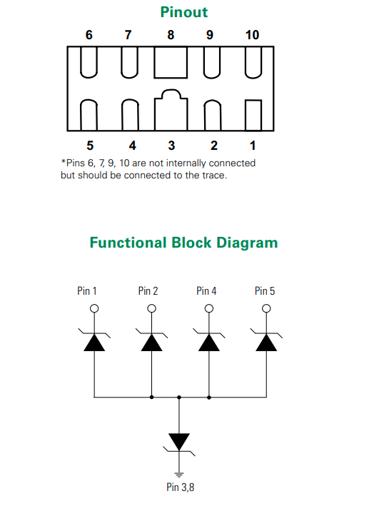

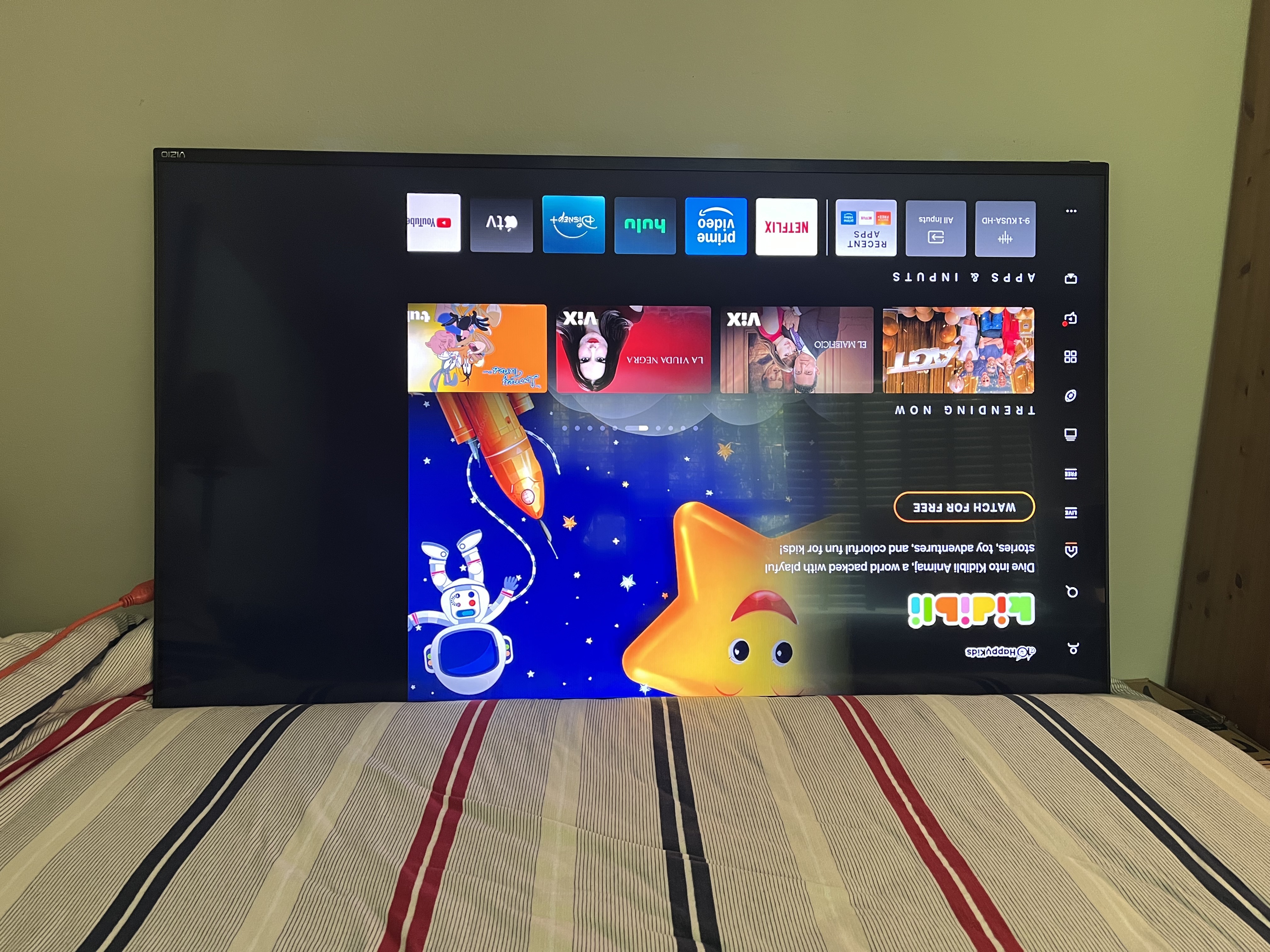

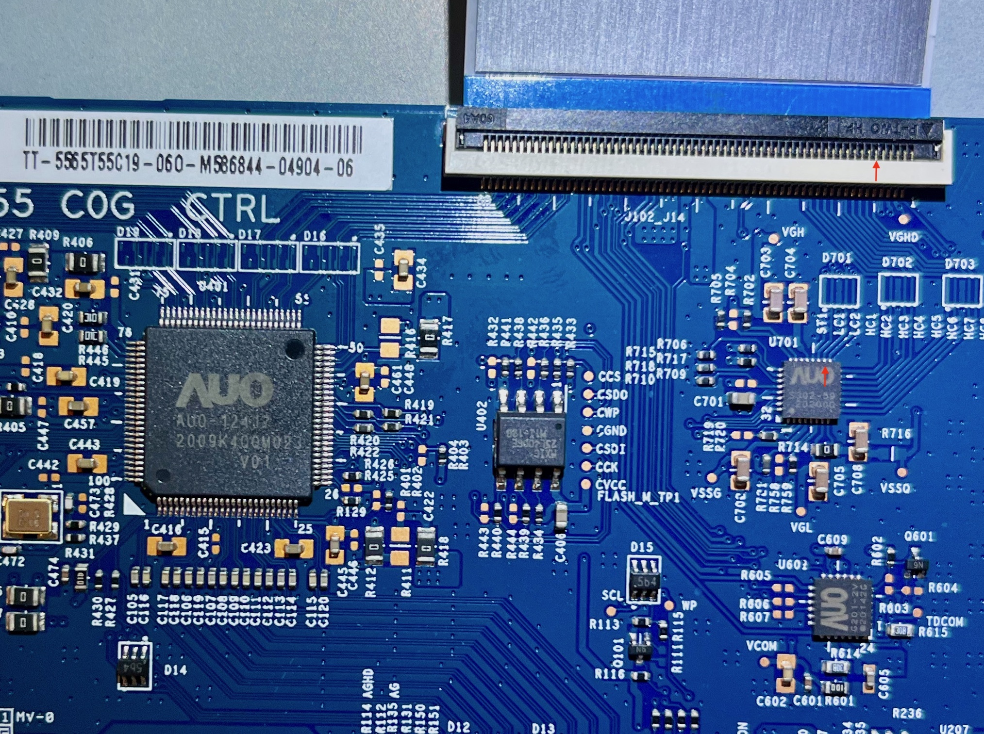

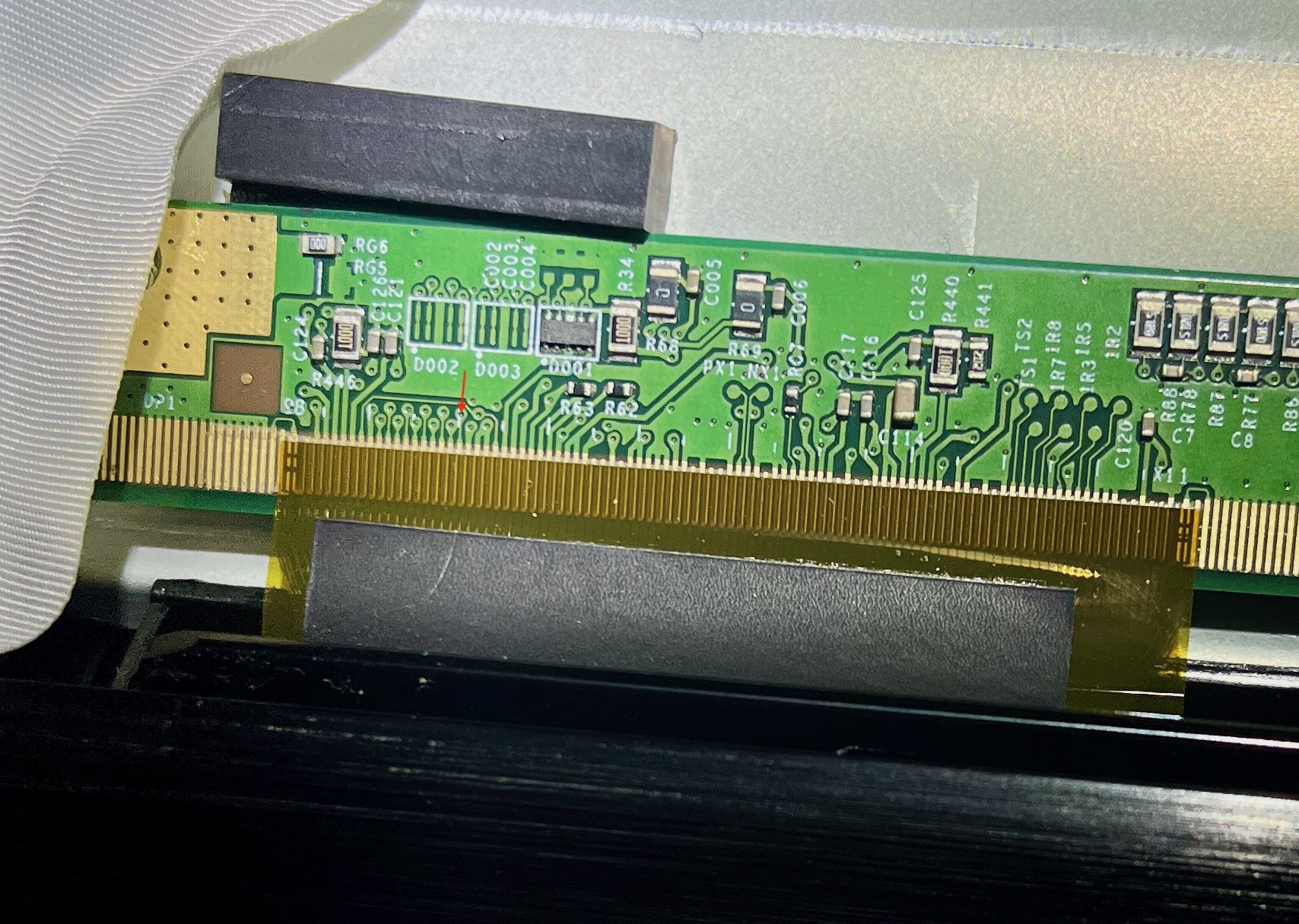

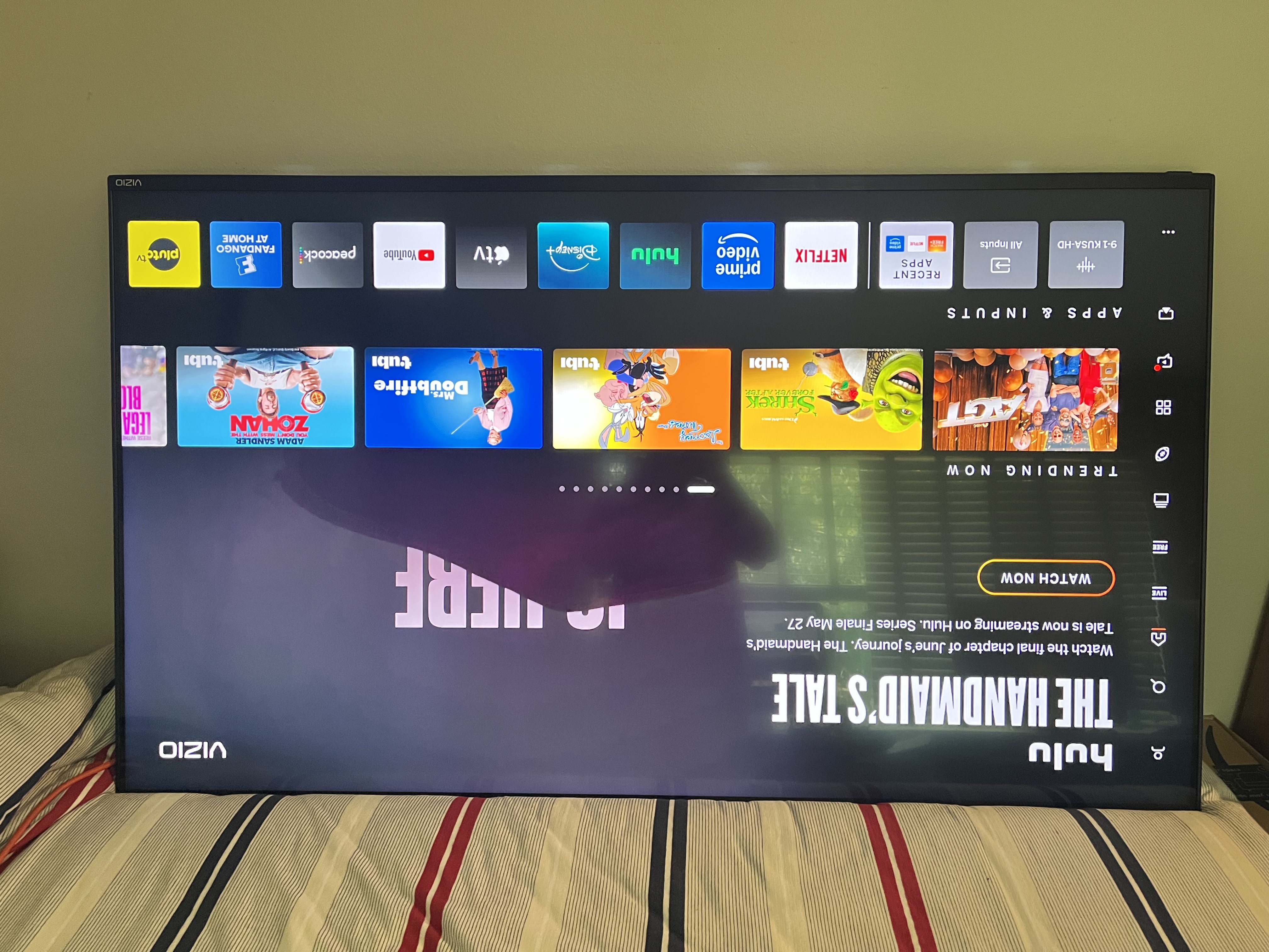

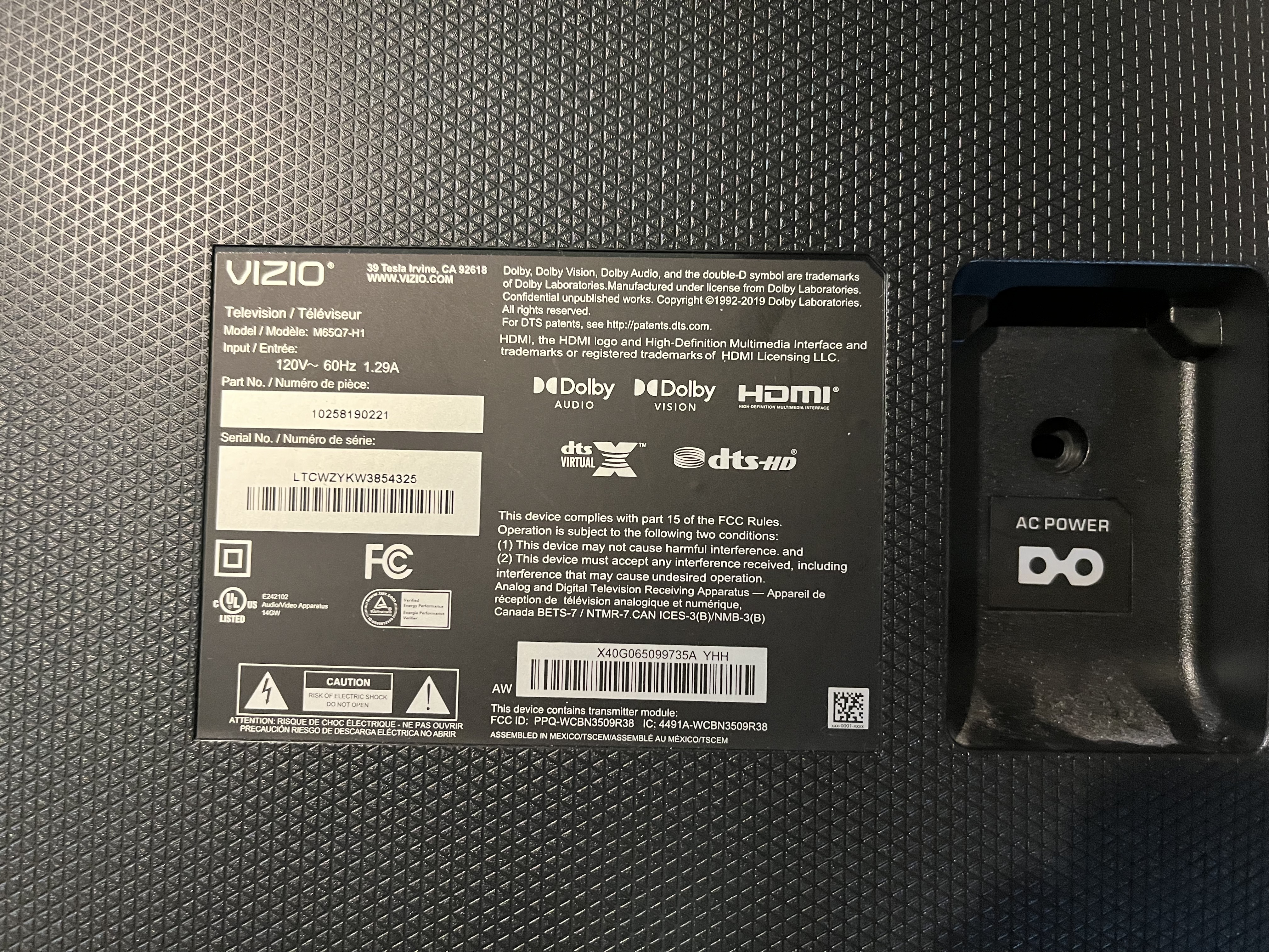

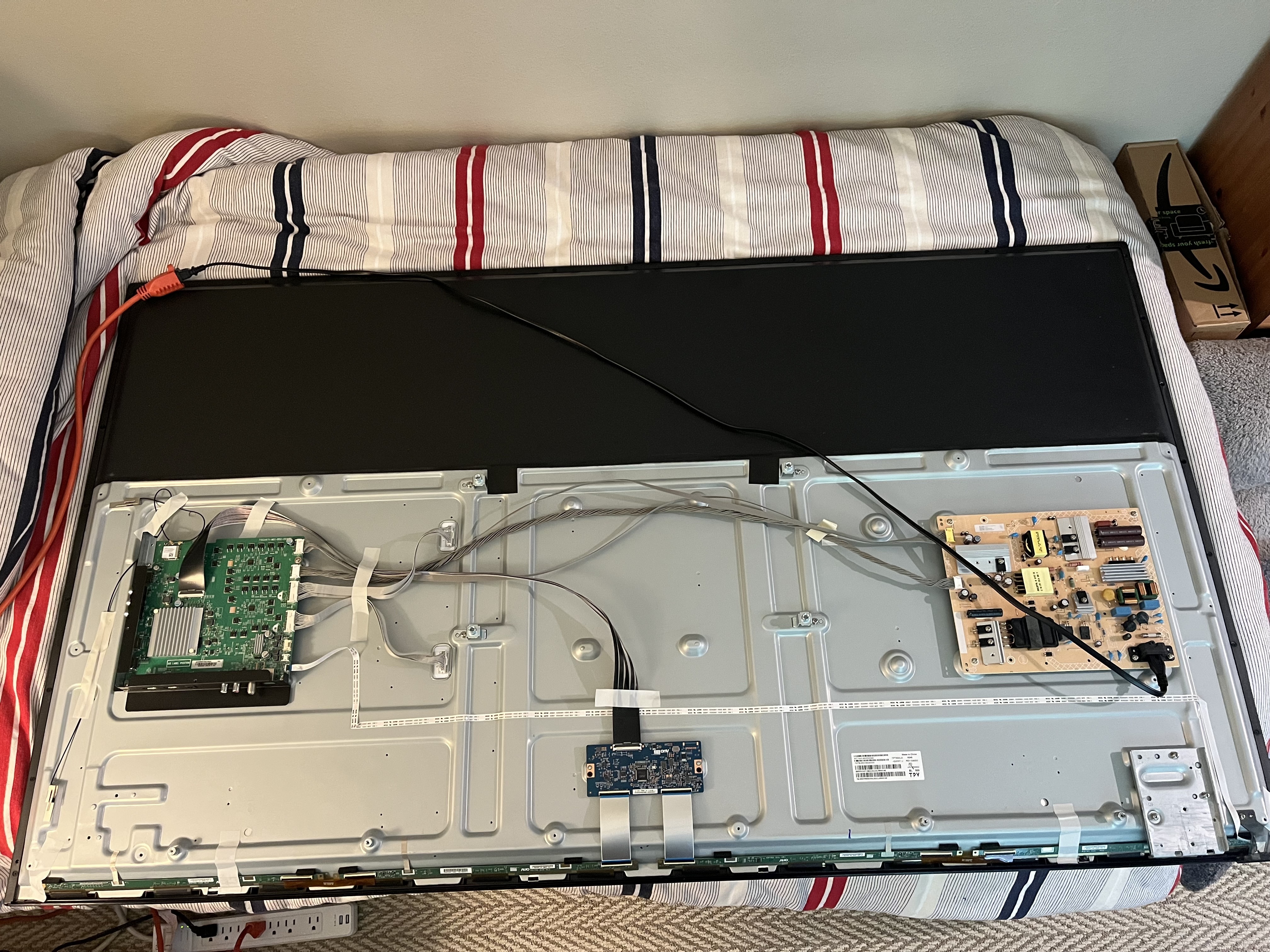

Vizio M65Q7-H1 Red Vertical Strips fixed by tape blocking LC1 signal to half of the panel
  • howardc64
    • Jun 2017
    • 650
    Vizio M65Q7-H1 Red Vertical Strips fixed by tape blocking LC1 signal to half of the panel
    Failure Symptom
    Click image for larger version  Name:	IMG_4268.jpg Views:	0 Size:	3.11 MB ID:	3646870 Click image for larger version  Name:	IMG_4276.jpg Views:	0 Size:	4.57 MB ID:	3646871
    No picture, just red vertical stripes. Google search shows quite common problem for these recent Vizio M series although red vertical stripe pattern may differ. Some call it "Netflix" boot screen haha.
    Where is the short?
    Panel has 4x buffer boards. Quickly found the 1/4 panel buffer board with the problem by selectively disconnecting buffer board flex cables.
    Click image for larger version  Name:	IMG_4269.jpg Views:	0 Size:	3.36 MB ID:	3646869
    Having recently fixed another Vizio with similar symptoms that was a shorted ESD diode array ( link ) Probed the ESD diode array but tested good. Also could not find any shorts on the buffer board anywhere. Finally used tape method and isolated to pin 6 which is the LC1 signal from the AUO S302-59 chip (can't find data sheet) Board labled this pin as LC1 signal. Tracing its path connects directly to COF/panel (red arrow point to where LC1 goes). Found this explanation ( link just read video descriptions ) on Vizio LC1 signal. Sounds like its vertical frame timing. Last pic shows perfect panel blocking out LC1 signal to the single buffer board.
    Click image for larger version  Name:	IMG_4275.jpg Views:	0 Size:	3.79 MB ID:	3646875 Click image for larger version  Name:	IMG_4271.jpg Views:	0 Size:	1.28 MB ID:	3646873 Click image for larger version  Name:	IMG_4273.jpg Views:	0 Size:	795.9 KB ID:	3646872 Click image for larger version  Name:	IMG_4274.jpg Views:	0 Size:	3.15 MB ID:	3646874
    Question
    Probably can't do better than flex cable signal blocking repair since the fault is likely in the COF/panel. Please advise if better repair is possible. Thanks
    Last edited by howardc64; 05-27-2025, 04:41 PM.
  • nomoresonys
    • Jan 2013
    • 12306
    • U.S.
    Another fine fix, thanks. Makes me wish I would have further investigated a vizio I gave away, that only had one fine red vertical line.
    Last edited by nomoresonys; 05-27-2025, 04:34 PM.
    • nomoresonys
      • Jan 2013
      • 12306
      • U.S.
      Interesting that blocking that one path fixed both red lines.
      • howardc64
        • Jun 2017
        • 650
        Interesting that blocking that one path fixed both red lines.
        yes, the short caused no display other than the red vertical stripes. Getting rid of the short allowed the panel display circuit to function properly. LC1 is surely redundant on the other edge of the panel so now just relying on that one.
        If you had single vertical line and if the rest of the picture shows, then its a different problem.
        • nomoresonys
          • Jan 2013
          • 12306
          • U.S.
          Ah, I see, so mine was a different issue, had a normally functioning display with just a fine red line. I think it was a bad connection on a tab bond. Hell I'll never know for sure now that it's gone. My curiosity is still there, I just can't justify putting in the time, being a slow learner with horrible memory...it's a losing battle for me.
          Last edited by nomoresonys; 05-27-2025, 05:15 PM.
          • howardc64
            • Jun 2017
            • 650
            After seeing this post ( link ) where TVS (Transient Voltage Supressor or also know as ESD Diode Array) tests good with diode test and no shorts but still caused a failure. Decided to relook at this TV again. Confirm the LC1 signal is connected to the TVS (D001, pin 2 red arrow in picture). Removed the TVS and the ribbin connector tape block for LC1 and TV works!
            TVS is 4266H ( prior Vizio with TVS failure I fixed was 4264H link ) Replaced with littlefuse SP1064E (they sent me 5x requested sample, had 4 left over after last Vizio repair) and TV is good as new and properly fixed I guess I've got 3 more TVS to fix 3 more Vizios/HiSense
Name:	IMG_4273.jpg
Views:	251
Size:	898.6 KB
ID:	3670299
            • lotas
              • Jan 2016
              • 4787
              • Russia
              If the zener diode in the assembly has a leak and not a breakdown, then it cannot be checked with a multimeter.
              • howardc64
                • Jun 2017
                • 650
                Originally posted by lotas
                If the zener diode in the assembly has a leak and not a breakdown, then it cannot be checked with a multimeter.
                Very good point. I guess if a blocked signal that revives the TV is connected to TVS, then TVS is suspect. Easy test is just removal. Hot air station is probably must for this 2.5mm x 1mm 10 solder point component.
                Last edited by howardc64; 06-28-2025, 03:47 PM.
                • otaku_nut
                  Vizio E701i-A3 fixed but now has red vertical line
                  by otaku_nut
                  Hi all, I tried searching the site for answers but I'm a bit over my head understanding some of what might apply and what doesn't, so please be patient with me. I used Freakaftr8's fix to remove the left driver board to restore picture to a black screen with sound Vizio E701i-A3. After doing so, I now have a large red vertical stripe down the center of the screen. The fix did require getting another t-con board from online, I ordered it before I knew about the mosfit fix for the old t-con board. I have tried cleaning the cable connections to the t-con board. I swapped the cables going from...
                  08-19-2025, 06:11 PM
                • howardc64
                  by howardc64
                  Problem
                  08-04-2024, 10:36 PM
                • tmhobadcap
                  VIZIO M60-C3 Can the vertical line be fixed?
                  by tmhobadcap
                  I am trying to help my friend to fix his Vizio tv with a vertical line on the screen. The line is on the right side. It is blue/purple on the right side starting from the top. But it only goes to about 3/4 of the screen height (not to the bottom of the screen). It is very obvious when the screen is dark and it is hard to be seen when the screen is bright. Please help....
                  02-05-2023, 03:37 AM
                • brad2157
                  Vizio E70-E3 Two white vertical lines
                  by brad2157
                  I picked up a Vizio E70-E3 for free that shows Vizio logo and then goes to a black screen. Original owner said he started having wifi issues and then he tried to reset the TV and that's when it wouldn't boot up any longer after his reset attempt. I picked up a replacement main board from eBay that matches the same model # board as the original from the TV.
                  Original main board - Shows Vizio logo when TV powers on, then goes to black screen. Doesn't boot up. No screen issues with any lines on start up Vizio logo.
                  Replacement main board - Boots up fine, but starting...
                  12-13-2021, 05:11 PM
                • RetroComputingGrotto
                  IBM LTO 7 Tape Drive - Dust Sensors??
                  by RetroComputingGrotto
                  I have a Quantum SuperLoader robotic tape library that uses an IBM LTO 7 tape drive which is constantly complaining that it needs cleaning. If you insert a cleaning tape, it performs the clean and resets the cleaning counter to 0 hours. It should only require cleaning every 50 or so working hours but after as little as just 1 hours use it requests cleaning. We've purchased a new cleaning tape along with new LTO backup tapes but that has not resolved the problem.
                  I have taken the library apart and can see no noticeable signs of dust inside. I have removed the tape drive from the...
                  09-19-2024, 01:54 AM
