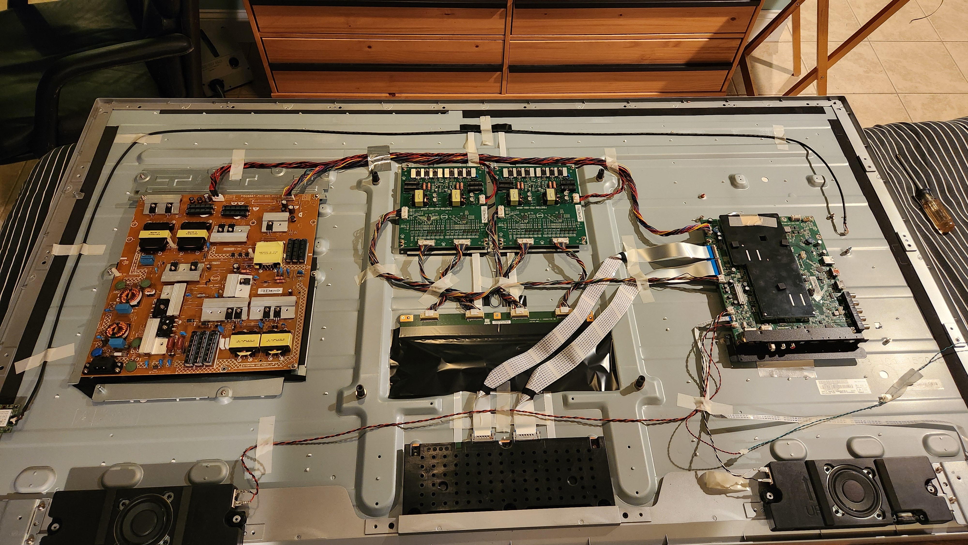

    Hi.

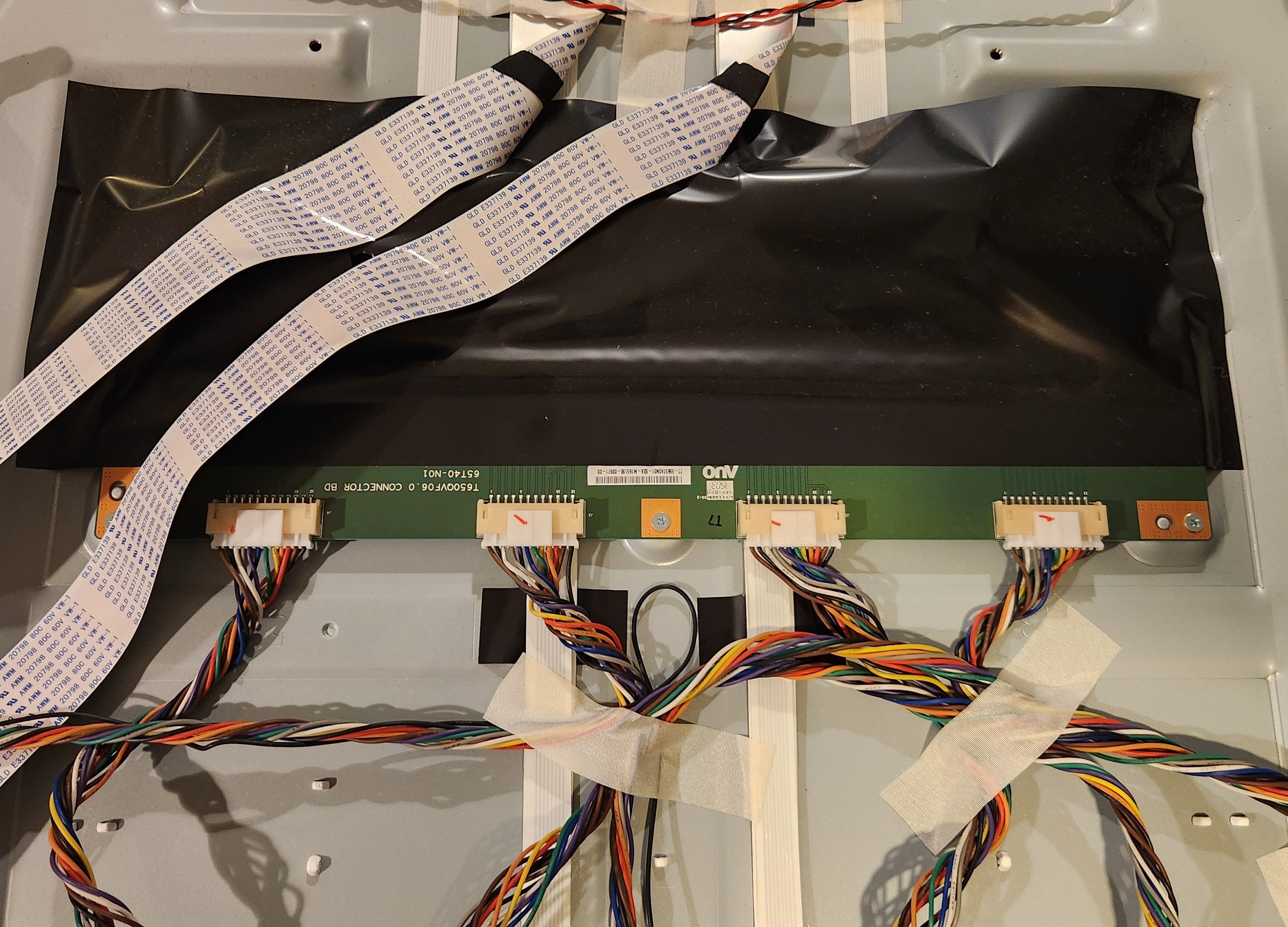

    picked up another TV. This time is a Vizio M65-C1. TV does not turn on. I had repaired another 60 inch vizio , Bad main board.
    When power button is pressed, the Power led indicator on the bottom right, turns for a few seconds and then it fades away. No backlight or Vizio logo on screen. Removed back cover and repeated test.
    This is the TV Click image for larger version

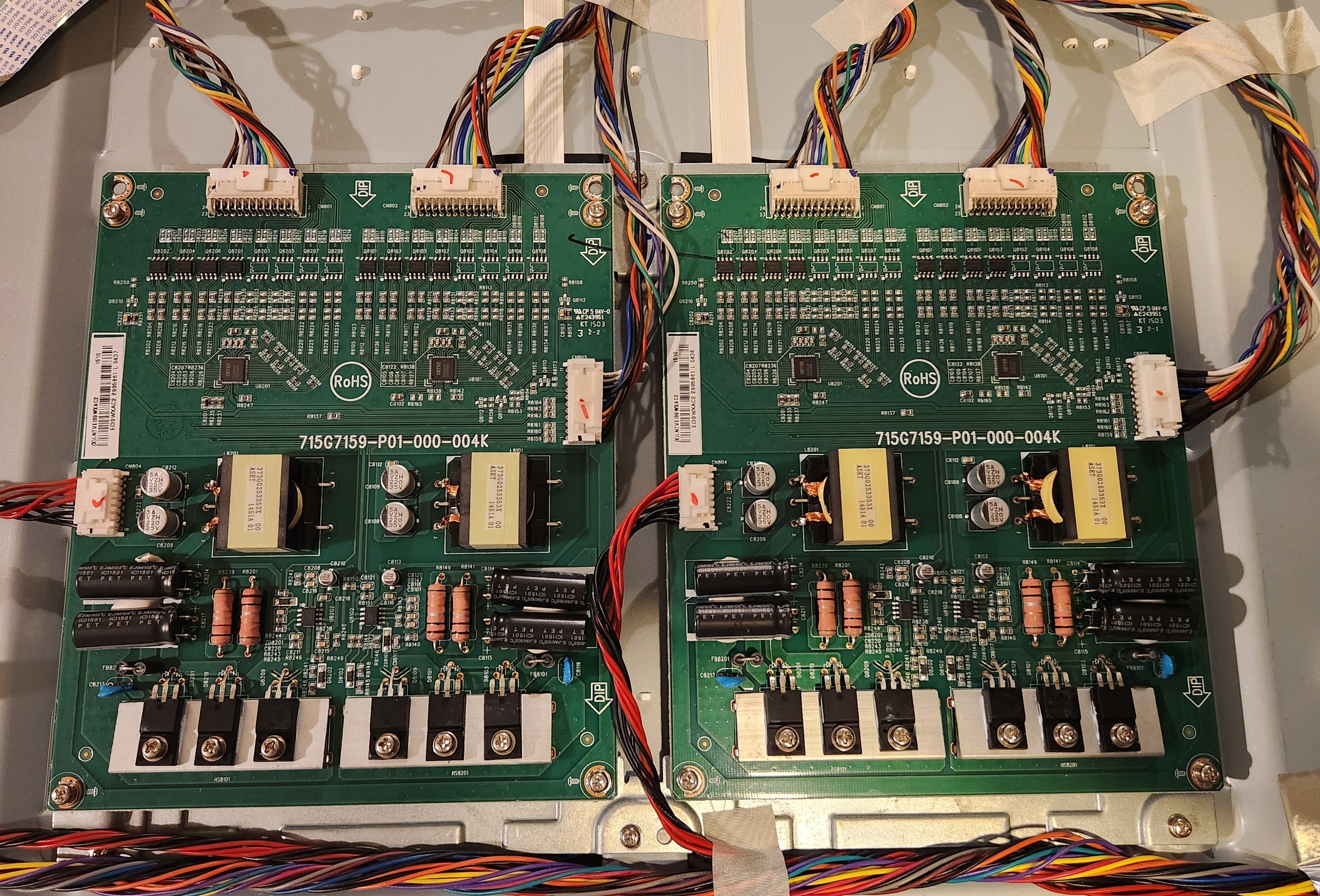

ID:	3682443This TV is a little different from the Samsung I have worked on. Power supply is on the Left side, Main Bd is on the right side, T-CON , not in the picture is on the bottom. I am assuming that the boards in the middle are the LED Drivers. Why 2 boards and what is the function of each one? Click image for larger version
Name:	LED Drivers_2.jpg
ID:	3682445Click image for larger version
Name:	LED Drivers.jpg

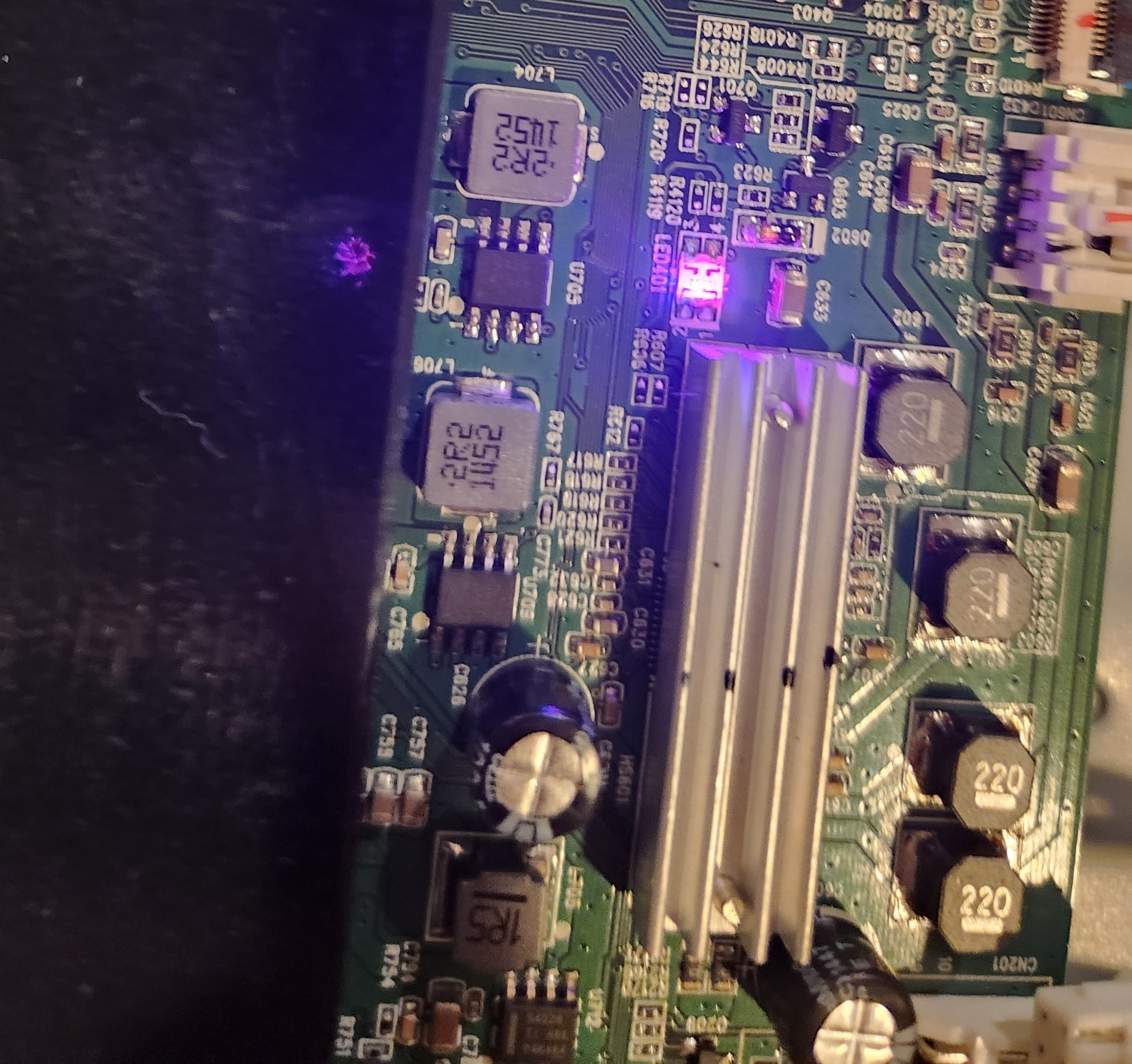

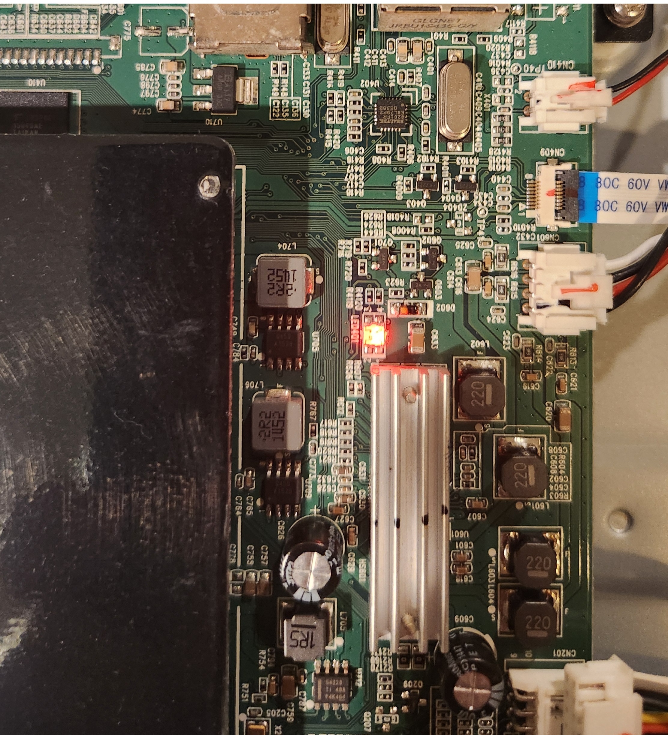

    When power cord is connected to PS board, one RED LED on main board turns on and stays onClick image for larger version
    . Checked voltages at power board and everything looks normal. I have +24V, +19V. The other connector going to main board has :
    ON / OFF = .147V
    Dim = 3.3V
    PS _ON = 3.6V
    When power button is pressed, a smaller Pink LED turns on next to the RED one and stays on Click image for larger version
ID:	3682440 until power button is pressed again. The power LED indicator turns on and fades away. When power button is turned OFF, the RED led stays on. No indication of LED turning on or Vizio LOGO on TV

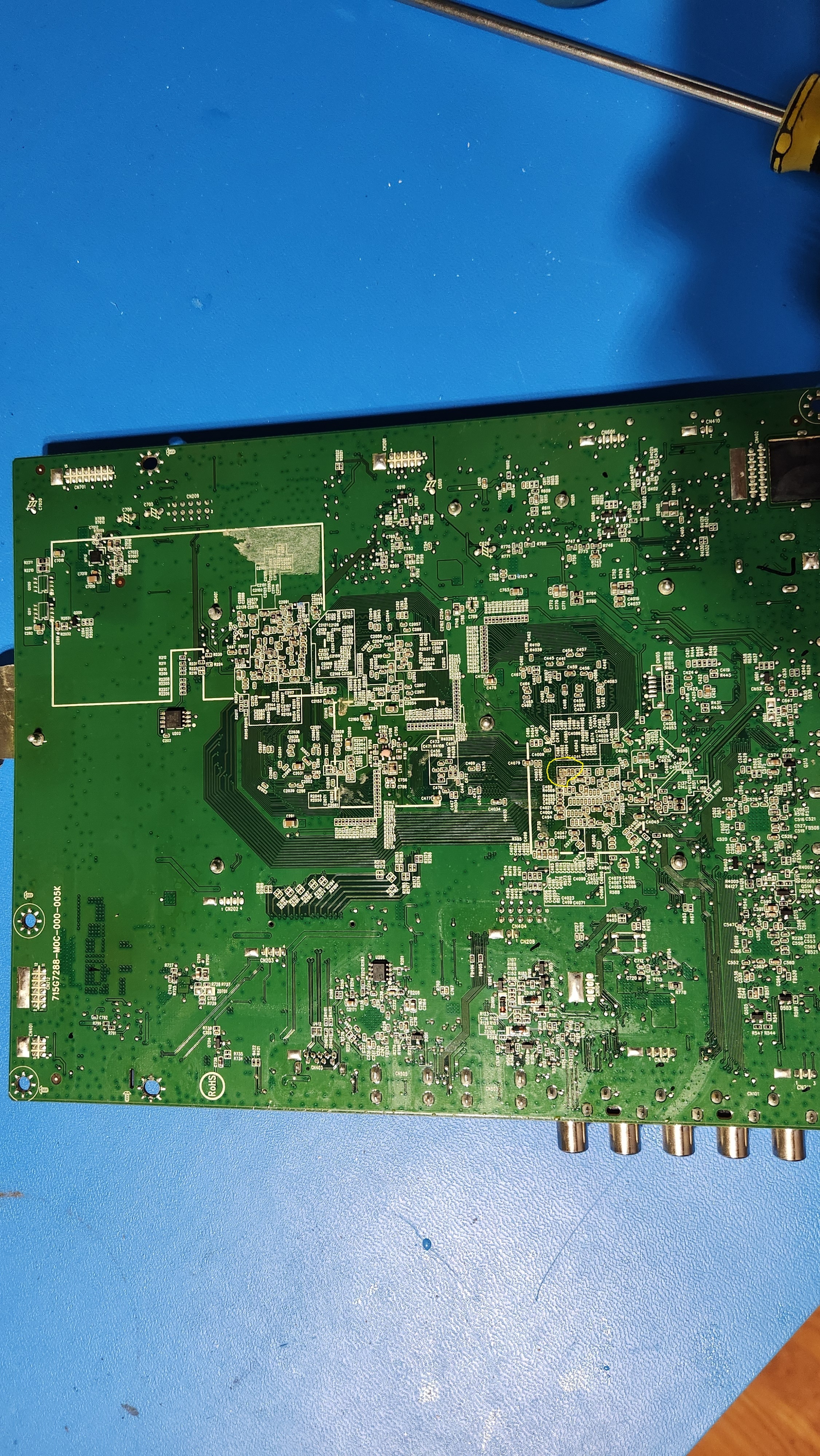

    Removed main board Click image for larger version

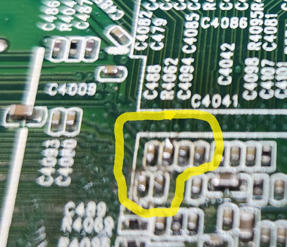

ID:	3682442 and check ed some capacitors under one of the main CPU and noticed that some them, measure between 7-10 ohms. Click image for larger version
Name:	Faulty capsjpg.jpg
    Removed all the capacitors in questions but small resistance value is still there. So, I am assuming that somehow the main board is defective and the fact that I read that small resistance value accross those capaitors is an indicator that either and internal short / has happened.
    Wanted to be sure I am not missing anything before I order a new main board.
    Thank you in advance for any suggestions.

    Most common failure is cracked BGA solder balls on the main board BGA chips under the 2 depressed rectangles in the heat sink. Proper BGA removal and reflow is necessary for long term fix (over bake or hot air gun/dryer fix usually don't last long) And need to know enough about heating boards to not do more damage (cold garage floor on bottom and hot air on top will usually warp + crack something)
    https://www.youtube.com/watch?v=XjB5vwSqDg0
    https://www.google.com/search?q=m65-...t=gws-wiz-serp
    On main board, not all low ohm caps are shorts. SOC CPUs need ~1v and operates in GHz speeds. So their voltage rail filtering caps to ground is super low resistance. Think of it this way, if you need to clock fast to GHz, need low resistance So if the caps are on low voltage rails (1v = CPUs/GPUs, 1.8v = DRAM, 3.3v = eMMC), its likely the correct design.
    BTW, easy solution of just replacing the main board are often costly on these Vizios with similar shaped heat sinks. Its because so many fail and most people don't have access to proper BGA remove/reflow equipment like above video. So pricy due to low supply and high demand.

      Yea id agree, likely a reflow of bgs chip. I have this exact TV same problem. Although I didn't watch the main board while reflow and it bent it and no longer works lol so oh well.

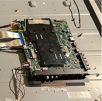

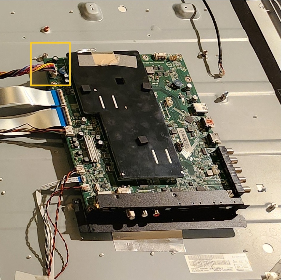

                After further inspection I have noticed that maybe some components are missing from this device on the bottom side of the board close to the connector that carries signal to the power supply.
ID:	3685570 Click image for larger version
                can anybody help me confirm if those locations are filled? what about the value ?
                Thank you
                Massimo

                  Generally, not all pads are stuffed with components.
                  Unfortunately, the section is below bottom heat sink so not many pics show such area
                  https://www.shopjimmy.com/vizio-756t...masnar-serial/
                  You can go through posts for searching "M65-C1" on badcaps.
                  https://www.badcaps.net/search?q=m65...22m65-c1%22%7D
                  These ~2015 era Vizio main boards with BGA failures all look similar. Here is a video for heat sink removal but probably too low resolution and blurry from video motion blur to see area clearly
                  https://www.youtube.com/watch?v=TX6qu3m2O2M

                            Might want to make sure your solder joint there in the picture is good, not cracked, in that c706, c705 area, maybe touch it up with a bit of flux and new solder.

                                    Received a replacement board today. I could not wait to plug it in and see my TV turn on. Unfortunately the same behaviour remained. StandBy LED turns on and fades away and the OFF/ON signal at power supply board never goes HI/ 3.5 Volts. Am I missing something?

                                      If Replacement board is used, maybe it also failed? Very common on these Vizio main.
                                      You could check the inductors on main to see how many voltage rails the main board produces. Negative to board ground. Positive probe inductors (larger silver rectangular components) But this requires removing the heatsink which is quite difficult on these Vizio main boards. I think all the rails to run a processor (~1 for processor, ~1.8/2.5 for RAM, 3.3 for flash memory) all come on without needing code to run.

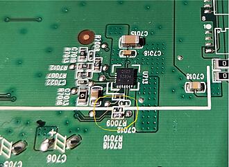

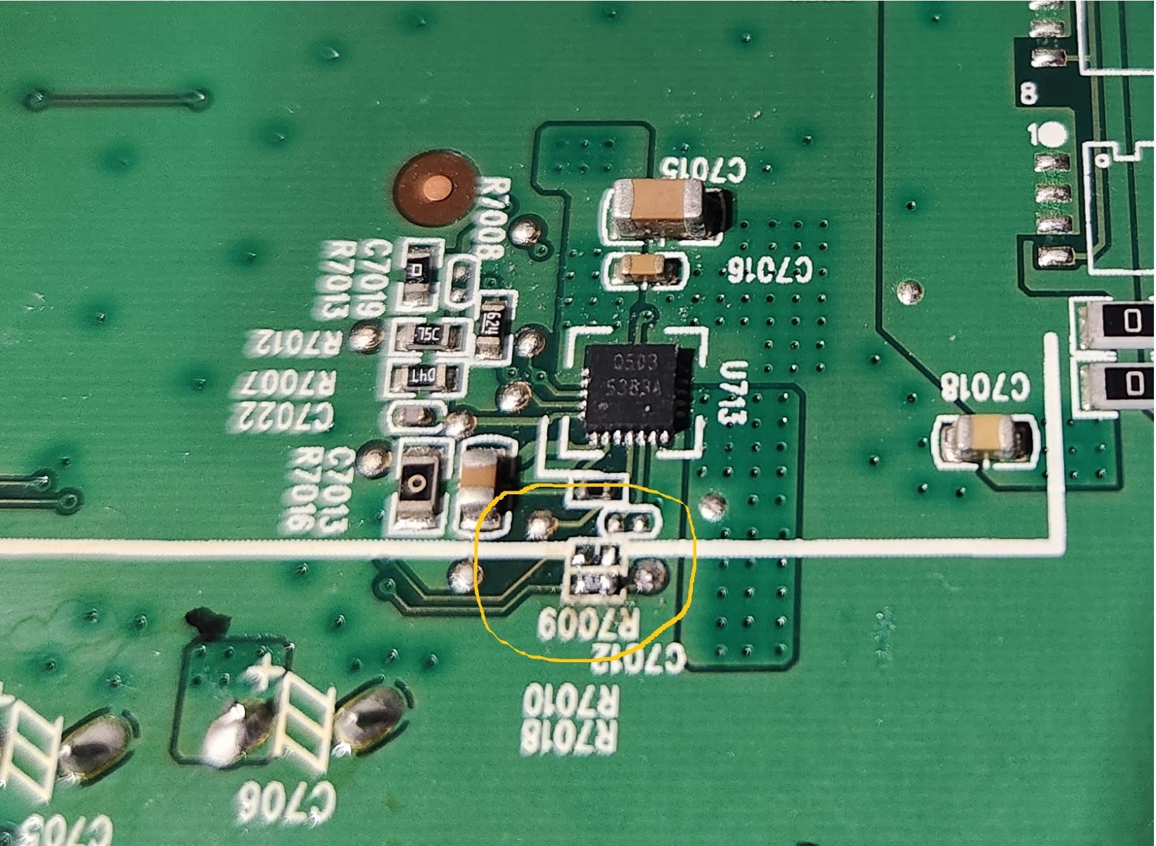

                                        Hi All
                                        I was able to revive the main board by removing the huge heat sink and reflow the 2 CPUs. Now the On/OFF signal to power supply is at 3.3V when the power button is pressed. The backlights are turning on but no image on the screen. I figured out the there is no 12V on either side of the FUSE on the T-Con board. This voltage comes from the main board. No shorts on the main board for 12 V but it looks like the voltage is generated by this IC U713 on the back side Click image for larger version
ID:	3708772 (Q503 5383A are the markings on the IC). The output of this IC, is exactly where the Ref. Des. U703 is located in the image and is directly connected to the 12V going to the T-Con board. Can't find the spec sheet.
                                        Did anybody ever find this issue? Also I suspect that the location circled in green still has a missing component.
                                        Thank you again for your help.
                                        Massimo
