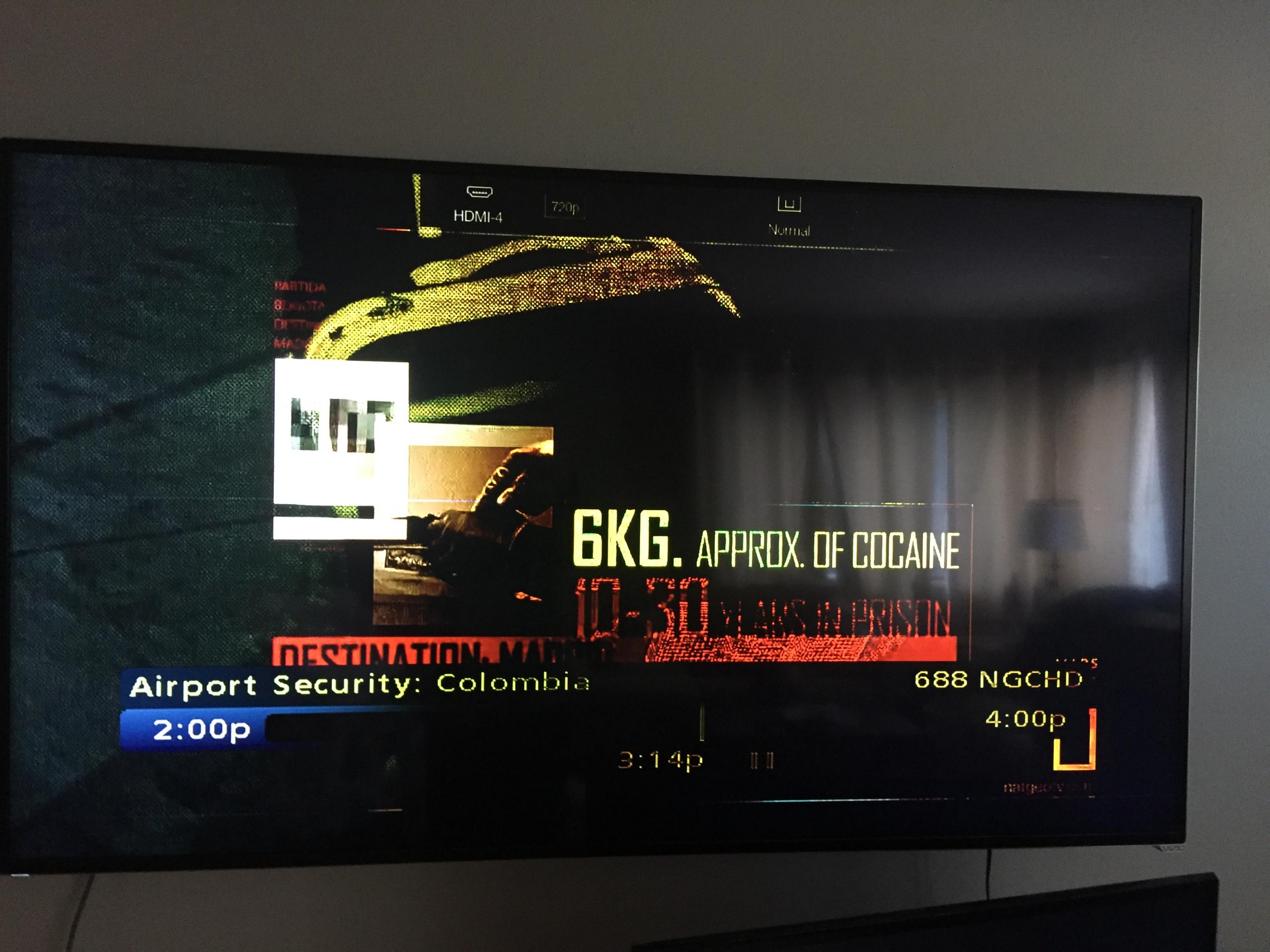

    Vizio m701d-a3r disorted picture
    looking on advice on how to fix , I have experinece with a multimeter and replacing lcd panels. I read freakaftr8 post on defective side tabs, could this be the same case?? and mine is a 3d tv his wasnt. Would that matter?

    Re: Vizio m701d-a3r disorted picture
    I have same problem with my m701d-a3r.
    Do you find a solution?
      I would check the backlight circuit and backlights first to rule them out as the defect.
        I'm not 100% certain but it looks very much like a side tab issue which has been discussed widely on the forum. Do a forum search and see what you think.
          +1 for side tab issue
            Yes this is a side tab issue. Just repaired one the other day same exact symptoms as the e701 series. This has a different bezel surround so it's a little more intricate to pull apart. All done from the back side. The driver boards on the side are located behind the panel on a black plastic housing assembly. You need to remove the screws hold the driver boards in slipping away disconnect the frame and pull it back and carefully remove all tabs feeling way from the panel on the defective side. This side would be your right side which is the darker side of the picture
