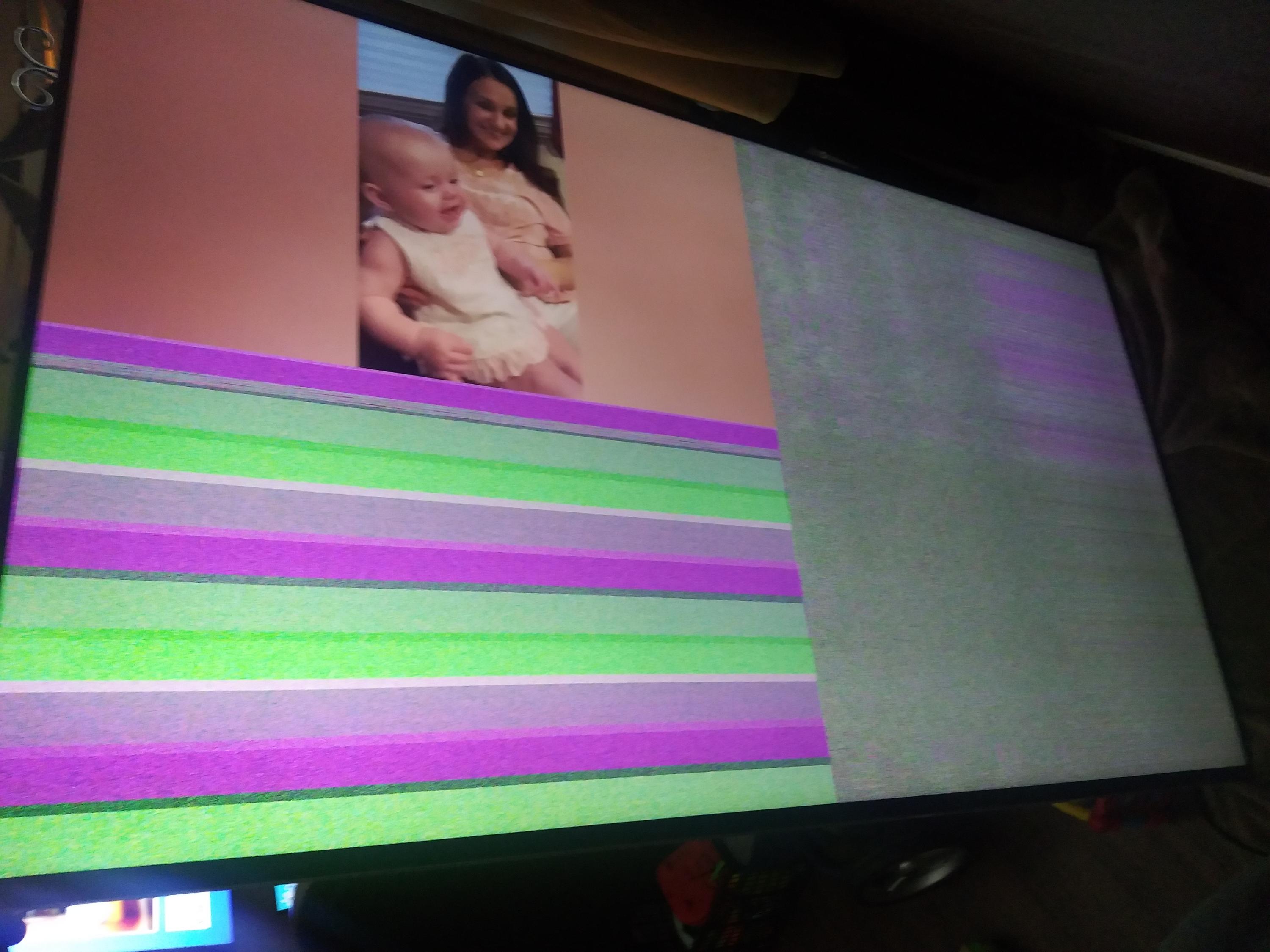

    Hello, i am working on Vizio M70-C3. It can hardly power on, it takes 15 power button presses or remote. Seems like eeprom problem that I seen before but all reading online says that this tv has power board or main board problem.

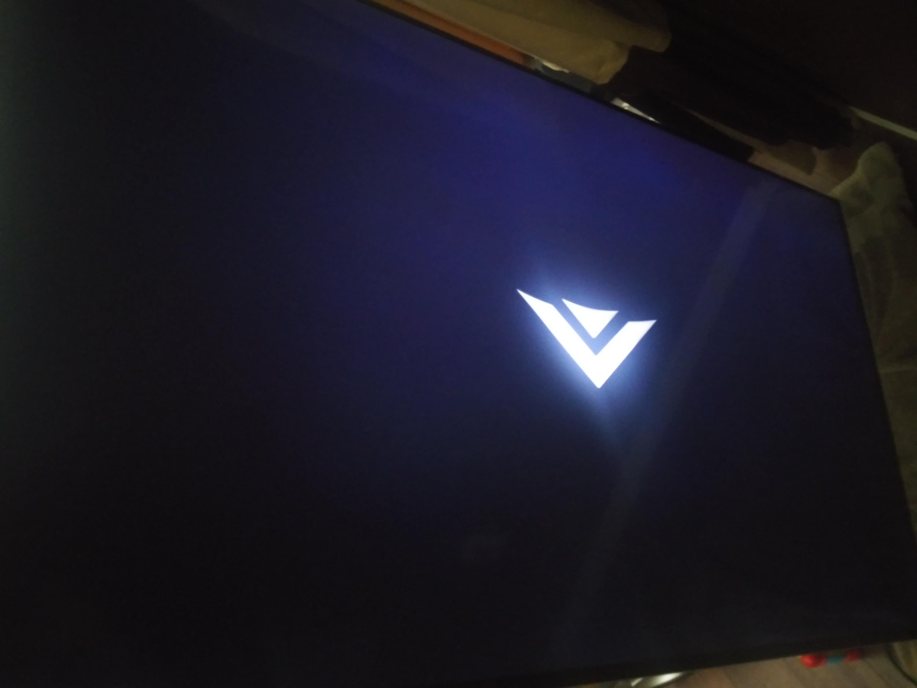

    When tv powers on vizio V logo shows nice on whole screen. picture 1

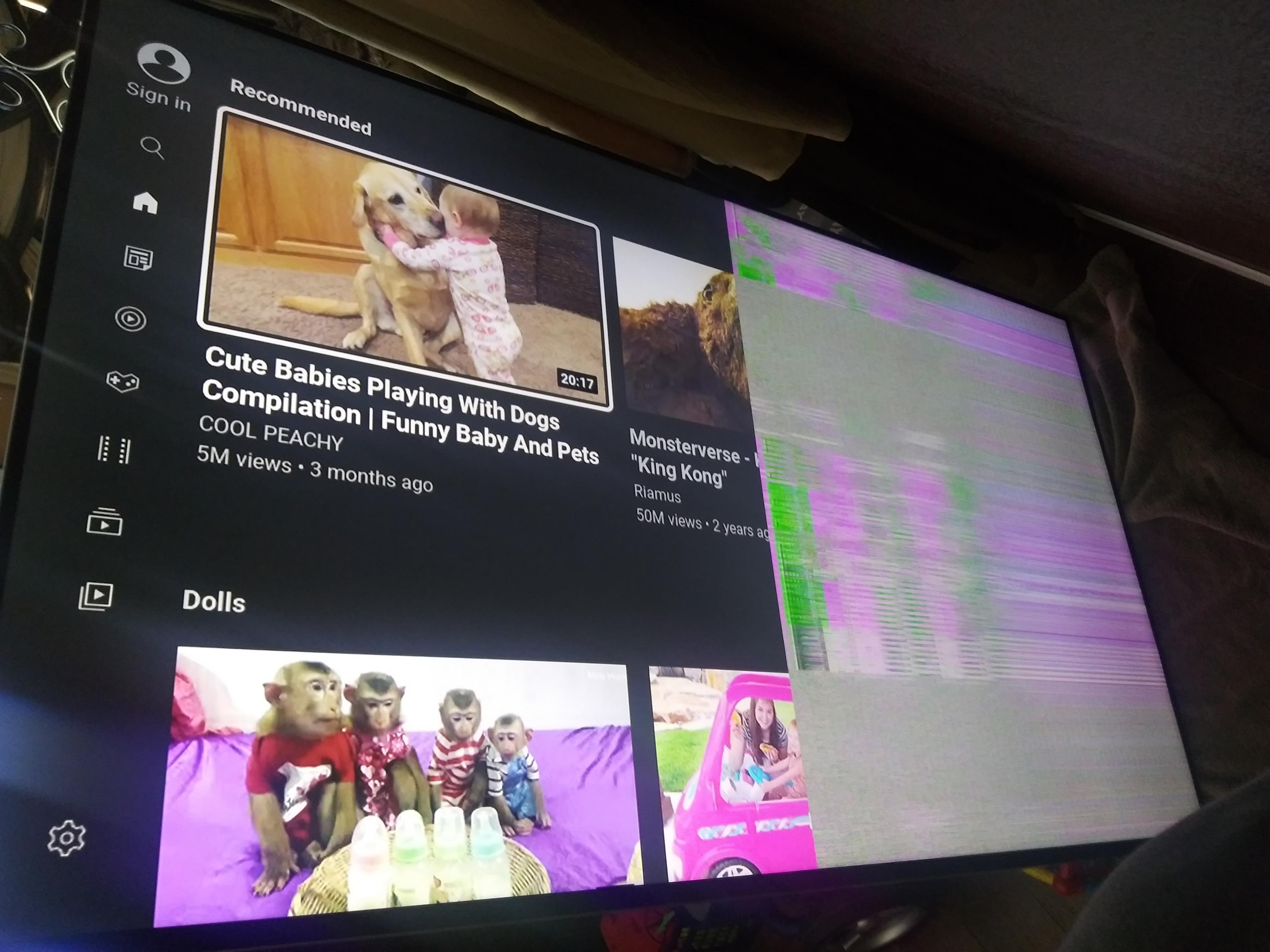

    When it goes into tv mode it only shows good picture on left side of screen, right is all scrabbled up. pic 2
    When i start youtube picture shows on left side fine, right is all scrambled. pic 2
    When i click video to start playing picture goes black(like when you change resolution on monitor) and picture only shows on 1/2 of left side. only 1/4 of whole screen is now working. pic 3
    After playing like this tv shuts off and again problem to power on.

    There is no substitute for this.
    The best options are reballing or instaling new chips if you can find them.

      I had this same exact problem. Turned out to be the chips under the big heatsink on the mainboard. I got lucky with an easy fix. All I did was took heatsink off and put new thermal paste. TV still working after 2 months.
