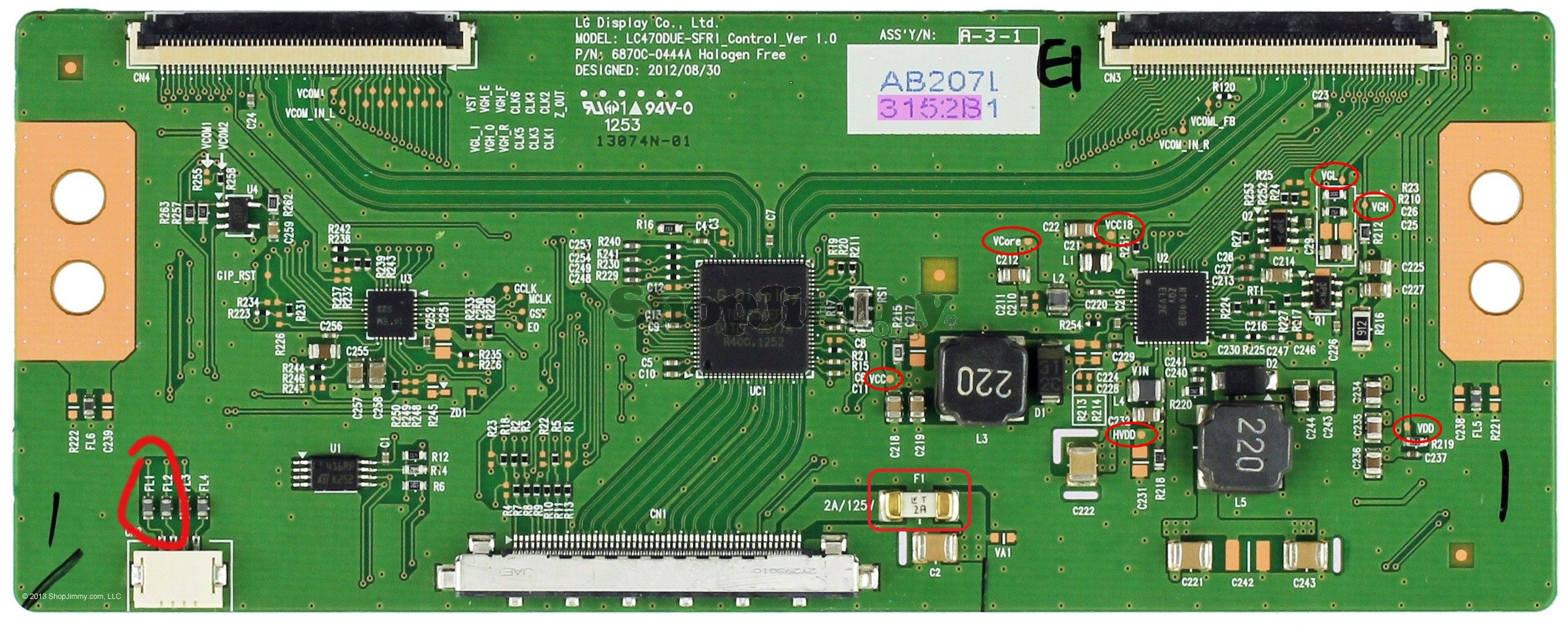

            #85
            Re: LG 47LN5200_U: PWR, MAIN, and all LEDs replaced, no picture
            Please check the DCV (when TV is turned ON) at those test points I have marked: Black probe on the chassis.
            VCC =
            VCC18 =
            VGH =
            VGL =
            VDD =
            VCORE =
            HVDD =
            • JDC
              • May 2015
              • 273
              #86
              Originally posted by budm
              please check the dcv (when tv is turned on) at those test points i have marked: Black probe on the chassis.
              Vcc =
              vcc18 =
              vgh =
              vgl =
              vdd =
              vcore =
              hvdd =
              vcc = .026
              vcc18 = .025
              vgh = .022
              vgl = .050
              vdd = .018
              vcore = .022
              hvdd = .024
                #87
                Originally posted by JDC
                vcc = .026
                vcc18 = .025
                vgh = .022
                vgl = .050
                vdd = .018
                vcore = .022
                hvdd = .024
                This is done with the TV powered ON? You have 12V feeding the T-CON fuse F1 but the switching power supplies are dead. Based on those Voltage readings you have made the T-CON board is dead at this point.
                BTW, I hope you did the test correctly.
                • JDC
                  • May 2015
                  • 273
                  #88
                  I'm pretty sure I did the test correctly. I had to run my pos. probe over a file to 'sharpen" it a bit as I wasn't sure I was hitting those small areas correctly.
                  In any case, I've got a TCON on its way.
                  EDIT: Yes, the test was done with the TV on.

                                #95
                                So you still have 12VDC at the F1 fuse of the NEW T-CON but no DCV on any of those test points?
                                • dick_barton
                                  • Aug 2015
                                  • 6643
                                  • Wales
                                  #96
                                  Something is not right!!!!!!!
                                  Do you flip up the tabs on the ribbon connectors to insert/remove the cables and then click them back down to lock the cables in place or are you pulling /pushing the flat cables into place???

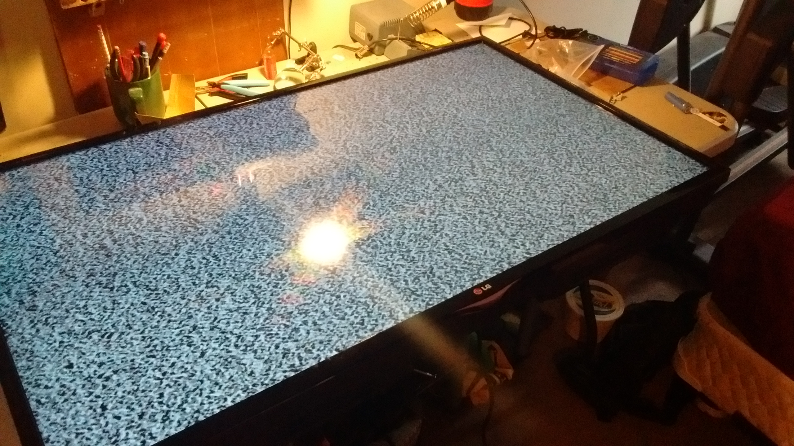

                                  • JDC
                                    • May 2015
                                    • 273
                                    #97
                                    WAIT! Oh man! I spoke too soon!! Hold on...
                                    • JDC
                                      • May 2015
                                      • 273
                                      #98
                                      I'm seeing snow on the screen! Stand by....
                                      • JDC
                                        • May 2015
                                        • 273
                                        #99
                                        *whew*
                                        Well, what did you think happened? When I put the new TCON in, I mustve not inserted the 2 strips in all the way into the panel, so I immediately posted the result here.
                                        I went for broke and redid it all. Snow, glorious snow on the screen.
                                        I intend to update the 1st post with the solution plus what I've learned from this.
                                        Thank you all so much. I learned so much from this experience, mostly to take your time and use a magnifying glass.
                                        EDIT: I guess I can't edit the first post. budm, dick_barton, diah, capleaker, and anyone else I missed, thank you so much for help me save the TV from the dump. I'm very proud of this!
                                        • dick_barton
                                          • Aug 2015
                                          • 6643
                                          • Wales
                                          #100
                                          Well done. Now to show us a picture on the screen.
