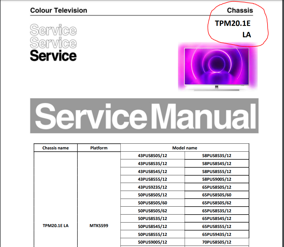

                        yours TV chassis TPM191E Android
                        The chassis of this TV is "TPM20.1E LA".

                          (58pus85
                          please look on the trusted page of Philips, and search after the NO he posted 8545
                          between we discussed this before... you link for HW and my for FW
