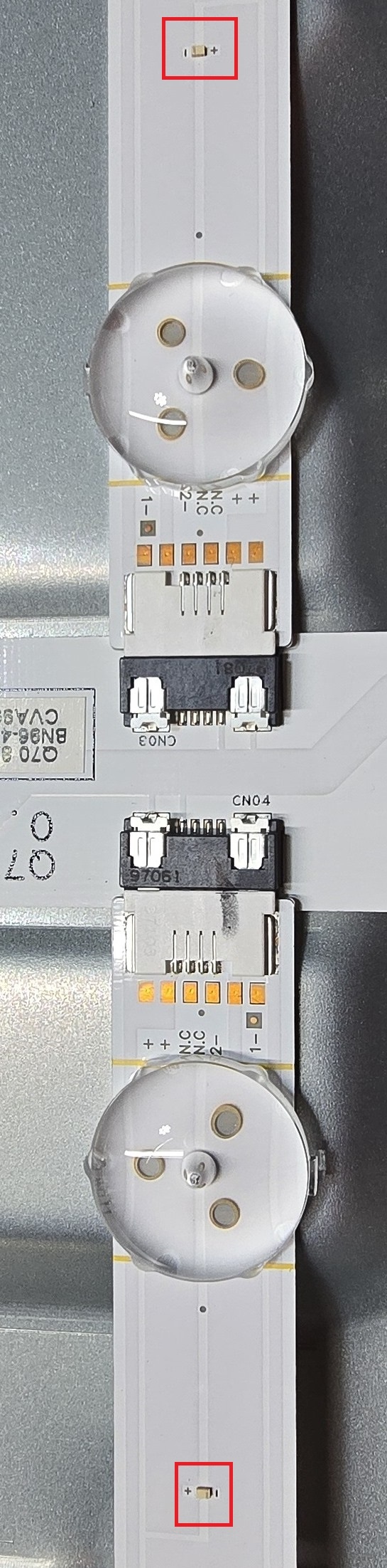

              about the zener i mean the external one on each strips

                Okay, what you have circled (squared) there is also that same diode in-between each led making one for every led. Only the inner one is which I should check?
                • Diah
                  • Feb 2013
                  • 6415
                  there are no inner one, what you are think its inner, in fact this one out side LOL

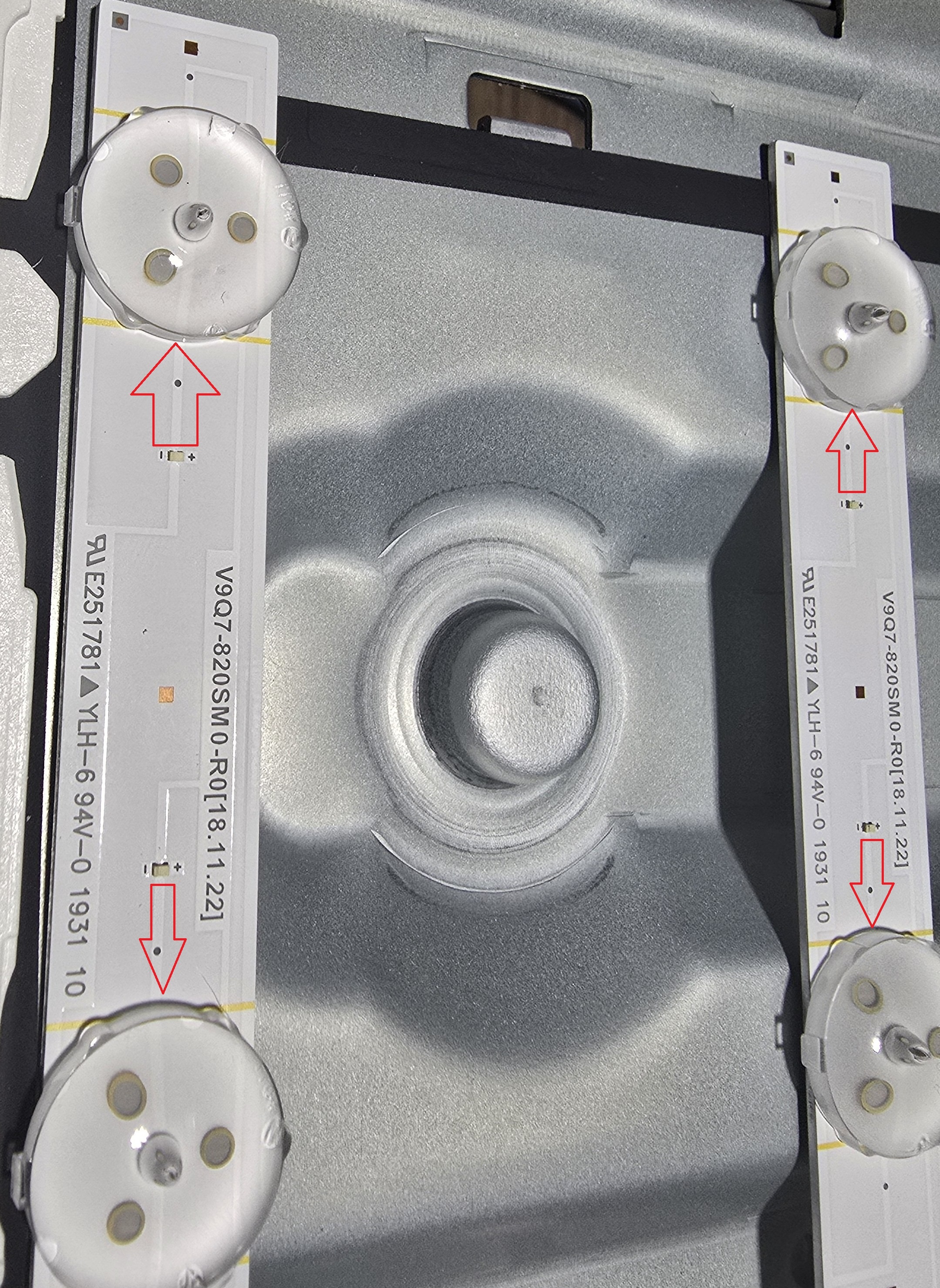

                    Every led has one in-between. That same diode is between every single led on every strip. There's 400 lights and there is 400 of these little diodes. Im not at home or id take a pic
                    • EazyBone
                      • Jun 2023
                      • 1351
                      • United states
                      In the pic there is one between each light. And two in-between the last one

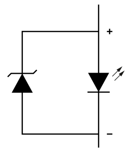

                            don't be confused , each LED will have one zener.
