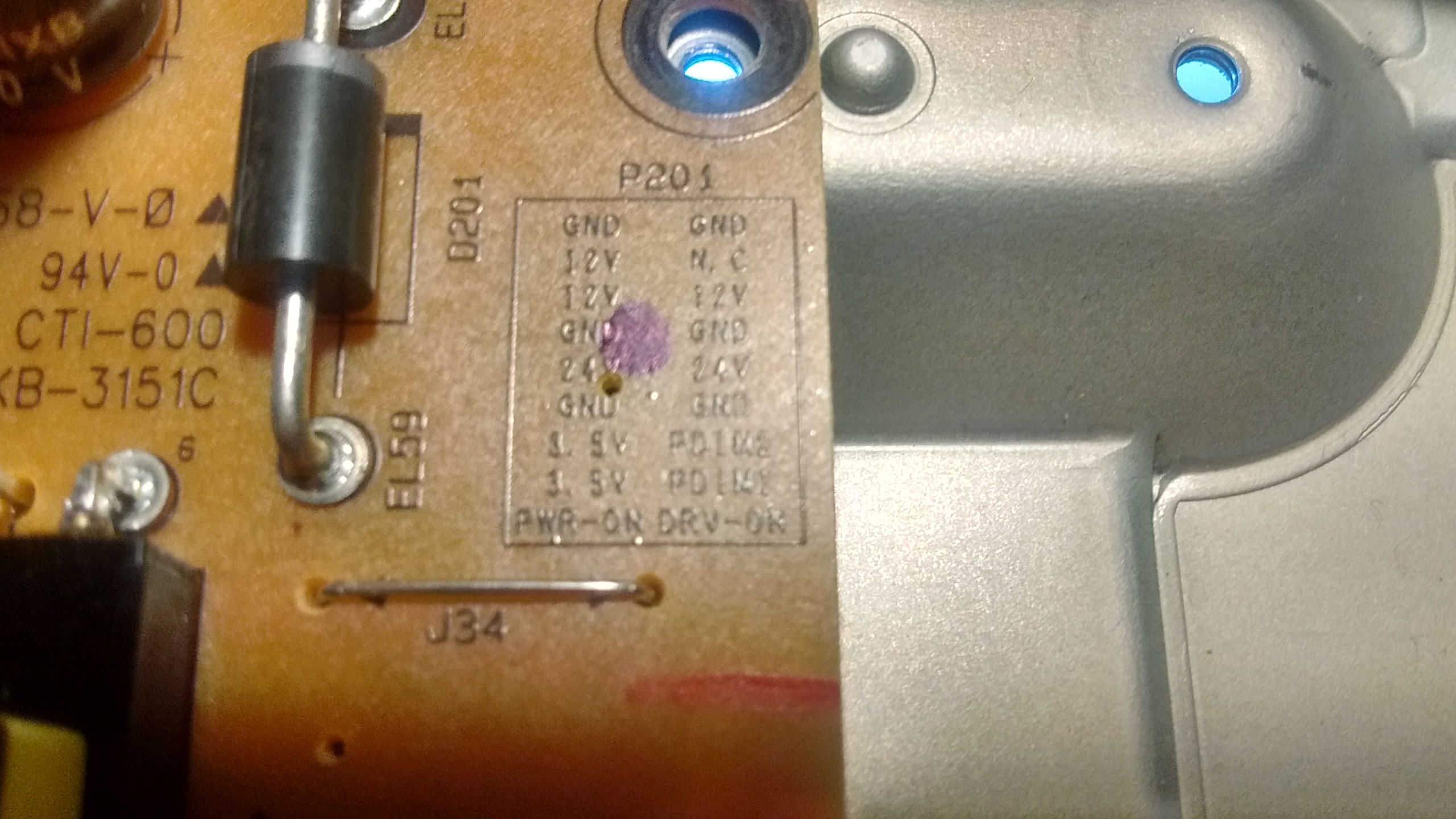

    Attached is a diagram for the connection from the power board to the main board. It says:
    P201
    GND GND
    12V N.C.
    12V 12V
    GND GND
    24V 24V
    GND GND
    3.5V PD1M2
    3.5V PD1M1
    PWR-ON DRV-ON

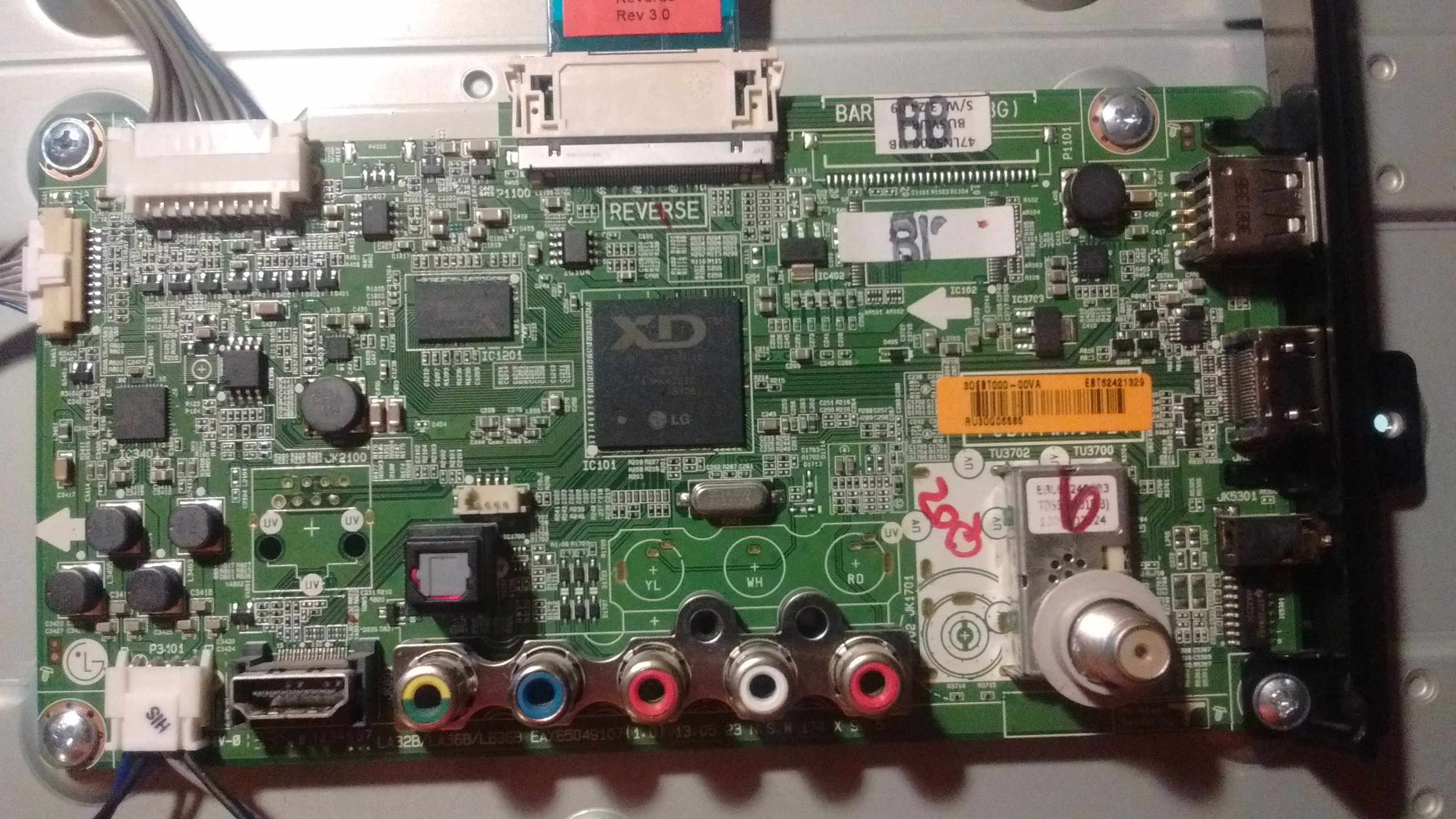

      Please can you provide some sharp picture of your main board which would be of help.
      Is this better?
      • JDC

        Re: LG 47LN5200_U: PWR, MAIN, and all LEDs replaced, no picture
        Originally posted by Diah
        from yours T-CON photo it show to me the left ribbon cable not correct sitting at the panel socket., take them both out and check the Gold pins of them, then reset them correct, as they labeled with hand writing they seem had story.
        Reseated, nothing out of the ordinary I could see, still no change. Thanks anyways.
            P201
            GND GND
            12V N.C.
            12V 12V
            GND GND
            24V 24V
            GND GND
            3.5V PD1M2
            3.5V PD1M1
            PWR-ON DRV-ON
            O.k., you measured GND, 12V, 12V GND, 24V, GND, 3.5V, 3.5V and PWR-ON.
            Where are the GND, NC, 12V, GND, 24V,GND, PDIM2, PDIM1 and DRV-ON measurements?

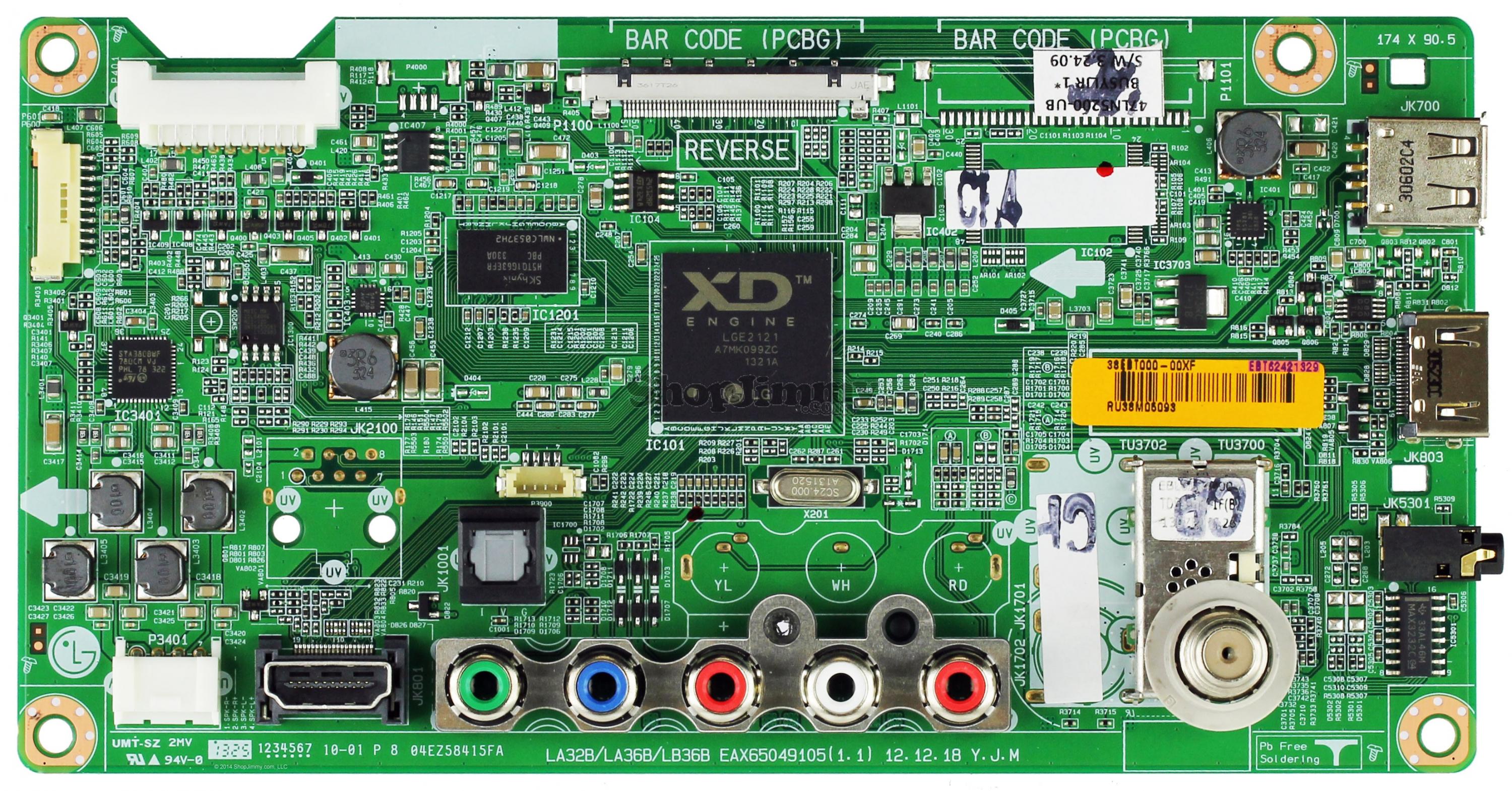

                            LG EBT62421329 (EAX65049105(1.1)) Main Board for 47LN5200-UB
                            http://www.shopjimmy.com/lg-ebt62421...7ln5200-ub.htm
                            Is this your main board?

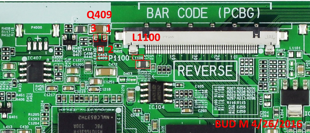

                            Check the resistance between BOTH ENDS the inductor L1100 to the T-CON fuse to make sure it has <1 Ohm resistance.
                            Check the DCV (ref. to chassis GND) of all 3 legs of Q409 when TV is OFF and when TV is turned ON.
                              While ON:
                              GND: 0 GND: 0
                              12V: 12.13 N.C.
                              12V: 12.13 12V: 12.13
                              GND: 0 GND: 0
                              24V: 24.47 24V: 24.47
                              GND:0 GND: 0
                              3.5V: 3.52 PD1M2: -.001
                              3.5V:.52 PD1M1:.984
                              PWR-ON:3.111 DRV-ON:1.010
                                Looks to be it.

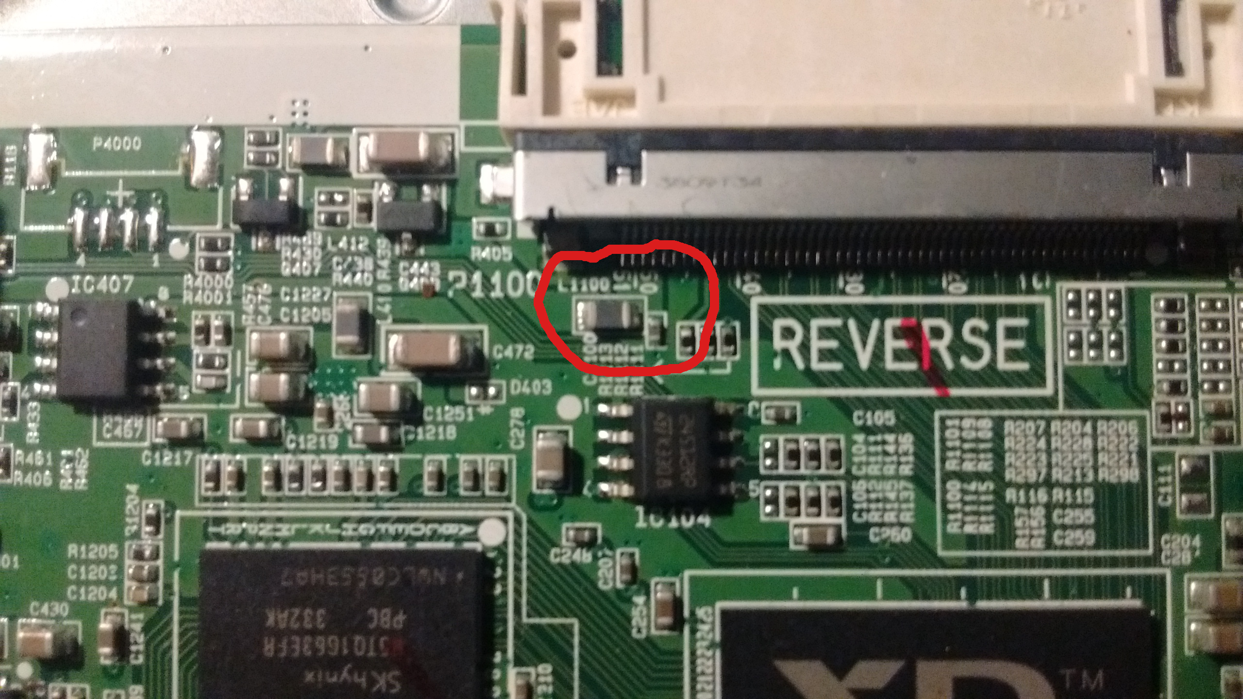

                                See attached. Are you referring to the circled component? If so, it measures -14.44 with every combination of probe placements (wanted to be thorough). Not sure I did this right.

                                  How about Q409 that have marked for you to test pin 1~3?
                                  https://www.badcaps.net/forum/attach...0&d=1461687797

                                    BTW: 'Quote:
                                    Do you know how to use the meter? -14.44 is what? Volt or Ohms, and are you measuring the Ohm when TV is plugged into the outlets? Is that the way you also check the fuse on the T-CON?

                                        #39
                                        Where are the pin numbers?
                                        TV off
                                        Pin 1 = ???
                                        Pin 2 = ???
                                        Pin 3 = ???
                                        TV ON
                                        Pin 1 = ???
                                        Pin 2 = ???
                                        Pin 3 = ???
