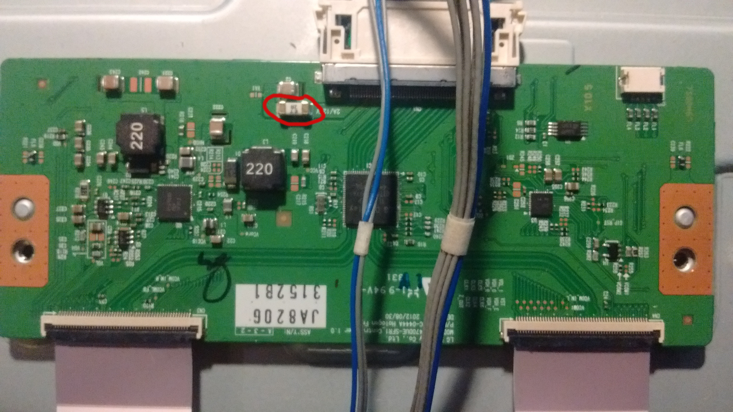

                    It would probably be best at this point if you told me exactly how to do that. With the TV unplugged and my meter set to ohms, set one probe on what fuse? The other on what inductor?
                      #50
                      Re: LG 47LN5200_U: PWR, MAIN, and all LEDs replaced, no picture
                      Black probe on either end of L1100, red probe on one end of the SMD fuse of the T-CON board one end at a time, it should show <1 Ohm (set meter to 200 Ohm scale).
                      • JDC
                        • May 2015
                        • 273
                        #51
                        You mentioned a SMD fuse. Is that the one circled in red in the attached pic? If so, all combinations measure between .5 and .8.
                          #52
                          I am surprised that you ask if that is the SMD fuse we need to check the resistance you you have already did the Voltage test on it an it shows as below:
                          Post #16: F1 fuse on TCON:
                          ON .014 both sides
                          OFF 0 both sides
                          Right now per your measurement you do have continuity from L1100 (checked out to be <1 Ohm) all the way to both ends of the T-CON and you also have 12V at the output of the switched transistor so I do not know why you do not have 12V at the T-CON fuse.

                            So far we've been calling it the F1 fuse. Is it also called a SMD fuse?
                              #54
                              SMD = Surface Mounted.
                              • JDC
                                • May 2015
                                • 273
                                #55
                                I understand that but when you refer to the SMD fuse, are you referring to the F1 fuse in this case?
                                  #56
                                  Yes, there is only one fuse (F1) on that T-CON board.
                                  • JDC
                                    • May 2015
                                    • 273
                                    #57
                                    What is the component that I circled then?
                                      #58
                                      That is white component is the SMD fuse which should have 12VDC on it.
                                      So it that the one you measured the Voltage and you get 0VDC?
                                      • dick_barton
                                        • Aug 2015
                                        • 6643

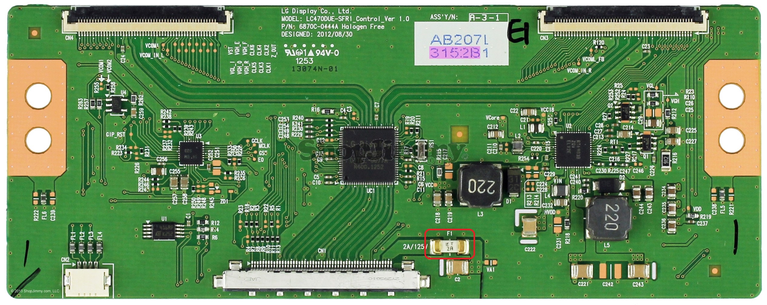

                                        • Wales
                                        #59
                                        Courtesy Shopjimmy
                                          #60
                                          Courtesy Shopjimmy
                                          I wonder now as to which FUSE that he tested and got 0VDC reading.
