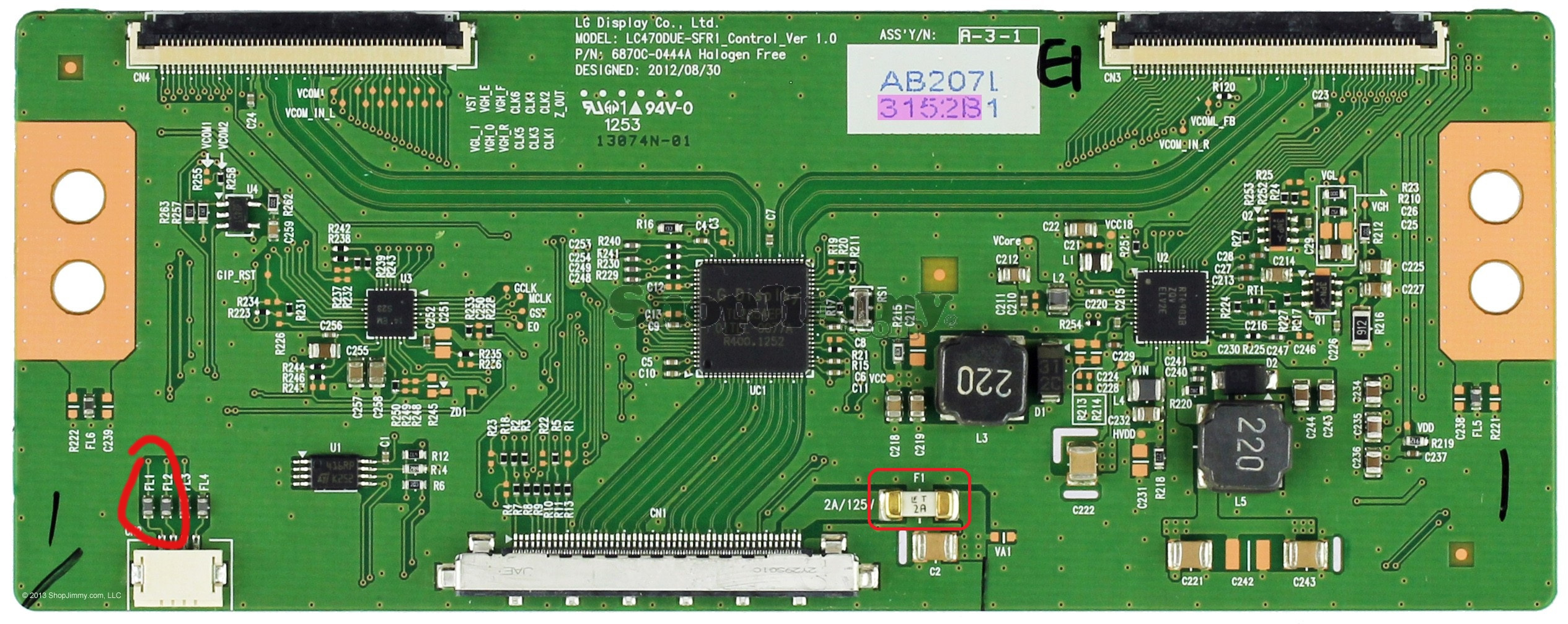

    The problem is that I'm not following the terms you are using correctly. You said the F1 fuse is the only fuse on my TCON? Then you say that the fuse I circled in the pic is a SMD fuse? I don't understand.

      Post #16 you made the Voltage test and this is what we are told:
      https://www.badcaps.net/forum/newrep...reply&p=651873
      F1 fuse on TCON:
      ON .014 both sides
      OFF 0 both sides
      We are chasing tail here.
      So now you do have 12V feeding the T-CON board.

          This is my fault. See attached. That's what I was measuring from. I saw what looked like F1 and assumed that's what you were talking about.
          The way I have the TV set up on my workbench, the light casts a shadow over the F1 fuse you have been refering to the entire time. I never saw it. The F1 marking was in the shadow.
            #65
            Re: LG 47LN5200_U: PWR, MAIN, and all LEDs replaced, no picture
            So back to square one, we do have Voltage to run the T-CON but you do not get image on the screen.
            So to be sure, before the LEDs went out, you were getting the pictures fine then the backlights went out so you start replacing boards but it turns out to be backlights problem, right?
            I would put all the original boards back in place and see what happen.

              I measured .2 ohms for the F1 fuse. Does that sound okay?

                At this point we know that we do have the 12V at the fuse to run the board, so it is either bad T-CON or the main board is not sending the signals to the T-CON board. Also what do you get when you only have one ribbon cables between the T-CON and the LCD panel connected one at time, also we also hope that all the cables are properly seated for sure.
                So did you have image on the screen before the LEDs backlights went out or not?

                                        I put the original main board in, same result except now I don't hear snow from the speakers.
                                        This has to be a bad TCON board.
