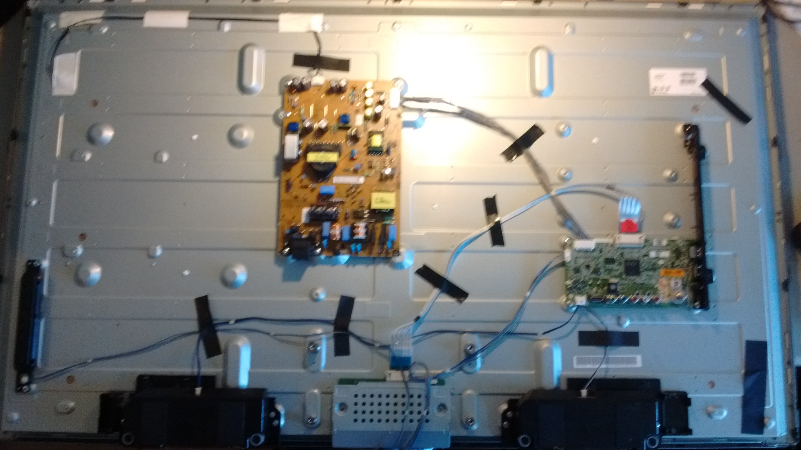

              We need to see the pictures of the whole back side of the TV to see how all the boards are connected together, then we need the picture of the T-CON board.

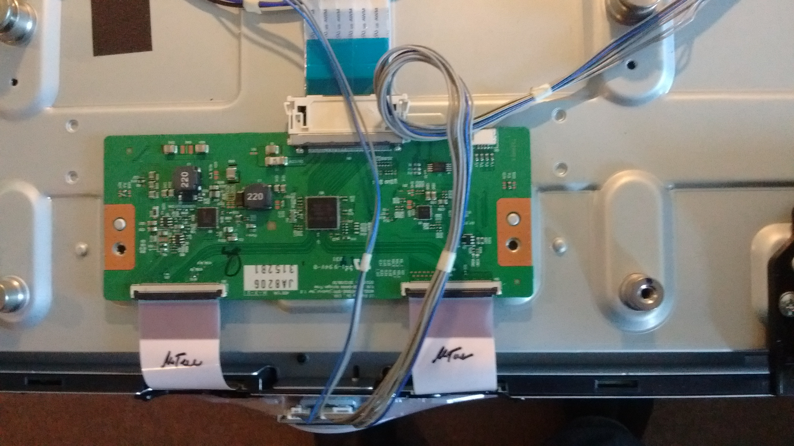

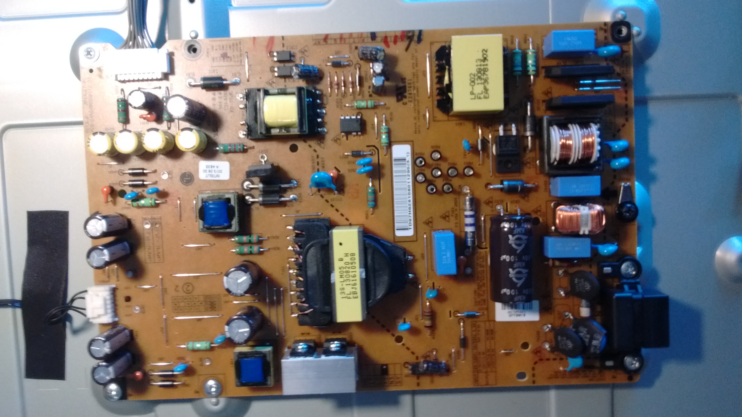

                        Here you go. I took a closeup of the TCON fuses as well.

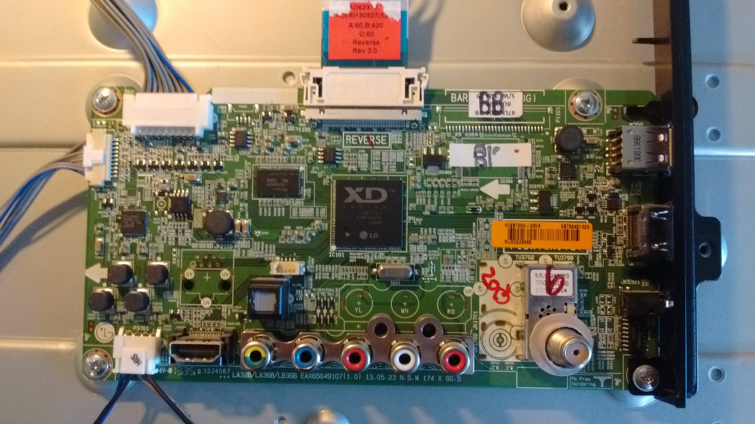

                            Umm... first off your pics are blurry.
                            Now there is a ribbon cable going from the PSU to the main board. There is a pin out on the PSU. Measure all those with the TV on and off and post the measured DC voltages with the corresponding pin out name.

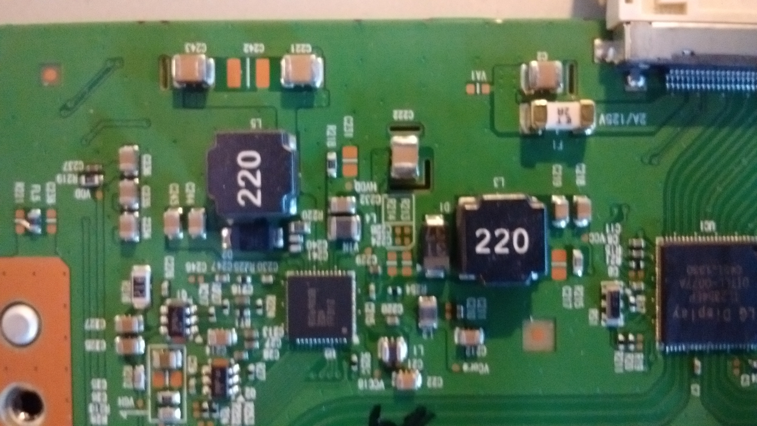

                            Also try to turn on the TV and measure both sides of F1 on the Tcon against cold GND.
                            Report back.

                                Re: LG 47LN5200_U: PWR, MAIN, and all LEDs replaced, no picture
                                Report back.
                                Using the main board pic I posted above as reference, from left to right:
                                ON
                                0
                                12.13
                                12.13
                                0
                                24.47
                                0
                                3.47
                                3.47
                                1.107
                                Off (but plugged in)
                                0
                                .007
                                .007
                                0
                                .004
                                0
                                3.55
                                3.55
                                0
                                F1 fuse on TCON:
                                ON .014 both sides
                                OFF 0 both sides

                                    You appear to have no TCON voltage, so no picture. You need to follow the wiring back to the mainboard and find the supply. Use your meter to trace the connection from the TCON fuse down to the mainboard. The TCON supply is probably supplied from a switched transistor or mosfet that I suspect has been blown.
                                    Edit
                                    Please can you provide some sharp picture of your main board which would be of help.

                                      from yours T-CON photo it show to me the left ribbon cable not correct sitting at the panel socket., take them both out and check the Gold pins of them, then reset them correct, as they labeled with hand writing they seem had story.
