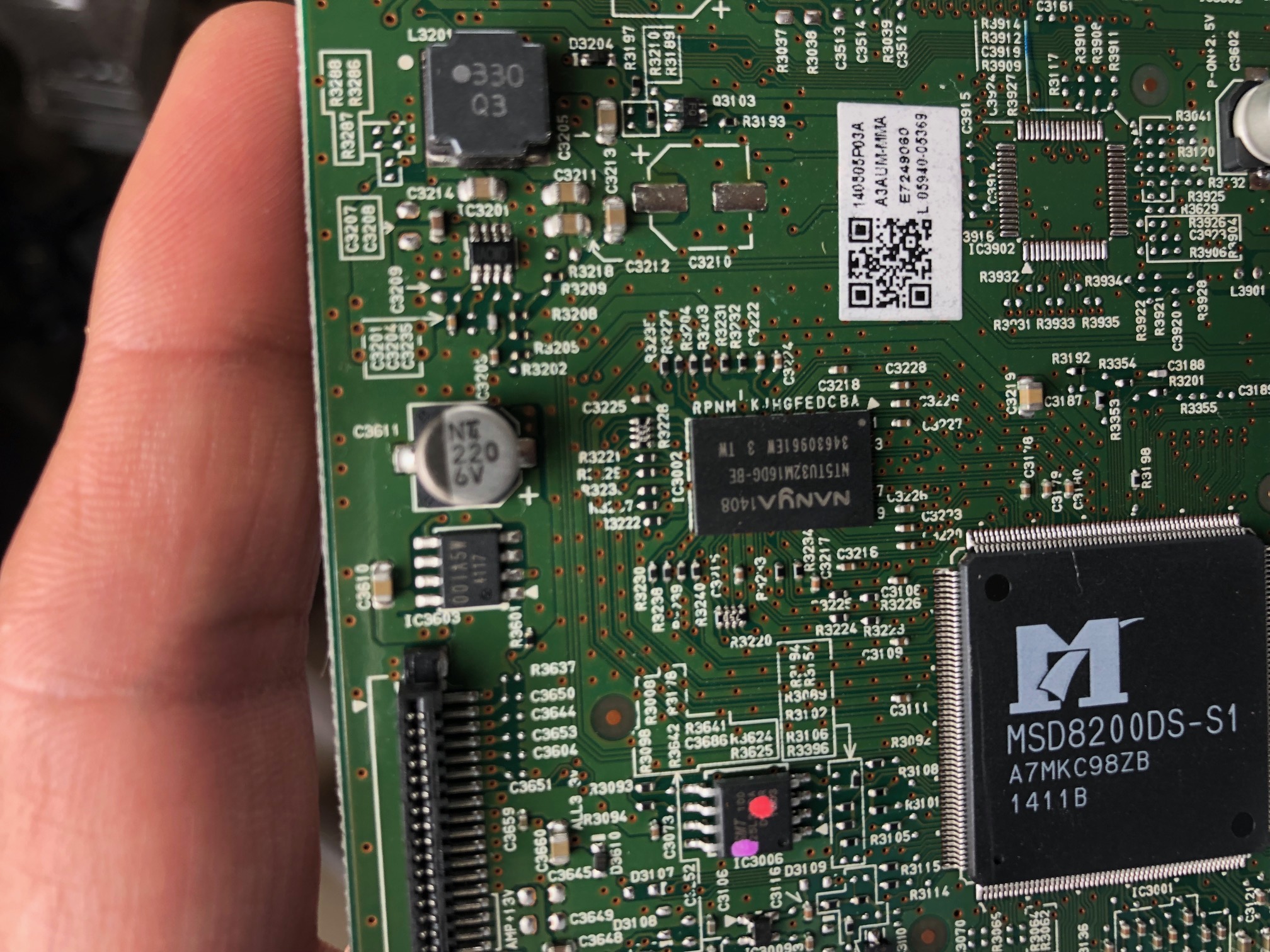

                  hi guy,s working on a way to proof that the main CPU is bad on Emerson lf501em5f
                  i have a test for this butt need more info LOOKING for a service manual this for a set
                  with no stby led butt has stby on supply and if you force on supply all rails are up jump bl-on led,s are on need the manual
                  • akk944

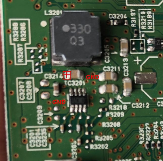

                    Hello, I'm having the same issue and have found the C3214 cap on my main board. What is the best way of confirming this cap is the problem before swapping it out with a multimeter. Do I need to check for the short as previously mentioned (got a little lost with the hot air gun).
                    Thanks! Sorry to bring up this old thread.
                    EDIT: I have a bad cap at c3214! confirmed by checking and comparing resistance with other caps on the board. With this being said, does the following look like a reasonable replacement? Original states 270pF while budm mentions 10uf?
                    https://www.mouser.com/ProductDetail...KDppzeEQ%3D%3D
                    Last edited by akk944; 05-05-2019, 08:08 PM. Reason: diagnosed issue, need help with replacement part

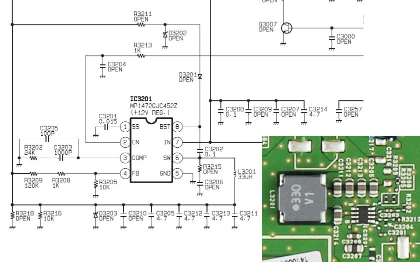

                      #170

                          #172
                          Re: LF501EM5F No Power, Chirping/Beeping Transformer
                          If it's 10uF that I need, then how does this cap look?
                          https://www.mouser.com/ProductDetail...SnPCSGjIcIU%3D
                            #173
                            1) Measure the dimension of the one you remove to see if it match the dimension of the replacement or not.
                            2) To verify if we are talking about the same C3214 or not, you need to check the resistant of the Not Grounded leg of the C3214 pin and the AMP +13v jumper wire of the power supply board, do the same against the ALL +3.3V jumper wire of the power supply board.
                              I looked up a BA4GU5G0201_3 board and schematic, See if this helps, in this case they use a 4.7µf , The other version board are likely slightly different.

                                  #176
                                  Put Meter on 20 or 200 Ohms scale, put one meter probe on the AMP +13v point, another probe on C3214 that is NOT connect to circuit GND (you know which pin that is, right?), if it shows around 1 Ohms or so then that C3214 is the filter cap for the AMP +13v power supply line.
                                  270pf will not be used for power supply filter cap, too small of capacitance.
                                  As you can see form RJ schematic, they will usually put more then cap in parallel as needed, if you trace out one end of the C3214, you will see that is connected in parallel with other caps that may or may be not installed on your board.
                                  The blank PCB can be stuffed to make many PCBA for the needed model of TV, so if the cap is not installed in particular PCBA then the schematic will label that part as 'Open'.

                                    Budm, no I'm not sure which pin is not connected to circuit ground. I was trying to figure that out by trying either end. I don't THINK my C3214 is in parallel with anything else, but it's hard to tell. I could be wrong. Please see picture of my board and C3214 attached. Finally, my meter has 20M, 2000K, 200K, 20K, 2000, 200. When I put it on the 20 or 200, it doesnt look like I have any sort of connect between AMP +13v and the resistor. Just shows '1'... doesn't even move. This changes when I go to the higher settings.
                                    Thanks!
                                      #178
                                      Thanks!
                                      Looking at your picture, so how come C3214 is not removed yet to find out if the shorted circuit go away or not when C3214 is removed?
                                      As you can see it is also connected in parallel with smaller cap C3208, c3207 3209 are not installed.
                                      Since the cap is still in place, please check resistance between GND and P-ON +21V to see it shows really low resistance, more likely that your board version use C3214 for the P-ON+21V power supply line, we need to verify.
                                      If it is connected to P-0N+21V line then it will be 4.7uF 35V (min) and it will be the same circuit that RJ provided..

                                        ....one year later, Quarantine has finally given me time to look at this again.
                                        Not sure how I figured that the short without the 3214 removed. I'm looking at it now and I checked the resistance across each cap nearby and compared it to the C3214. All of them are extremely low compared to the C3214.
                                        However, I did get 536 ohms when I checked resistance between the C3214 and ground as described in your pictured. All the other caps nearby are right around 600 ohms when grounded the same way. Not sure the relevance of doing that, but I thought I'd throw that out there.
                                        Nearby caps I checked: C3213, C3205, C3212, AND C3211
                                        Does this confirm the C3214 is bad or do I still need to remove it? I will go ahead and remove it if that's the next step, but want to make sure there is no further troubleshooting that can be done with it on
