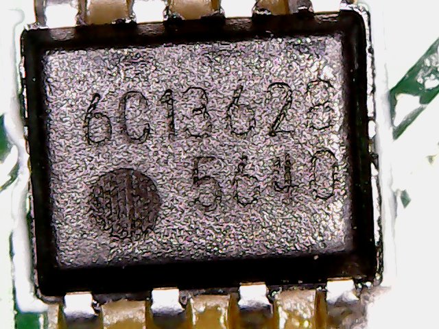

      I was about to give up on this but I think I found the problem. I have this power board and no TV to test it in because someone sent it to me hoping I could fix it. Board number BA3AU0F0102_2. I wasn't sure if the board was bad but I read this whole thread and it didn't help me much on this issue but I finally found D614 to be shorted. I have another board I am going to swap out the diode from but I will need to buy some new ones. I can not tell what this diode is. It is only marked "BR"
      I also suspect IC601 which I found to be FA5640 Switching Power Supply Control.
      The person said his TV was hit by lightning and he replaced the main board. I am going to swap out these parts and retest the board. Hopefully I have fixed the problem and I can send this board back and be done with it.

        OK, so here is the follow up. After removing the diode D614 is was not shorted. But after replacing IC601 the short was gone. Then I tested the board and I got my voltages up and running so the board is fixed. Seems like the cause was IC601 and it was shorted making me to think the diode D614 was shorted.
        Also if anyone attempts to remove IC601 it is glued to the board. I removed mine with my mini heat gun but the board pop corned and the IC popped up off the board. If someone knows a better way to remove a glued down IC I would like to be educated.
        This board is now being boxed up and shipped back to its owner

          easy. cut the traces of the IC with a knife, put a little heat on it and pull the IC off or carefully lift it with a flat screwdriver. Then remove the cut off legs that are soldered to the pads with your soldering iron and fresh solder. Done.
          I have to admit, that I didn't see any IC601 go bad on those Emerson's yet.
          If D614 would have been shorted, you would have more trouble back on the primary side. However, it is a very good Idea to replace D614 with a better diode to prevent a bad outcome later.
