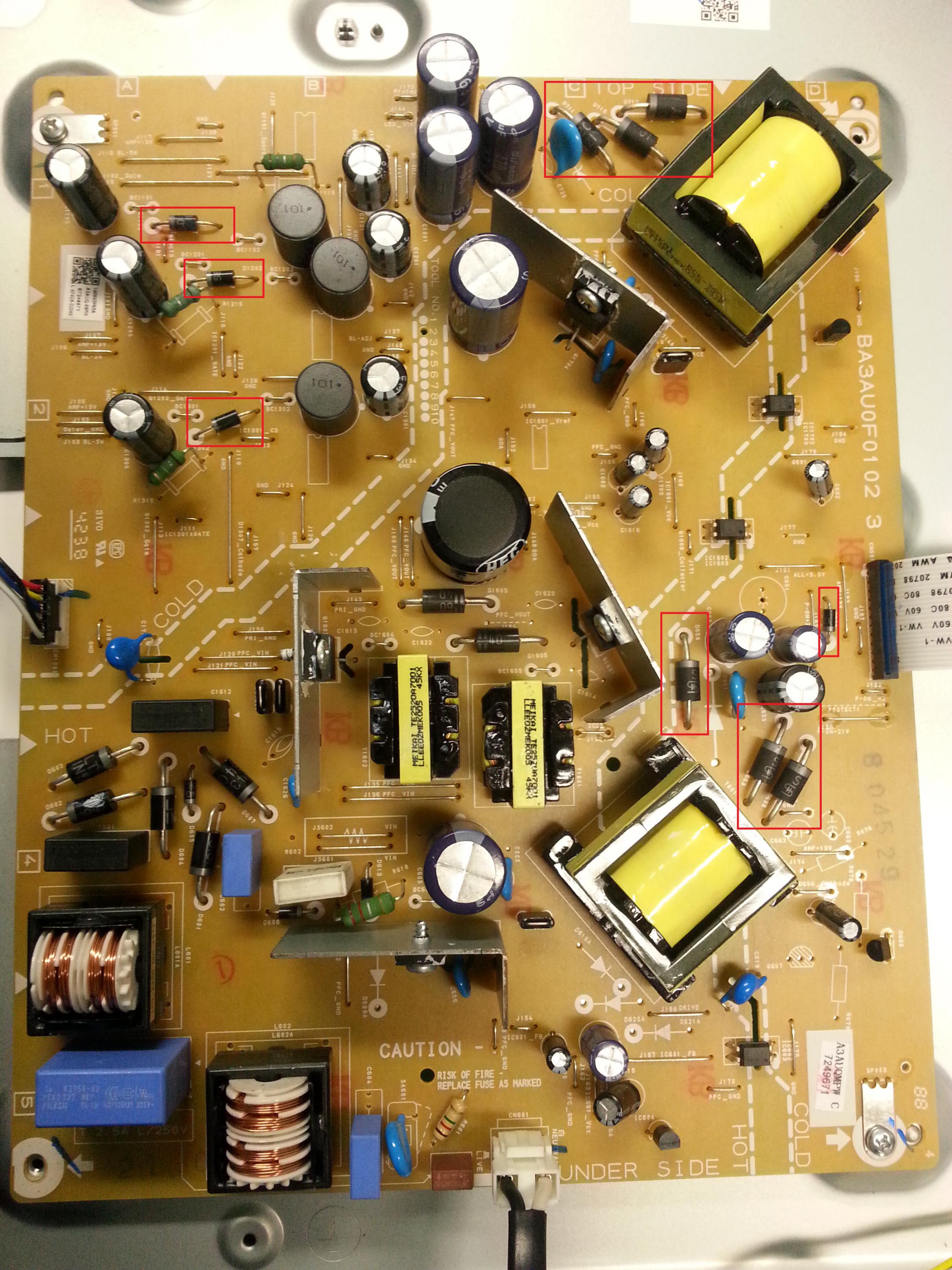

          I do have a DMM. I tested most if not all diodes. I just double checked the ones i've boxed in red in this picture, are these what you'd consider output diodes?
            Re: LF501EM5F No Power, Chirping/Beeping Transformer
            Yes, Test ALL the Diodes will be best, including the SMD if any on the bottom side.
              yes of course, I tested all of them. I noticed the SMD diodes that are situated near multiple resistors tested bad in circuit but after removing them i see they're good

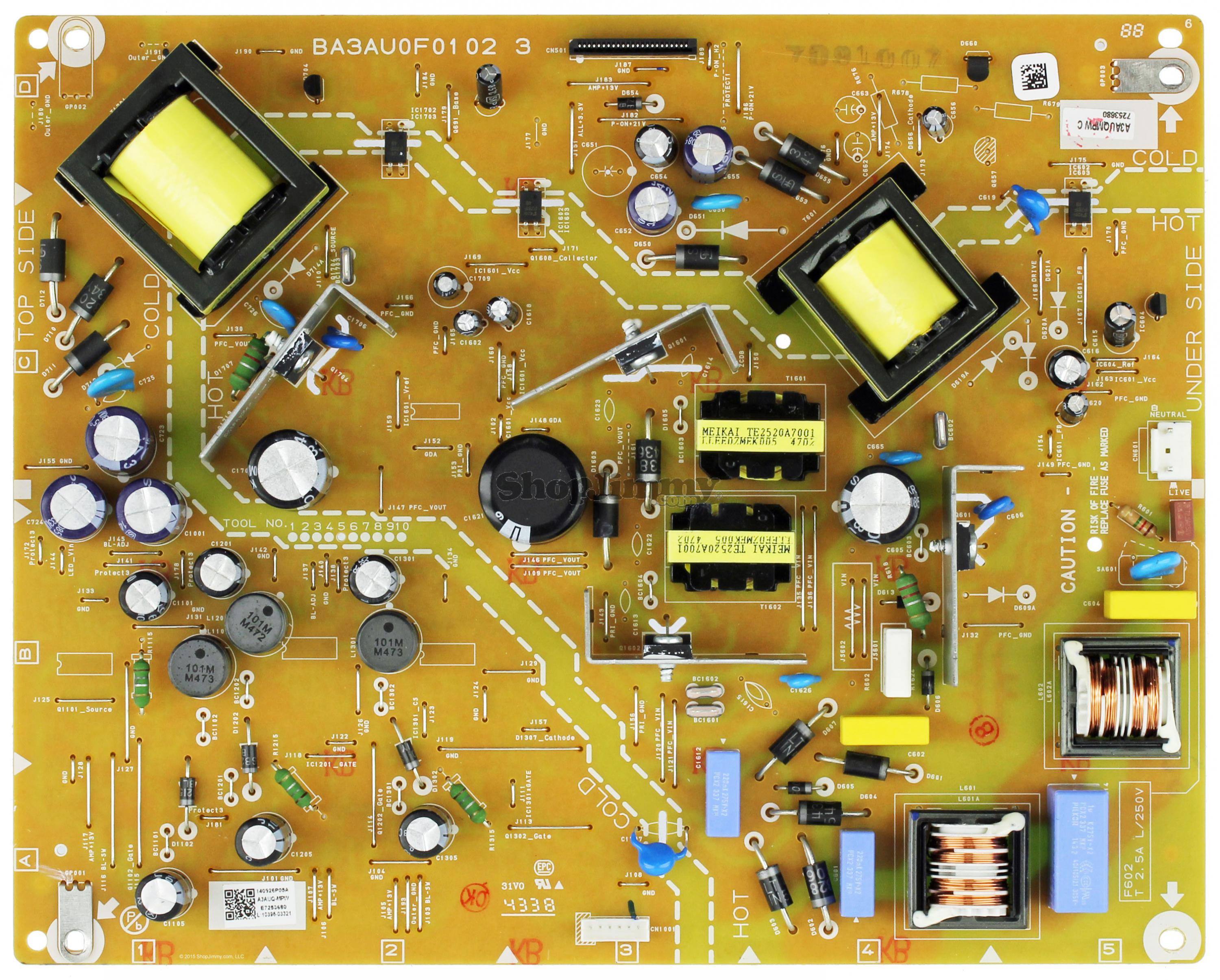

                      The Bottom right transformer is the power supply for the main board, what happen if you remove the flat white ribbon cable, will it is still ticking?
                      http://www.shopjimmy.com/emerson-a3a...upply-unit.htm
                      http://www.shopjimmy.com/emerson-lf5...repair-kit.htm
                      http://www.shopjimmy.com/catalogsear...rson+LF501EM5F
                      I have no idea how much time you will want to spend on component level repair.

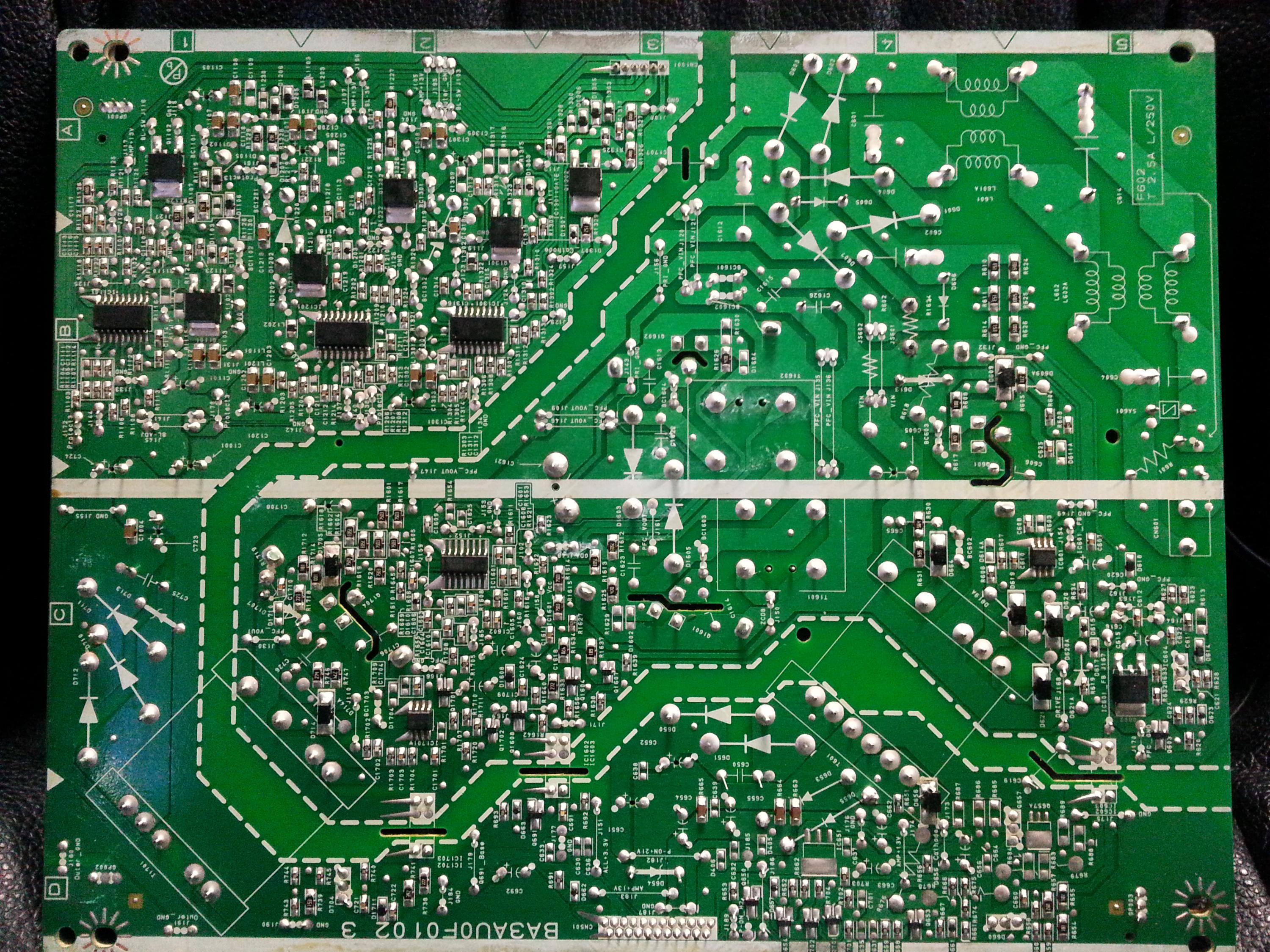

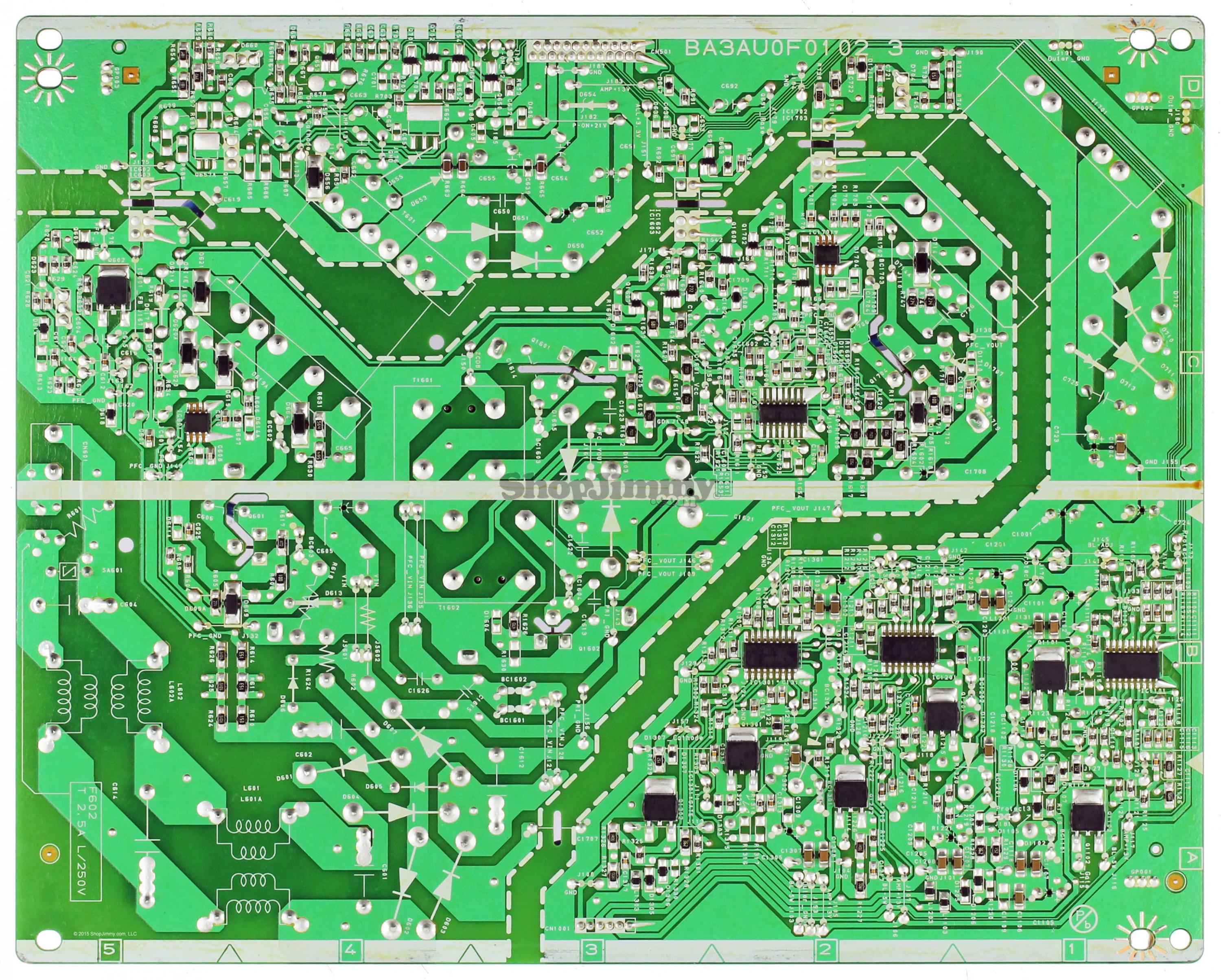

                          More In depth trouble shooting required, you will have to start checking the load resistance of the power supply outputs to see if any one of them show very low resistance.
                          You will need to look at the bottom side where the connector CN501 is to see which one are the power pins.
                          "As soon as it's plugged in (to mains) it starts to "chirp" at around 2 second intervals repeatedly and will not power on. " so it is doing it in standby mode.
                          Pictures provided by SHOPJIMMY.

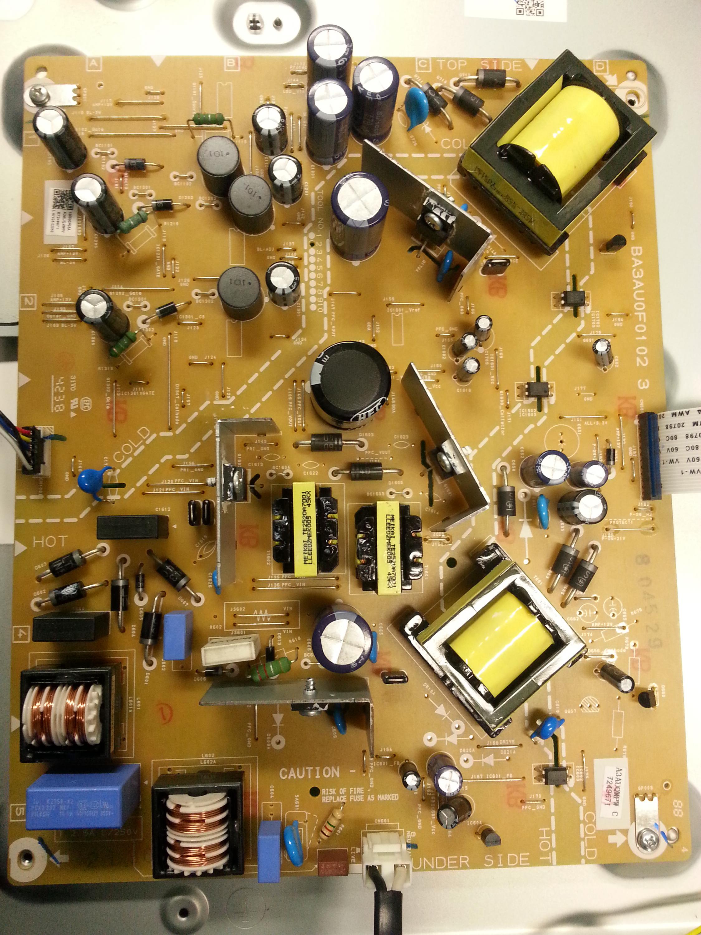

                                if you look at the screenprint under the psu, it's all marked.
                                i see:
                                gnd
                                amp +13v
                                p-on +12v
                                p-on H2 <???
                                all +3.3v
                                near the invertor is bl-sw
                                in the center is PFC-Vout
                                for a piece of shit it's pretty well labelled.
                                      Going off the labels you pointed out, I have:
                                      (power supply plugged in, nothing connected to it)
                                      amp +13v -> reads 8.18vdc
                                      p-on +21v -> reads 13.53vdc
                                      p-on_H2 -> reads 0.00vdc
                                      all +3.3v -> reads 0.00vdc
                                      bl-sw -> reads 0.00vdc
                                      (power supply plugged in, main board connected to it, transformer beeping)
                                      amp +13v -> fluctuating 3.8vdc~4.1vdc
                                      p-on +21v -> fluctuating 0.00~1.2vdc between beeps
                                      all +3.3v -> fluctuating 0.00-0.8vdc between beeps
                                      bl-sw -> reads 0.00
                                      Does the fact that all the voltages are low even before the main board is plugged in indicate that a problem is likely on the power supply board?
                                        • 31199
                                        well the psu looks wrong, but dont rule out a fault on both.
                                        so lets start with the psu.
                                        what are you getting on pfc-vout?
                                        it should be a few hundred i imagine.
