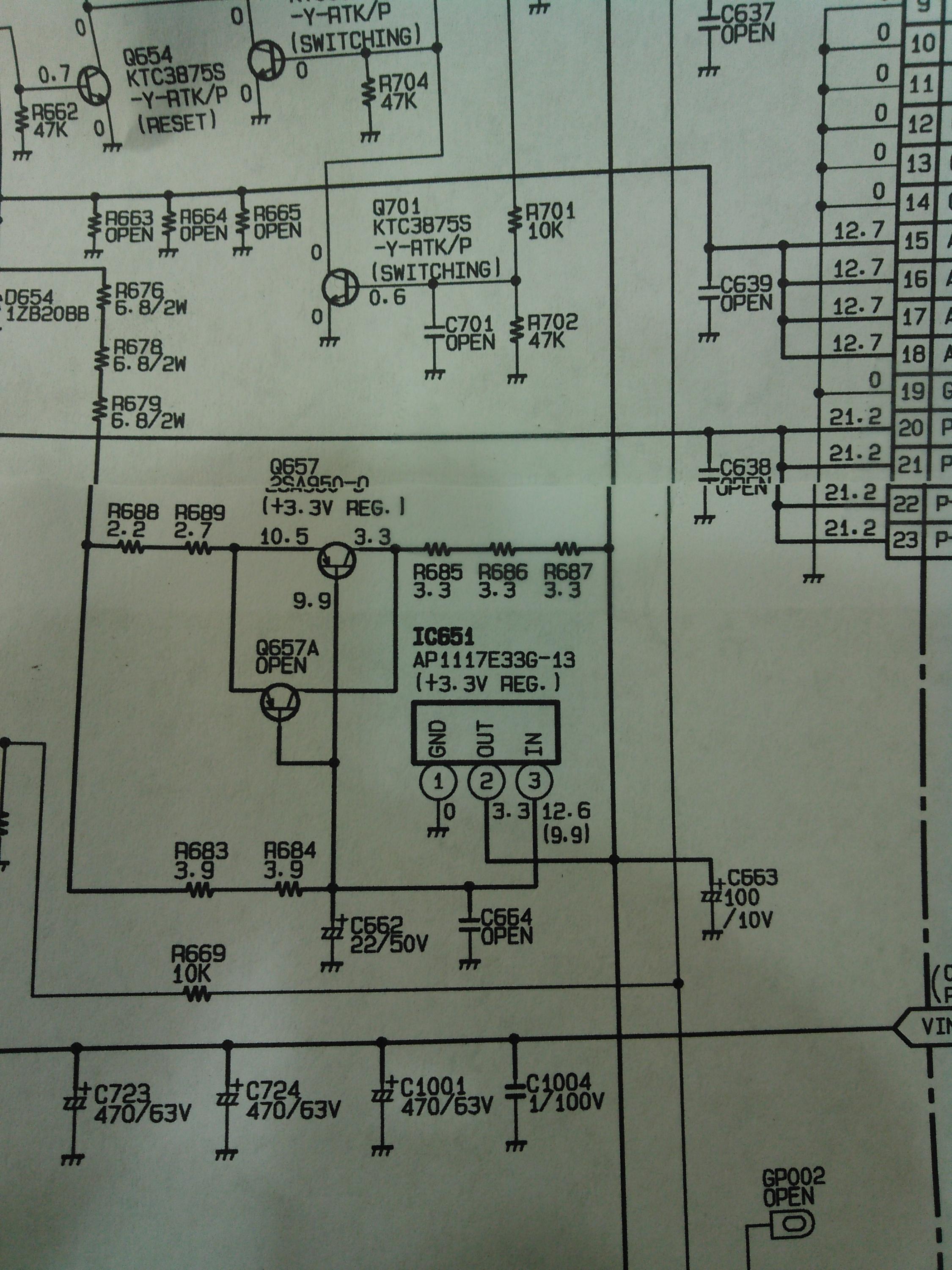

                            Spec sheet of the FA5640:
                            Page 12:
                            Start up minimum Voltage is 12.5V, 14V Typ.
                            Under Voltage shutdown can be as low as 7V, 8V typ,
                            Right now you are getting Voltages at outputs (AMP13V and P-ON 21V) side so the IC is running otherwise you will have 0V at the output side of the transformer rectifier circuits.
                            You can verify that the IC does start up and run or not by lifting one of the 3 resistors R610, R611, or R614 which feed pin 8 (VH) for the internal charge pump circuit and see if you will have any DCV at the output side of the transformer at all.
                            After looking and studying how the circuit function, I suspect the problem is at IC651 (1117 series 3.3V fixed LDO regulator) or open circuit or high resistance at the input pin due to bad resistors connected to the input pin, it should have about 8VDC feeding the input pin right now (that is what you reported for the AMP13V), that is more than enough to get the IC651 to put out 3.3VDC at low current to run the main board in standby mode.
                            Once the PS-ON is present then Q653 is turn on so the feedback resistor R667 is grounded out so the output Voltages will go higher to maintain the higher output Voltages and keep the sensing pin of D650 (431 shunt regulator Diode) at 2.4V) which causes the rest of the Voltages to go up to the proper level. They had to keep the out put Voltages at low level in standby mode so the power consumption will be low, that is why the 13V and the 21V are low right now since it is not required full Voltage in standby mode, it will kick up to proper Voltage and then the 3.3V will be handle by Q657 which can handle more current than the 1117can supply when TV is in full on mode and requires more current from the 3.3V power supply, at the same time the PFC Voltage booster will be running also.
                            So the bottom line, in standby mode:
                            The AMP+13V will be around 8V. This 8v is high enough to feed the 1117 3.3V LDO regulator IC to provide 3.3V at low current to run the main board in standby mode.
                            The P-ON-+21V will be around 13V
                            You can also see that the 13V and the 21V is putting out at 60% of the normal Voltage and being maintained at that level in standby mode.
                            The ALL+3.3V SHOULD BE AT 3.3V!
                            So you need to check the Voltage at IC651 1117 3.3V

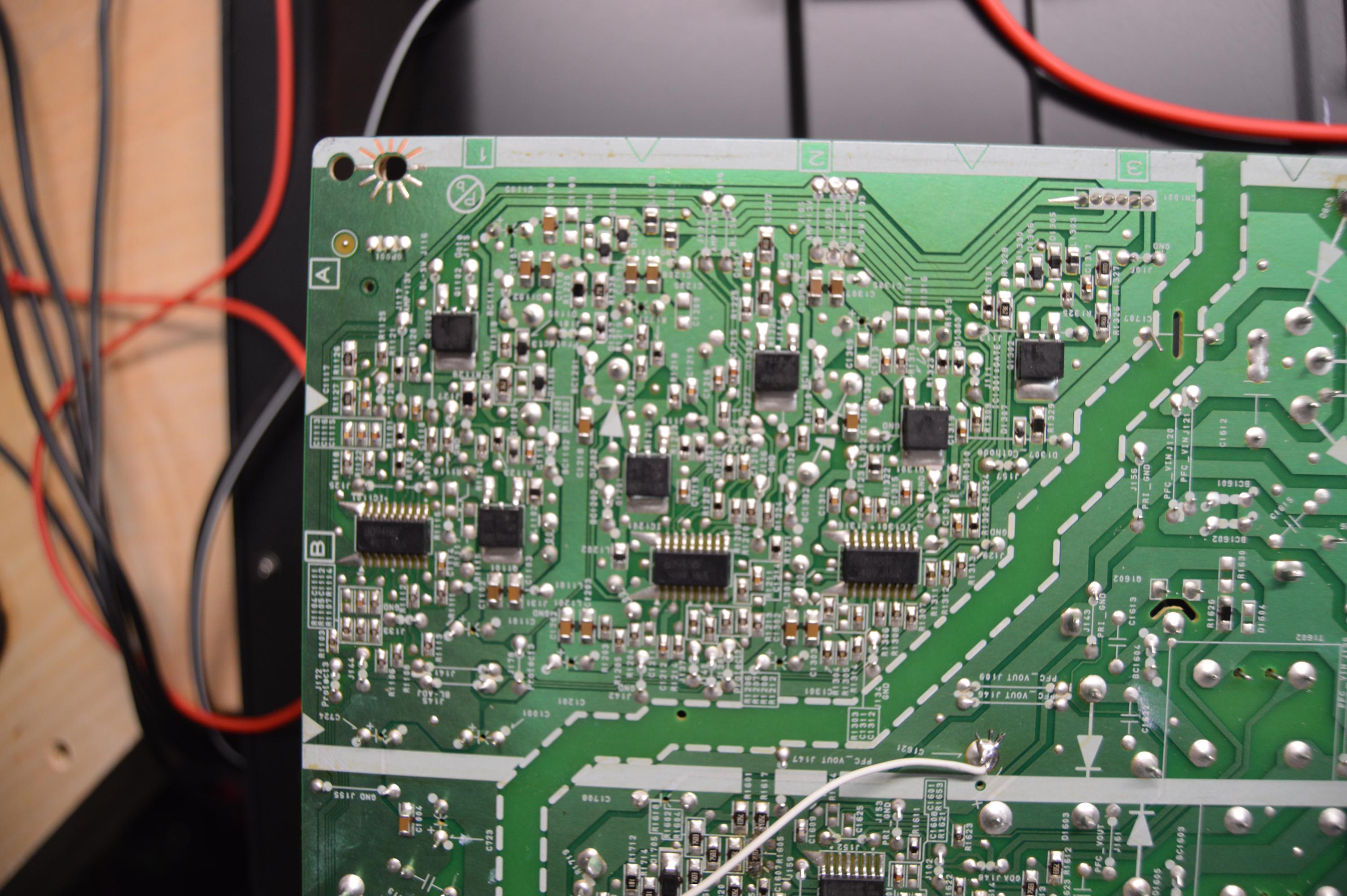

                            • shadetreetrader11
                              • Oct 2015
                              • 230
                              #74
                              Re: LF501EM5F No Power, Chirping/Beeping Transformer

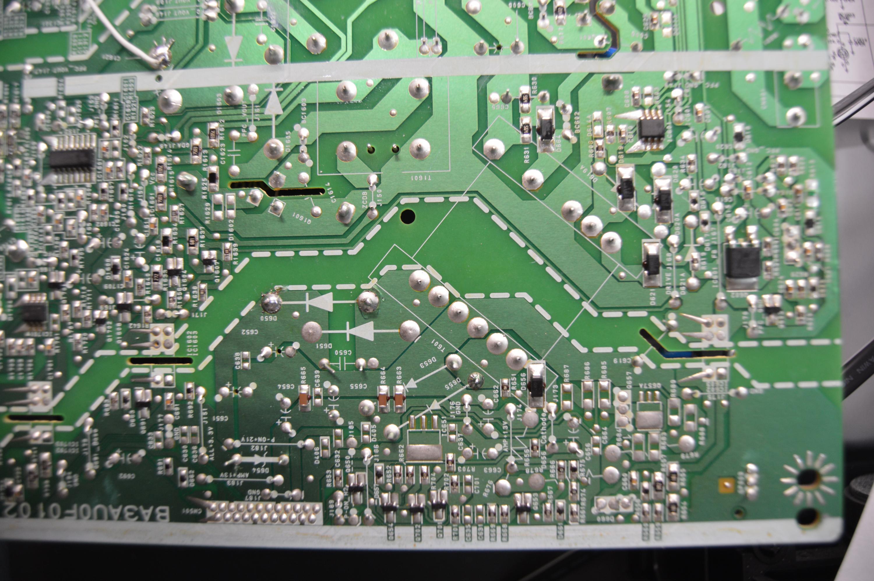

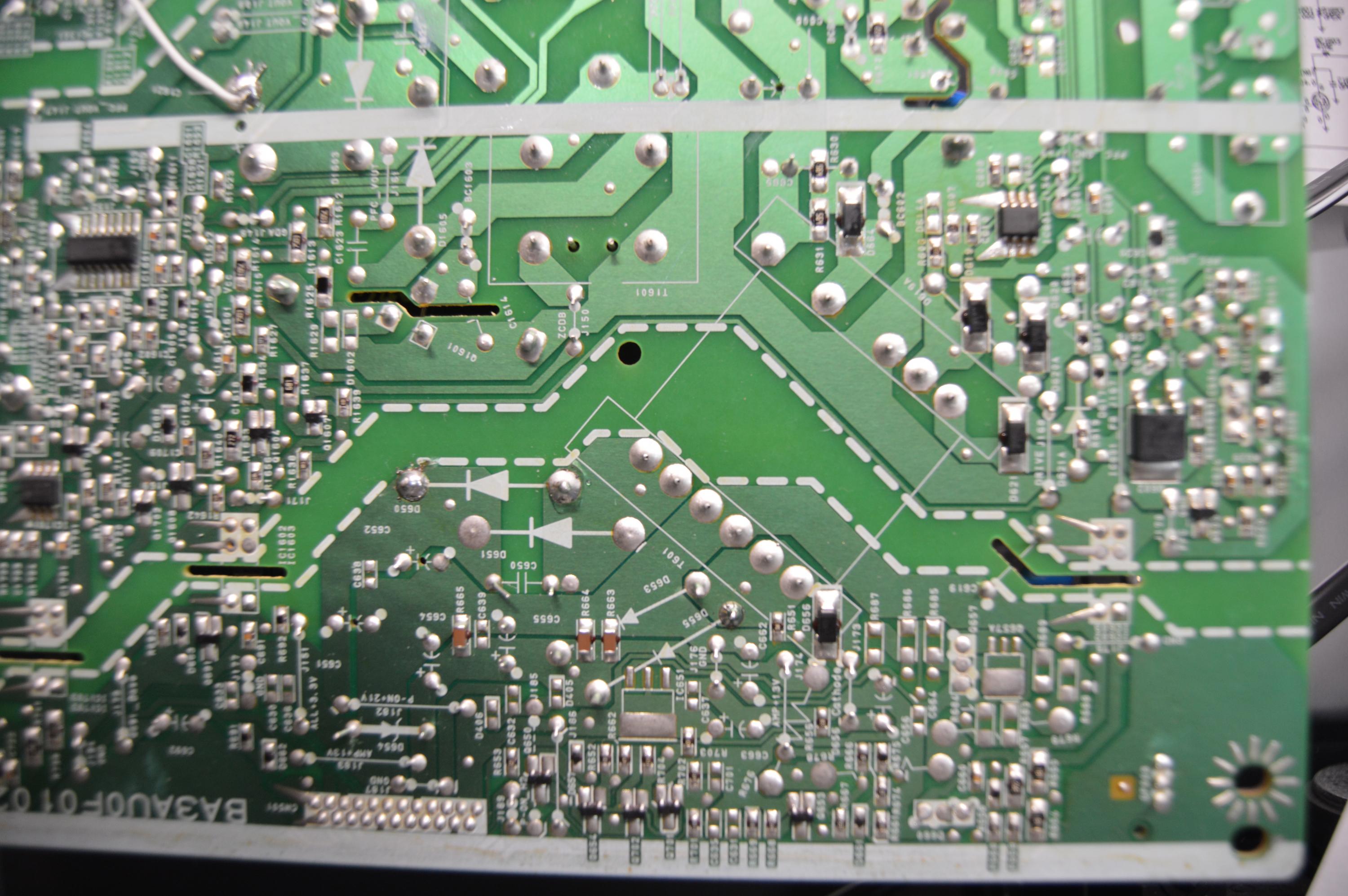

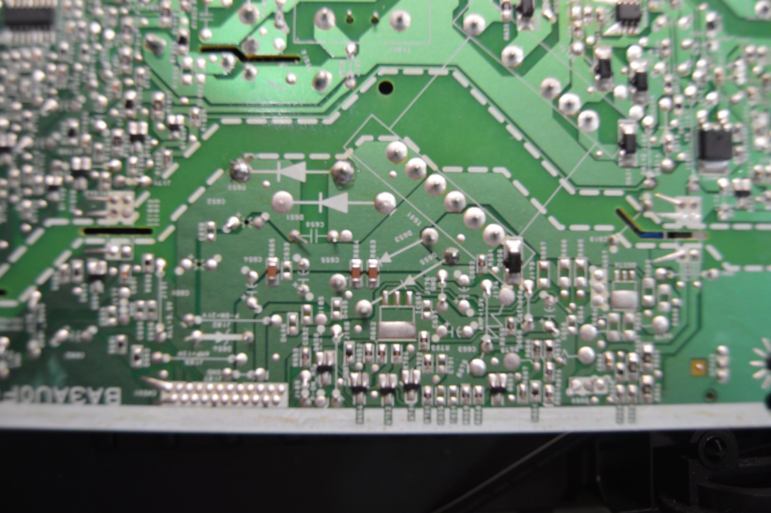

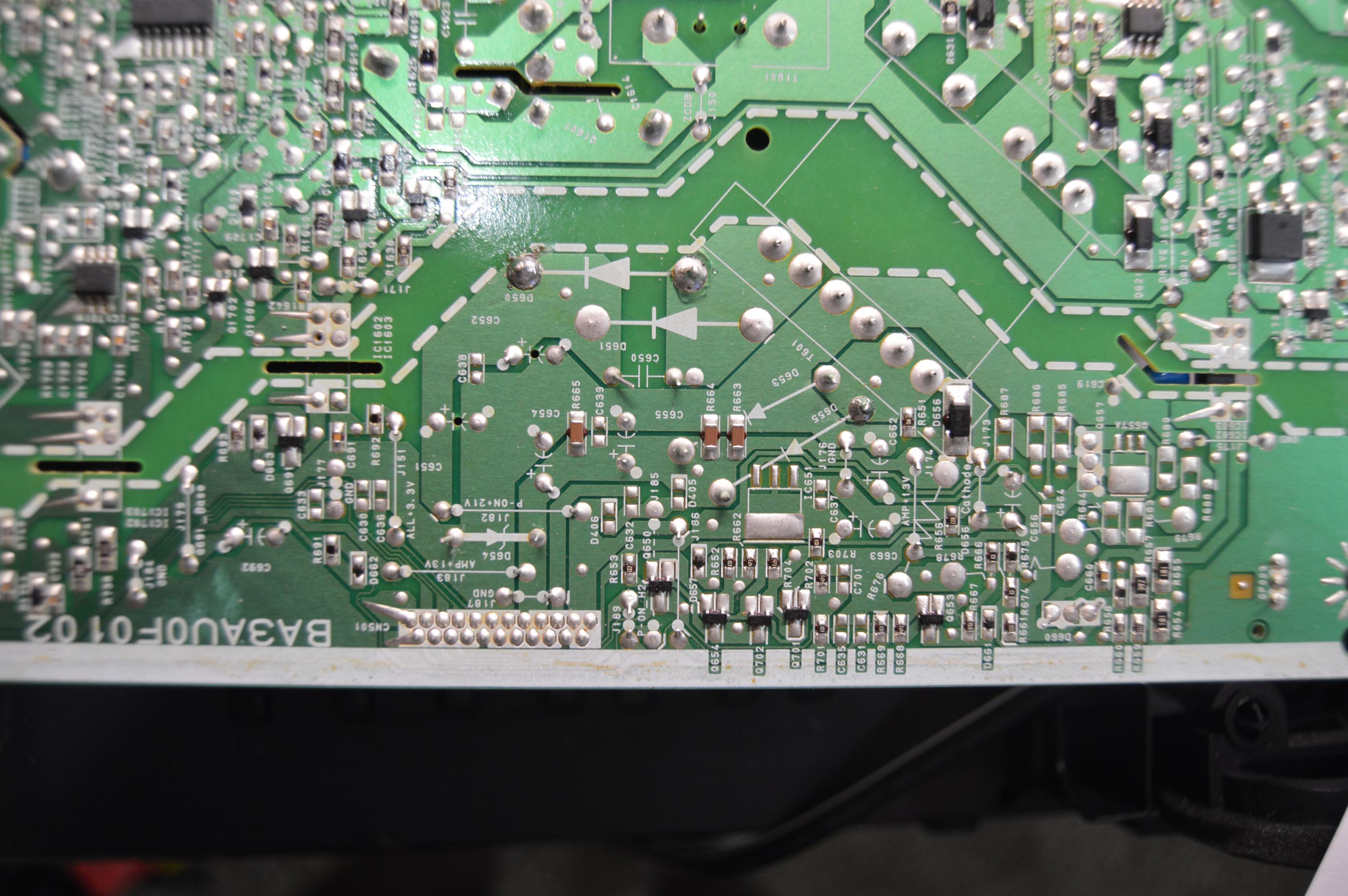

                              My board didn't come from the factory with IC651. The Board I have is ba3au0f0102 3. Now having said that I down loaded a print off the Internet and It also has IC651 in it.
                              • shadetreetrader11
                                • Oct 2015
                                • 230
                                #75
                                  #76
                                  Schematic on my post #45 is the one I use.
                                  So now we have to trace out the connection from the 3.3V pin to see where it goes to, this is not going to be easy.

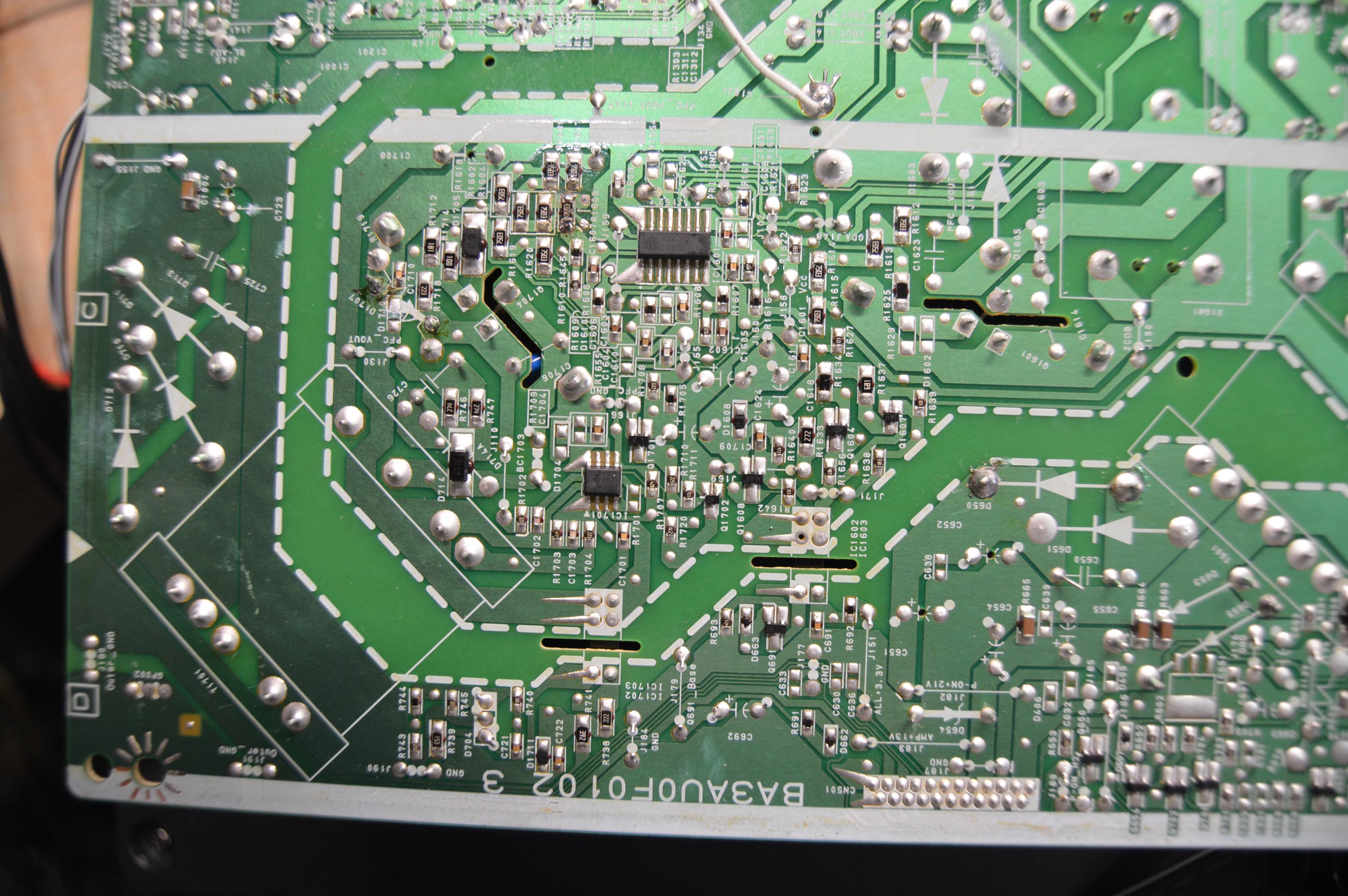

                                    #77
                                    OK the diagram does not match the board BA3AU0F0102 3.
                                    Emerson A3AUNMPW-001 Power Supply Board.
                                    http://www.shopjimmy.com/emerson-a3a...upply-unit.htm
                                    • shadetreetrader11
                                      • Oct 2015
                                      • 230
                                      #78
                                      • shadetreetrader11
                                        • Oct 2015
                                        • 230
                                        #79
                                        Should we chalk this one up as a loss and I order one? It's up to you I'm game. But for now I'm going to bed. Have to be up at 6.30
                                          #80
                                          No, not yet!
                                          Is this your main board?
                                          It looks like the ALL+3.3V is generated on the main board!
                                          http://www.shopjimmy.com/emerson-a3a...ain-board.htm#
                                          If it is, look at the P/N of IC3602.
