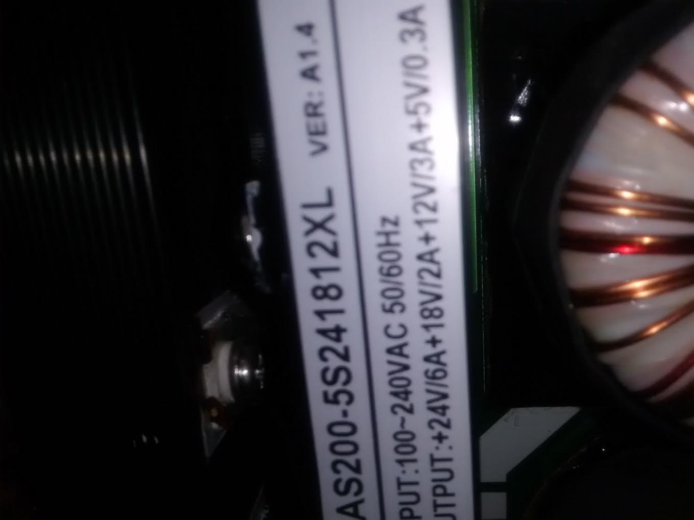

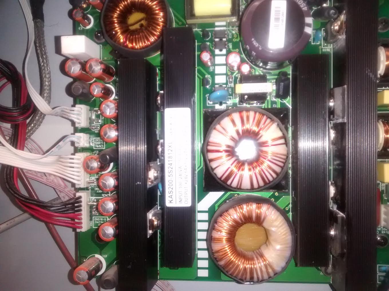

    Everything looks good no fuses blown maybe the lower bottom cap might be bulged a little but nothing I can see, I order a cap kit today , Am I on the right track?
    Re: Polaroid FLM-3701 no power/ standy light
    It could be the angle of the pic, but it looks like you have quite a few blown caps on the left side of pic 2. I count 8 - possibly 9. I can't clearly see the cap closer to the top of the pic on the left side (E3). That would be the possible 9th blown cap.

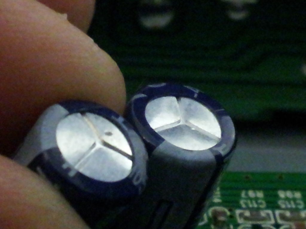

    I've attached a pic of two caps, just in case you're not sure. The cap on the left with the domed top is bad, while the cap on the right is visibly fine.

      Looks like at least 9 bad caps with domed tops to me too.

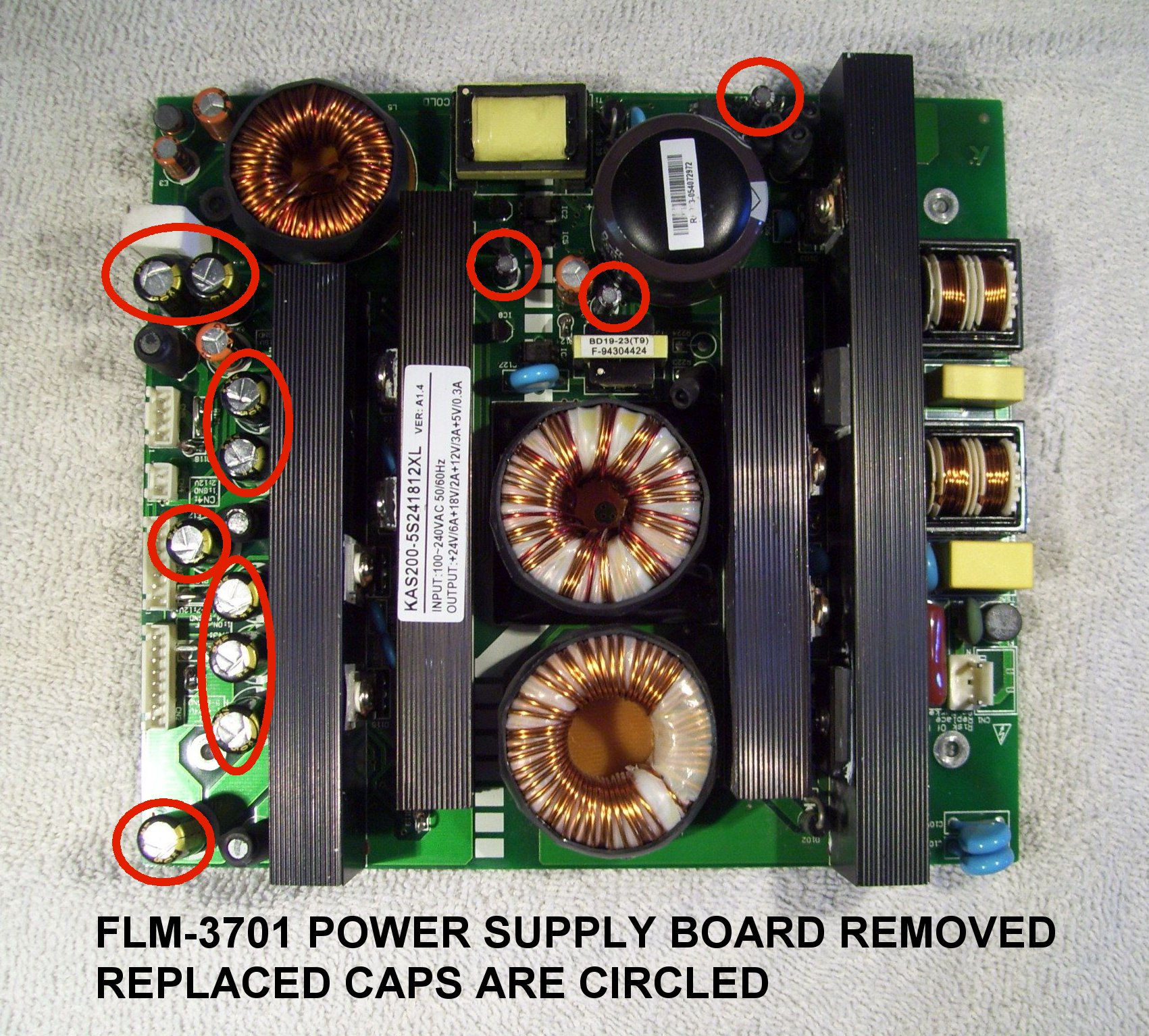

            About bad caps on the Polaroid FLM-3701:
            The nine big output caps E8 thru E17 go bad and they will be obviously swollen. E8 - E13 are 680uF 35v and E15 - E17 are 680uF 25V.
            However, there are three small 22uF 50V caps that also go bad. They look normal. They do not swell. They are E7, E8, and E22. Be sure to check those with an ESR meter.
              Them bad caps are just the start ! You probably have the secondary output failure basically on these Kas boards bad caps cause a small Smd diode to fail which causes no standby.

                  I see 8 bulged caps...
