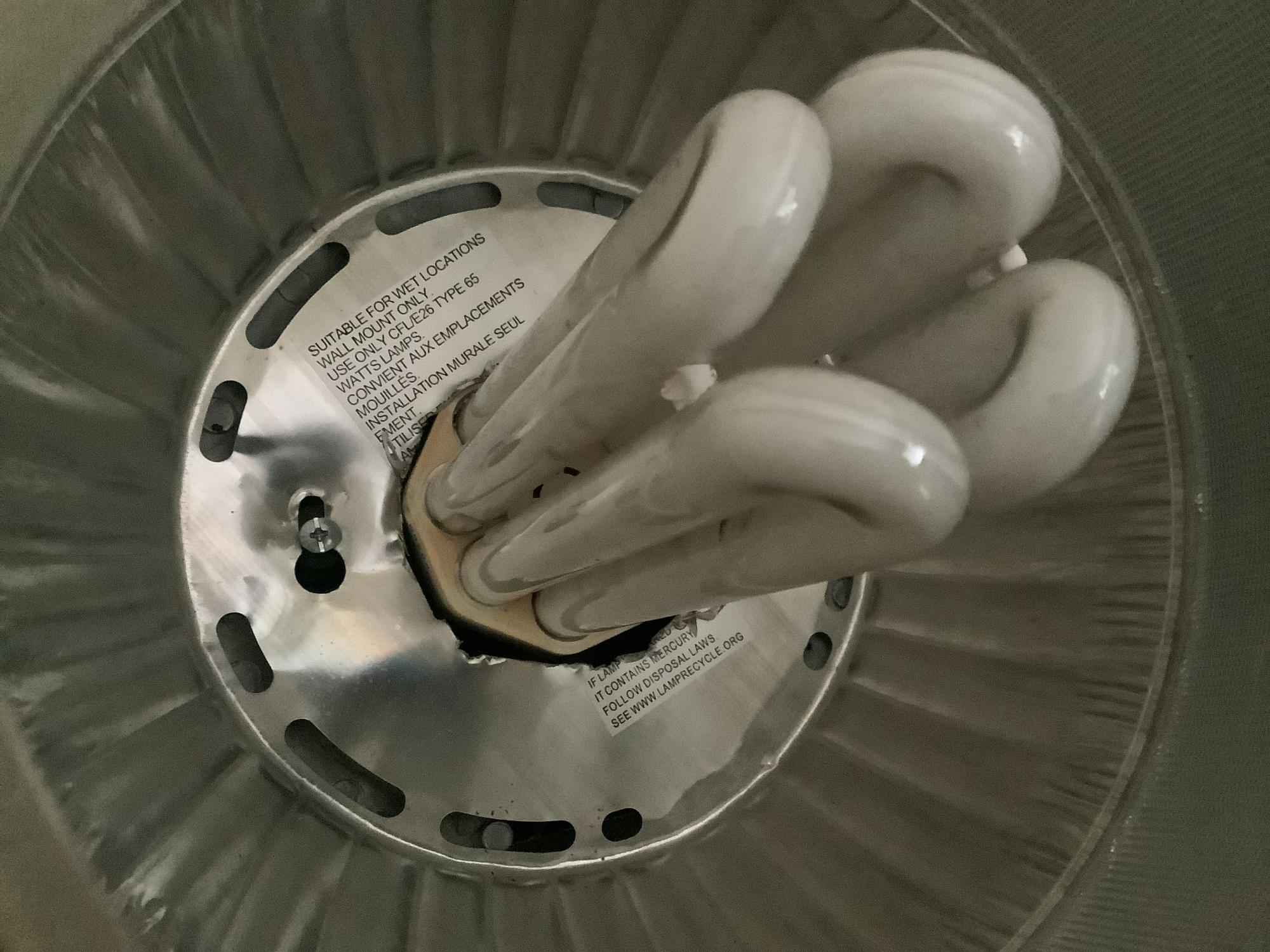

    I have a Lithonia Lighting 65-Watt Gray Hardwired Compact Fluorescent
    I also have back when Light of America had these light bulbs available for yard lights
    The issue with Light of America was the blast boards had all most certain board failure while bulbs hardly ever fail
    While the Lithonia lighting fixture has all most certain bulb failure
    So I have modified the Lithonia lighting fixture to accept the Light of America light bulb and see how long this will last
    I have only had this light fixture for not more than a year if it even that long and I have already had to replace the light bulb once this does not count the light bulb that came with it

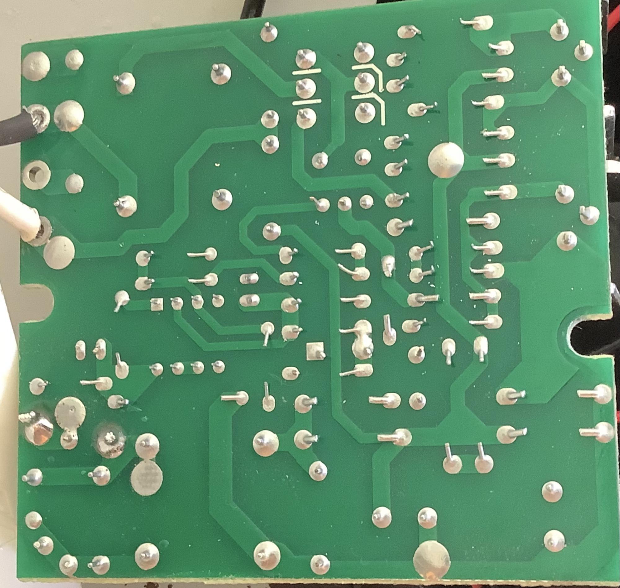

      On the CFL ballast board should be two transistors. Something like an mje13007. I am guessing they are shorted plus maybe a fuse open. I used to repair the old cfl’s at one point, because I had some old broken ones and it happened that on one rainy Sunday I needed 6. I took them all apart and separated the cfl from the board. Thing is you got to match the board with the cfl. Measure the heater with an ohm meter on the cfl on both sides. If a heater is open, the cfl is junk. Then proceed to the board and usually there are 2 transistors on there and a fuse. Check them, replace them if necessary, take a good used cfl and put it back together. I don’t do that anymore these as I switch over to LED.
      Not sure how these things are built I guess I need to see one apart.
        • 31196
        Re: Lithonia Lighting versus Light of America Compact Fluorescent product quality
        on cfl's with the film cap between the heaters, the 2 common failure points are the heaters and the mains smoothing electrolytic.
        i have seen better designs with an ntc in series with the cap to drop the heater current after a few seconds.

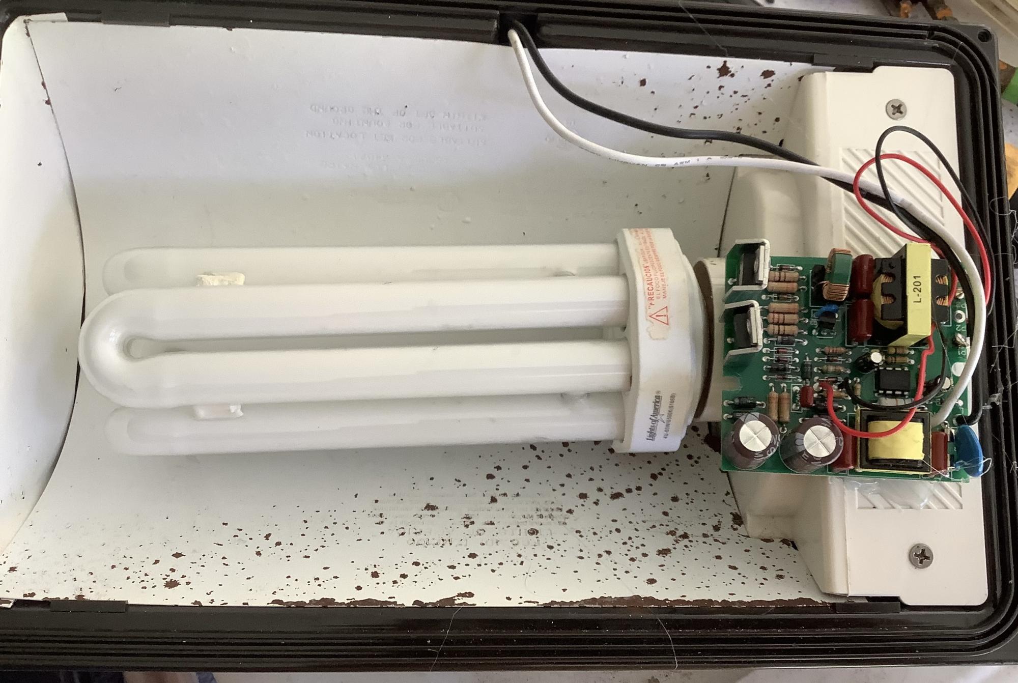

                      I think I figured out what the issue with the bulb were I think that the manufacturer might have made a big mistake with what the wattage of the bulb are with the first one that I bought
                      I think that they were 42 watt bulbs not 65 watt bulbs because I found a 42 watt bulb that I have and it was the same length not the length of a 65 watt bulb
                      Because in the one I just bought has the right length bulb and works the way it should
                      So I am going to use the one that I modified for a lighting fixture that is also a Light of America that the blast had failed and they do not make this fixture anymore and I need for the lighting down the driveway
                      I will show some pictures of it when I finish this project
                        • Jul 2011
                        • 6064

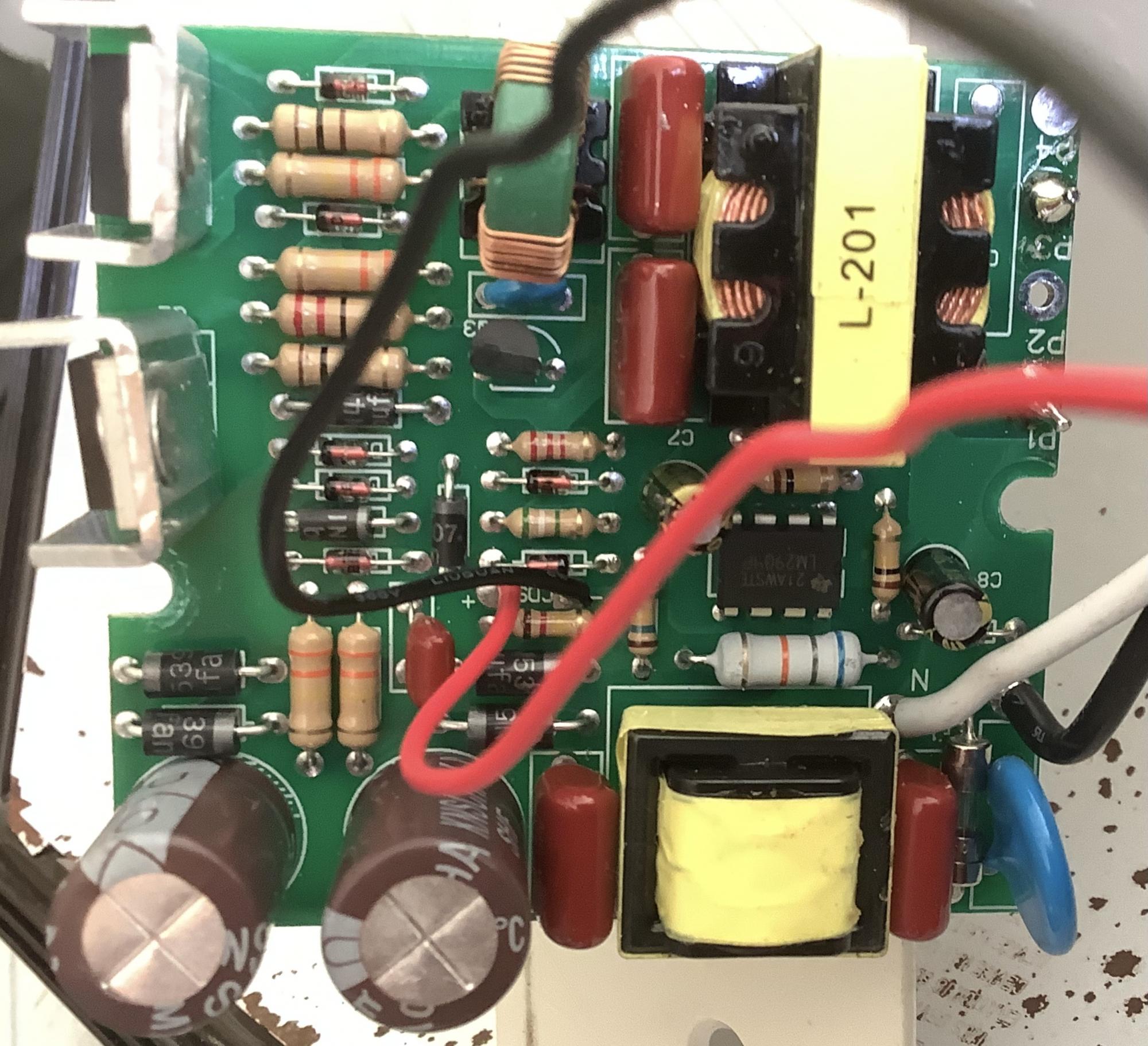

                        Here are some pictures of the new ballast board in old Light of America enclosure and light socket
                        This project has been completed and happy with the results
                        I decided not mess with the one that I had modified I going to leave it alone because it is working very good

                          Well it has ran for about a month now and so far no issues with it as far as I can tell with both fixtures but the one that I show the picture where I put the ballast board in the fixture it only gets used when I need extra lighting to see what I am doing outside
                          I am pleased with the results of this modification to this lighting fixture so hopefully it will keep working as it is now for many more hours of use
