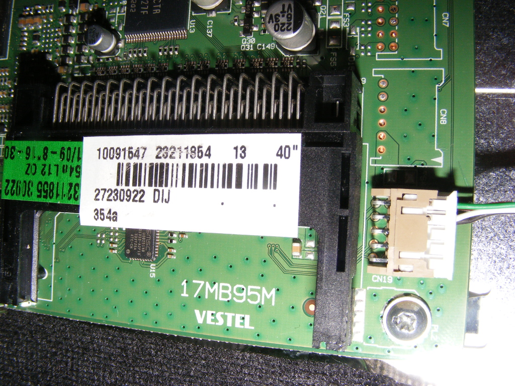

    on the maniboard you often find a 4 pin connector, often blue.
    it has ground, 5v and txd,rxd
    you need a voltage convertor of some type of a usb adapter.

      Thanks! I don't have any connector like that on this main board but I have been doing some research.
      Found this info, different board but possibly useful:
      http://electronicshelponline.blogspo...-software.html
      And also from the service manual of the 17MB95-S I see that on the SCART connector pins 12 and 10 are UART-TX-SC and UART-RX-SC so I think I may be able to use that. The page above talks about needing an Mstar debug tool which seems to be a usb adapter as you mention.

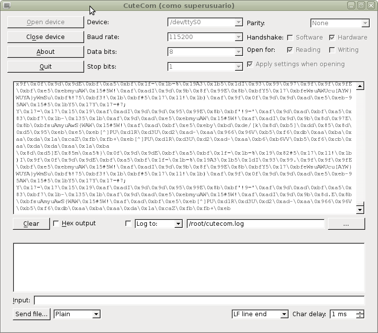

        Interesting. I managed to get a serial connection to pins 10 and 12 of the SCART, and you can see the linux boot up process going on. Have attached two log files in case anyone's interested. The first file is what happens when the TV is first plugged in. The second is when the power button is pressed on the remote to bring it out of standby. It always freezes after the lines
        [SVCMGR]: service 'mstar.ESPlayer' died
        [SVCMGR]: service 'mstar.SecureApi' died
        At that point the TV carries on playing for 10 seconds or so and then it reboots and starts the loop over again.
        I should be able to flash new firmware from the USB following the instructions in the link I posted above but I was hoping to be able to take a backup of the existing firmware first. It seems I need to be able to get into the service menu in order to do that though and the service menu is not working.
        Anyway I will probably just go ahead and try flashing some new software tomorrow and see what happens.

          So I have had some success. You have to hold OK on the remote while you plug in and then the bootloader will check the usb for the file usb_auto_update_A1.txt. This file holds instructions for reflashing the bootloader and the NAND ic with files on the usb. I also found a few mb90 .bin firmware files around on google. I have got the TV up and running now and it stays on with menus now and works great with HDMI etc. The only problem is the TV tuner on this board is a different version than the firmwares I have found are configured for, so it can't tune in digital TV.
          So I am on the hunt for firmware more specific for this TV. I have contacted Argos and Vestel themselves but no response yet. I am also thinking I may be able to track down another owner of the same model and extract a dump from theirs, but it looks like there's different versions of the same model no, so that might be tricky to find the exact right one. I was also wondering if there was a way to reconfigure or recompile the current software with drivers for the tuner I have, but not really sure how to go about that. Anyway I am happy to have made progress and hoping a way forward from here will come up soon enough.

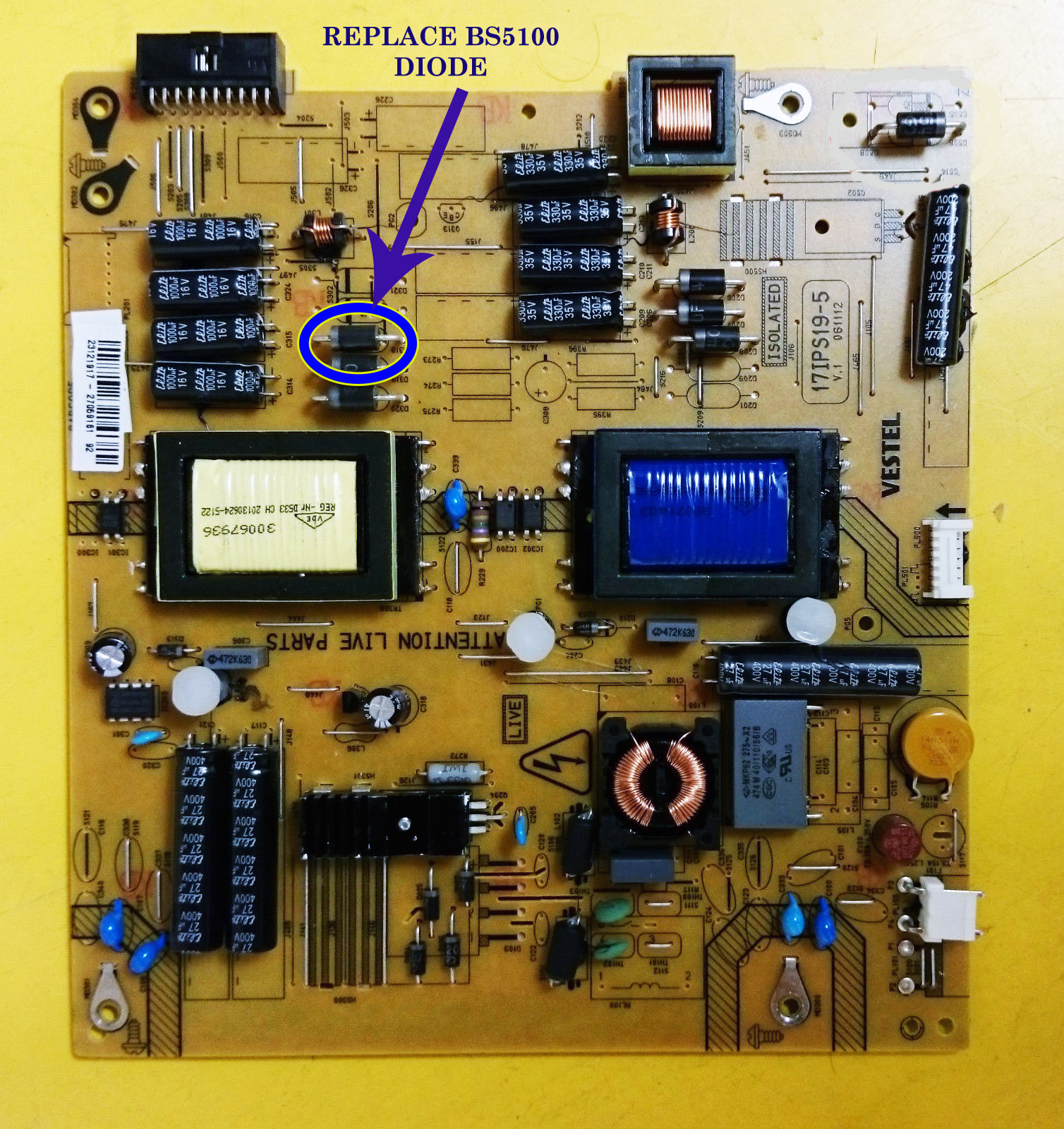

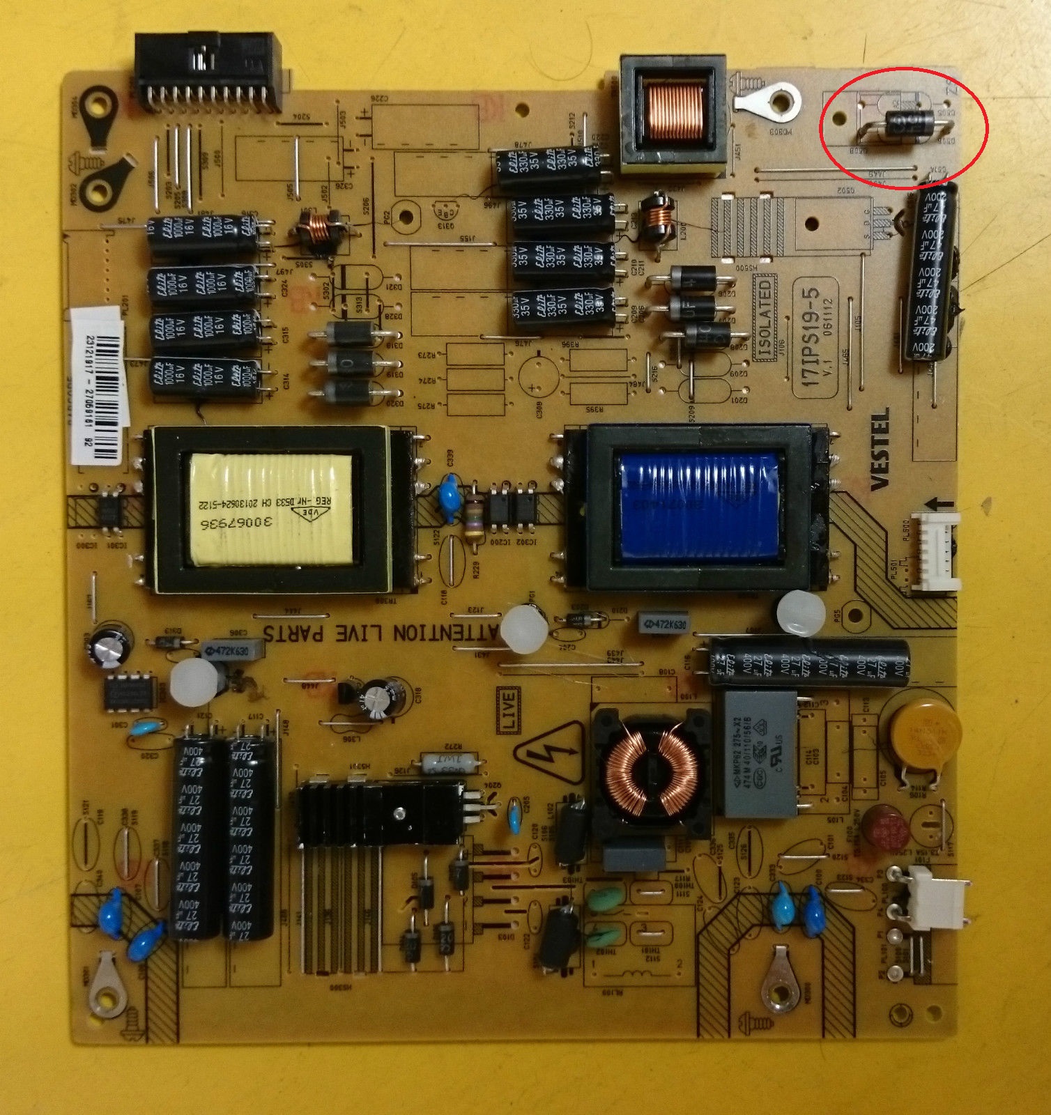

                      my fault sound but no picture found a diode shorted on the power supply all fixed testing now

                          Basically there are a LOT of different versions of this TV, as with most Vestel stuff it seems. Different panels, mainboard revisions, software on the mainboards etc.. I figured out that the 354a on the barcode sticker on my mainboard corresponds to the software version - 3.5.4a in this case. I found quite a few versions on mb95 software lying around the internet. Later versions from around 3.5 have support for the Si2157 tuner chip which this one has. Earlier ones are set up for only the Si2156. I figured out how to switch it to use either tuner. Also how to swap panel files from other versions of the software.
                          In the end I got hold of another mb95m mainboard who's connectors didn't match up to mine but the software version was close enough. I pulled the bootloader and software and flashed them to the original mainboard and everything worked - tuner, panel, menus. Couldn't get internet to work for the life of me though.

                                  If the PSU appears dead and does not light the standby LED then try replacing a shorted BS5100 diode. Picture uploaded.
