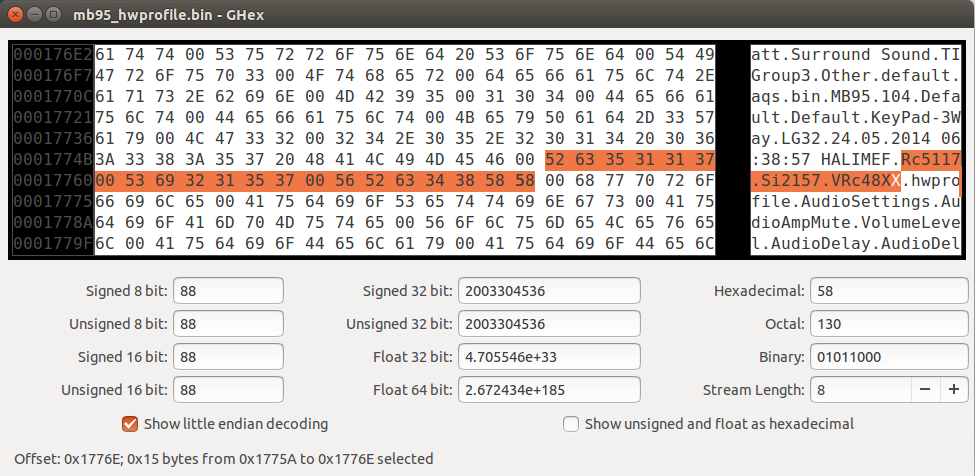

                                      Remote control info seems to be in the file mb95_hwprofile.bin in CONF. You can extract files from CONF.BIN using the scripts downloaded from https://github.com/jrspruitt/ubi_reader

                                        Re: Bush (Vestel) led40127fhdcntd - turns off and on repeatedly
                                        Maybe just a dumb ideea.
                                        Many items in hwprofile are 00h after reading dump.
                                        If we make that 01h maybe then option isn't read only in service menu.
                                        And like I see in swprofile in german forum, take address of next byte,reverse it,like 0x006c1A become 1a6c,search for hex value, then experiment.
                                        In swprofile
                                        Is something like
                                        00 00 00 00 1a 6c 00 00 function disabled (but I'm not sure about last 00 00)
                                        01 00 00 00 1a 6c 00 00 function enabled ( but ... like I said in previous example)
                                        But in hwprofile seems that string is shorter.
                                        01 00 XY ZC (xy zc are address)
                                        Or maybe I'm wrong.
                                          I changed the tuner type succesfully just by changing the line here from Si2156 to Si2157 (see image). Just above that you can see Rc5117. I guess this refers to the remote control. There are codes for many remote listed elsewhere in the file including some with brand names (most without):
                                          Panasonic-Rc4861
                                          Sharp-RC484x
                                          Technisat-Rc4850
                                          Technisat-Rc4852
                                          TOSHIBA-Rc3412
                                          TOSHIBA-Rc4826
                                          TOSHIBA-Rc4827_8
                                          I think you should be able to replace that with the code for your remote if you can figure out which one it is.
