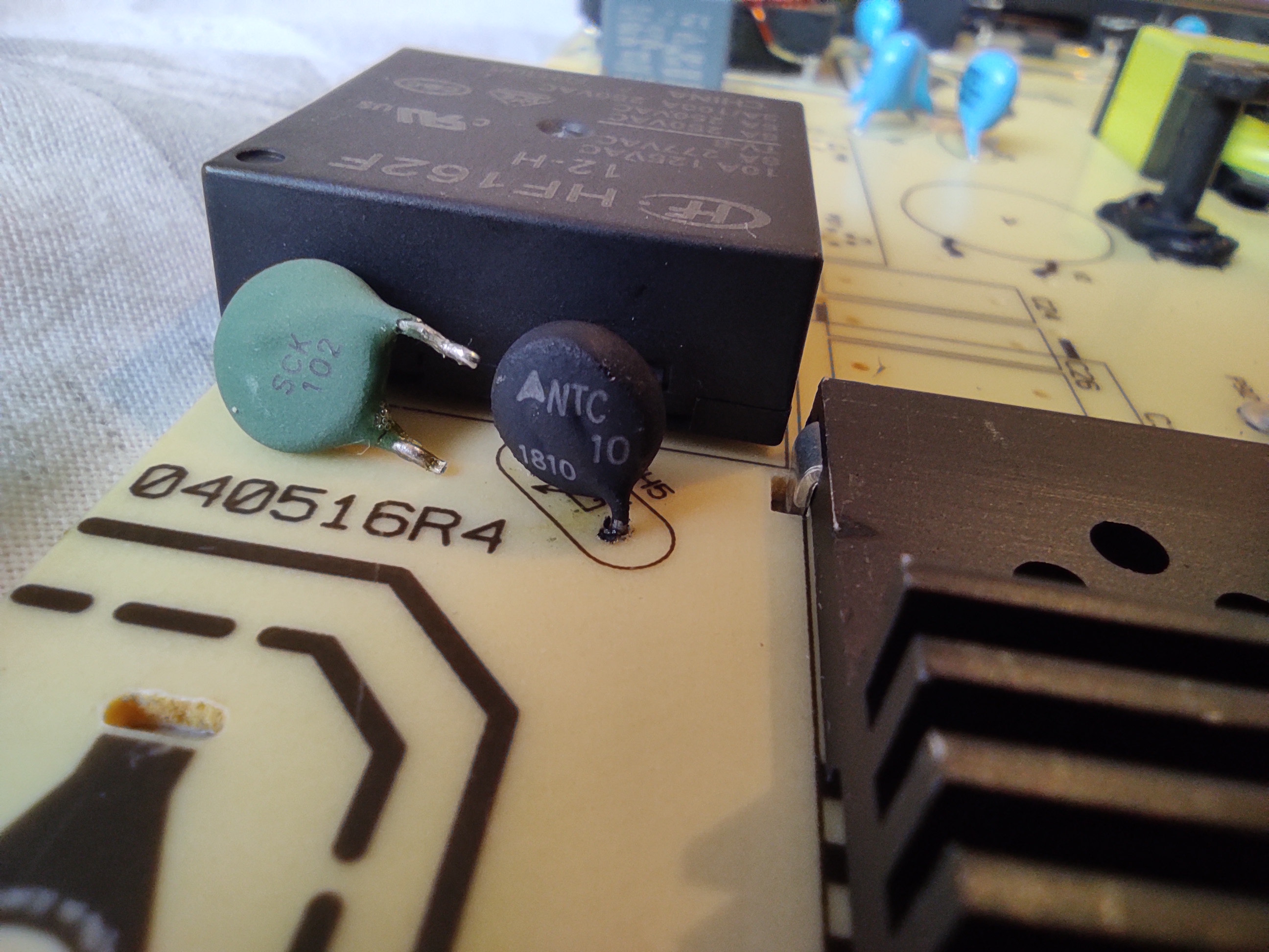

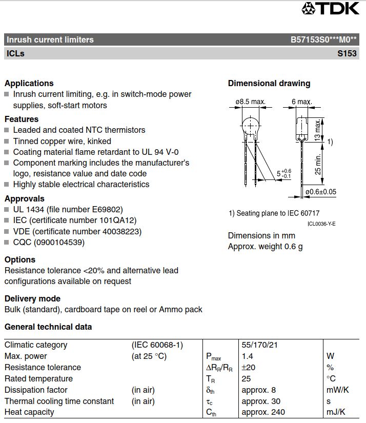

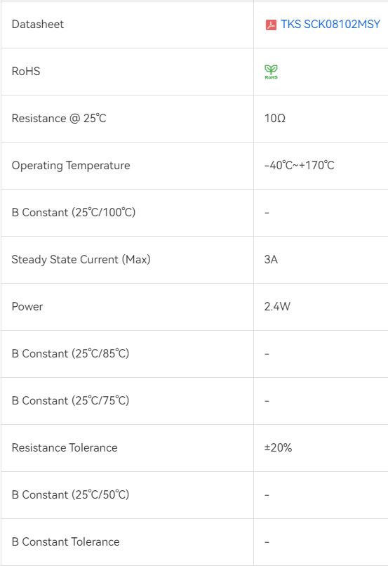

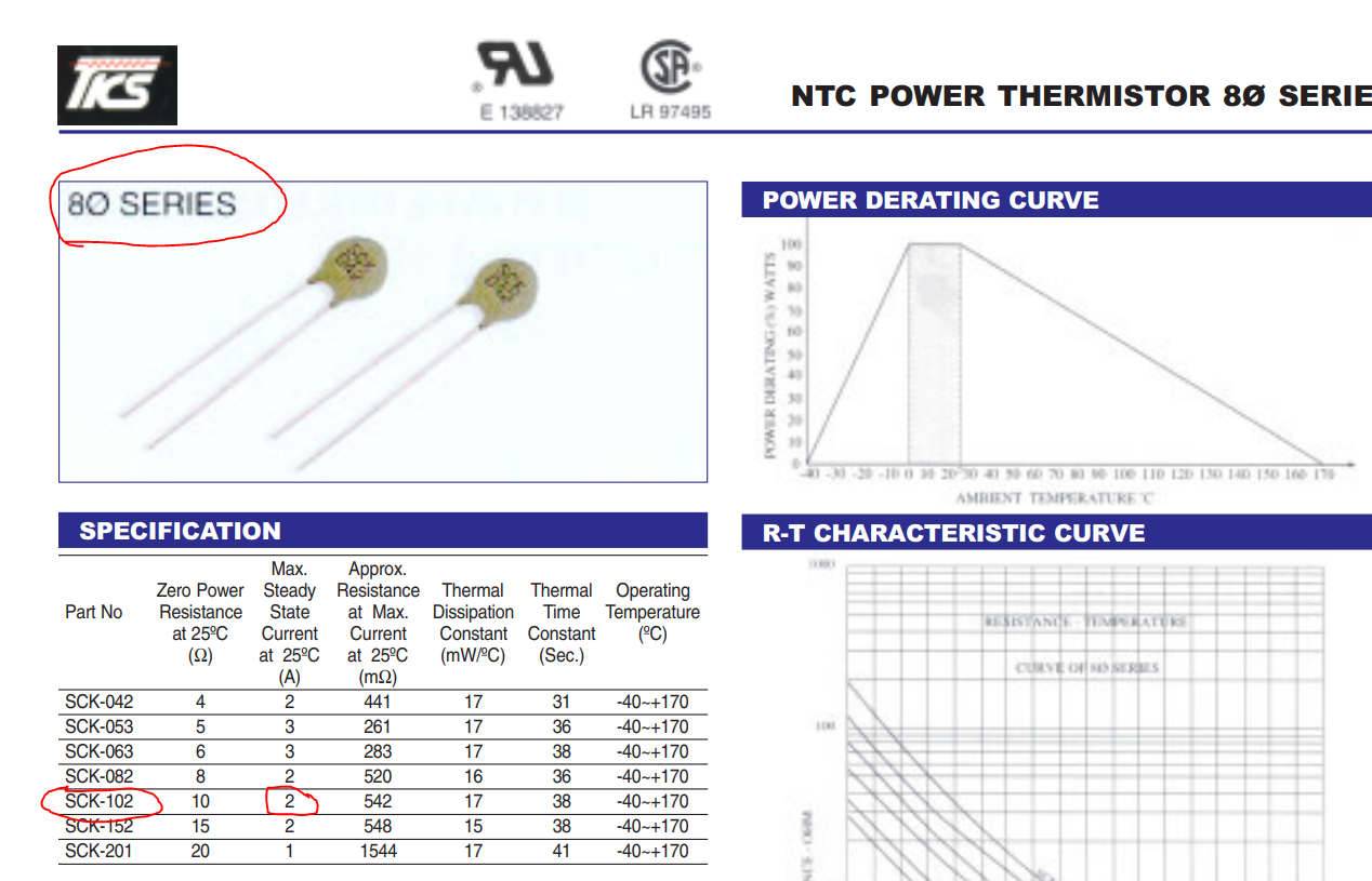

      Re: Bush (Vestel) led40127fhdcntd - turns off and on repeatedly
      reason is im trying to find ones which i can use instead of ordering the same ones from china which will take a month to arrive.
      the shop near me is RS components, which i can get to easily and they have a lot of stuff in stock.
      also i believe the website here: https://www.lcsc.com/product-detail/...Y_C211173.html
      seems to have different info on the product page compared to the datasheet. webpage says its 3A but datasheet says its 2A so thats where i was getting some confusion from.
      there is this one here: https://uk.rs-online.com/web/p/thermistor-ics/1857867
      that seems to be close on specs rated at 2A has 30second Thermal cooling time constant but only 1.4w power rating which is less than the original ones 2.3w. capacitance at 240v is also a lot less at 100uf vs the originals 220uf.
      im in the United Kingdom so if anyone know what i can get a hold of quickly it would be much appreciated.

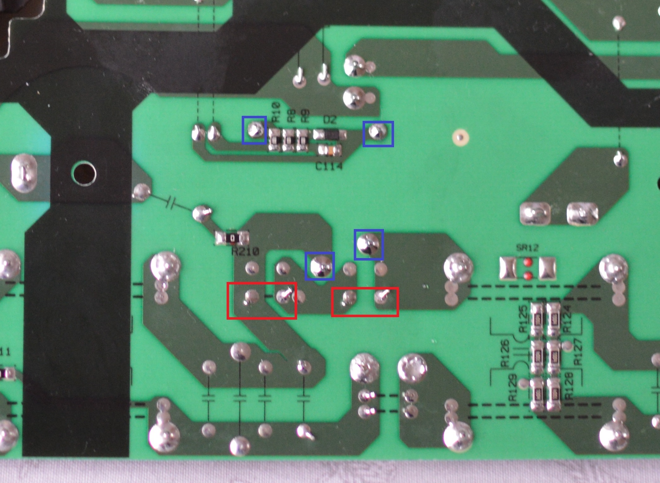

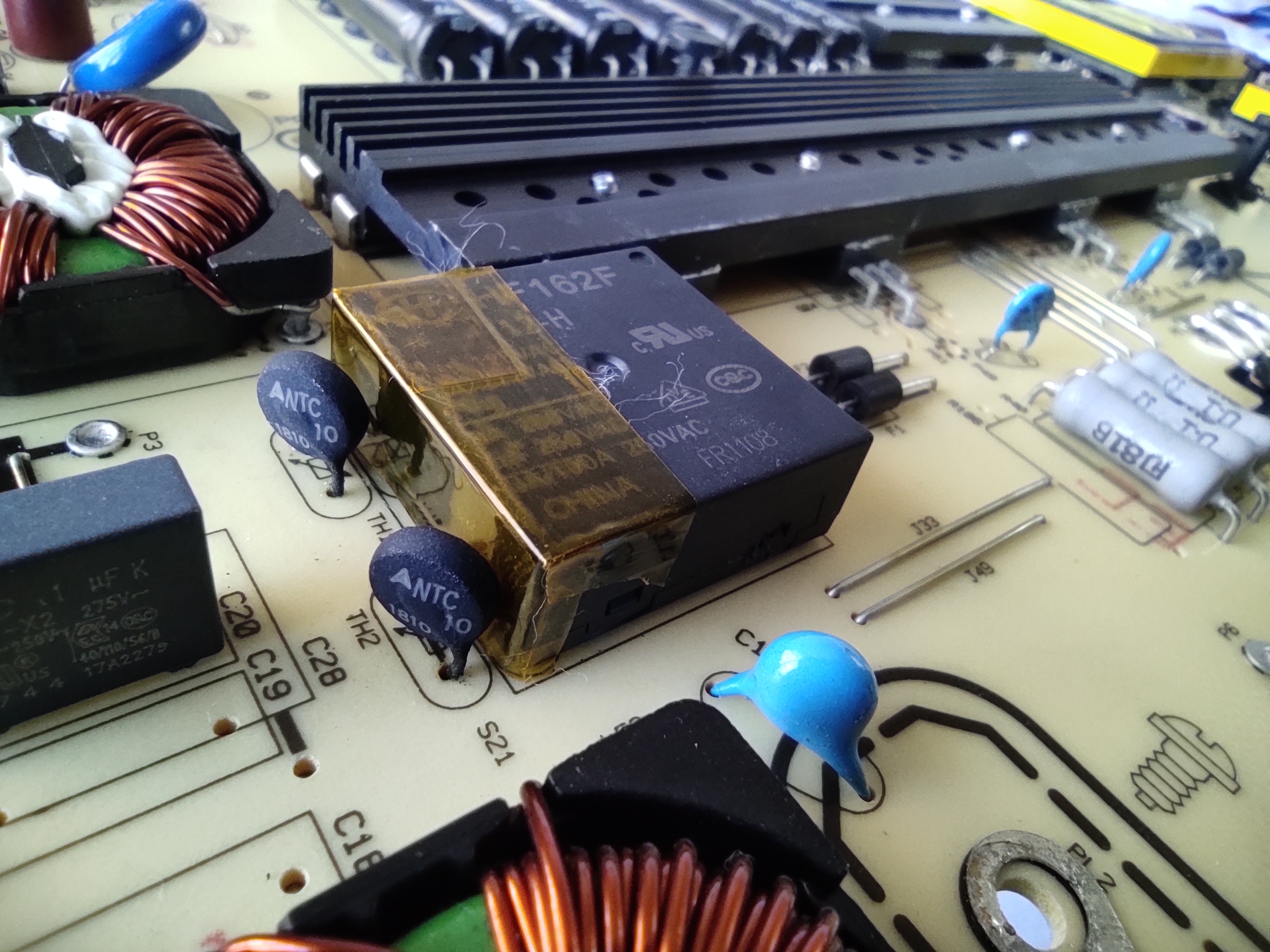

        iv marked the back of the board here, red box is the thermistors and blue boxes are the legs of the relay. dunno if it helps trace something but the more info the better i guess
          They (thermistors) are connected in series to the closing contacts of the relay, for a soft start.

            #165
            thanks for that info. do i have to use the exact original thermistors that were there or can i use any which are marked as 10ohm 2 amp?

                  #168
                  Replace them, you can put one at 20 Ohm.

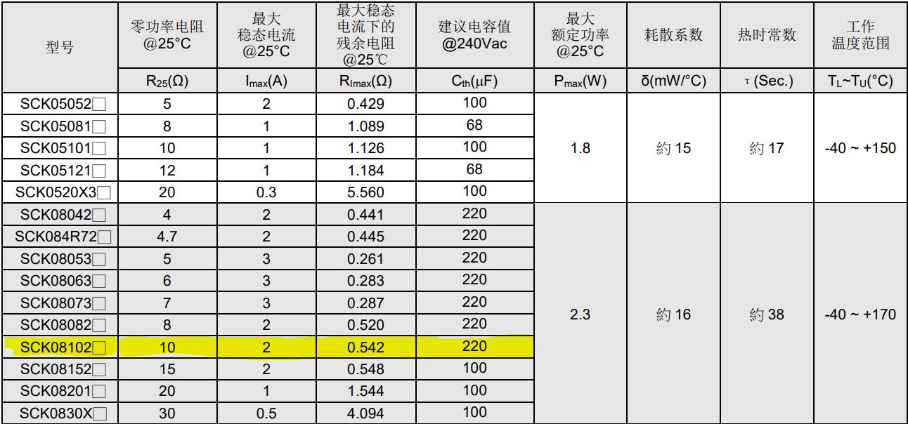

                    #169

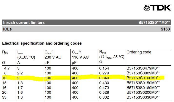

                    can i use these ones linked in the pic below or will they blow up?
                    also i noticed the data sheet says they have a cycle life of 1000 could this by why the original ones popped after 5 years of use with tv being used multiple times every day?
                    also i forgot to add i got a multimeter across the blown thermistors and the have values of 38.5ohms and 226kohms. the working one has 14.2ohms (around 16c temp in my room) and when i hold it with my fingers its ohms start dropping down.

                      #170
                      38.5ohms and 226kohms - These are no longer workers, especially the second one.

                        Thanks for the reply, did you have a look at the specs of the tdk ones i posted above? Would they be safe to use?

                          #172
                          hey all, i replaced the 2 thermistors and now its working properly. tv turns off and stays off.
                          question is now, the 3rd thermistor on the board that is not blown up should i replace it too or leave it as it is?
                          had to buy a 5 pack of thermistors total cost was £2.90ish so iv got 3 left.
                          got to thank everyone for their support.

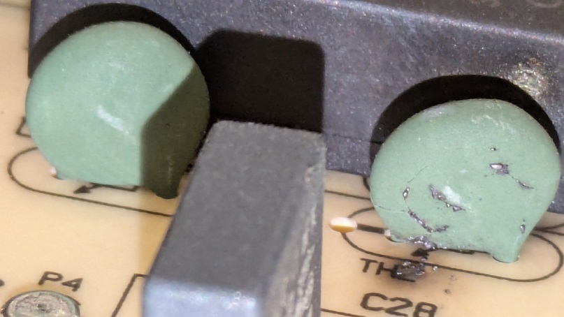

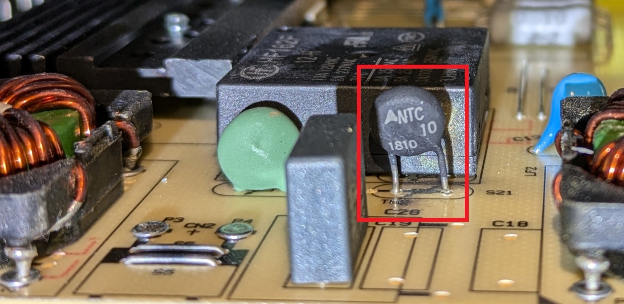

                                    I have opened the TV, and can see that TH2 (just one of the three) thermistor is burnt, photo attached. I do not see any markings, but based on the earlier post from slybunda it must be SCK 102.
                                    lotas, I see you have suggested to replace it with 20 Ohm (https://www.badcaps.net/forum/troubl...e9#post1867354), is that right? or did you mean replacing two of the old ones with one 20 Ohm? I believe slybunda said original ones were 10 Ohm each.
                                    thanks in advance

                                      #178
                                      Yes, I had to remove two of 10 and put a jumper in the place of one and set it to 20 in the place of the other.

                                        #179
                                        I have replaced one burnt thermistor with a new 10 Ohm one (https://uk.rs-online.com/web/p/thermistor-ics/1857867), left the other old ones in place as they did not look damaged.
                                        The TV is working fine again, hopefully this will be a permanent fix.
                                        Thanks to this forum and specifically to lotas and slybunda for detailed guidance.
