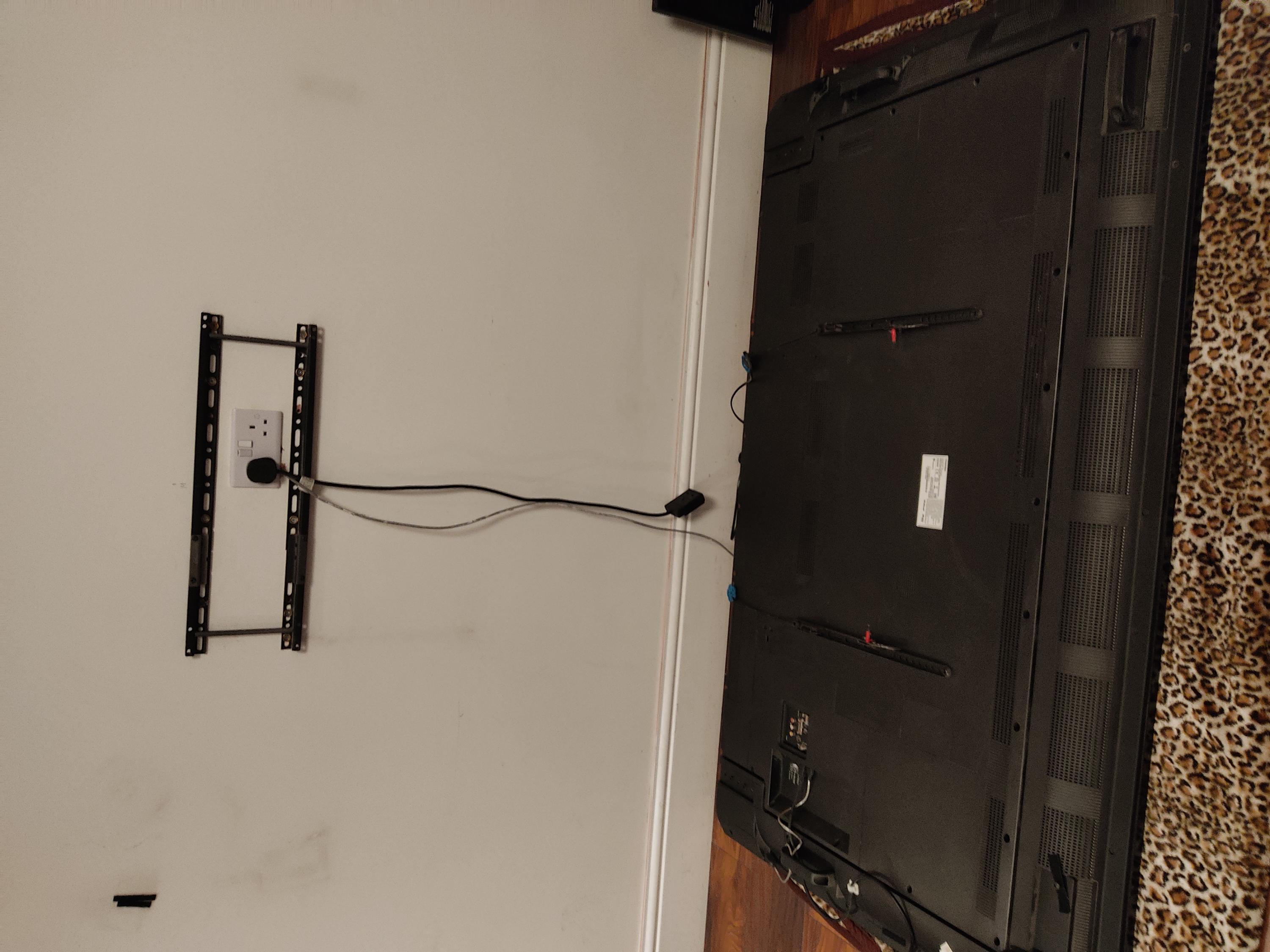

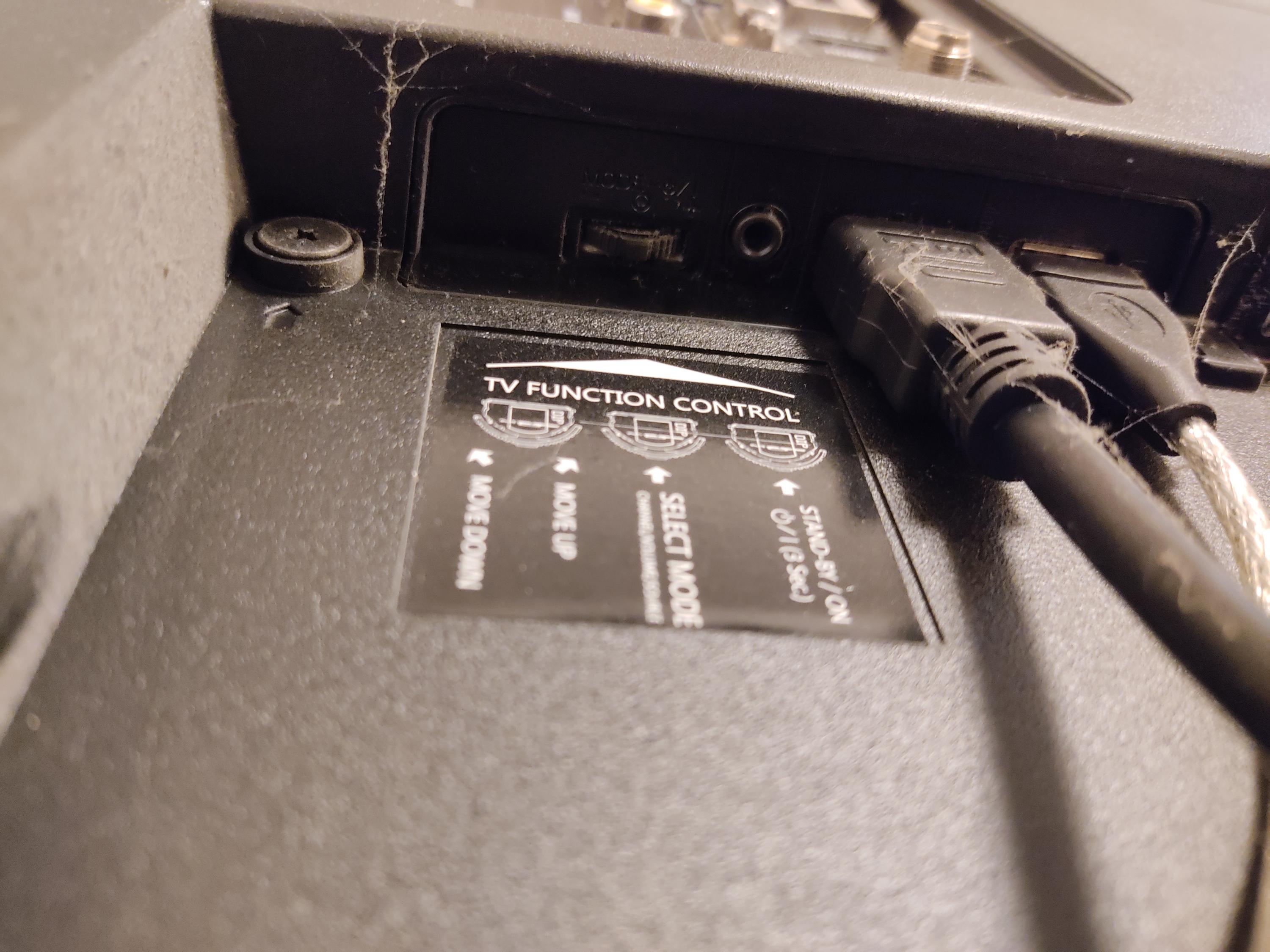

            • slybunda
              • Feb 2012
              • 139
              #146
              Re: Bush (Vestel) led40127fhdcntd - turns off and on repeatedly
              its a toshiba 75u6763db.
              when i press power button the screen goes off and i hide the remote behind me but tv still comes back on by itself and turns off and on again and again until i catch it when the red light is on and hit the power button on the remote then it turns on and stays on.
              however last night it seems to have stayed off but iv not tried using it today. will try it and post back.
              • lotas
                • Jan 2016
                • 4809
                • Russia
                #147
                So maybe your TV button itself is “leaking”, has oxidation inside, which leads to false activation of switching on and off.

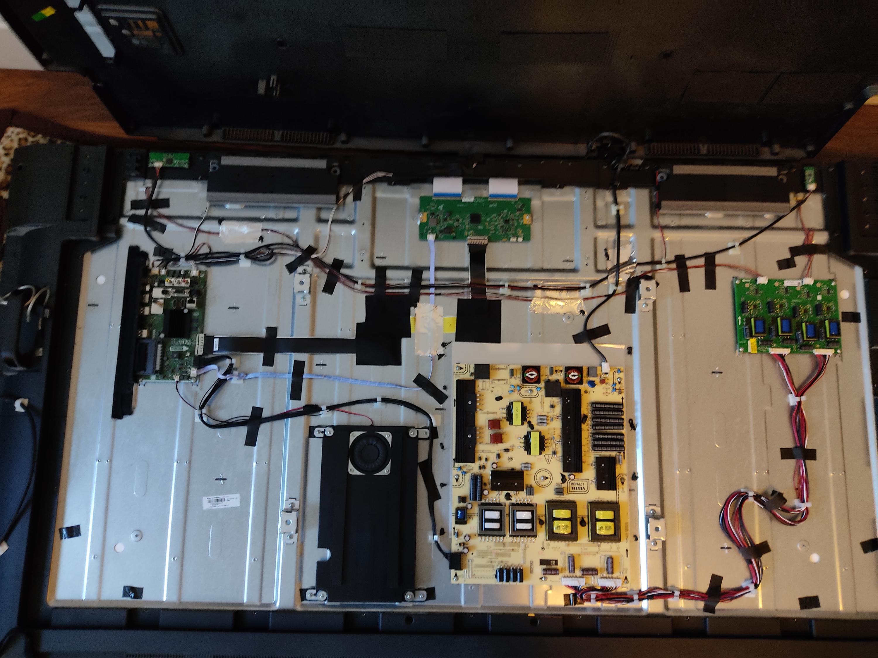

                • slybunda
                  • Feb 2012
                  • 139

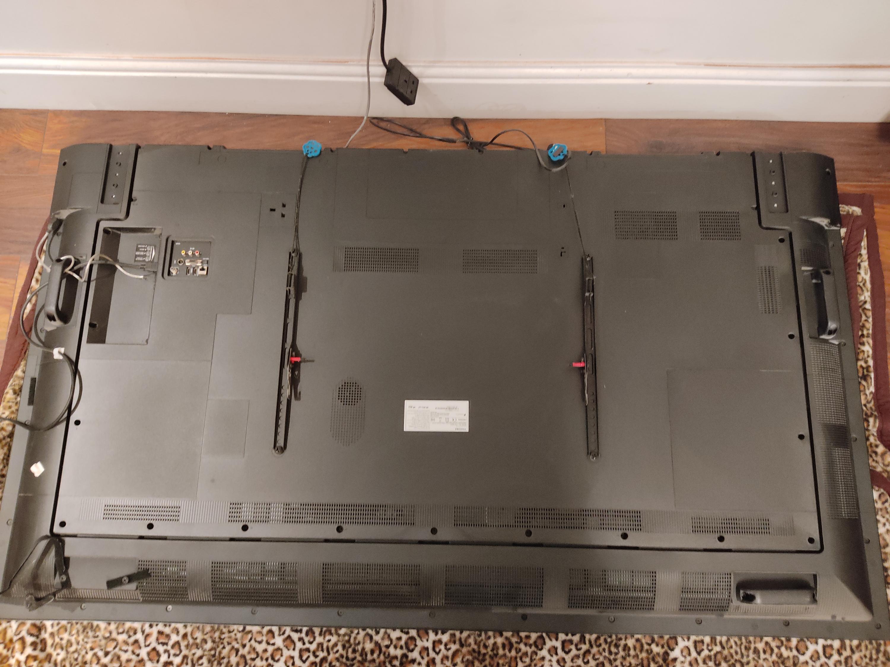

                  #148
                  tv was doing the same thing today. powers on and stays on and works fine but when power button pressed on remote tv goes off but then comes back on and keeps cycling on and off until i press the power button on the remote while its got the red light on and off and then it powers on and stays on.
                  have taken it off the wall now since i had some help from the wife. deffo a 2 man job to take it off the wall.
                  will take the back cover off tomorrow and have a look inside.
                  some pics attached

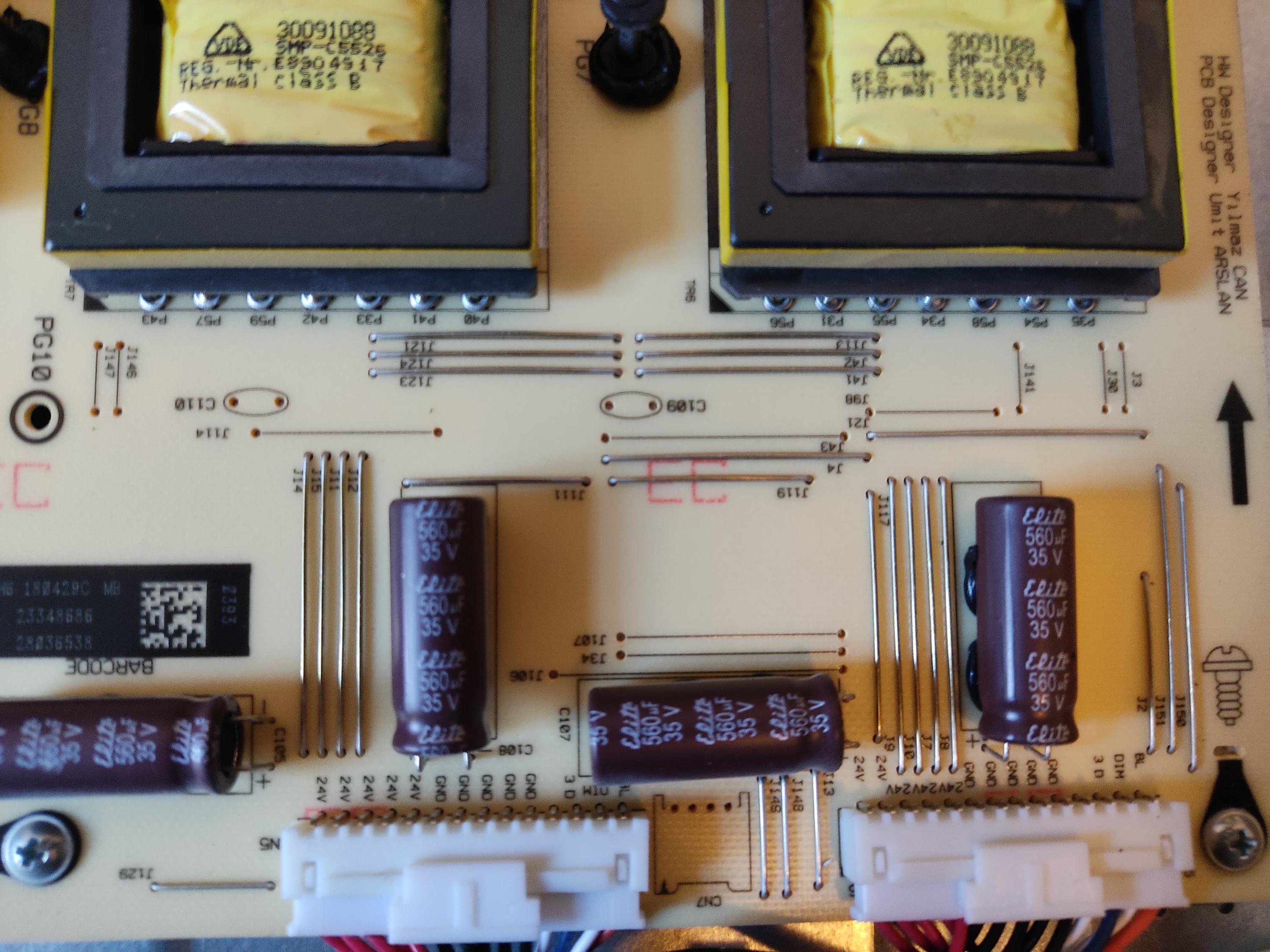

                  • slybunda
                    • Feb 2012
                    • 139

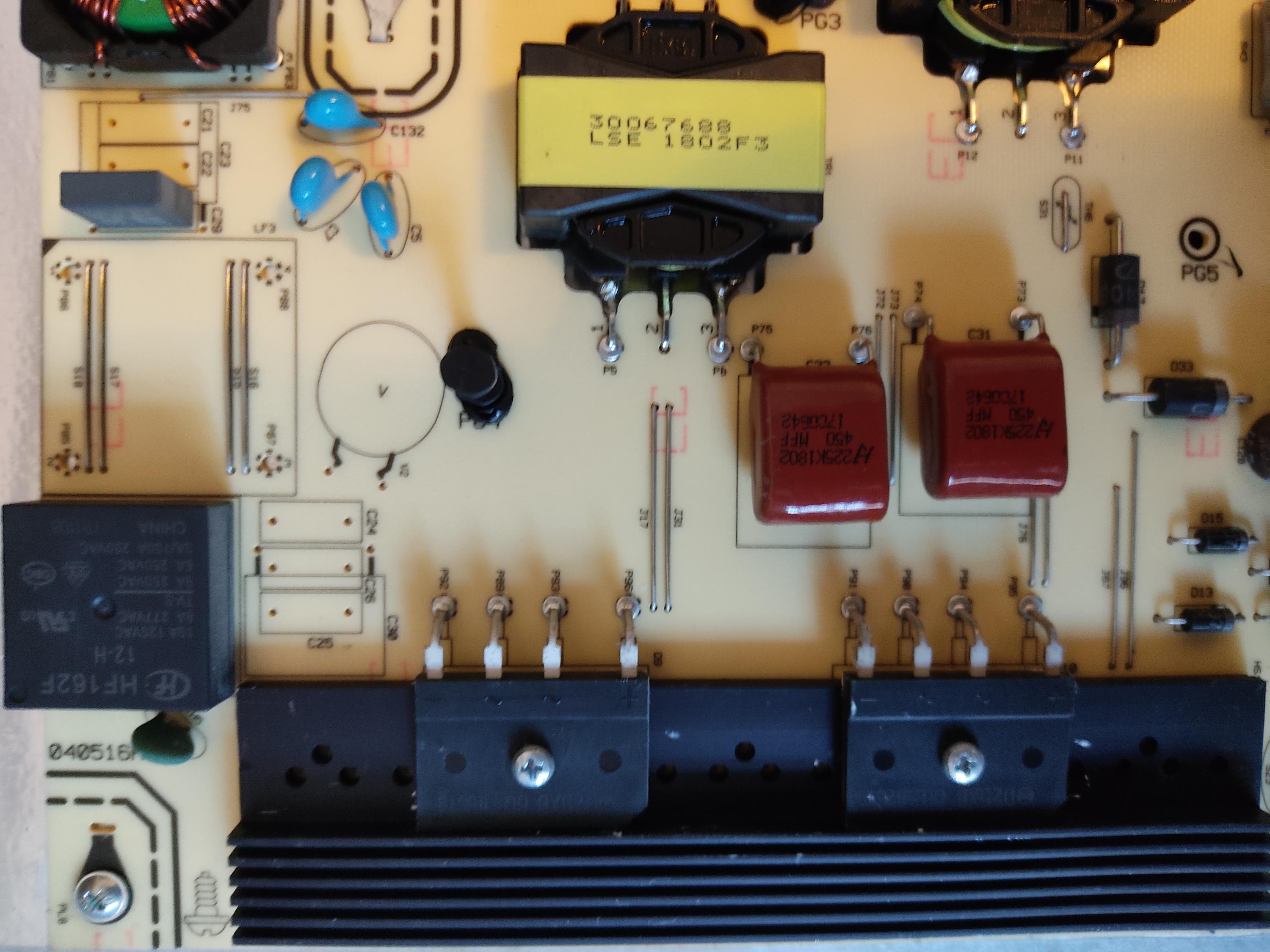

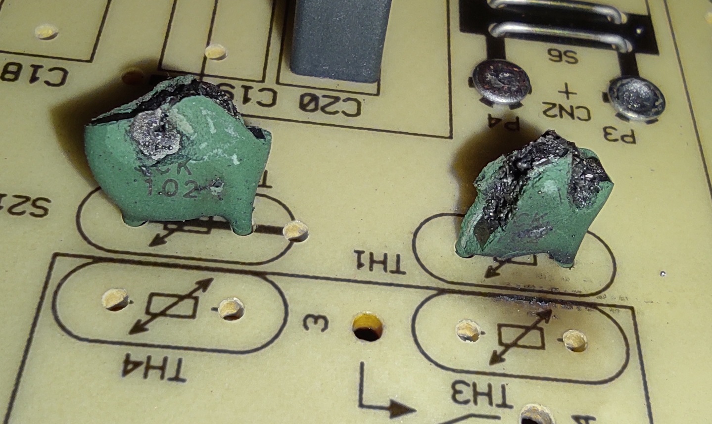

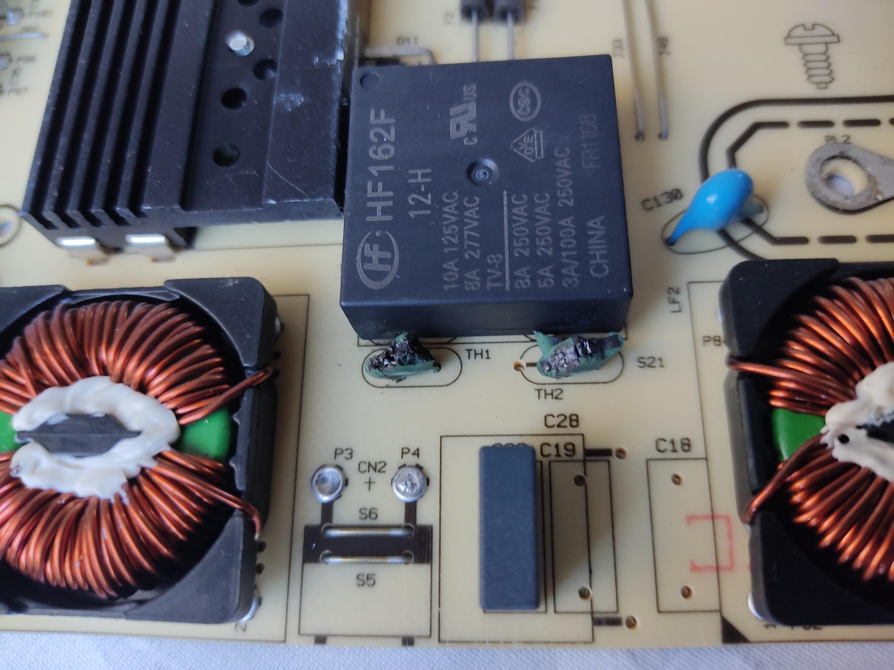

                    #149
                    looks like i may have found the problem: pics attached
                    looks like 2 green things i think they were thermistors are popped. not sure what type they were but found another green one next to another one of those black boxes which might be a relay of sorts.
                    what to do? not sure what the original ones were in size or type since they blown up and cant see any marking on them now.
                    guess its good news that there is something visible to this. also that would explain the loud popping noise i get when turning tv on sometimes.

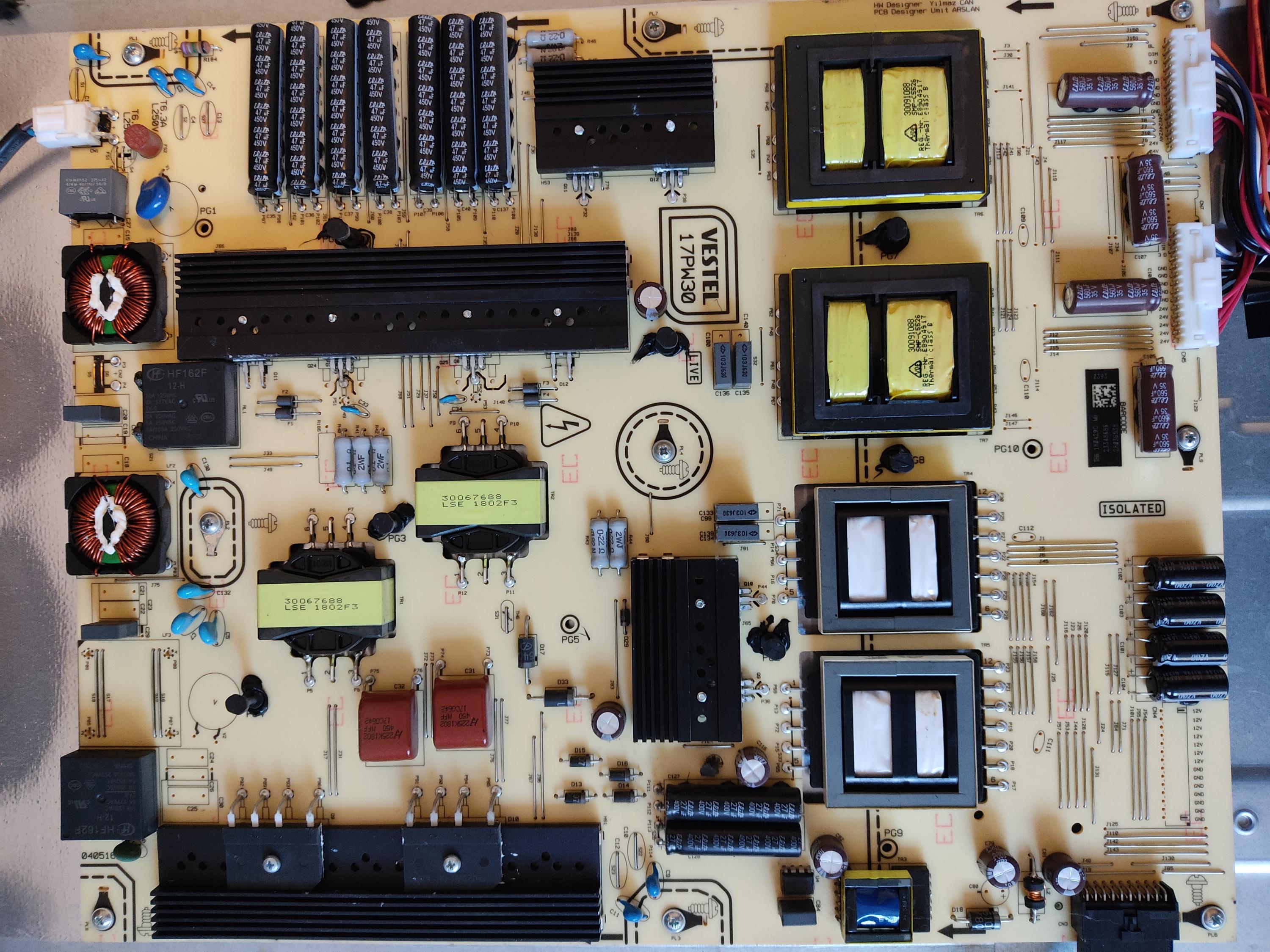

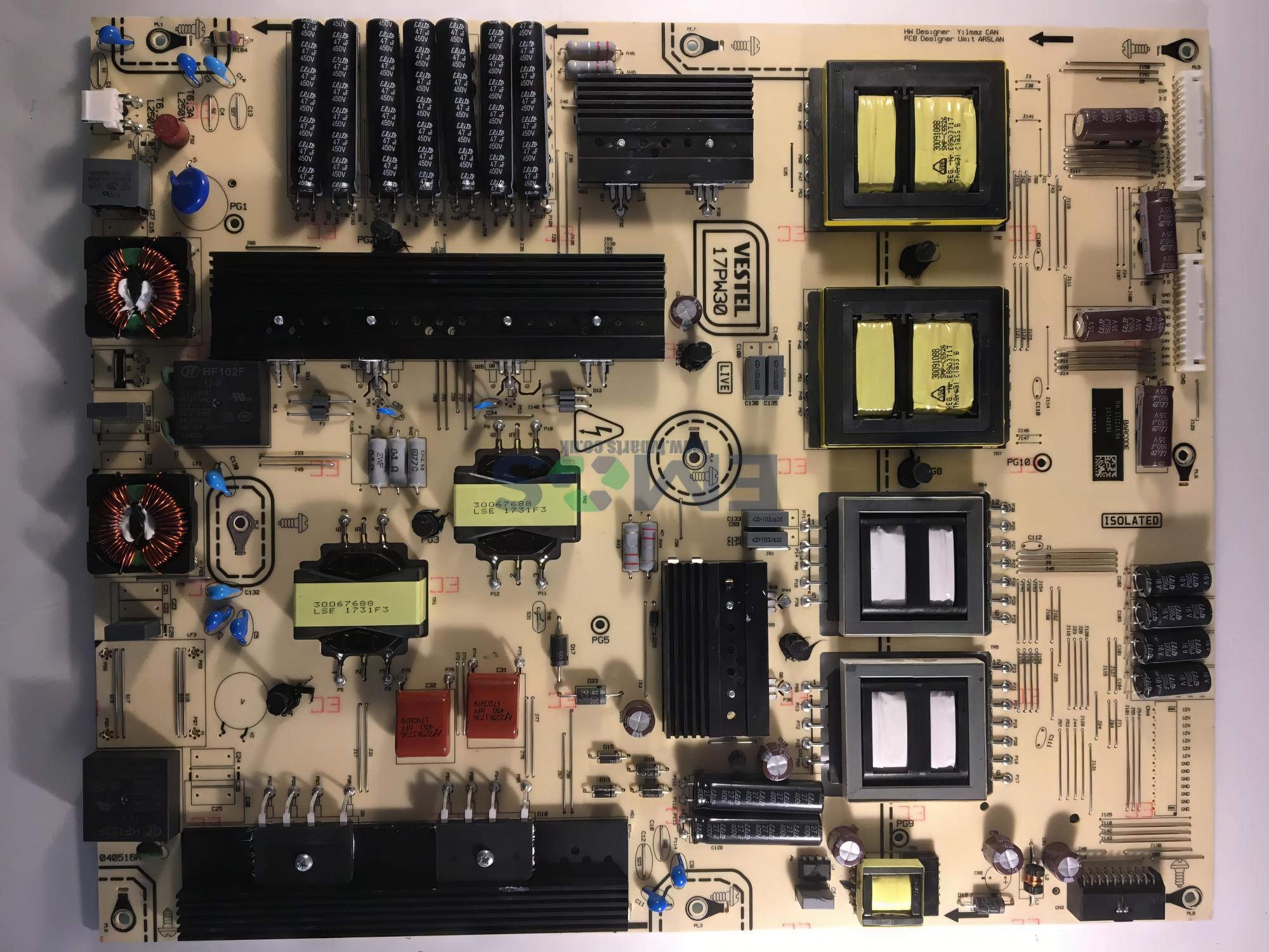

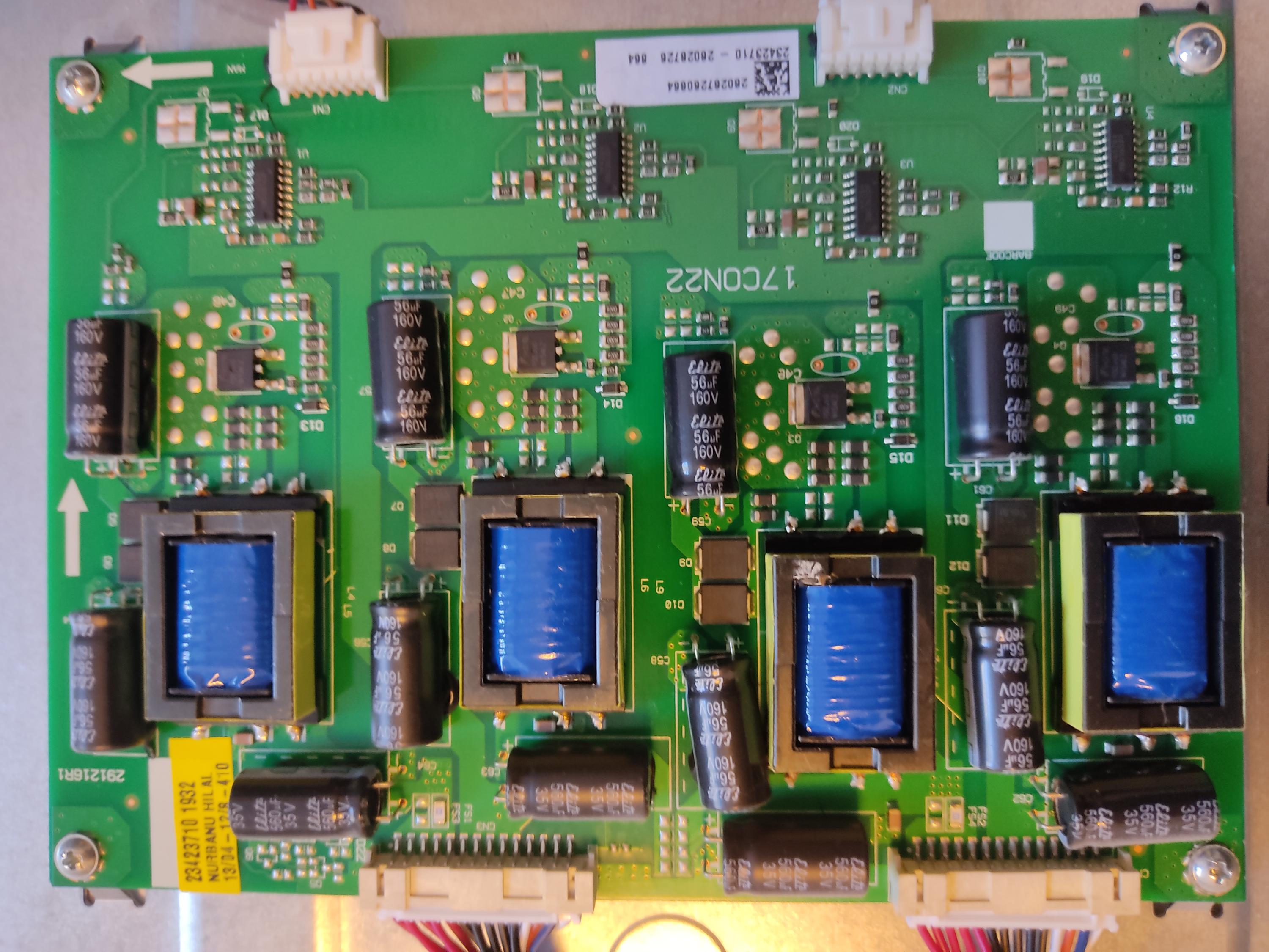

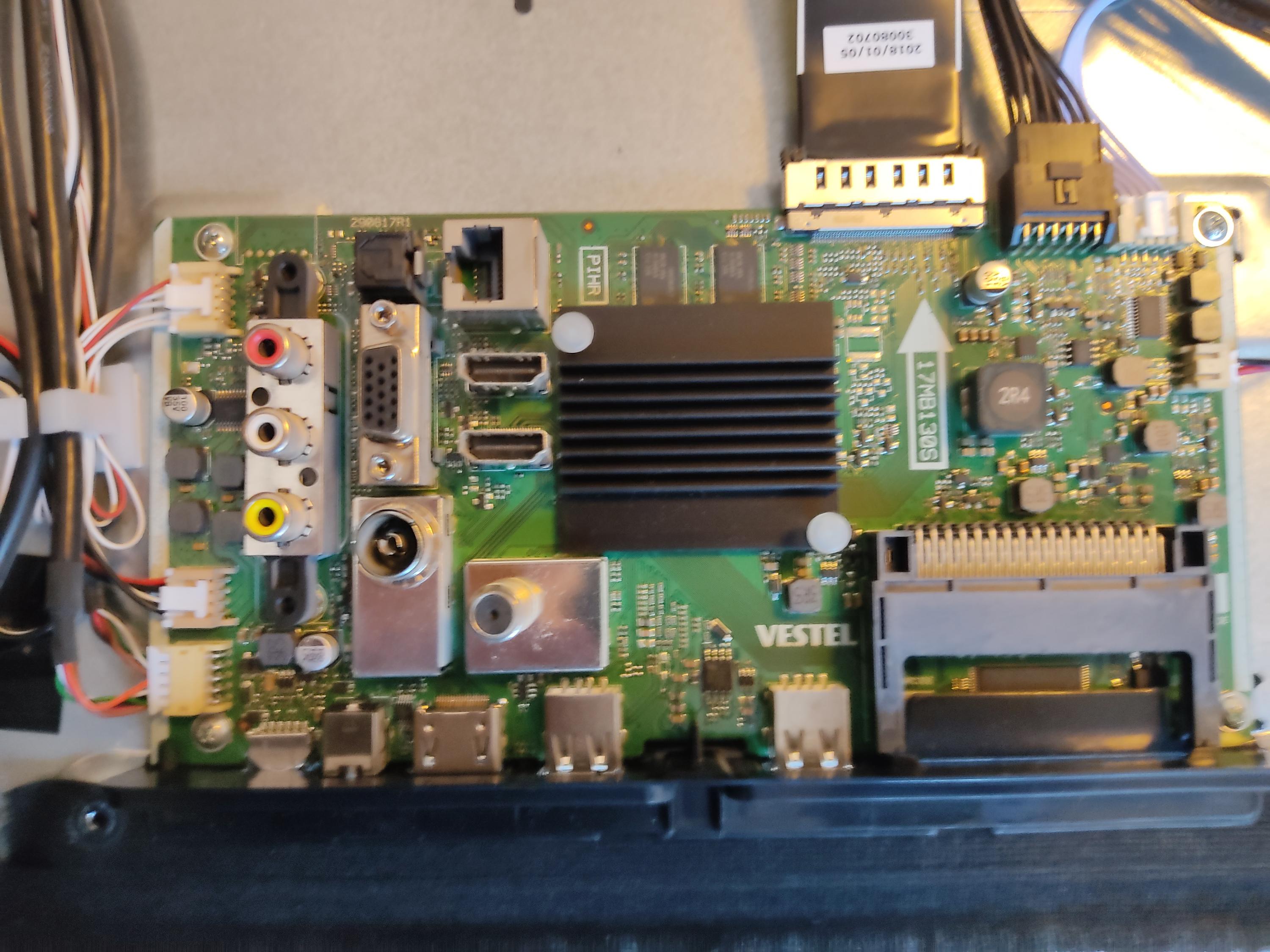

                    • slybunda
                      • Feb 2012
                      • 139

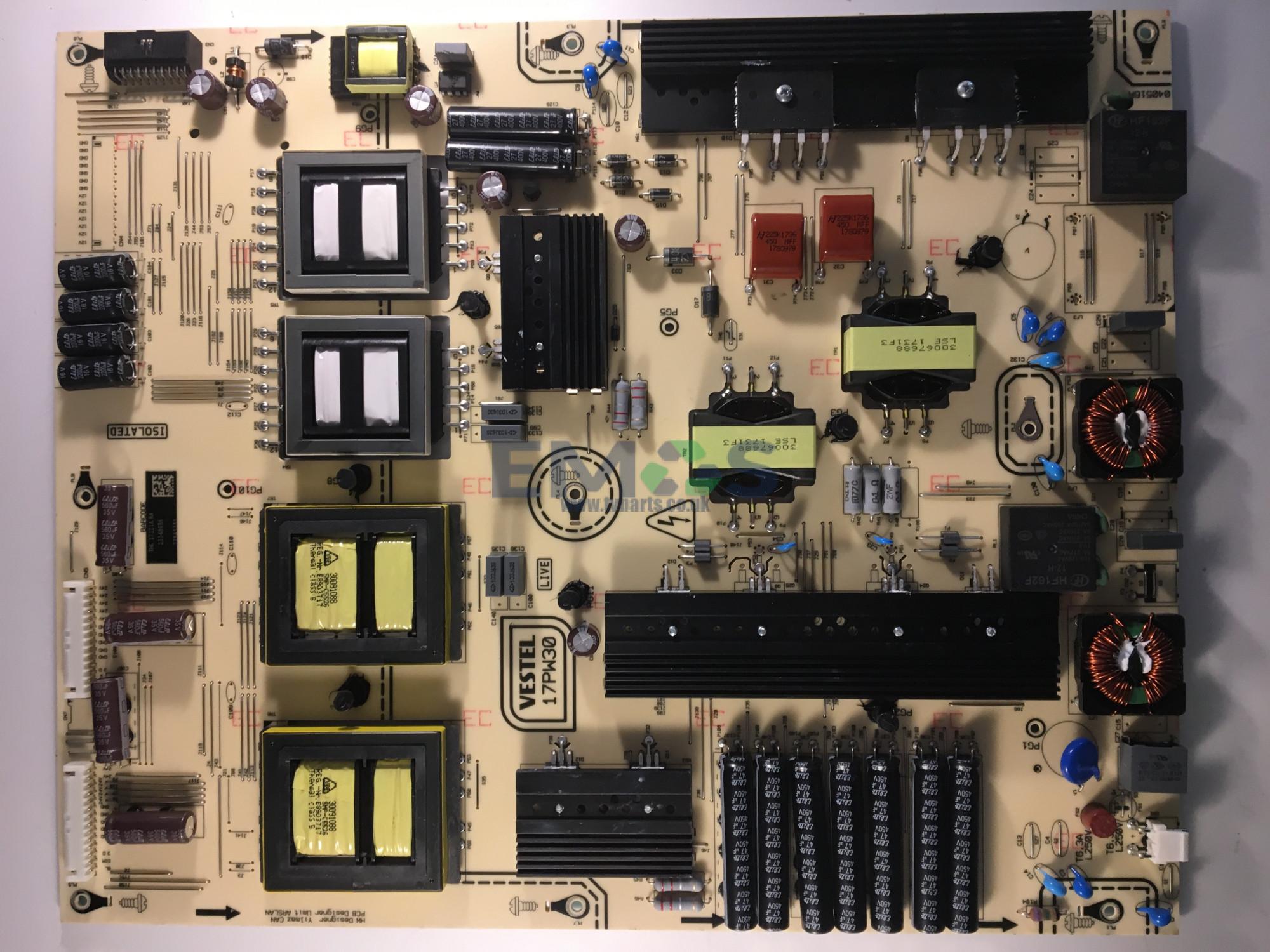

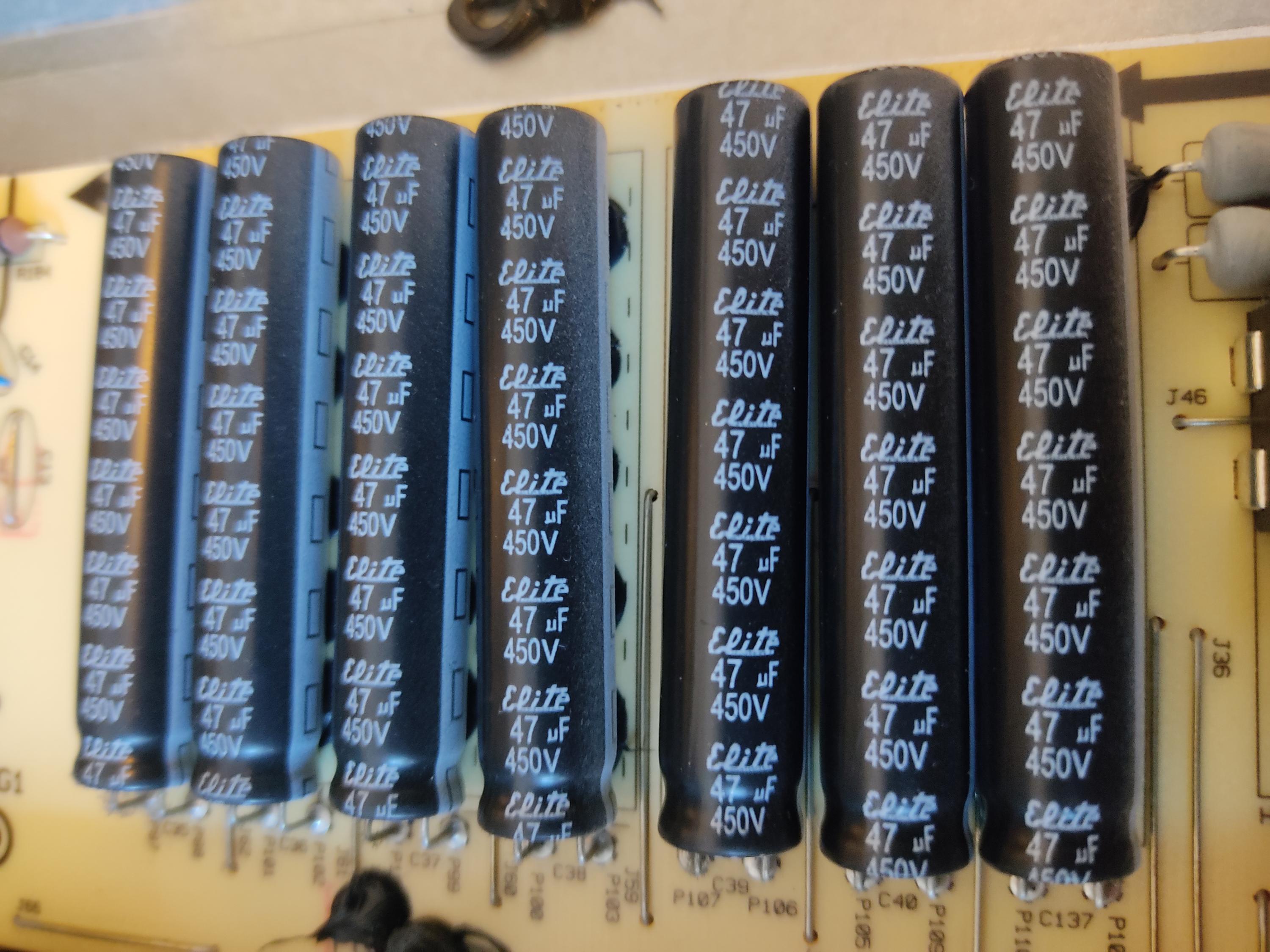

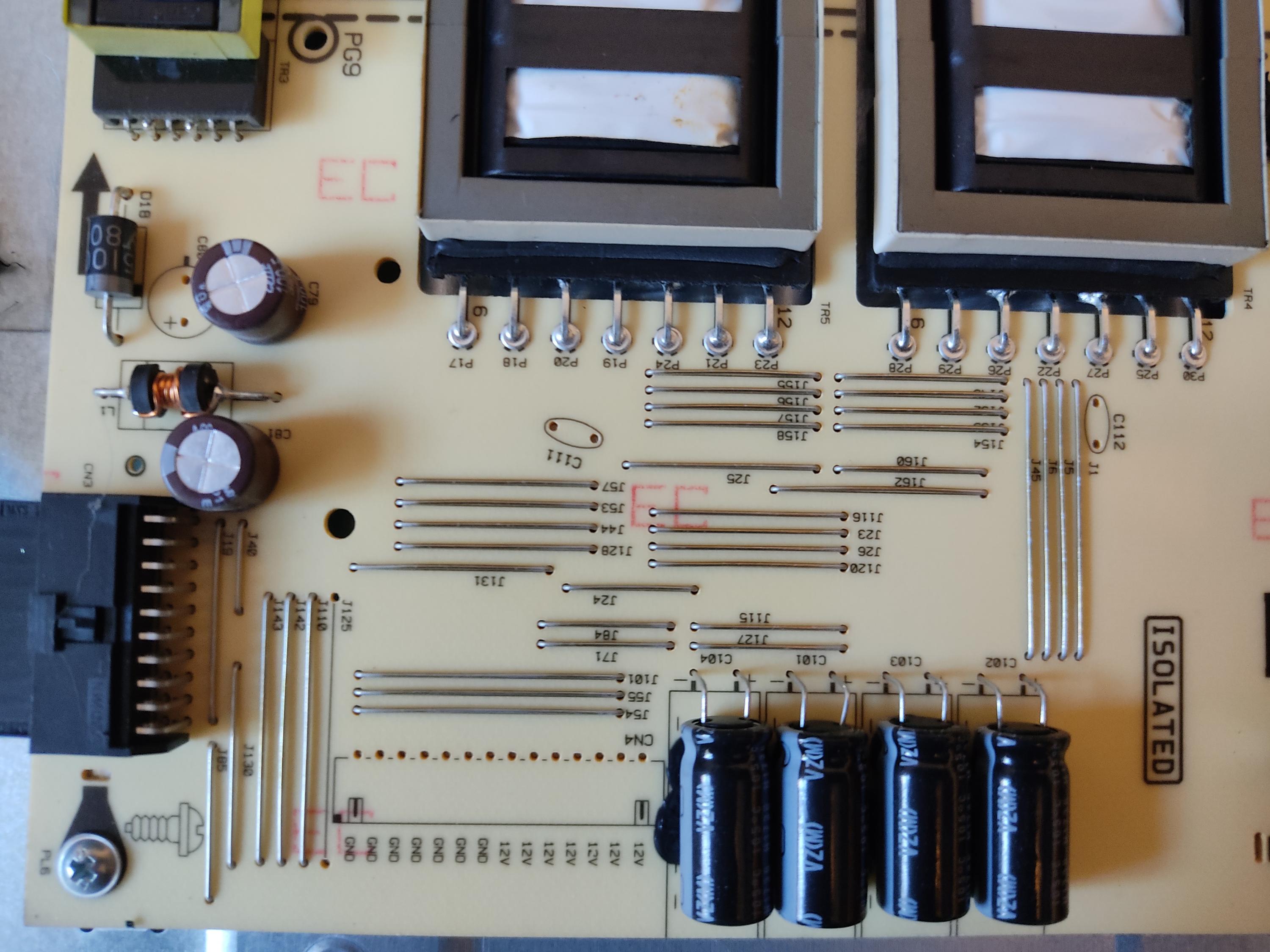

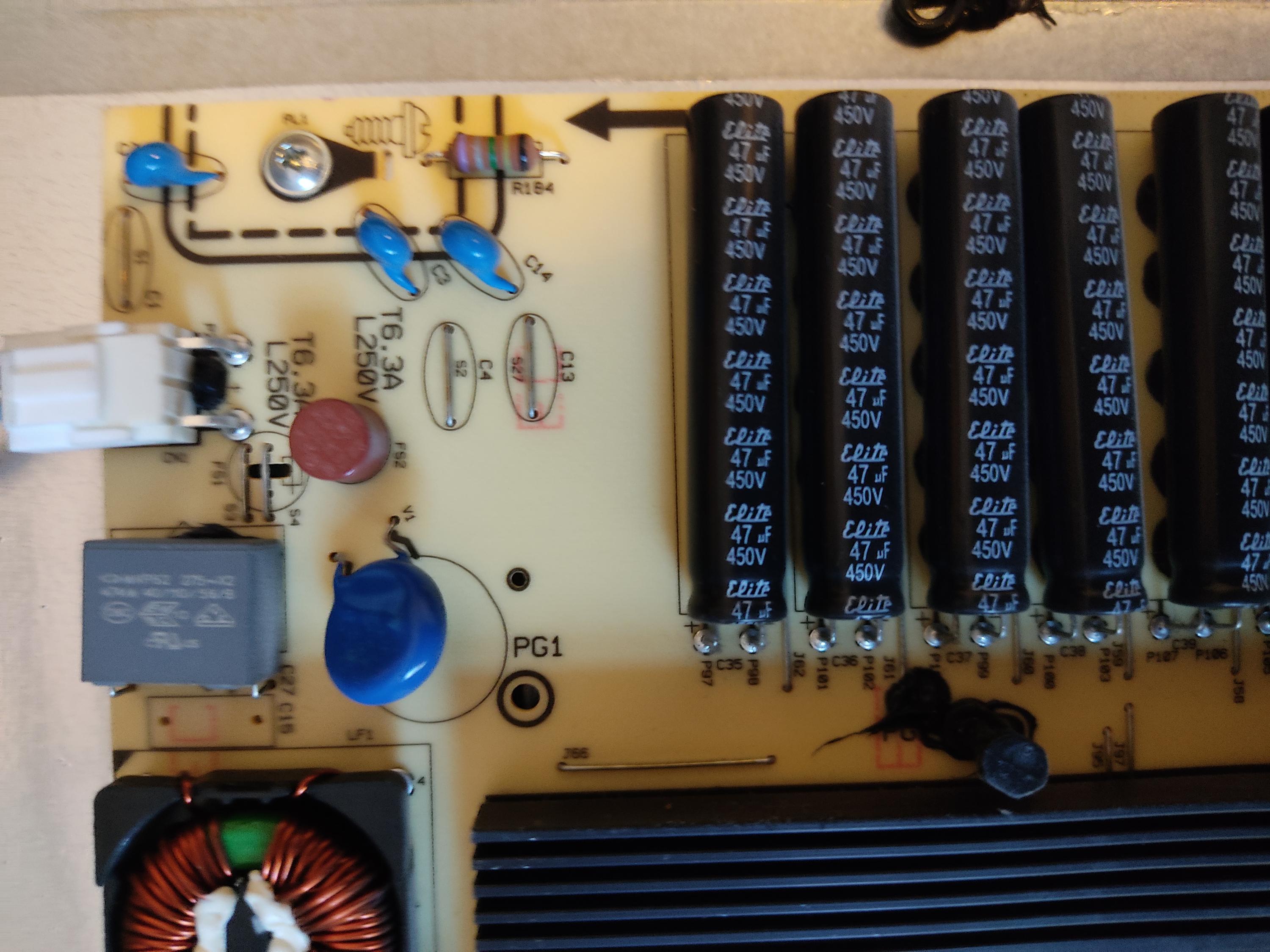

                      #150
                      added some extra pics of the board incase anyone is interested or has similar issues and would benefit from them.

                        #151
                        just to add, iv checked the mosfets with multimeter and not seeing any shorts , the 2 blown thermistors have resistance values of 38.5ohm and 226kohm. the not blown one on the board has a reading of 14.2ohm.
                        issue is that the tv once turned on wont turn off. now i dont know if thermistors can cause that sort of issue.
                        also not sure what would have caused them to blow in the first place? power spike from the mains or something else? odd that when turned on the tv stays on and works fine for hours.

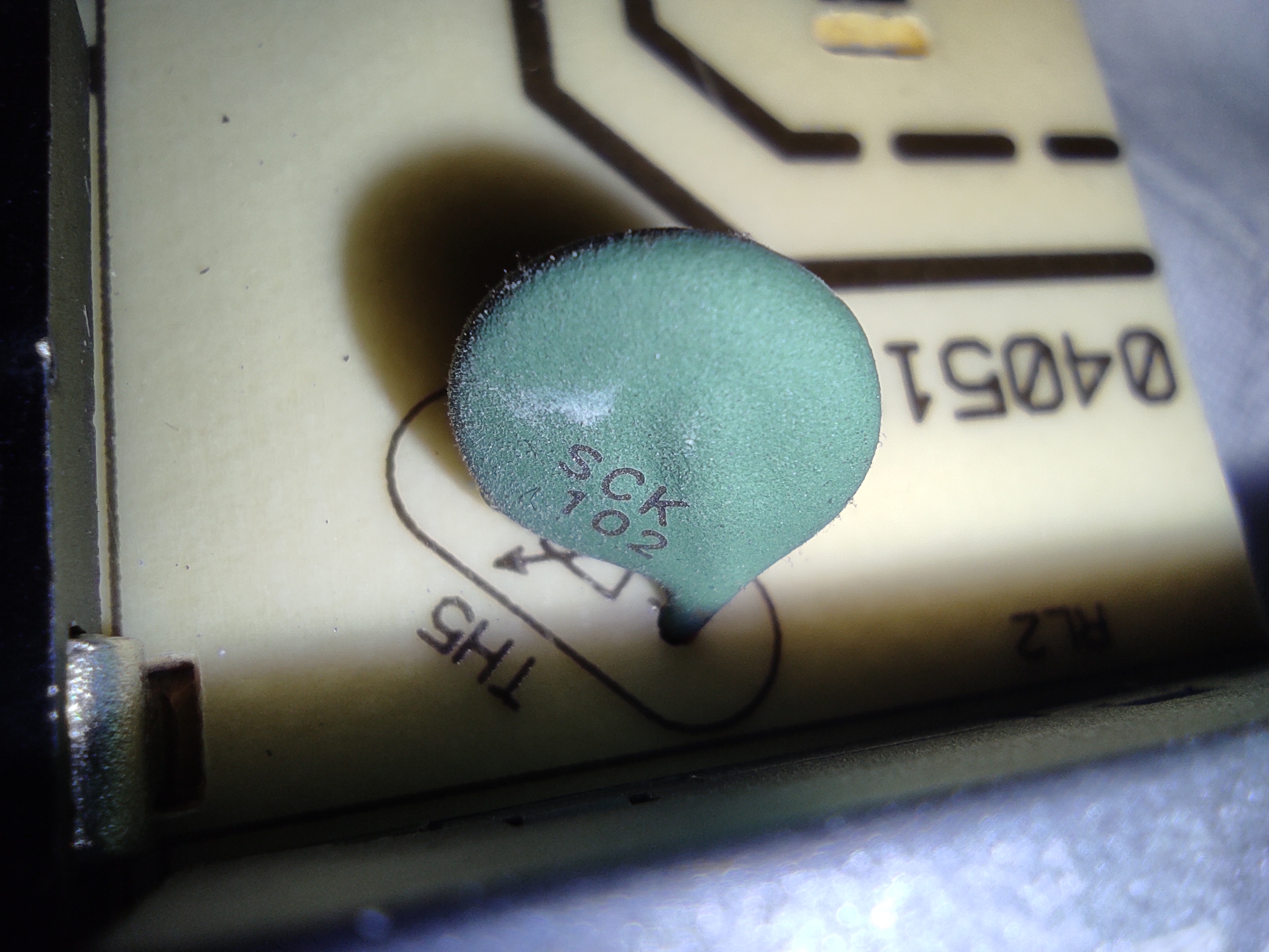

                          #152

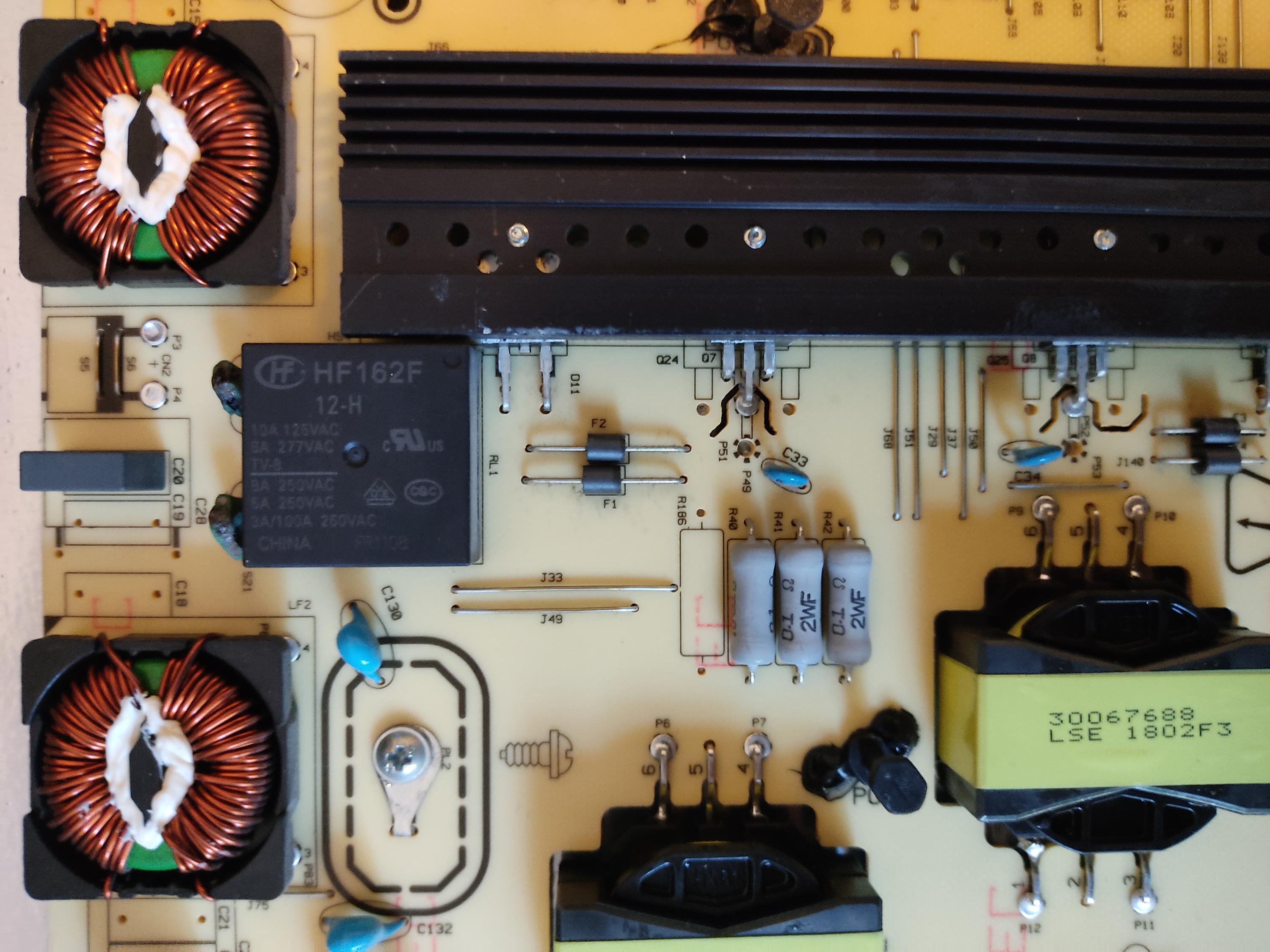

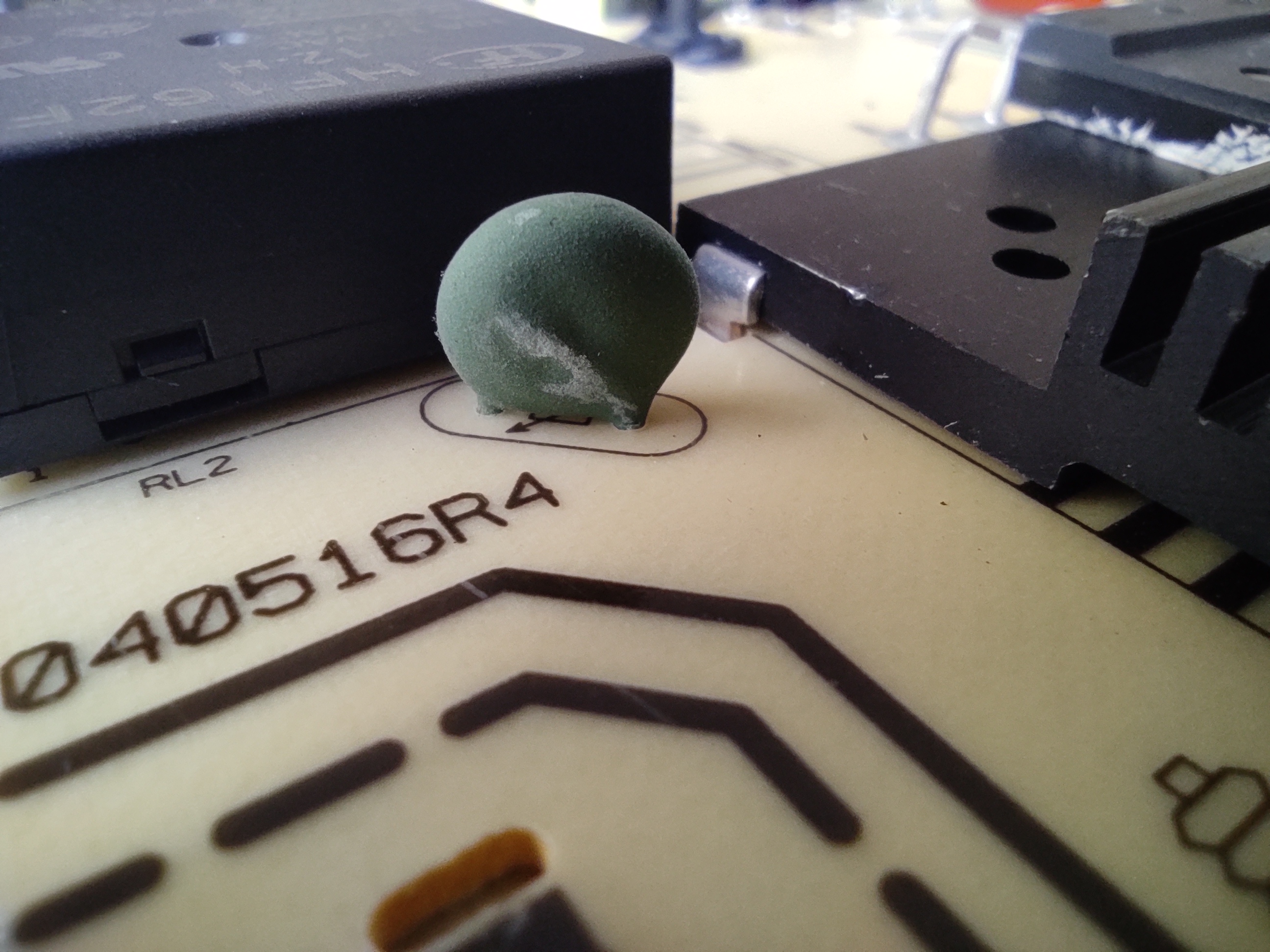

                          backside of the working thermistor has a line going through it, not sure if thats normal or not. pic attached

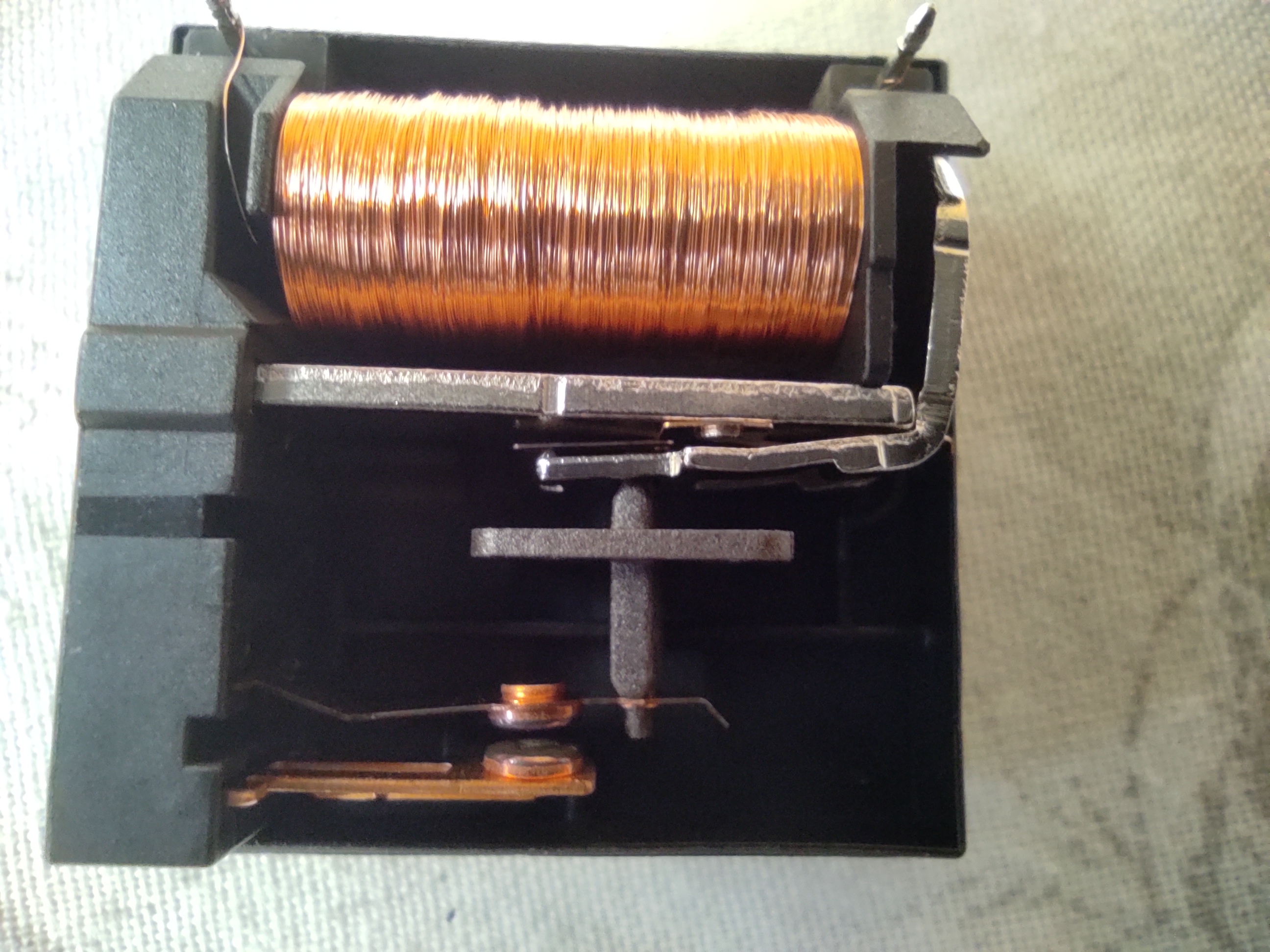

                            #153
                            took the relay off and had a look inside, all seems good, was also able to get a look at the blown thermistor, looks like its a SCK 102
                            pics attached

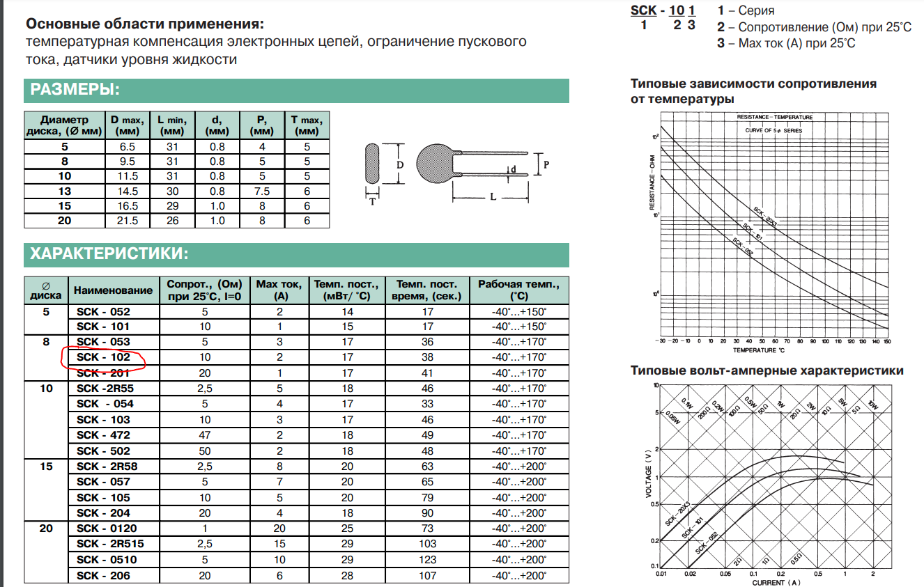

                              • lotas
                                • Jan 2016
                                • 4809
                                • Russia
                                #155
                                SCK-102 - NTC thermistor 10 Ом, 2 А, 20%
                                • slybunda
                                  • Feb 2012
                                  • 139

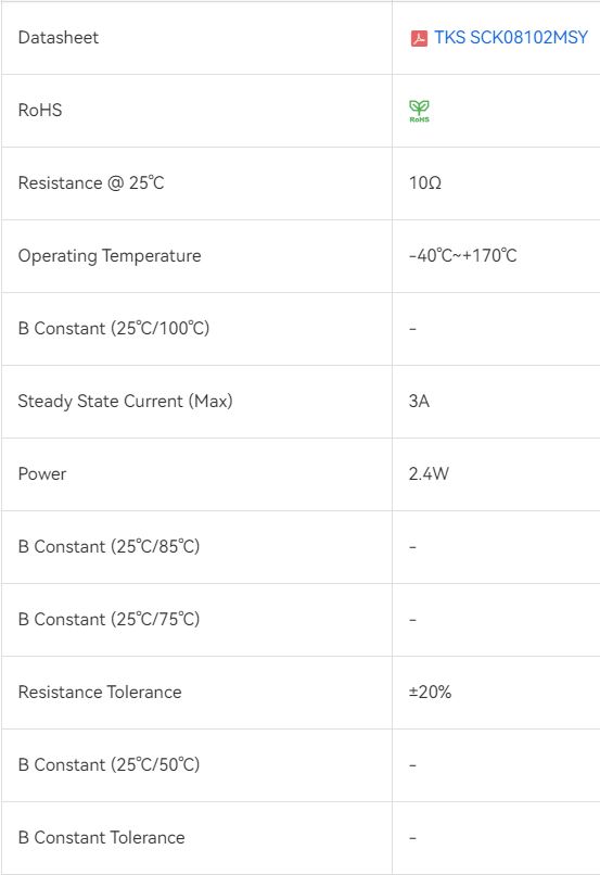

                                  #156
                                  Odd the info i got from here: https://www.lcsc.com/mobile/product-...Y_C211173.html
                                  Says its 10 ohm 3 amp 2.4w?
                                  • slybunda
                                    • Feb 2012
                                    • 139

                                    • lotas
                                      • Jan 2016
                                      • 4809
                                      • Russia
                                      #158
                                      Sck-10(2) The last digit indicates amperes.
                                      • slybunda
                                        • Feb 2012
                                        • 139
                                        #159
                                        Ahh cool, what sort of wattage should it be?
                                        • slybunda
                                          • Feb 2012
                                          • 139
                                          #160
                                          https://www.lcsc.com/product-detail/...Y_C211173.html
                                          website above has given me this info on the SCK102
                                          pic attached.
                                          when selecting a thermistor what does the specs need to match? is it just got to be the ohm rating at 25c temp?
                                          what is thermal time constant rating? i see this vary on similar spec thermistors. the SCK102 has 38 seconds and im struggling to find one that matches that exactly, most are 30s or 60s or more?
