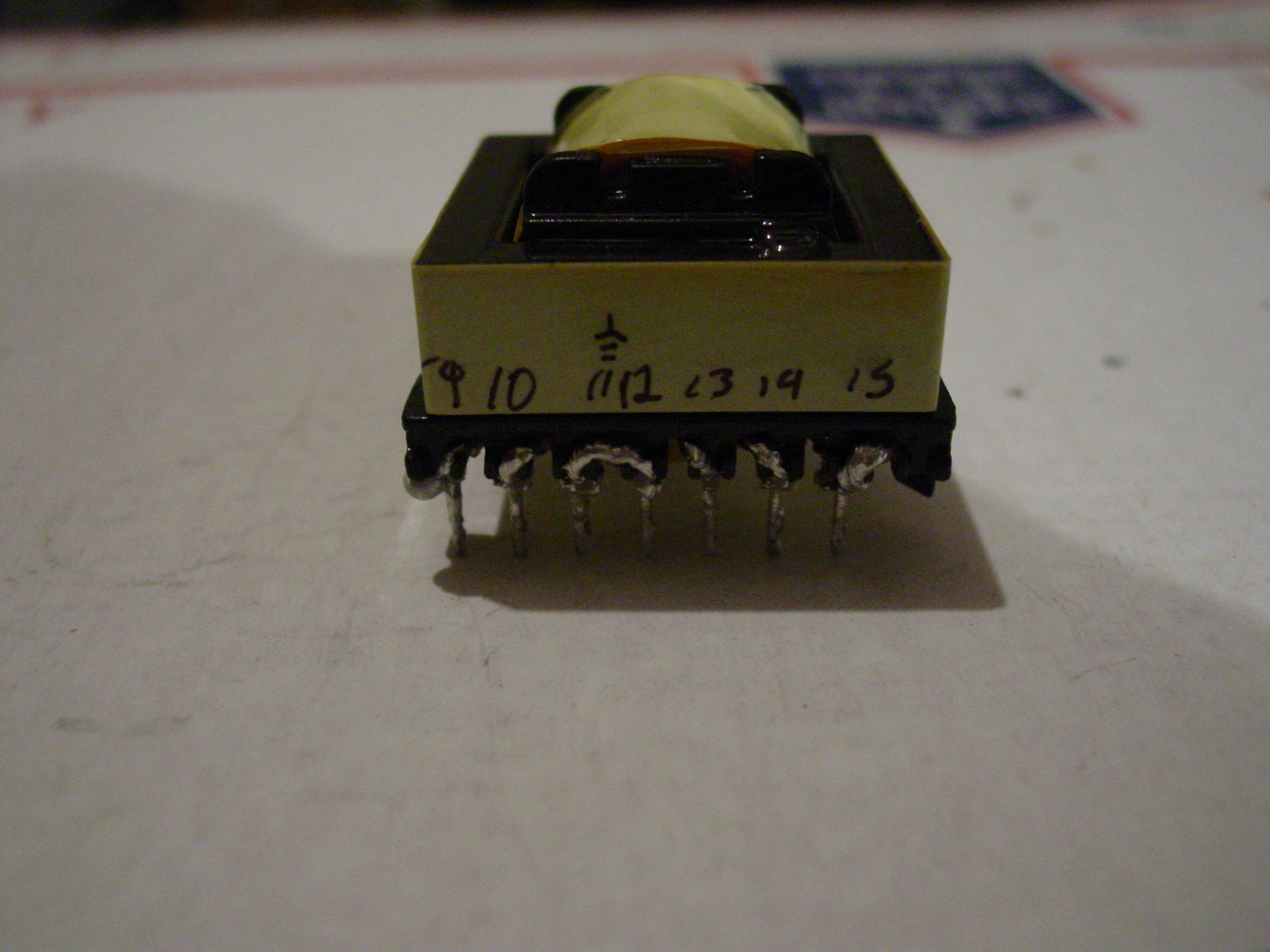

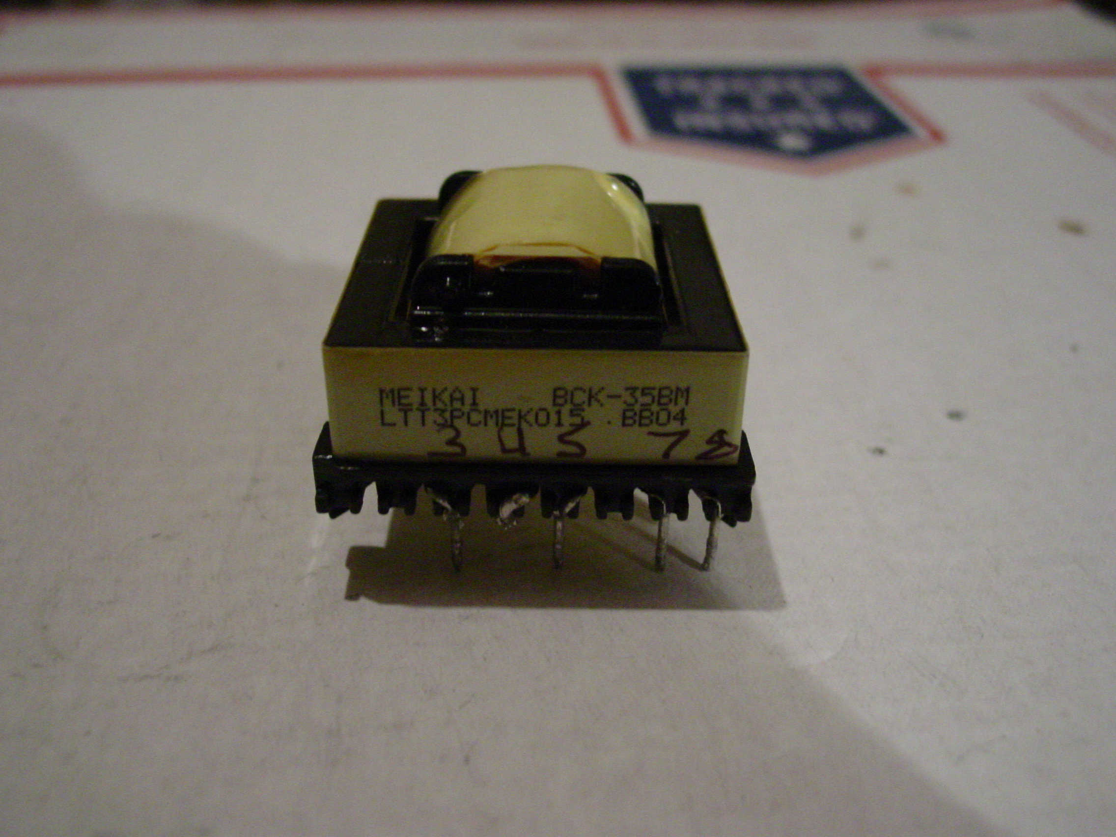

    Working on the PSU for this tv. Has no proper volts anywhere.
    When plugged in to AC on the bench, the primary transformer would instantly start sqealing. No blown fuse at f601. Highest volts readable was 9.9v on the 24v line. 4.2v on STBY.
    Pulled transformer out and checked output side and all pins ( 9,10, 13, 14, 15)read .000 on any ohms setting to the ground pins ( 11, 12).
    Cannot find any info on the transformer Meikai BCK-35BM LTT3PCMEK015. Service manual for tv lists it as a Trans Power 11714
    P/N LTT3PC0KT069. Searched all combinations of those numbers no luck.
    Sears has in parts list for tv, but is no longer made or available. Anyone know anything about it? Thanks.

        Already de soldered and checked. Only thing that did not give a good reading was the R608 resistor. Supposed to be 0.18 ohms, mine reads .003. NOT blowing F601 fuse like I have read about in the other posts when plugged in to AC.
        Now back to the original question about how to test the transformer as I have de soldered it and all DC output pins read shorted to the ground pins, .001 on my meter. Plus when I took it out the short I had on 24v rail went away.
        The DC pins give an open reading to the AC which is correct
        Meter readings good when testing from power connection CN632 backwards to transformer DC solder points.
        Here is a couple of pics of the transformer, have not been able to find any info on it.
          Re: Transformer on Emerson LC320EM2 PSU
          DC resistance of the power transformer will show <1 Ohm, you need a RINGER and Inductance meter for testing inductor/transformer.
          The transformer is driven by very high frequency, not by DC, so the impedance will be high.
          You can check the transformer to see if it has open winding or not only, not impedance, inductance.
            I guess the resistor is part of the problem. Resoldered transformer back in without the resistor in circuit and no more squealing.
            Will have to wait on replacement as Digikey was out of them. Thanks.
