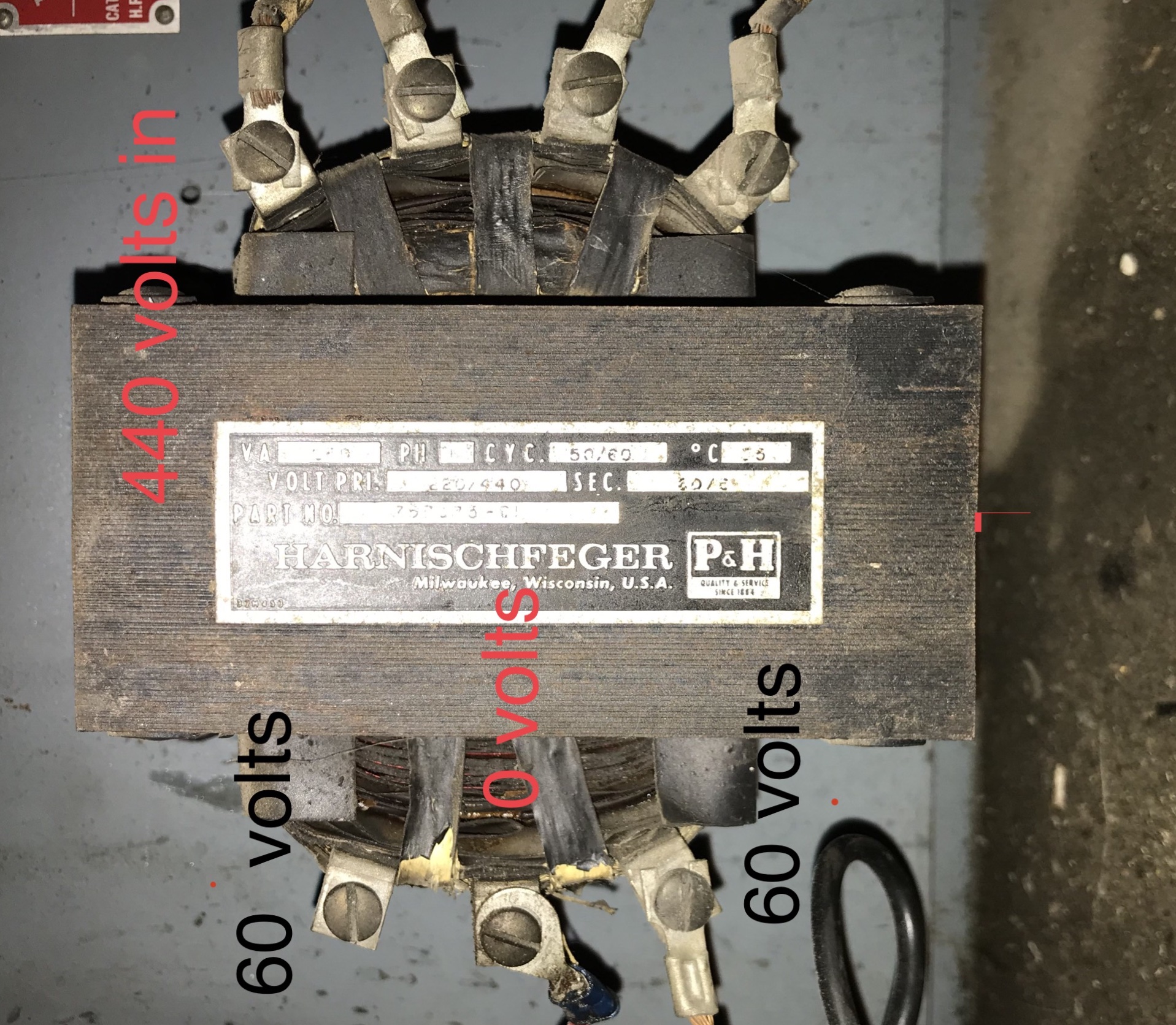

I am looking for a transformer secondary of 60 volts @ 30 amp
    • Jul 2011
    • 6070
    The primary voltage is 480 single phase the second voltage needed is 60 volts
    Now it could be 30 volts 0 volts 30 volts preferred
    Or it could be 60 volts 0 volts 60 volts and just use one side of
    Output amp need to be at least 30
    Dose anyone know where I can find one
    This is what is the device I am working on
    The problem with this one is that it is over heating and smelling like it is over heating
    When it has a load on it

    Re: I am looking for a transformer secondary of 60 volts @ 30 amp
    Are you sure about your specs? 60VAC 30A output is 1,800VA and about a 45lb beast. That small transformer is probably overloaded and why it is stinking.
    1,500VA control transformers are common but standard secondary voltage (like Hammond HPS Imperator) is 24V or 90V.
    I thought you could undervolt a 600V (550/575V) transformer at 480V to get your voltage, but nothing around 48V or so.
    You show 60-0-60 but want 30V so I'm confused. What is this thing powering.
        Only half of the winding is being used so it is 60 volts
        The device it is hook to it was drawing 23 amps DC
        So if you have a transformer secondary that has 30 volts 0 volts 30 volts then you would have 60 volts
            Maybe but here is a concern it powering a brake coil
            Here is the other concern how many amp is going to be on the 120 volts side
            Where do I find a 60 volt switching power supply
                Is the brake (current) the same as always? I have seen brake solenoids fail with shorted turns, which causes current to go way high. 1.4kW is a huge brake!
                At 23A and 60V whatever is switching that is under a lot of stress.
                There are 60VDC 20A SMPS https://www.aliexpress.com/item/4000402859916.html
                It might be better to use more than PSU in parallel for safety, if the brake operation is critical. SMPS won't last as long as iron.
