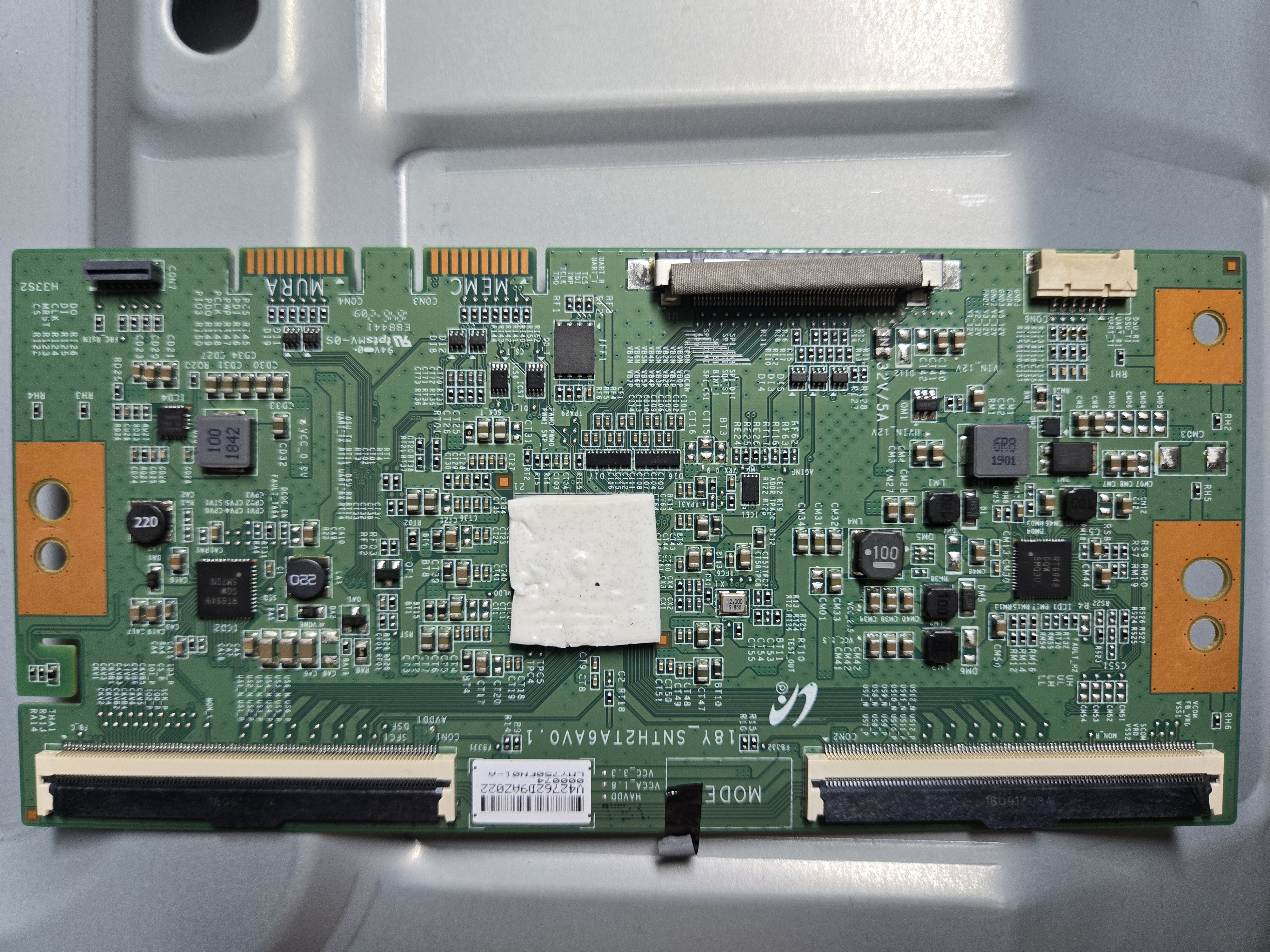

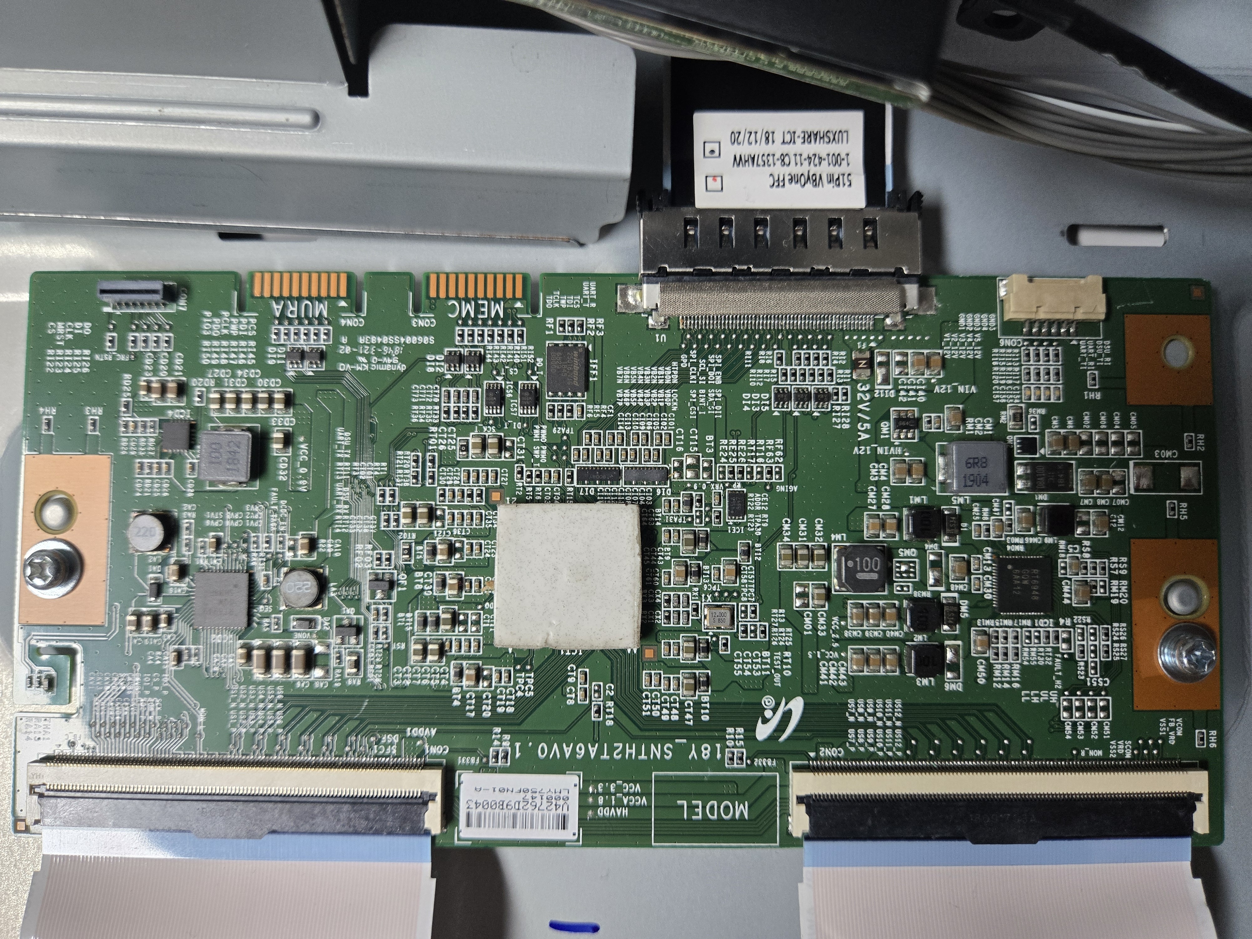

                                #135
                                Can you show a detailed picture of both tcons?
                                • NolesFan
                                  trying to learn
                                  • Jul 2024
                                  • 94
                                  #136
                                  Let me know if not good enough.
ID:	3462749 Click image for larger version
                                  • nomoresonys
                                    • Jan 2013
                                    • 12330
                                    • U.S.
                                    #137
                                    Ok, so with new tcon, try same test as post #126, remember vone IS vgh, see what it is with both ribbons connected, if it isn't optimal check again with one cable at a time connected.
