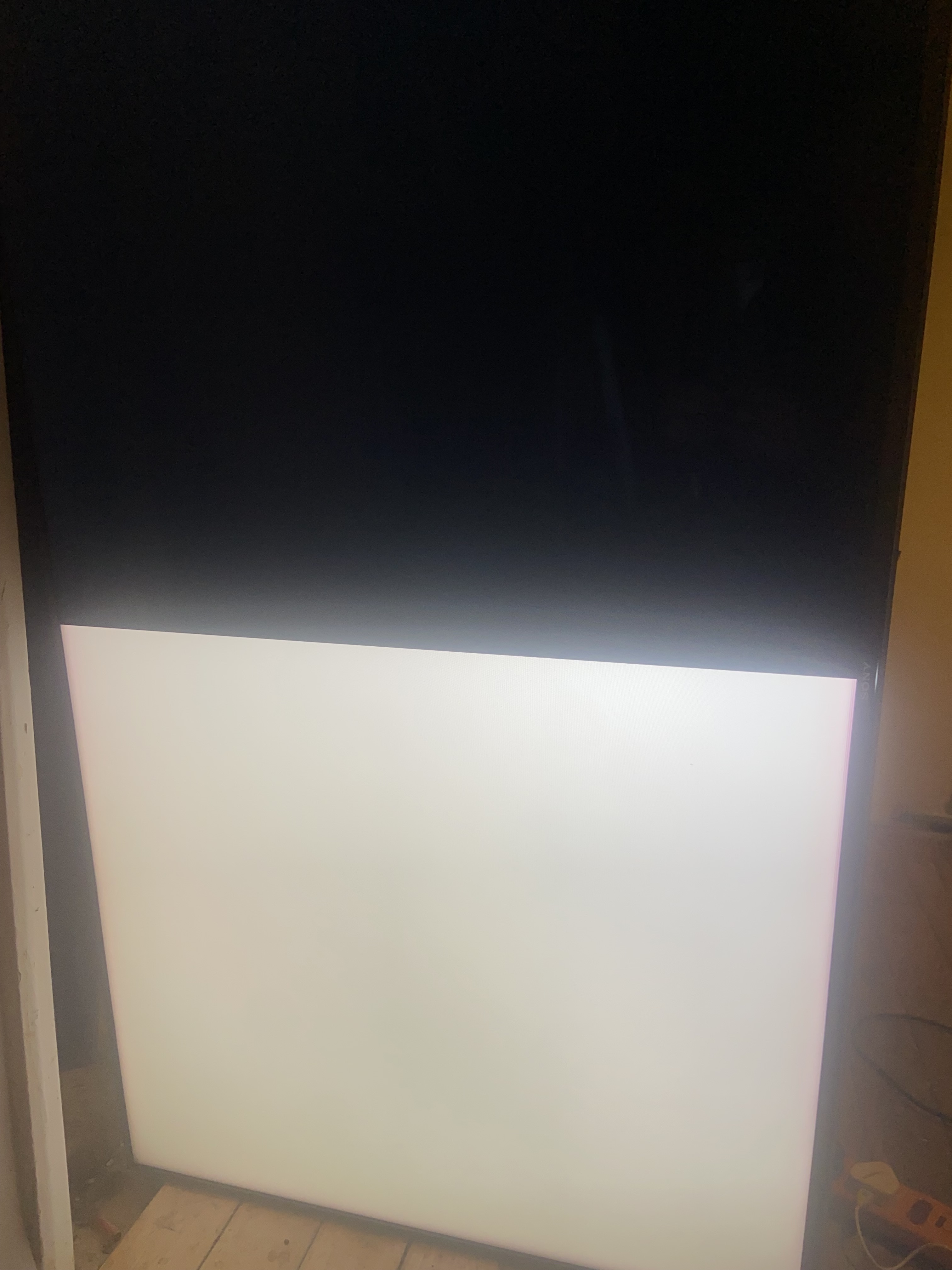

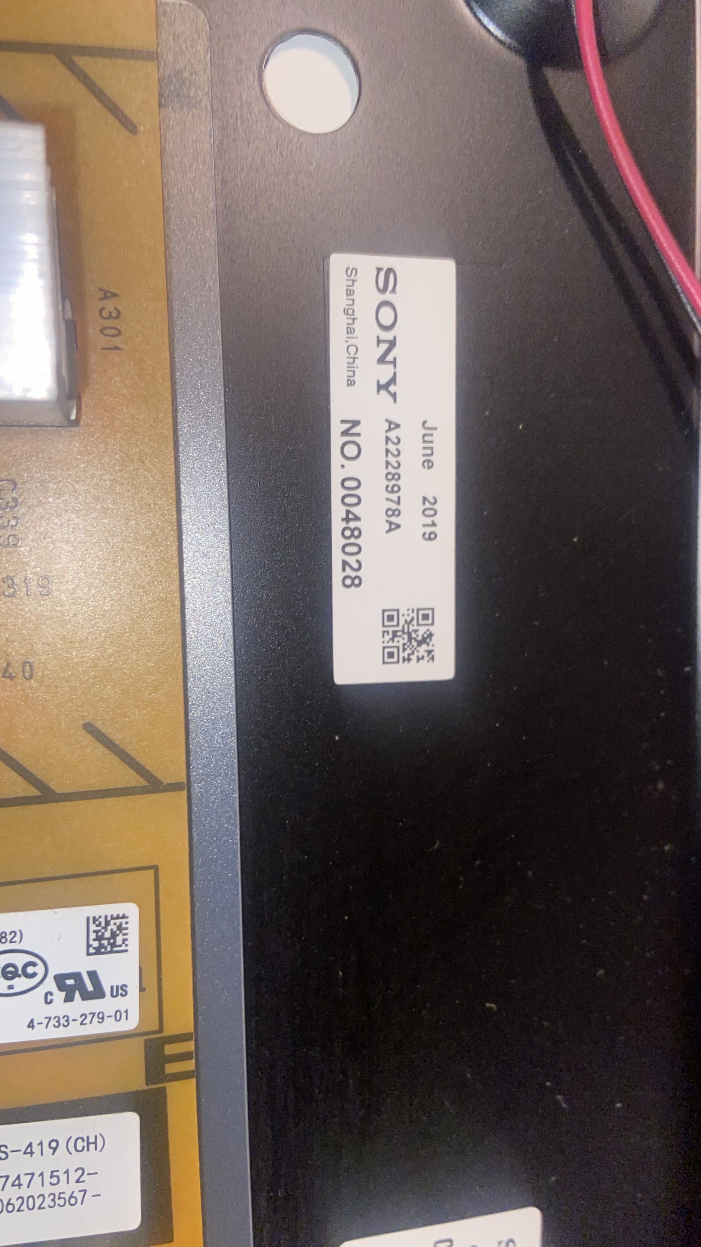

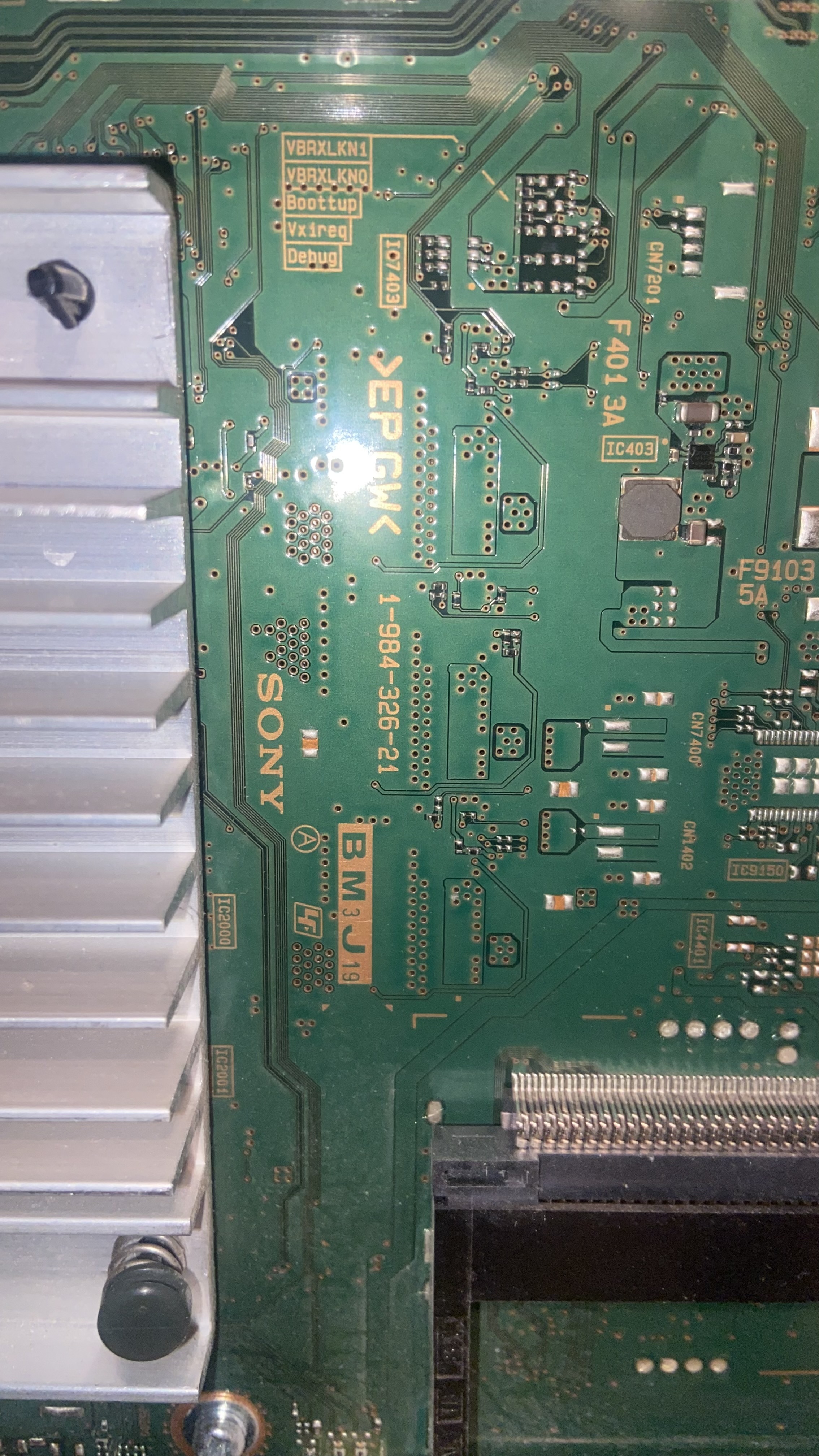

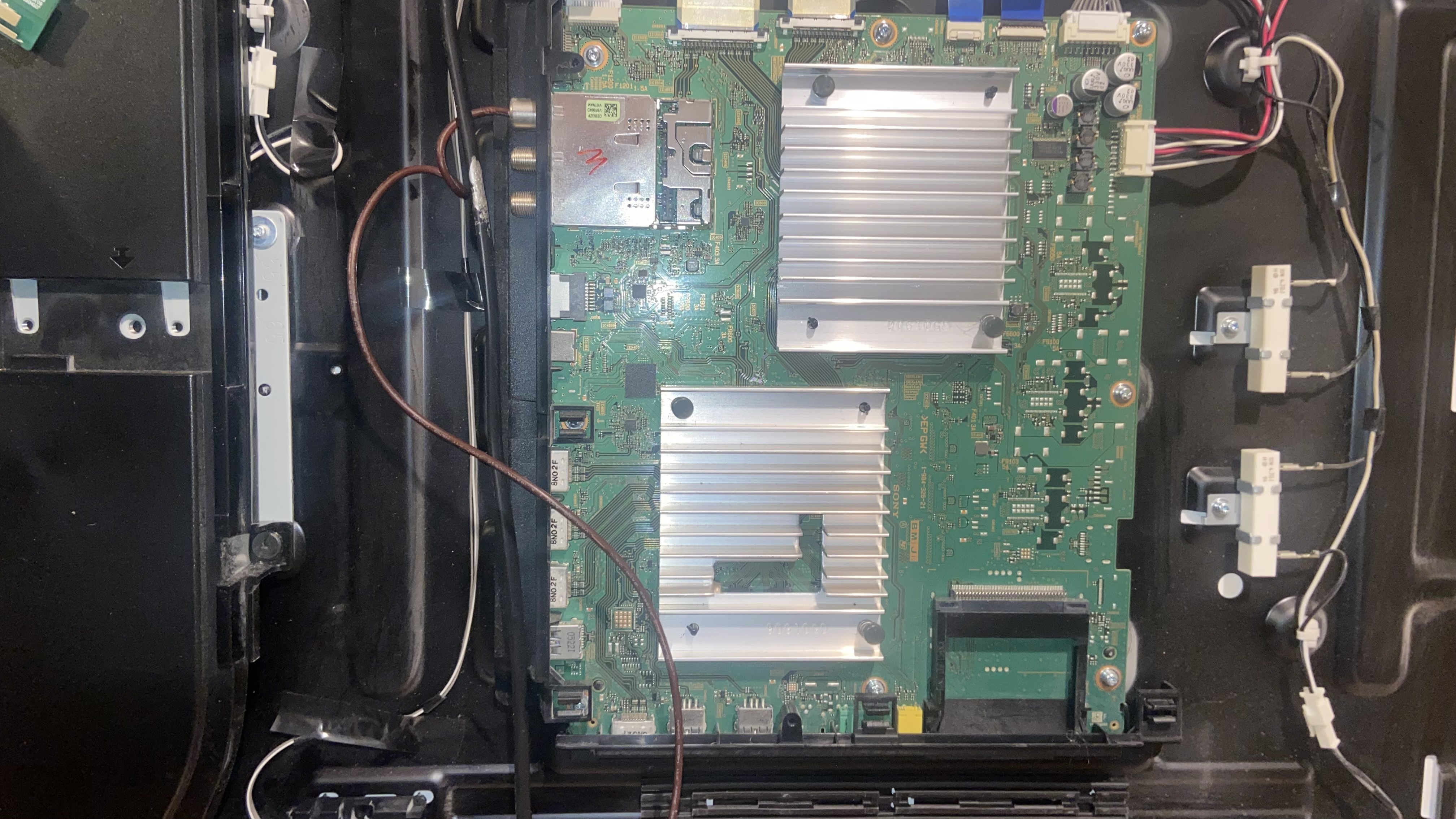

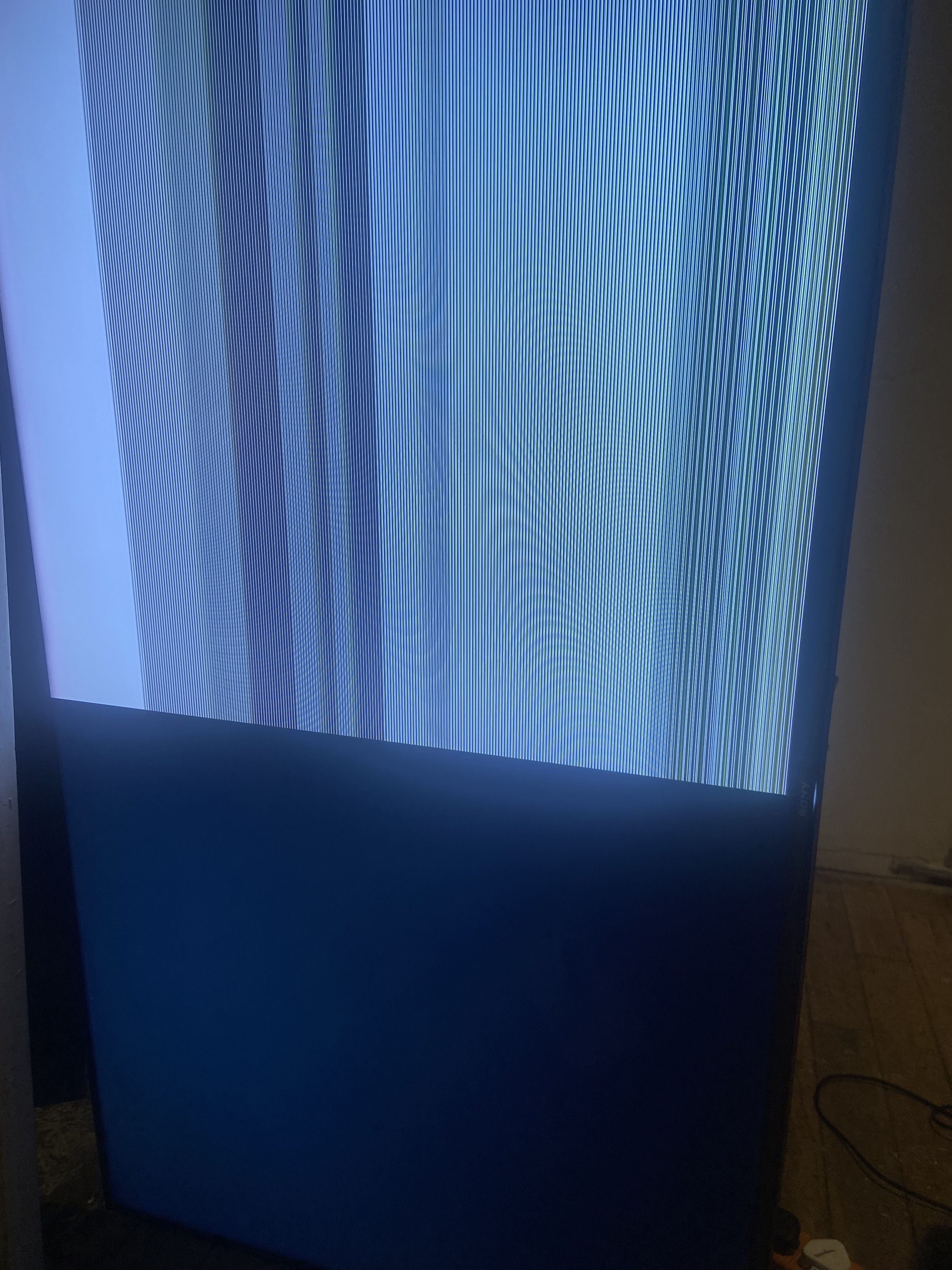

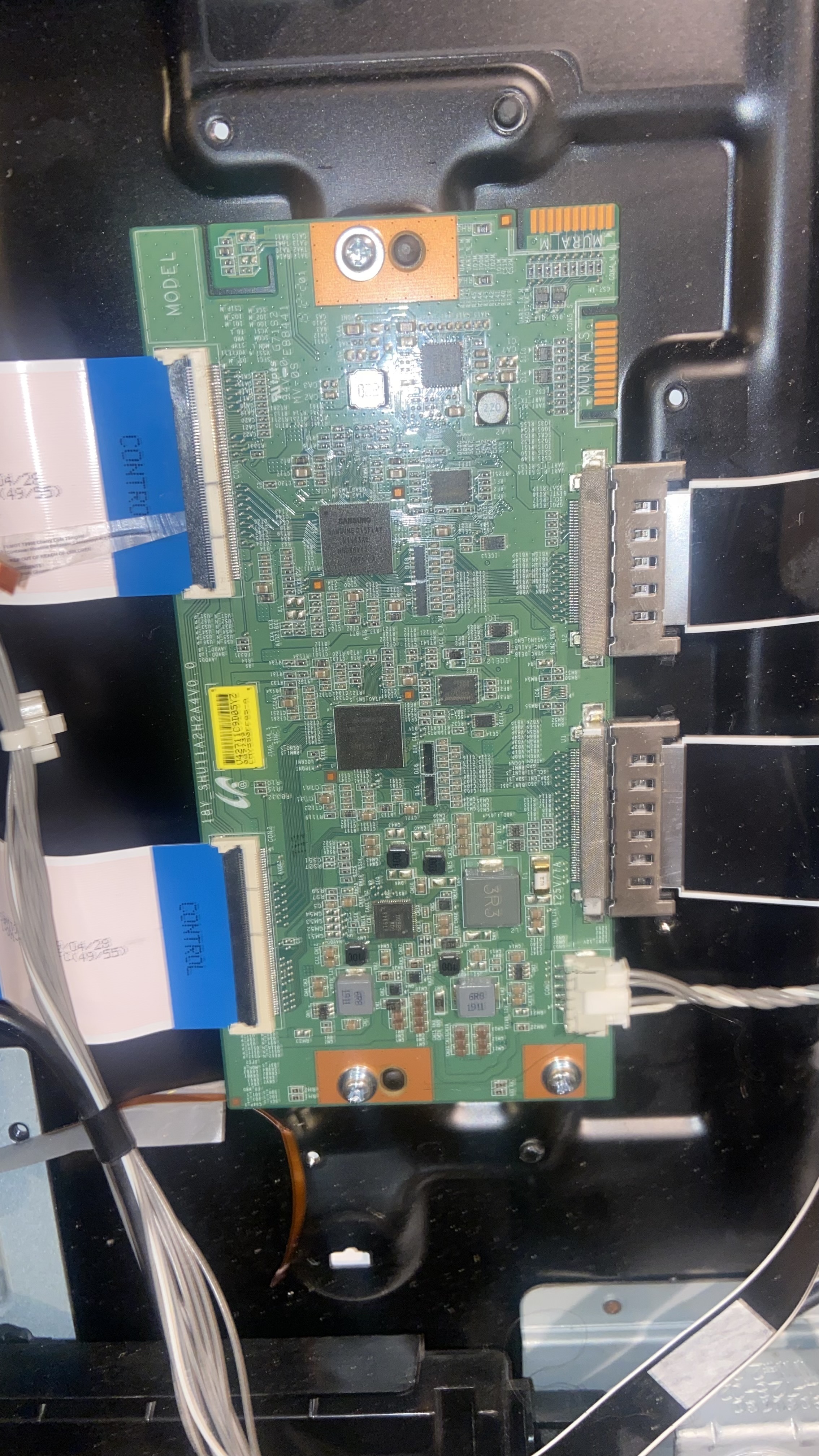

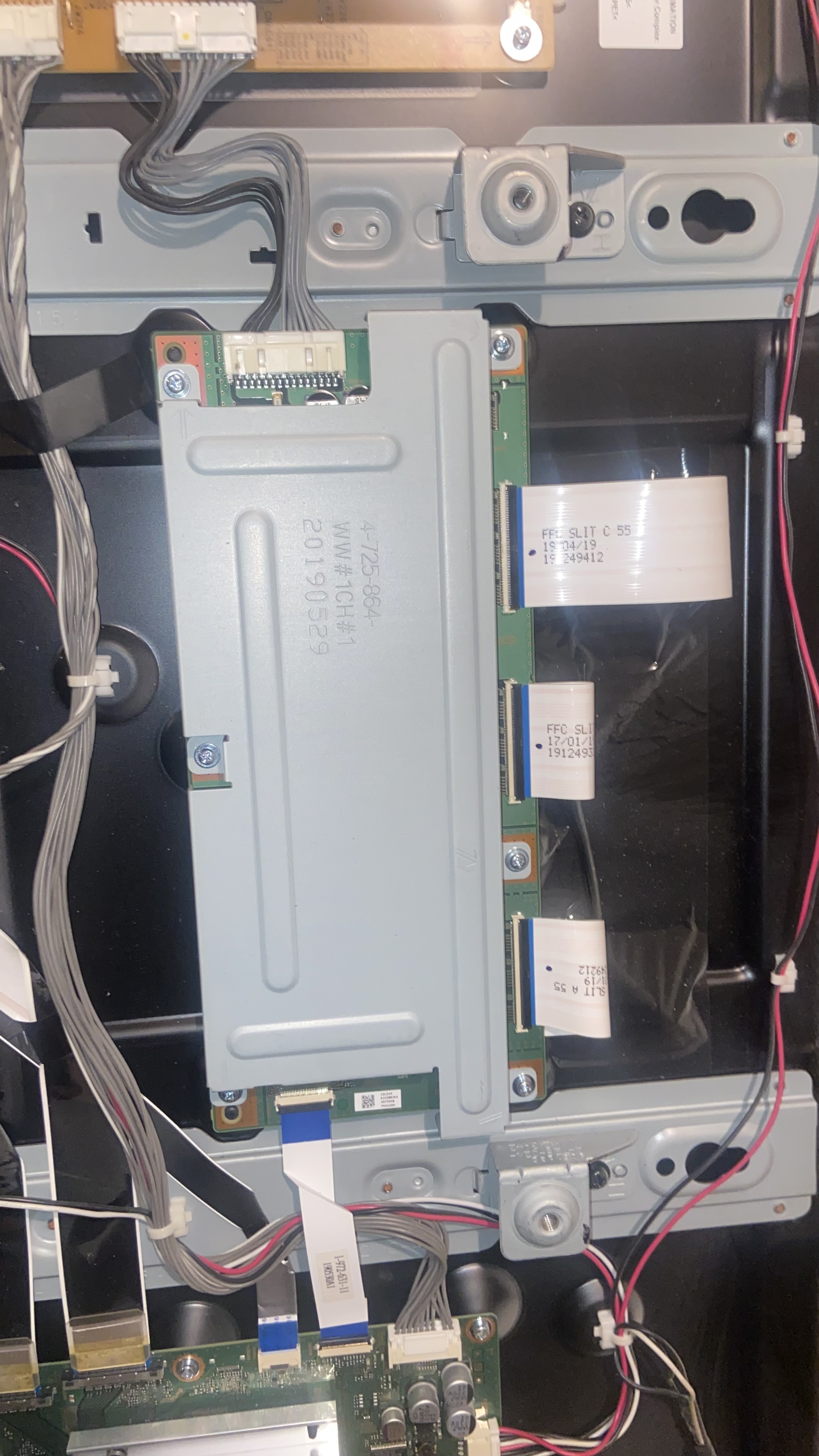

    Hello again everyone,
    This is my latest mission, to try getting this Sony tv back to normal working order…
    I've only just got it today, when you power it up everything is as should be, in fact it works perfectly for a few minutes then the screen starts getting horizontal lines on & eventually the full screen goes back, I will upload photos of the problem & also some photos of the board etc. You might notice that I'm busy trying the tape method, I'm not sure exactly where the clock lines are so I'm just guessing & hoping for the best lol . I've already tried removing the LVDS leads & cleaning the contacts with a pencil rubber but the problem still remains

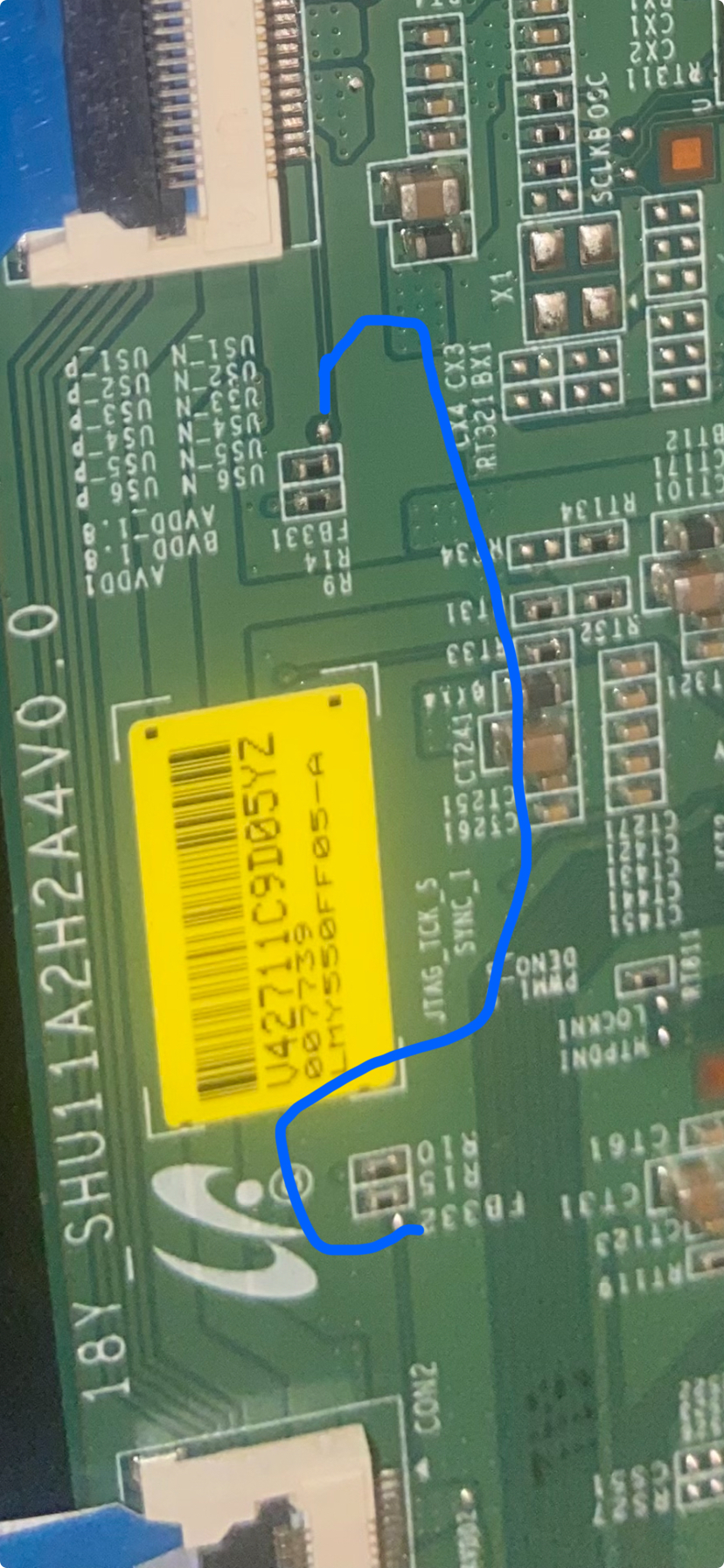

      To determine which side creates this defect, you need to install a jumper on the t-con between points FB331 - FB332. then disconnect one cable from the t-con to the panel and check this defect with the panel, then check with the other half by disconnecting the other cable....
      • lotas
        • Jan 2016
        • 4840
        • Russia
        CKVs are in this area.

          So what do I need to do ? Solder a wire between FB331 & FB332 , then remove 1 side of the tcon at a time then on the broken side do the tape method?
          sorry to probably repeat everything you’ve said but I’m just getting it correct in my own head if that makes sense haha Click image for larger version
          • lotas
            • Jan 2016
            • 4840
            • Russia
            Yes, we understood everything correctly.

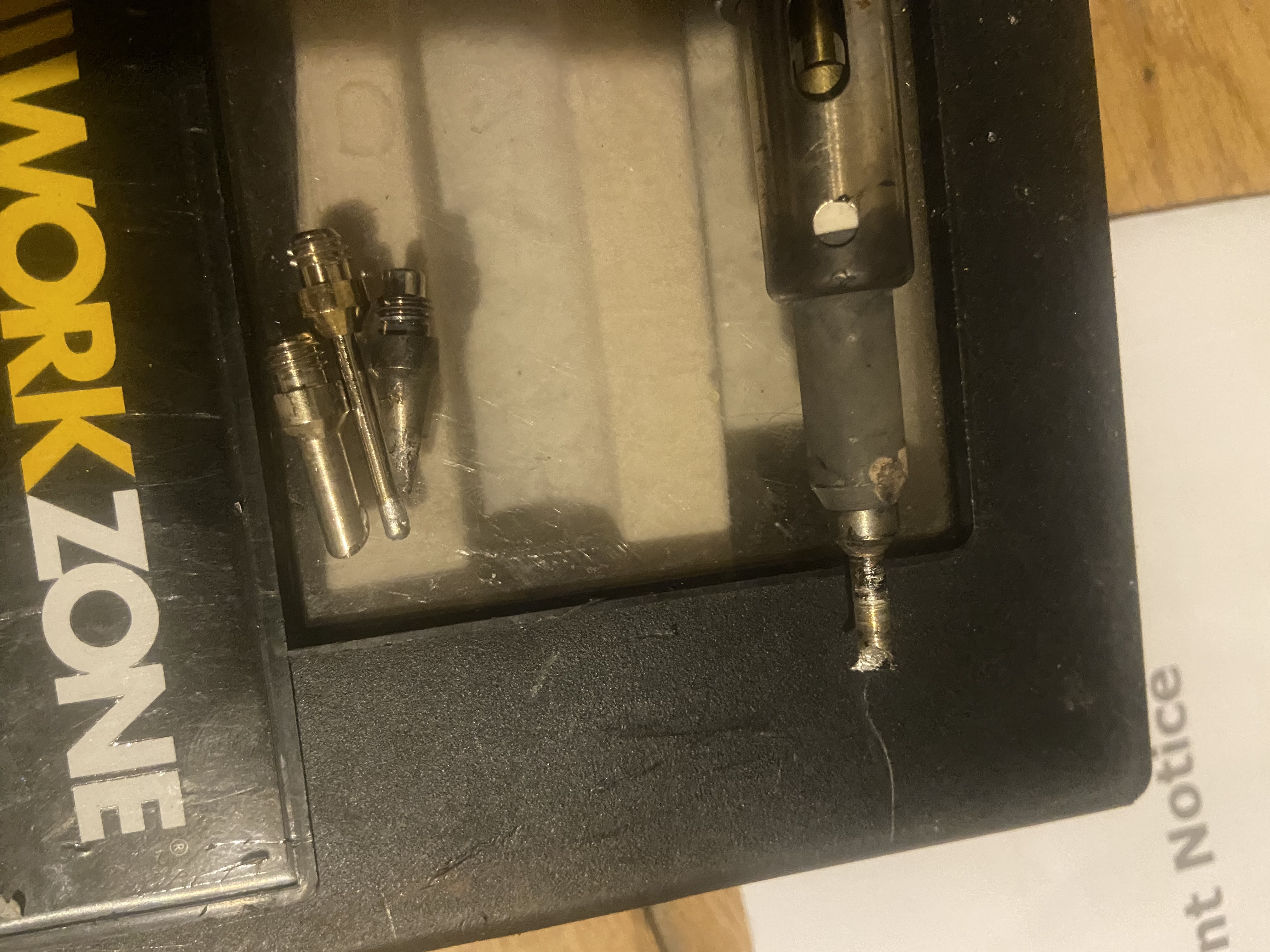

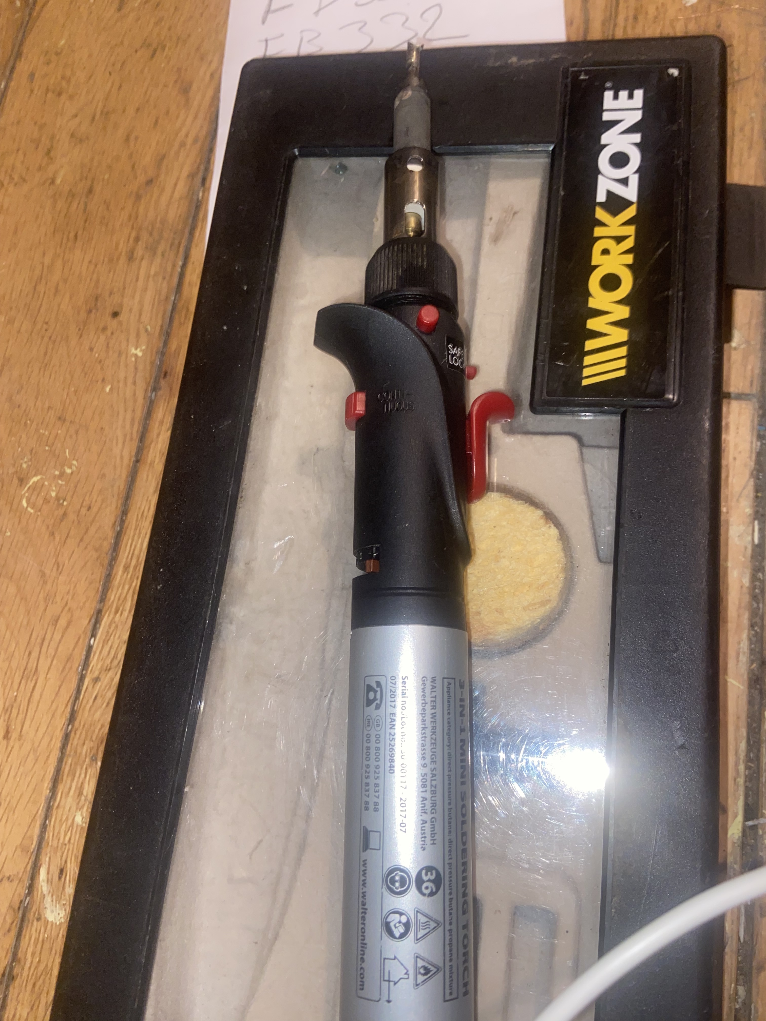

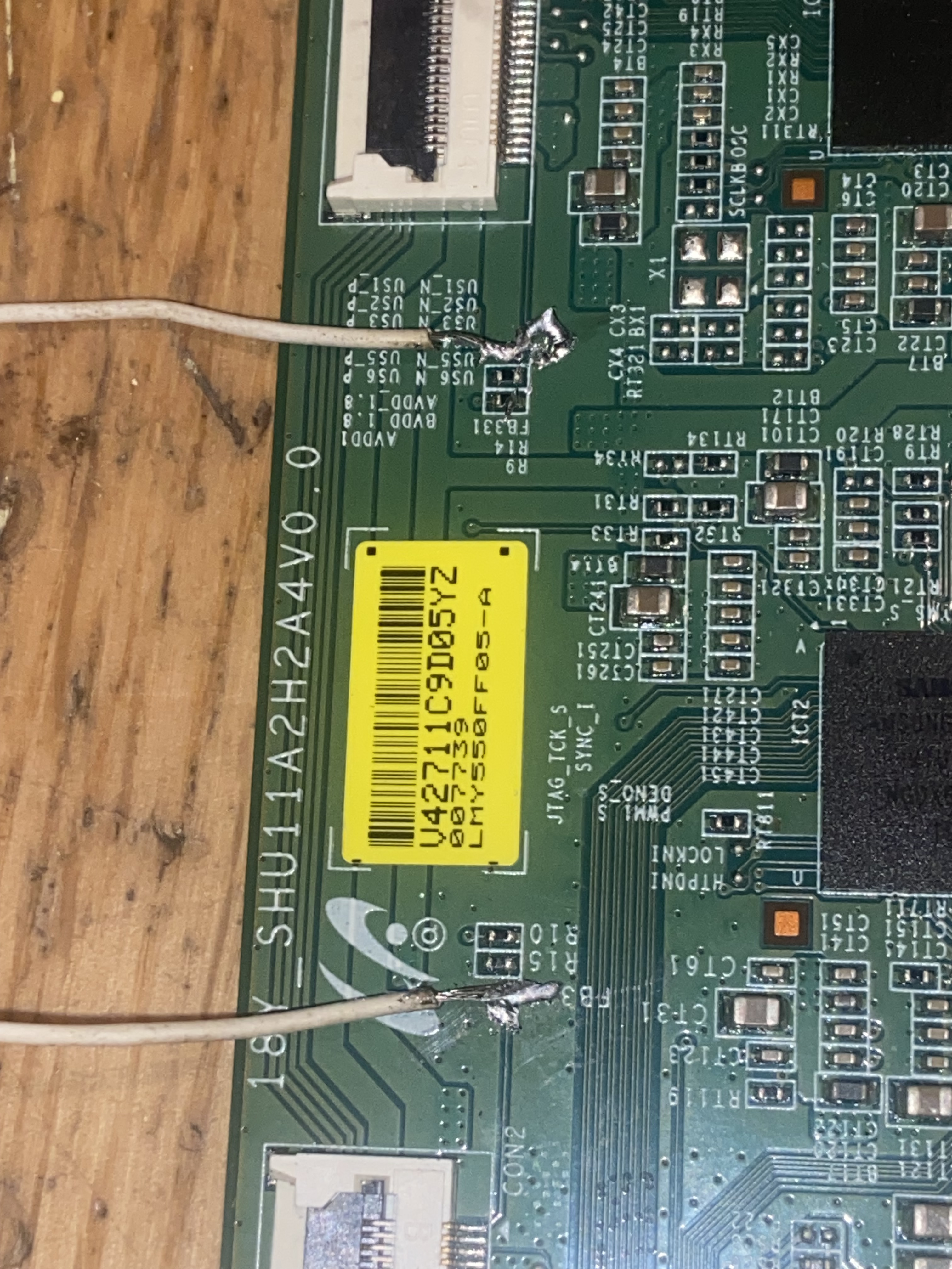

              I know it’s absolutely hideous soldering, but I only have an old butane soldering iron at hand at the moment, I should of waited until tomorrow to use my proper tools but I’m really impatient.. You Click image for larger version

ID:	3576259 know what they say , a bad tradesman always blames their tools 🤣🤣

                  Here’s the results, is it the same side of the tcon board as the lined side off the screen that I need to tape ? Click image for larger version

                    Oh , also, do I need to remove the jumper before trying the tape fix ?
                    • lotas
                      • Jan 2016
                      • 4840
                      • Russia
                      You don't have to remove the jumper.
                      It’s better not to use such a soldering iron (torch), you’ll kill your t-con!
