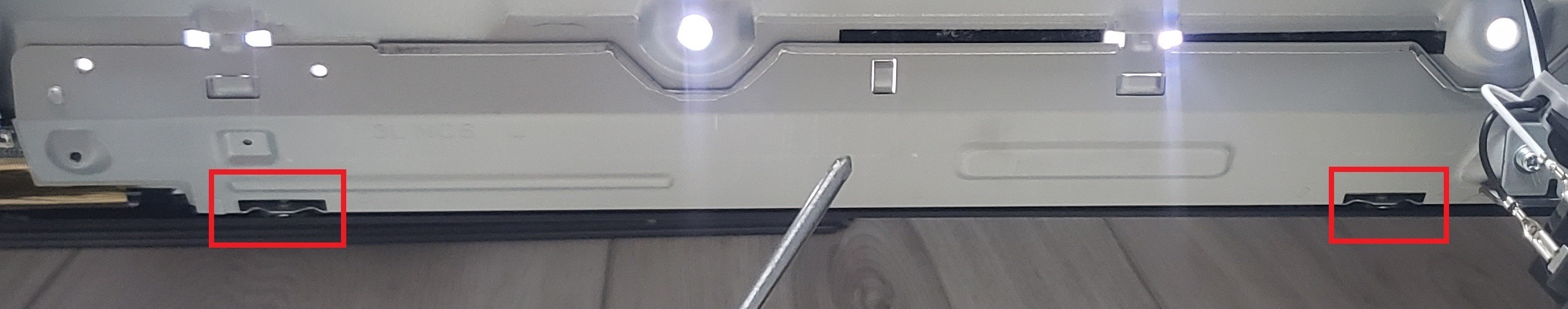

                  #108
                  So I removed the speaker and there is nothing behind it. Its just 2 wires coming off it.
                  What is the panel buffer boards?
                  Im sorry, Im getting lost at what yu want me to do

                    under the speaker you will have plate on each side you need to remove them then you will have access to the panel buffer boards which the 2 ribbon cable from T-con connected to them... take look at the middle you will find U ribbon cable connect 2 pieces together on each side

                        Diah, you are referring to that panel in the first photo and not to the gold ribbons in the second, correct?
                        • Diah
                          • Feb 2013
                          • 6435
                          #112
                          yes under the metal plate there are the panel buffer boards

                            Secret to removing them? I took out the screws for the stands and I removed the 3 screws that were holding it down, but there is no play in the plate.

                                      all screw of the plate need to take out...
