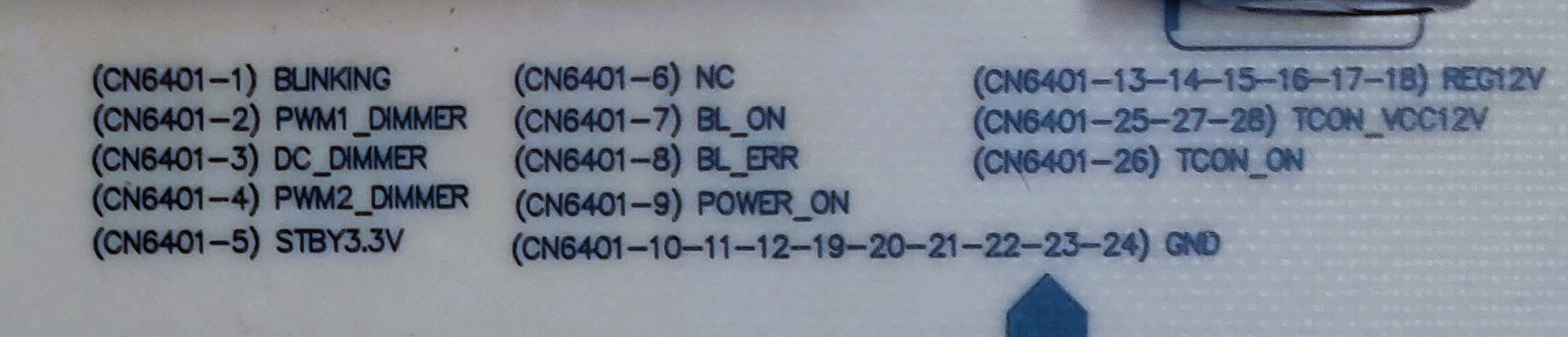

                      My pin location chart: Click image for larger version

                        connect pins 5 - 7 -9 -26 all together
                        connect one of pins 25-27-28 to T-CON fuse
                        the melody you have first setup screen... . before you do the standalone test do as i wrote at post #14 Note 2
                        measurement wall socket should be in AC not DC

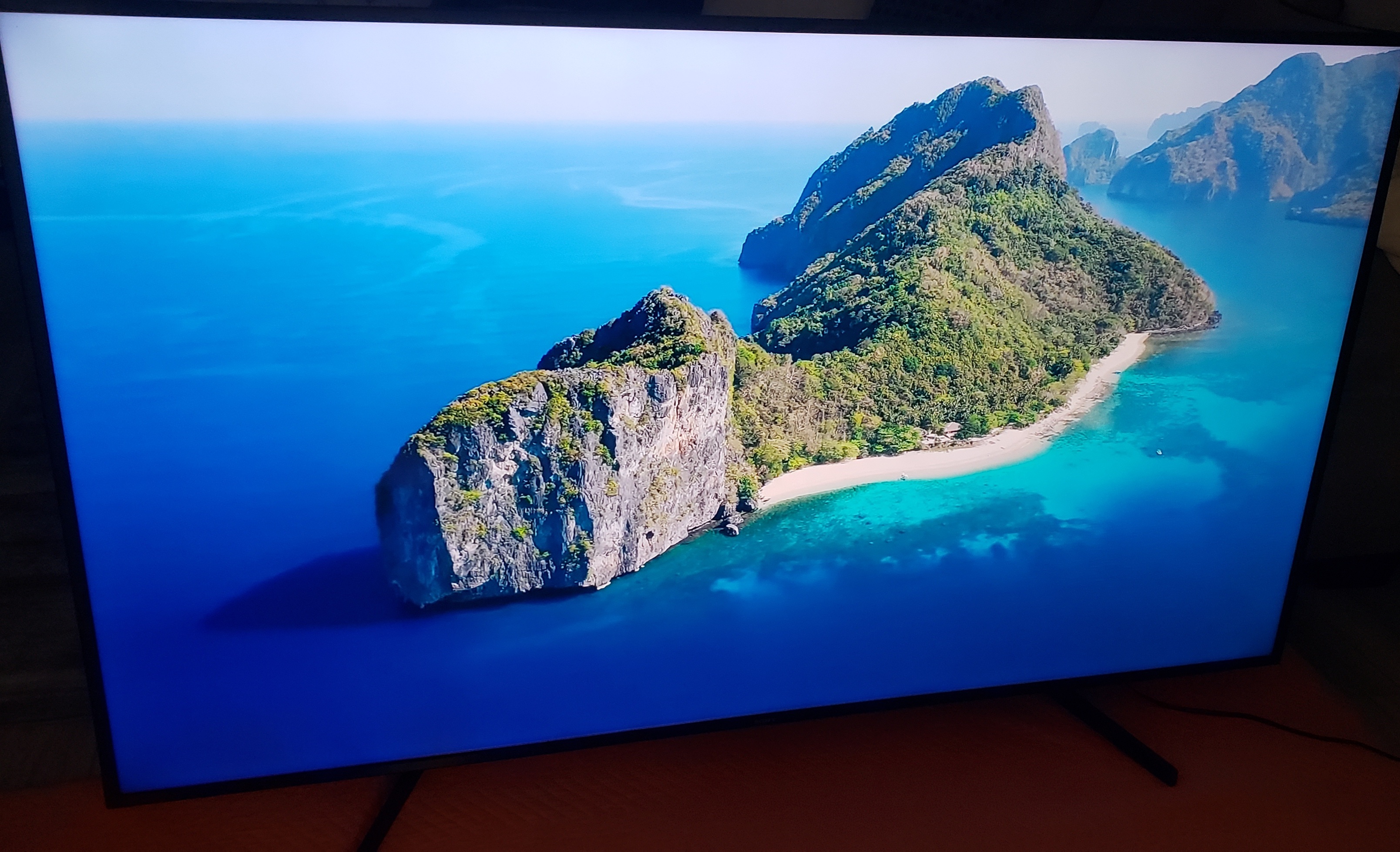

                            Well not sure how to explain it, but its working. I started checking over the PB to MB harness, because I wasnt getting any reading on the STB or the ON voltage. So I unclipped the harness to make sure I was getting my probe in there to touch metal to get a reading and when I plugged the clip back in, I noticed the lights were changing, so I checked the screen and sure enough the TV started up, and was like it was just purchased, asked me to register and choose language and blah blah blah. Just want to thank the guys who put in effort to respond to me, it is much appreciated.

                              Glad to hear it, must have been a bad connection, sometimes it just takes cleaning or unpulg and replug a few times to get it working, curious if the voltage at powercord was still less than 120.
