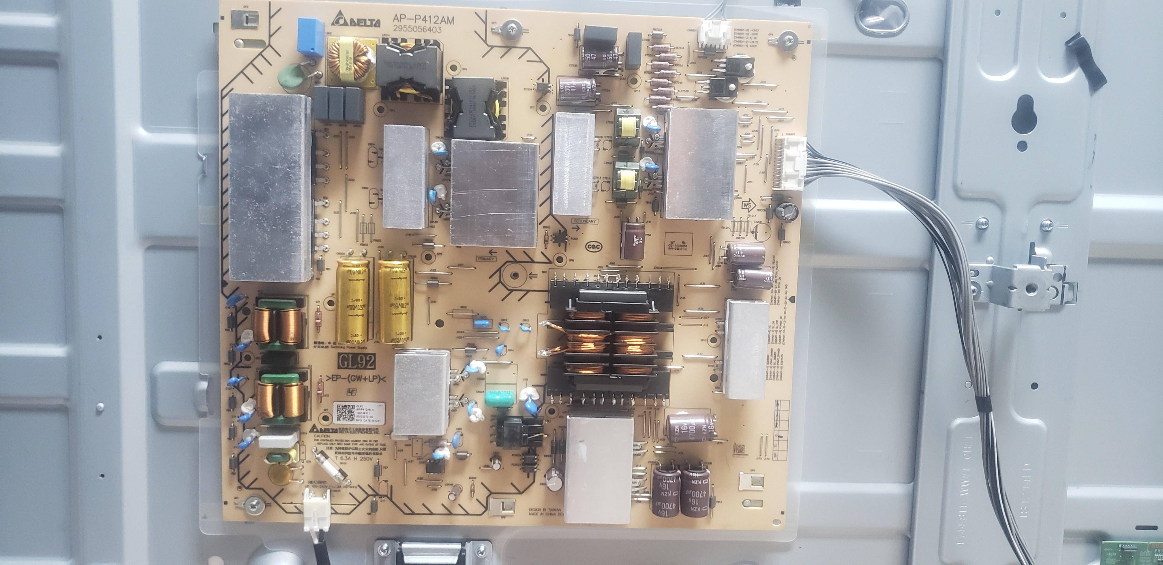

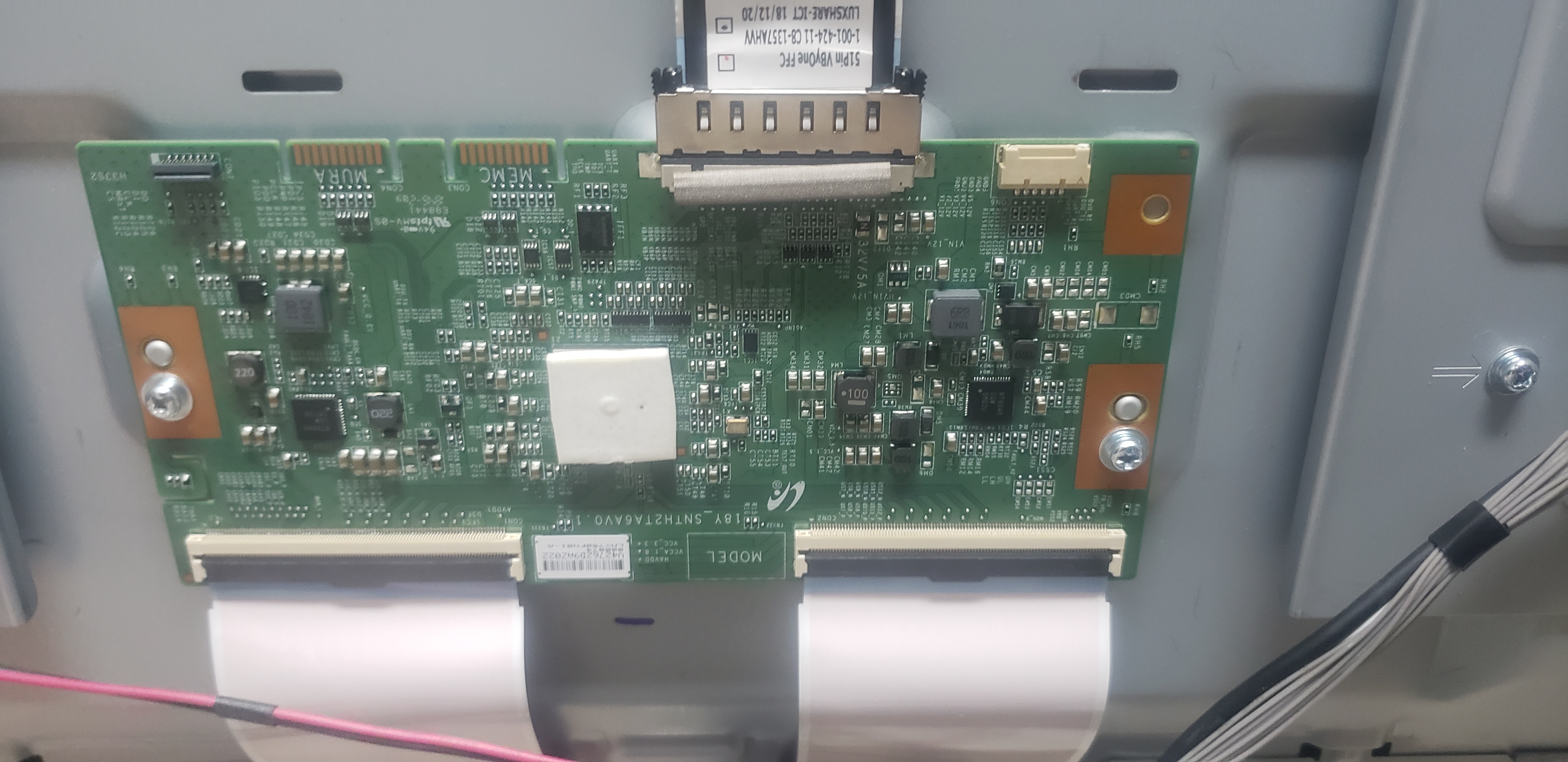

                #67
                Yes it is absolutely the right way but just for curiosity can we se some pictures of your tv and all the boars thanks in advance for some feedback after Nick

                      Davi, Im not changing boards, Im having the current one repaired ( if they find anything wrong ).
                      bohaboha here are the photos you asked for.

                                      So do DIAH'S screen test, that will tell the tale. I don't assume anything, I will say that imo sonys have MUCH less screen issues than most other brands.
                                      Diah's post #14 - "take 12V from the pin 25 T-CON VCC and put it on the F fuse on the T-con
                                      put it in wall and check what you will have on the screen.."
                                      I tried this back before I sent it in Nicks. This is right about the time someone was impatient with a novice so I said fuck it and sent it in.
                                      Post New Members - please post your introductions here - The other way that it was not responsive was Diah's was in post #14, when plugged in, I could do anything and no self test as you say. (though it should read couldnt do anything). Meaning the screen never even turned on. Ill try it again when I receive the MB back from Nicks.
                                      Since they found nothing wrong with the MB, it was only $30 dollars to test it plus shipping. I probably couldve found someone local, but since they have quite the following on Youtube and many videos to support what they do, I chose that route.
                                      So once I get the MB back in and I run Diahs test in #14, if I get nothing on the screen, does that tell the panel has failed or the Tcon? Or neither really?

                                          #80
                                          take out the 2 ribbon cable between T-CON and Panel. upload photos of the ends of each cable pins with high resolution... you may have cut / short at pins contact
