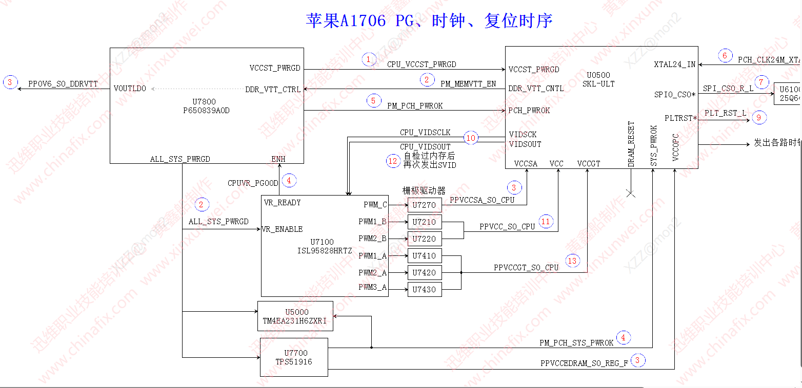

                      So, I had some time to check a lot of signals and I have still not give up trying to find the problem here, although I'm getting less hopeful as I dig through.

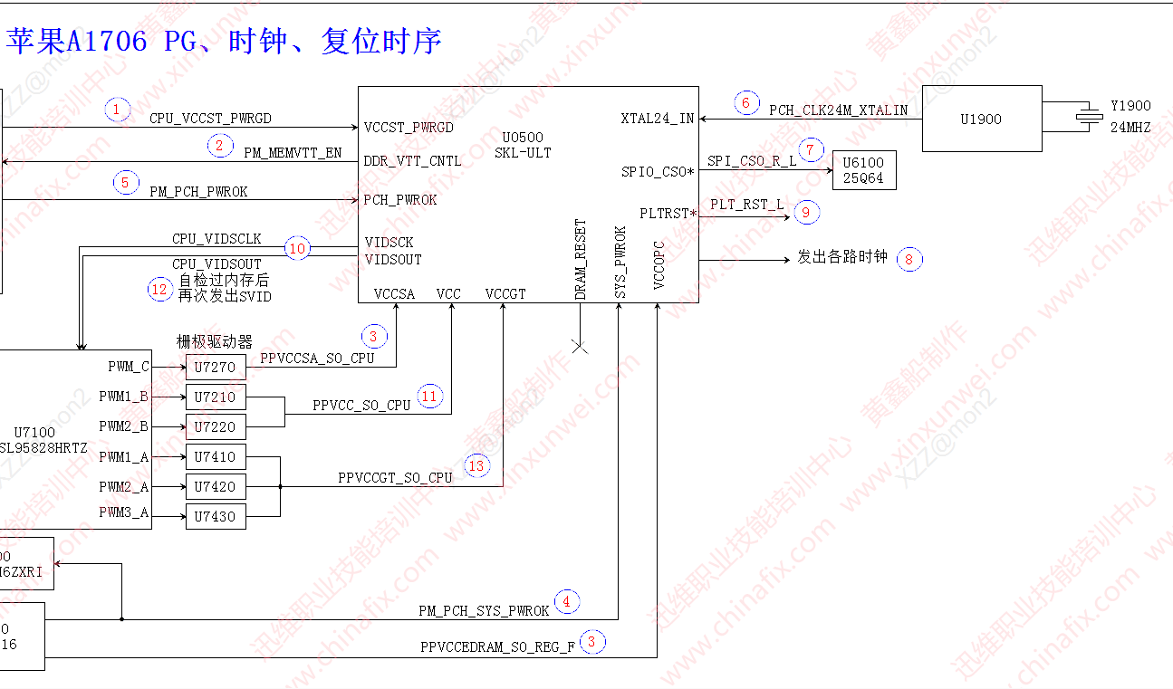

                      The only exception appears to be PPVCCEDRAM_S0_CPU, which is 0 and, for what I understood, should be 1.05V. This signal is produced by U7760, so I proceeded to check its voltage signals:
                      PP5V_S0 5.12
                      PM_OPC_ZVM_L 0
                      SWEOPIO_CNFG 0.1
                      PPVCCEDRAM_S0_REG_F 1.04
                      SWEOPIO_G 0
                      PPVCCEDRAM_S0_CPU 0
                      I couldn't find the datasheet for this chip (SLG5AP031), but I did find one for SLG55031. 55031 says EN is activated with a HIGH signal. But because PM_OPC_ZVM_L (which connects to EN pin) is named ending with "_L", I'm assuming SLG5AP031 should be enabled by LOW signal. If yes, then the chip should have worked fine and PPVCCEDRAM_S0_CPU should have followed PPVCCEDRAM_S0_REG_F voltage. If my reasoning is correct, then either U7760 and/or Q7760 and/or Q7761 are not working correctly...
                      If this is the case, is there an easy way to check which is failing?
                      Do anyone has any tip about what else should I check?
                      If the CPU is bad, is there an easy way to test it?
                      I'm thinking about buying a working macbook equivalent to this one to cross check all signals in the hopes I can discover what is wrong. Not sure it is worth investing so much money and time on this, though.
                      Thanks for any inputs on this!

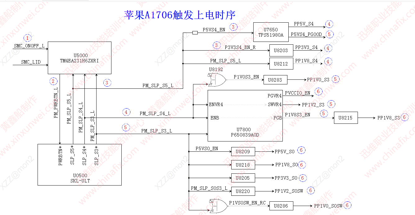

                        See if the attached helps.

                          Thanks for the tip, the first stage (that generates the main power rails) is working nice. I'll check later for some of the intermediate signals at next stages. I already know PPVCCSA_S0_CPU and PPVCC_S0_CPU both look ok, and that PPVCCGT_S0_CPU is always 0, but I read somewhere that this last signal will only activate when there is demand for graphics.
                          I'm still suspecting my eDRAM is not being powered up. Is there any other diagram like those you've sent me that shows PPVCCEDRAM_S0_CPU​ being generated?
