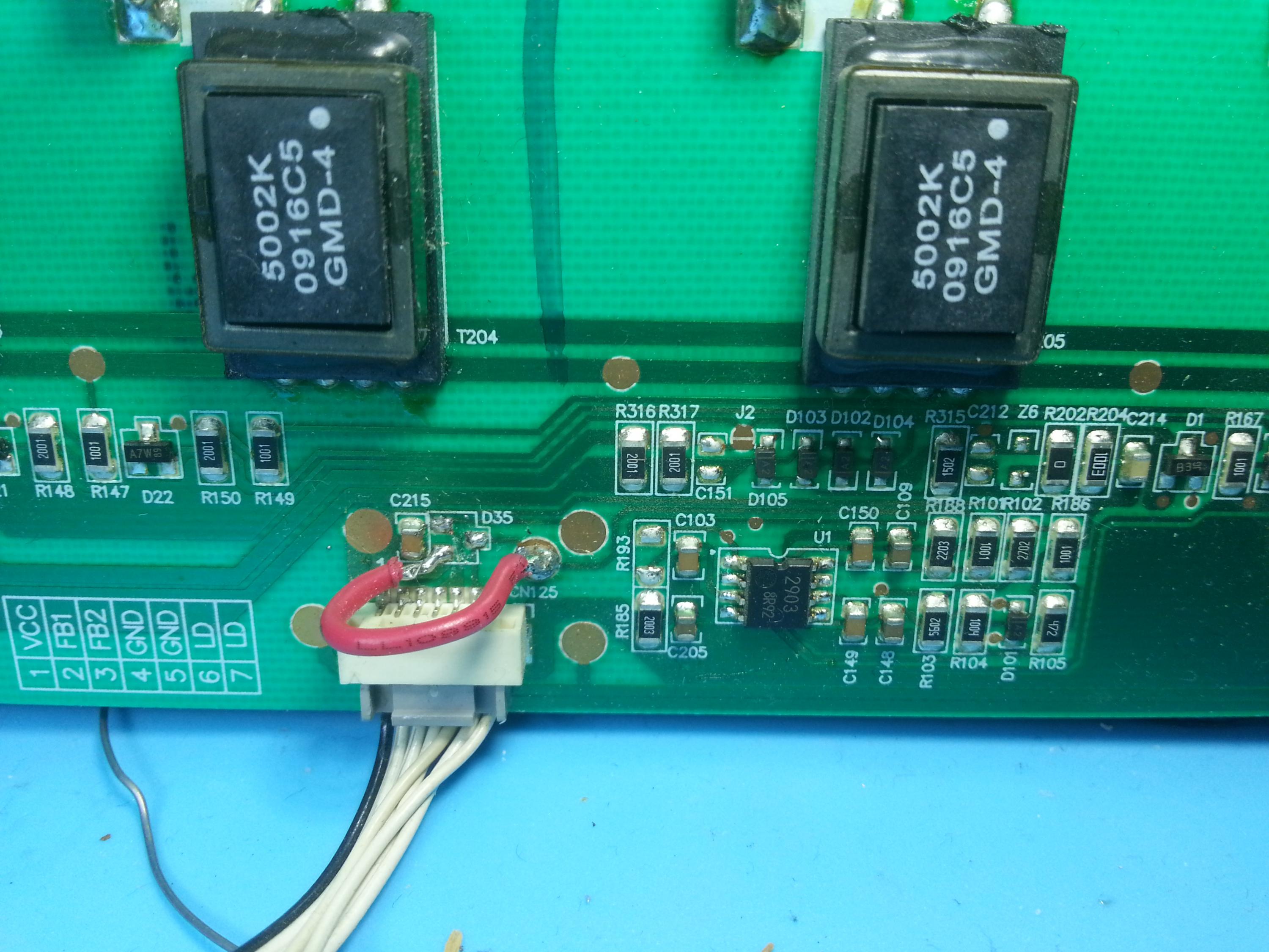

                                I've got one of these in. I'm wondering if someone can explain what LD denotes please.
                                Someone has removed a diode and soldered in a bodge wire between the 12v and LD on the inverter. TV powers on but no backlight.

                                  Re: Samsung le46b530p7w
                                  Looking at the following schematic it looks as though LD is an output signal from the inverter board
                                      LD = Lamp Detect, if Lamps are all good and stay on after the firing Voltage is applied to the Lamps, the LD should be around 11~12Vdc range, if one or more lamps do not stay on then the LD will be <10V.
                                      That long board where the lamps are connected to is called Balancer board.

                                        #139
                                        Thank you. So that red wire was for tricking the TV into thinking the lamps are ok ? I think i'll check to see how the lamps look.
                                          Same topology as in this Video, you can use the testing method to find out which lamp is bad.
