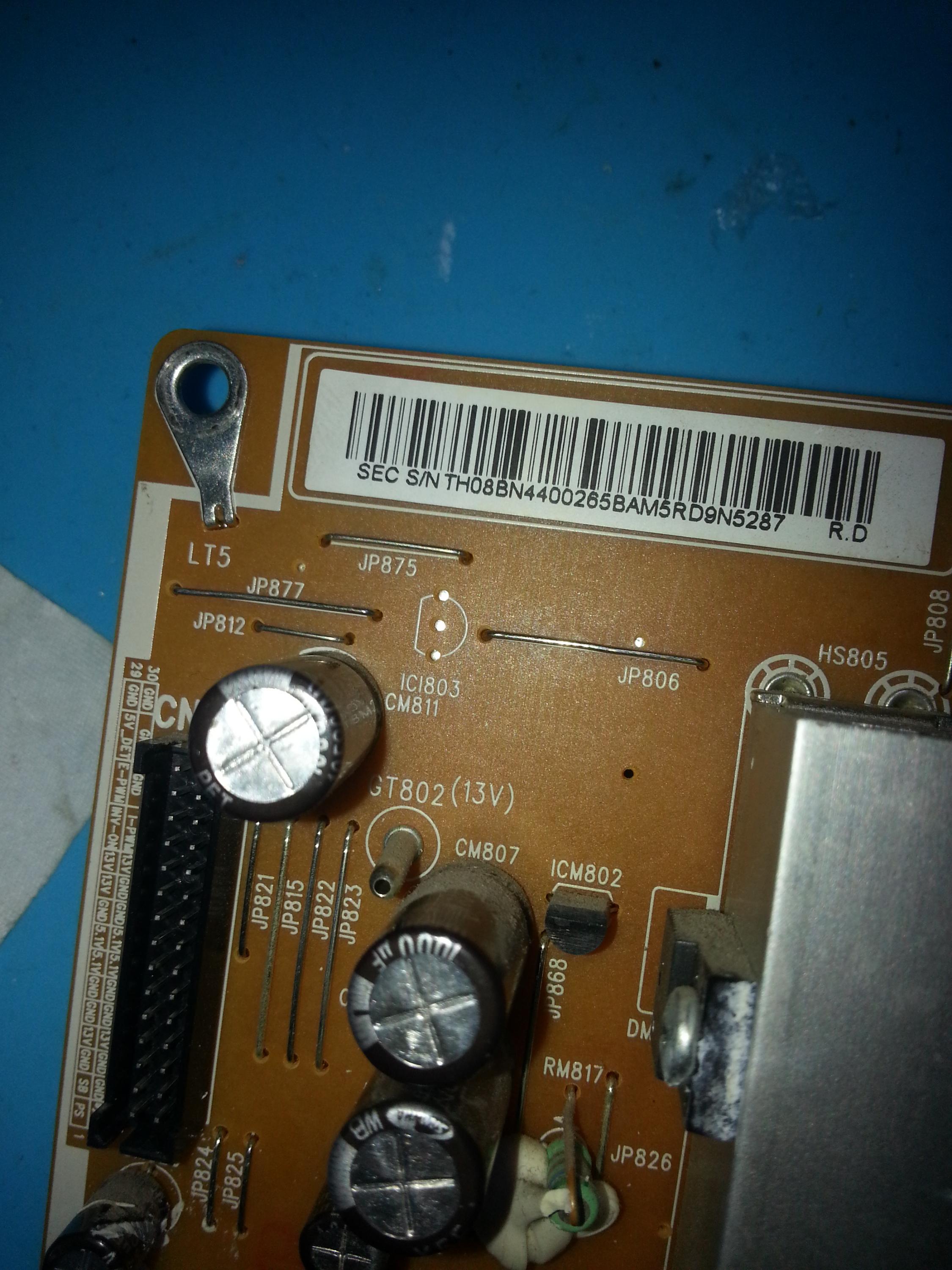

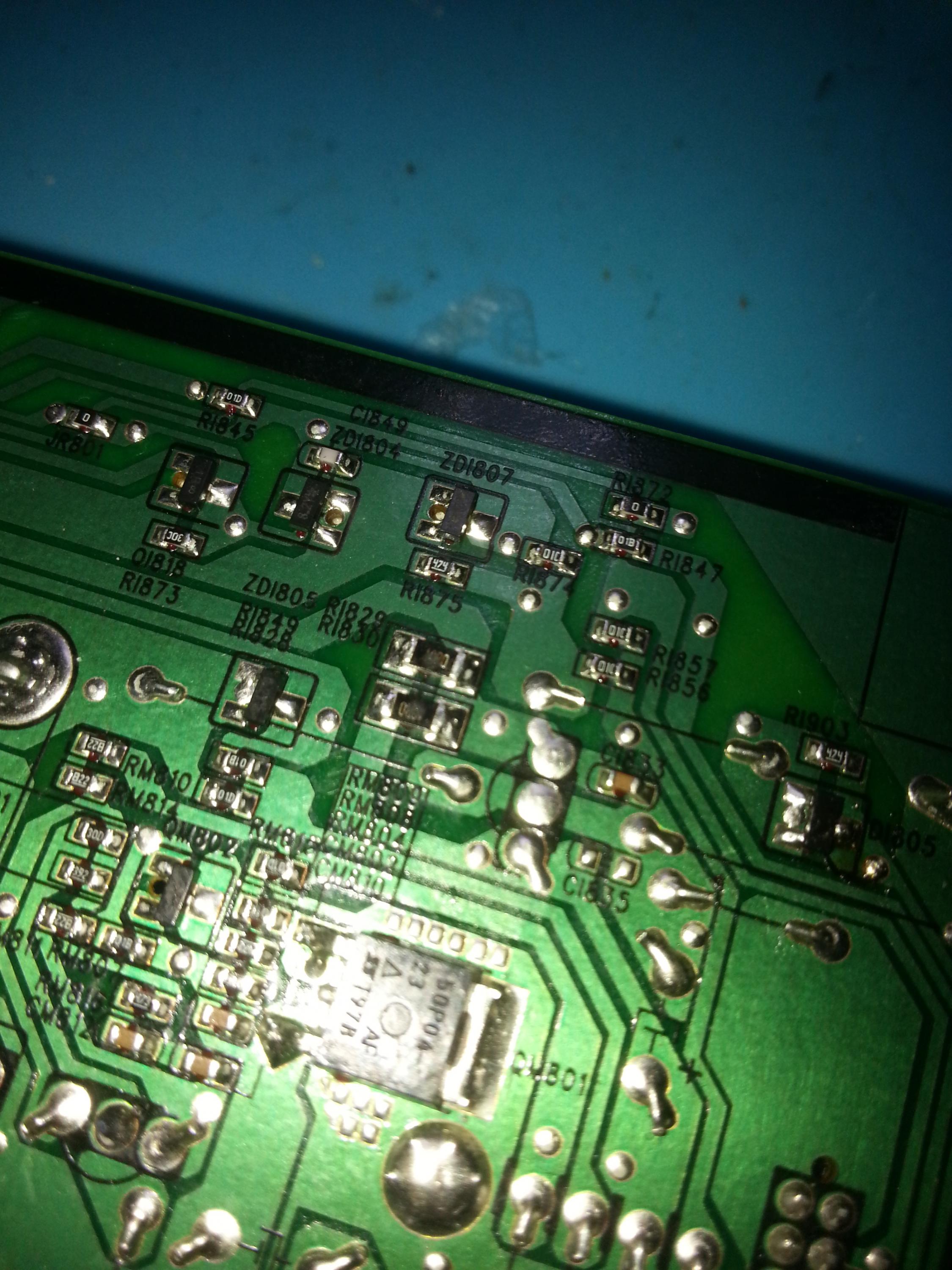

                    IC 1803 isn't fitted and it doesn't look as if it ever has been. Looking under the microscope I see that R1829 and R1830 are burnt up. I've only got 10ohm in 3216, ok to try you think ?

                        #151
                        Re: Samsung le46b530p7w
                        Photos of the missing regulator and burnt resistors the other side.
