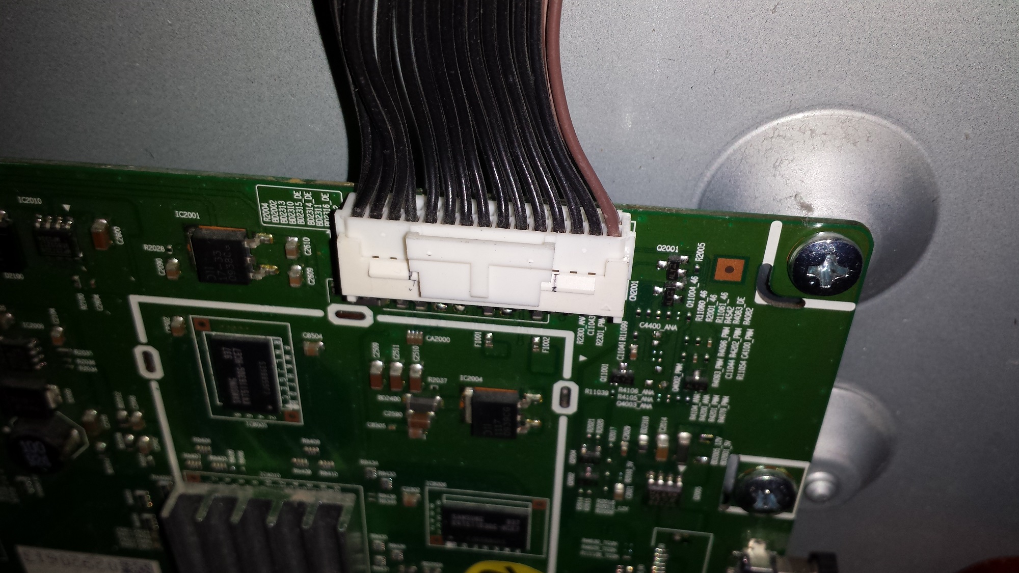

      OK, it looks like we've been chasing a wild goose. I should have asked you for that measurement before.
      Check the pin 23 inverter on/off is staying HIGH from main board (connector going between main & power.)
        #43
        Re: Samsung le46b530p7w
        if ive read pin 23 right on the main board
        12.5 v
          #44
          That doesn't seem right -- it's probably the one right next to it. If it's a double row connector, maybe the one above it. See page #1 of schematic for the pin diagram.

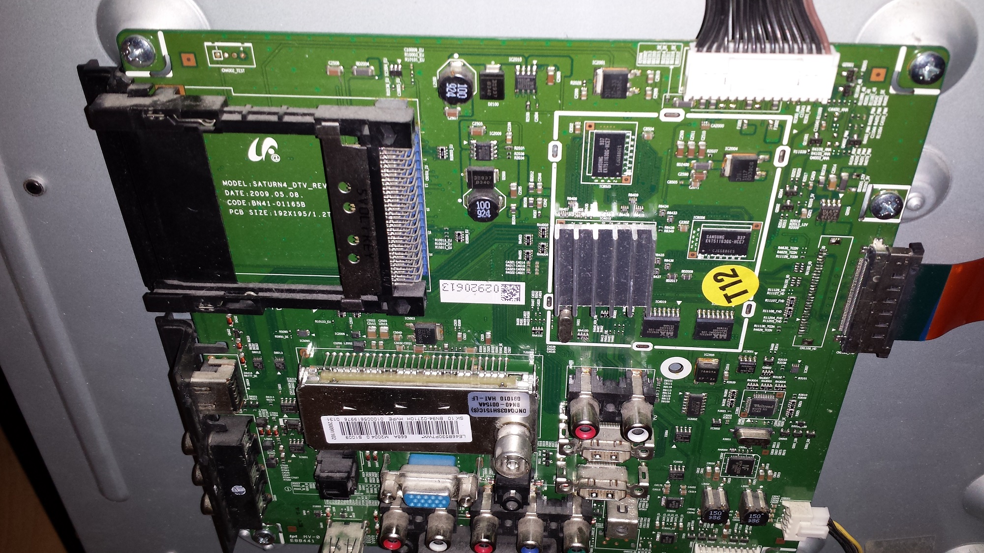

            your schematics hosting keeps timing out on me ? so ive upload some pics to see if that helps
              #46
              ok found it reading is 4.9 v
