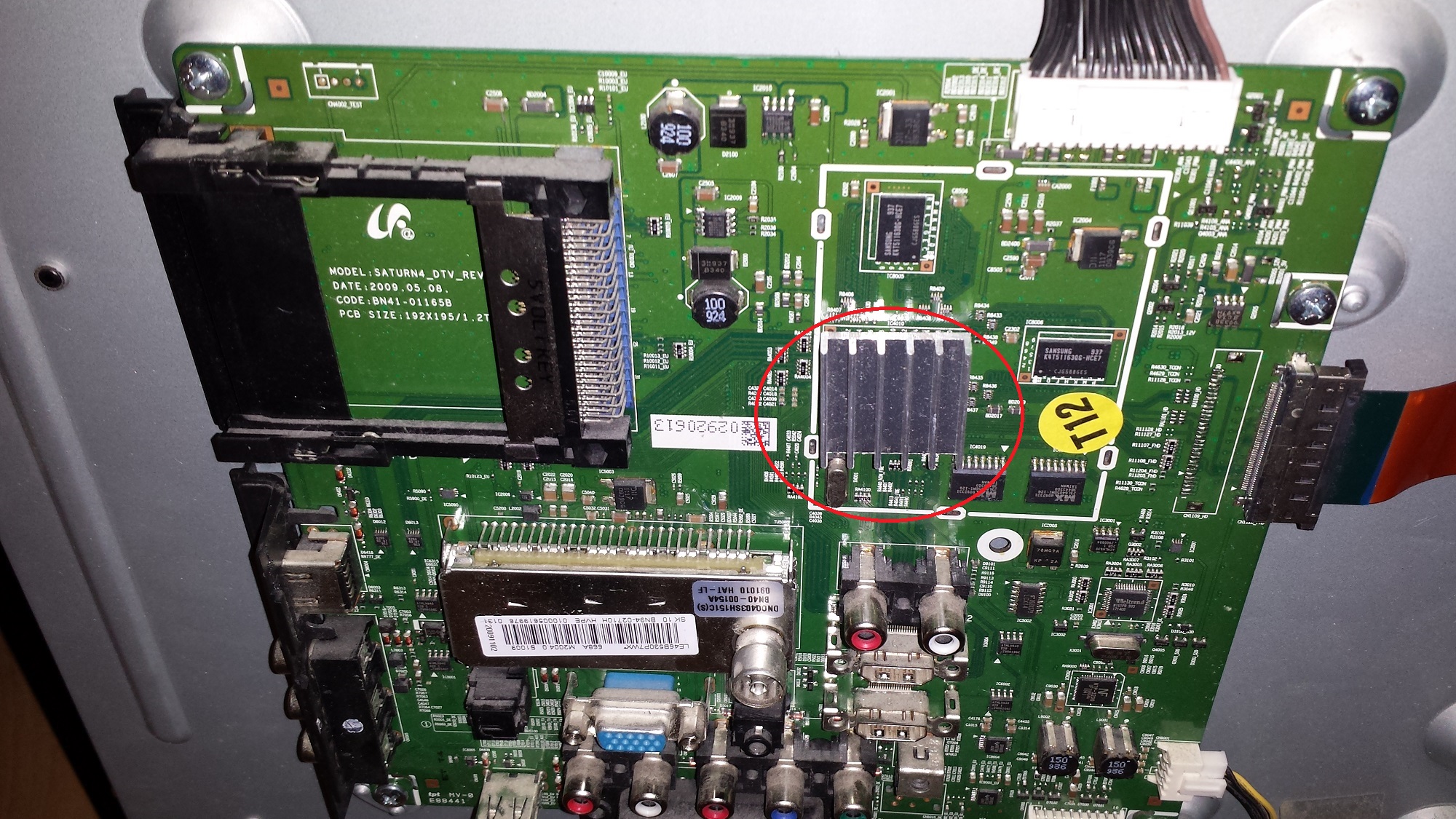

    thats the thing tom today 6hrs before it failed now 5 mins then backlight goes off so now i have no time to heat it up to test
      #82
      Re: Samsung le46b530p7w
      @tom in the 5 mins that i have before it shut off i tried heating up the main board and it shuts down pretty quick
        #83
        Get a tube.. rolled cardboard or something similar and blow warm air down it in different areas of the board until you get the fault to occur faster again.... can start to close in on the faulty component
          #84
          ok so i got a empty toilet tube put it on the end of a hair dryer then heated the main board,the area ive ringed in red almost suddenly shuts the backlight down once i heated onto it tried it 3 times
            #85
            ok scratch that now i thought ill try it again heated the same area for a fourth time wont shut off now the backlight is staying on im confused now
              #86
              Please double check ON/OFF signal. If it is holding steady when it fails, then it cannot be main board fault.

                  tom should the heat sink be really hot after only 5 minutes of the tv being on ?
                    #89
                    Yes. That is why it has a heatsink.
