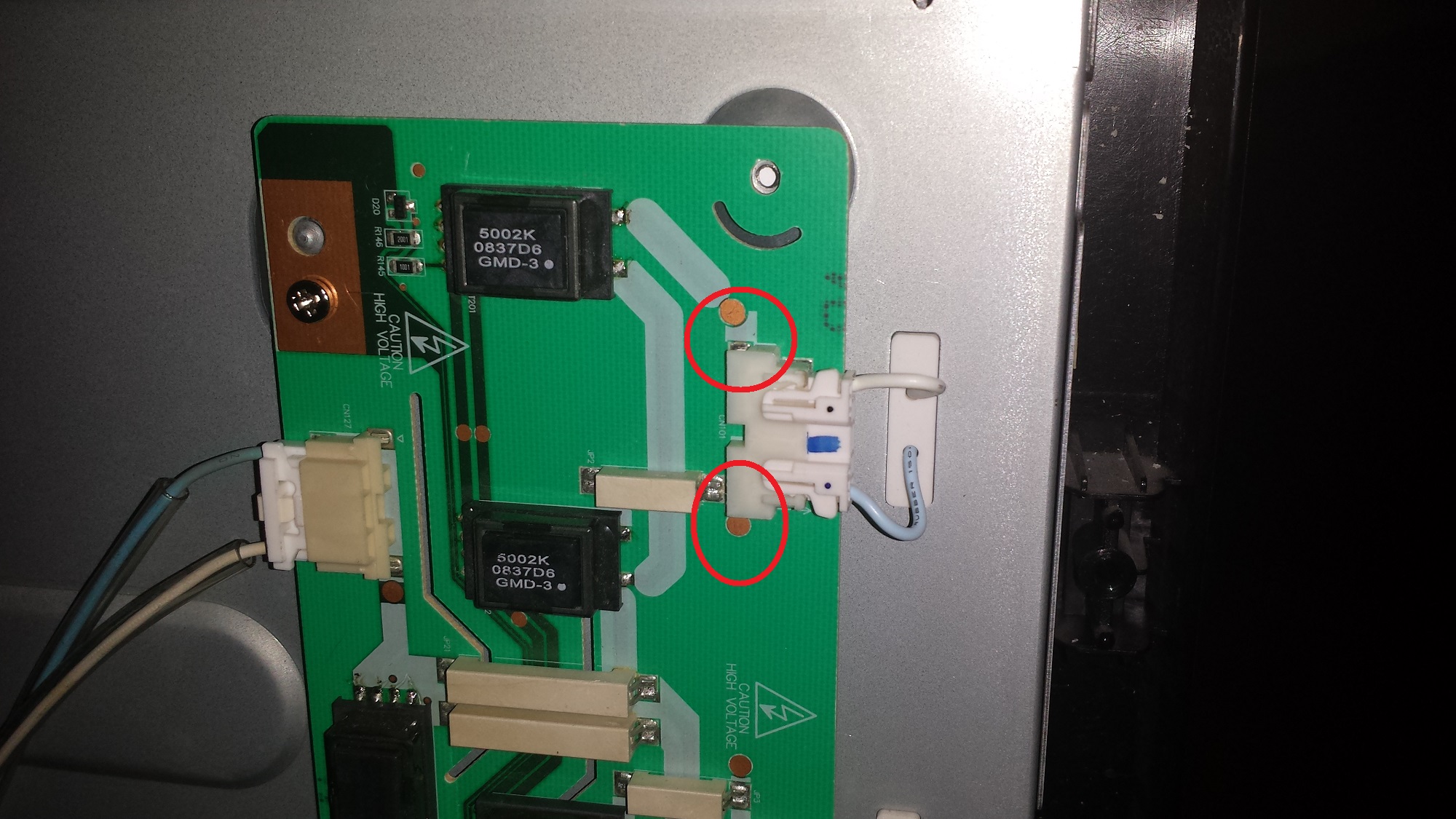

                                          #120
                                          Re: Samsung le46b530p7w
                                          tom if i test these invertor test points im getting about 180 volts on average but when the back light goes i get nothing is that right ?
