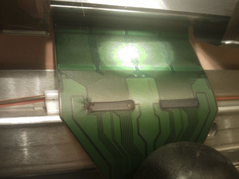

            Feel for one of the IC's to be hot on the ribbon cables on the panel

              Re: 2008/9 Samsung LN55A950 Displaying Horizontal Lines
              which IC's, on the tcon? not sure what you mean by IC on the ribbon cable on the panel...
              i'll pop off the back again..

                #47
                Here is an example:

                  #48
                  I see, thanks for the image. I am looking around but don't see any with black marks nor anything overly warm...

                                        • tibimakai
                                          • Jan 2012
                                          • 3680
                                          #60
                                          That picture is taken after the panel is taken apart. Front plastic bezel off, metal frame of the panel removed. There are a lot of these ribbon cables. Those have problems, not the T-con ones.
